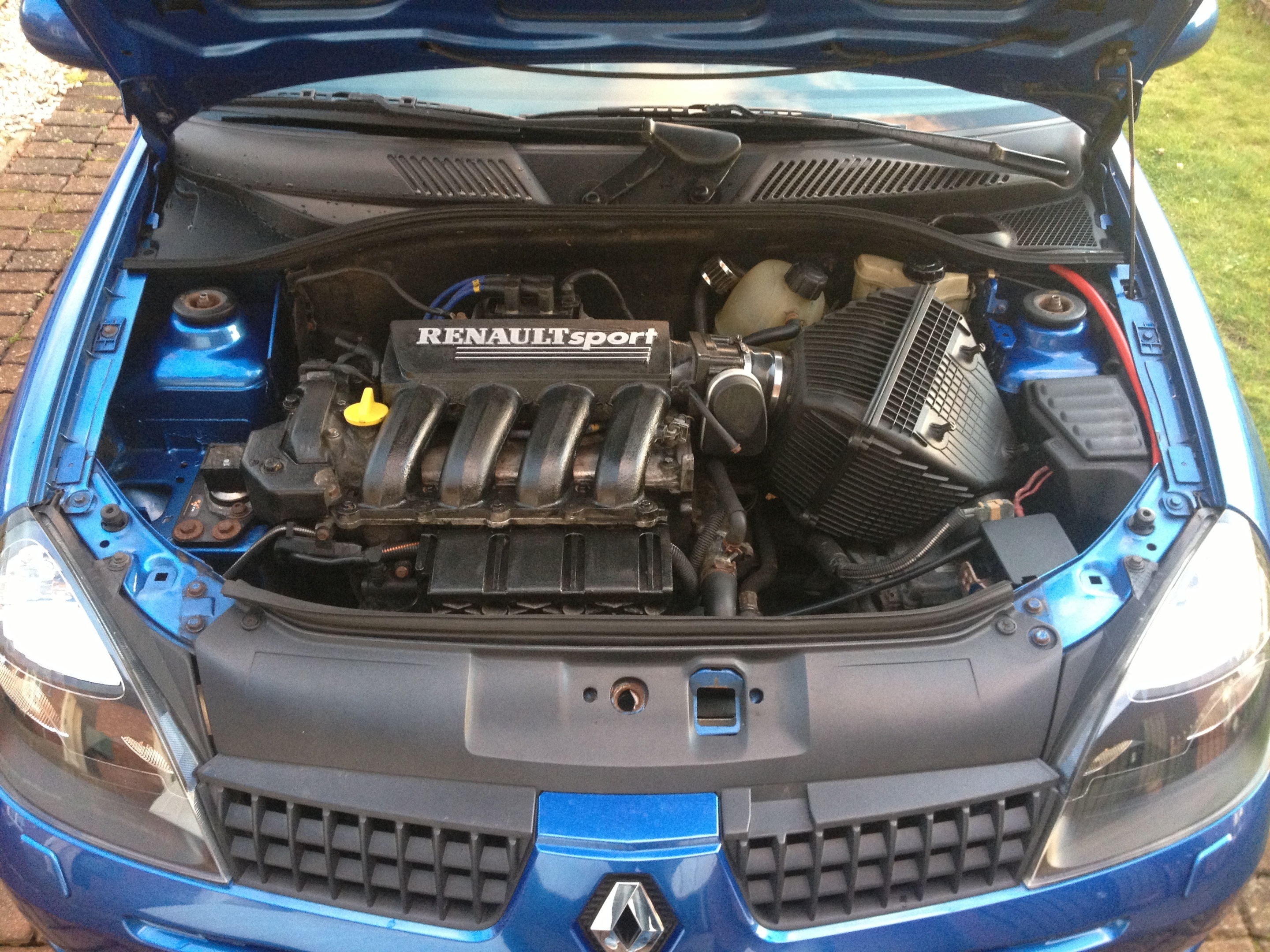

I bought my 172 Cup in June and the previous owner had fitted this airbox. It doesn't look like other V6 ones I have seen - is it an Espace one? It's fitted with a panel filter and does make a nice sound.
My water temp needle usually sits just below half. On hard driving / acceleration it climbs a fraction to halfway.
Is it getting enough air there or should I fit a feed? If I should where to route it and I take it 70mm will be sufficient?

Dug out the box of bits that came with the car and found original airbox!
Don't know if its fitted perfectly but it's fine. The cold air feed which was a b**ch to squeeze thru a tight gap so left it off. Breather pipe at top missing also. Don't know if that'll do much?
Took for a spin and its a little quieter. Doesn't sound as good though. It's never going to be a quiet car and its lost the rumble / warble at low revs which I quite liked in hindsight.
Driving wise though it is definitely less responsive low down and feels slower up till about 4k. After that it feels quick and a decent shove in back but don't think quicker than before.
Overall not as good I'm sure. Going to stick the V6 one back on. Also noticed the V6 has a nice KTEC panel filter inside. Will get it on the RR next month and see what it's putting out.

So the cold air feed pipe goes to the bottom hole? Not the hole on the right hand side? Where does the pipe go? Below the headlamp?
My battery has been relocated under the scuttle (left hand side). Basically above the left hand strut top.

you want to get that breather blocked up or piped back in.
It won't be happy if it sucks in any grit!
On the standard airbox, there are 2 cold feeds, on goes through the hole just infront of the airbox behind the headlight, the other goes downwards iirc.
If your battery is under the scuttle, wheres the washer fluid bottle gone?!

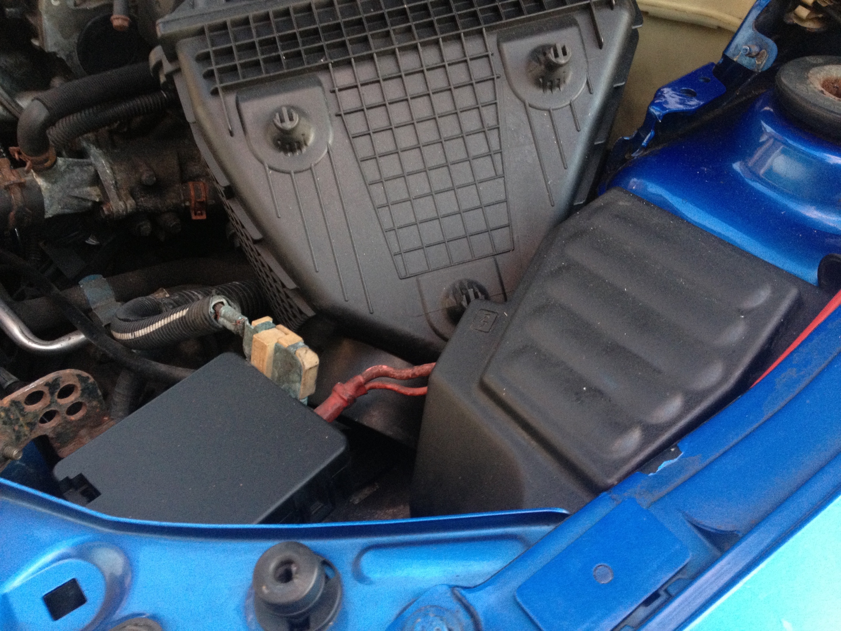

Refitted V6 box this morning. It's certainly a tight fit in there. Took it out for a drive and the low down pull and immediate throttle response is back. It's far superior. Chap I bought it from obviously knows a lot more than I do!
Here's the battery location
Washer bottle removed and replaced with this under the passenger seat

I read it as the battery was on the other side where the washer bottle normally lives.
Right odd setup you've got going on there!

Pic taken before eibachs fitted:
