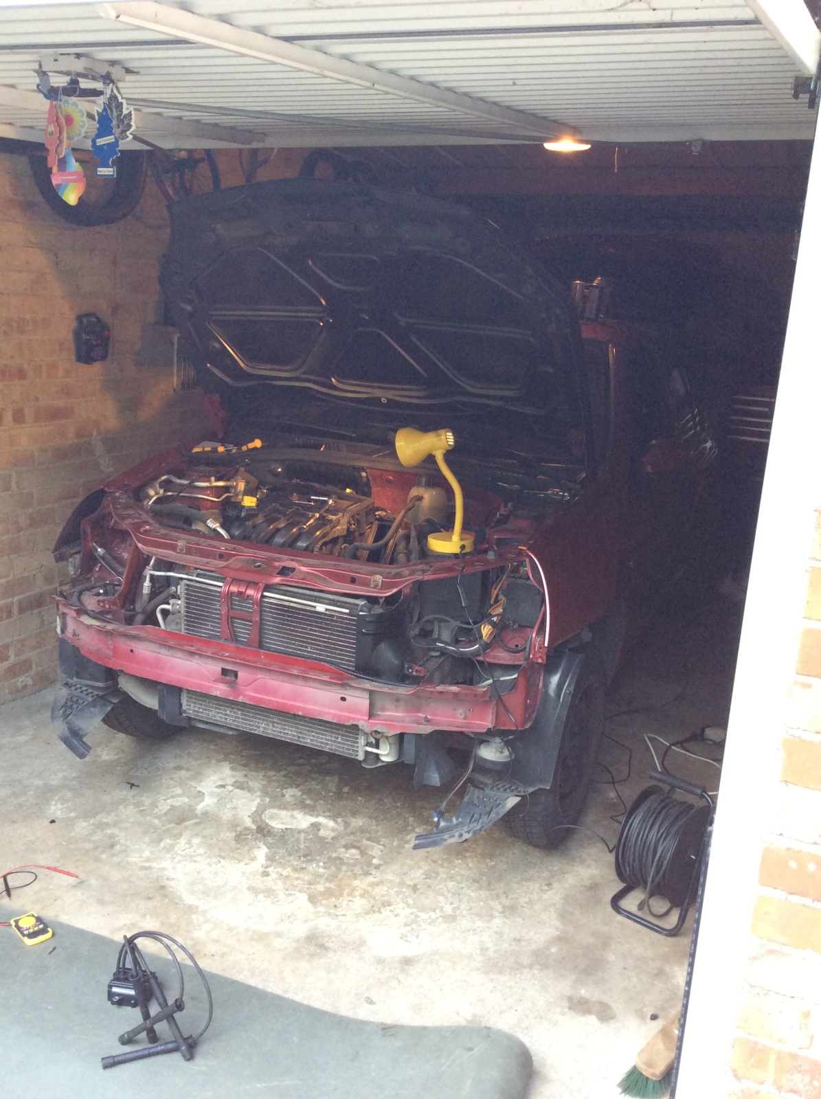

right so did some goggling about and came across a thread about the d4f engine and the throttle bod throwing false codes and causing all sorts of mischief with the idle and drive so got to work on stripping it down to get to the throttle body to only find that it had a practically brand new one in it :(
so gave it the ones over and put it back I after cleaning up the engine some more this was the result.
throttle body...
engine before...
Engine after...
All back together...
