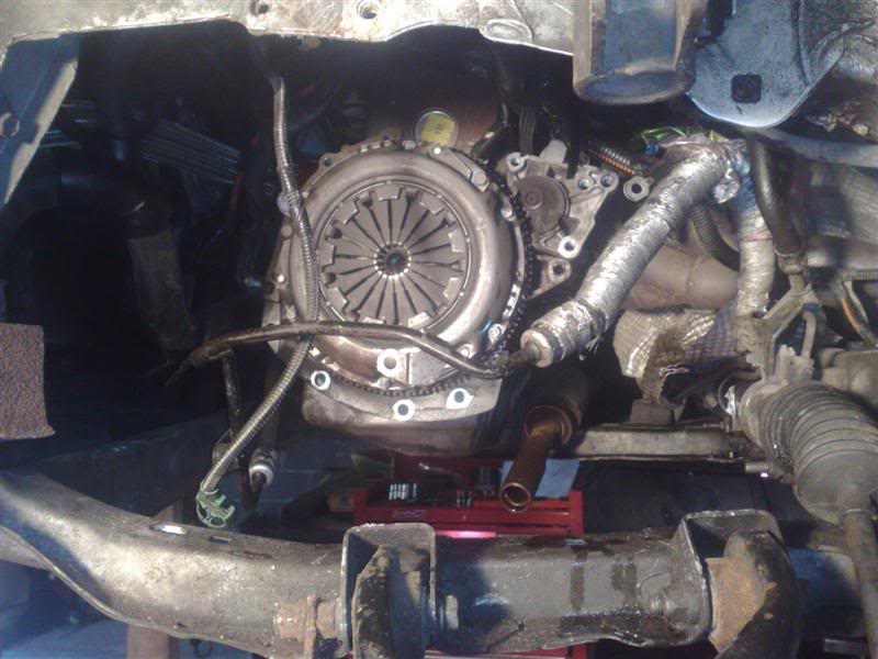

Last time I did this I took the whole engine & box out in one.
This time however I have my ramps so I'm going for the 'out the bottom method'
Reckon an hour or so & it should be out.....or is that wishful thinking?!

remove entire passenger front corner (just take it off in 1 piece, unbolt the lower ball joint and pull the hub, strut and driveshaft out in 1 go)
undo lower box mount and dog bone
drop subframe, don't have to completely remove it
the rest is easy enough, i remove the starter
watch out for the PAS pipe over/round the box

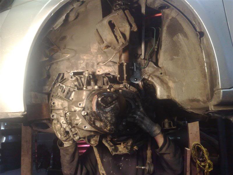

Yup....you were indeed correct Fred...it does just fit through the gap! LOL!
Just under 2 hours we got it out in - wasnt as bad a job as what I imagined to be honest - hopefully I wont be needing to do it again once I have the box back fixed!!!!

To be honest mate the PAS pipes dont really get in the way too much - was just a case of hooking them out the way!!
