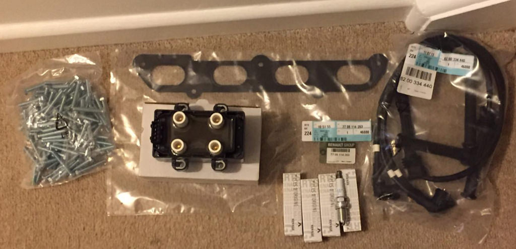

Decided to replace some parts on the Clio as it's never idled and run as it should to me, and after un-earthing more bodged jobs by previous owner(s), which involved a whole evening messing about with the connections on the relay board/engine bay fuse board due to broken wires/ a loose main connector block due to broken locking pins (white one) and a loose main earth on the gearbox which also wasn't mounted to a clean earthing point. Anyway, took advantage of my staff discount and bought all genuine parts...
All fitted, and running lovely
:) Pulls quicker and stronger from low revs too which is nice. The old plugs were the wrong ones and had clearly been in a long time, no oil residue found which means the rocker sealant is holding up well, however they had the brown arcing marks all down the side of the ceramic so they were definitely due a change (Bosch plugs when everyone knows that 172/182 only like NGK R), leads looked like they had been on the car since it was new and the coil pack looked pretty tired too - plus the earth points for the coil pack are the bolt holes where it bolts down into the inlet manifold, although I know it's also earthed through the wiring but these are still earth points - only had one bolt holding the old one in, so replaced all 4 with brand new bolts in all 4 mounting points so earthing will be better too (in theory).

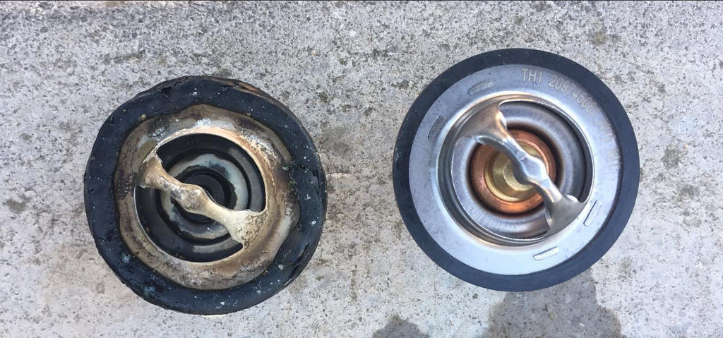

Replaced the thermostat... think it was overdue! The seal was knackered on both sides with splits and holes, and to make it worse the bleed screw for the coolant had been cross threaded so had to re-tap the thread on the housing and fit a new bolt. All tested and seems to be working nicely with no leaks (touch wood). If I ever come to sell this car someone's going to be getting a bargain with all the new parts fitted and bodge jobs done correctly!

Yeah definitely... That seal won't have been doing much the amount it was warped and split!
Got a part number for this mate? Renault part?

Part numbers are all on the Renault Parts Direct website, on each item it has a SKU reference number - that's the genuine Renault part number and can be used in any main dealer or specialist. :smile:
