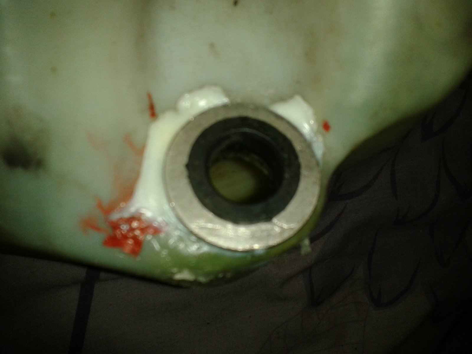

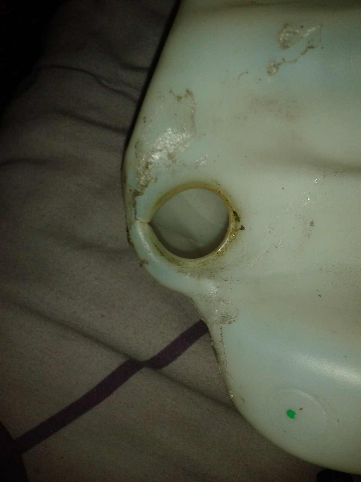

Just getting round to sort something I removed months ago,split bottle.
I think this has worked,just do a leak test now.
Correct I/d washers with lashings of no more nails.

I think it is easy to damage the bottles by removing the pumps by pulling them out incorrectly,ie not in a straight line,and I managed to damage my spare bottle.
After effecting the repair shown previously,it was apparent that even new pumps leak through the white spout,and once on the car it was obvious that both pumps did not perform the same function,and were only suitable as front screen/rear screen use,as they only operate one spout at a time.
