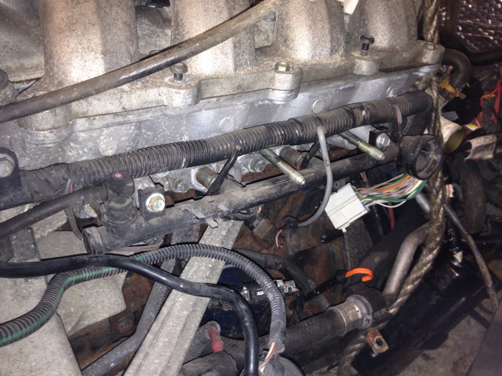

I think you are on the right track, but no pressure regulator is fitted.
Injector leak down seems a likely cause.
