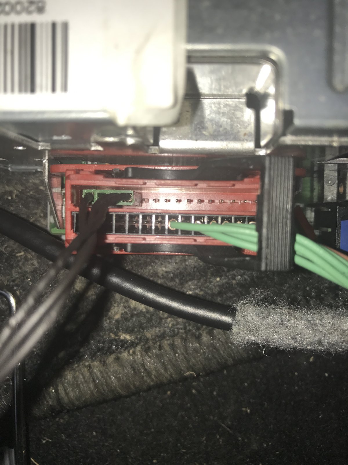

Hiya I'm having problems with this. I thing I have installed it correctly, enabled AUX ON but it's like my stereo can't even find the cable
