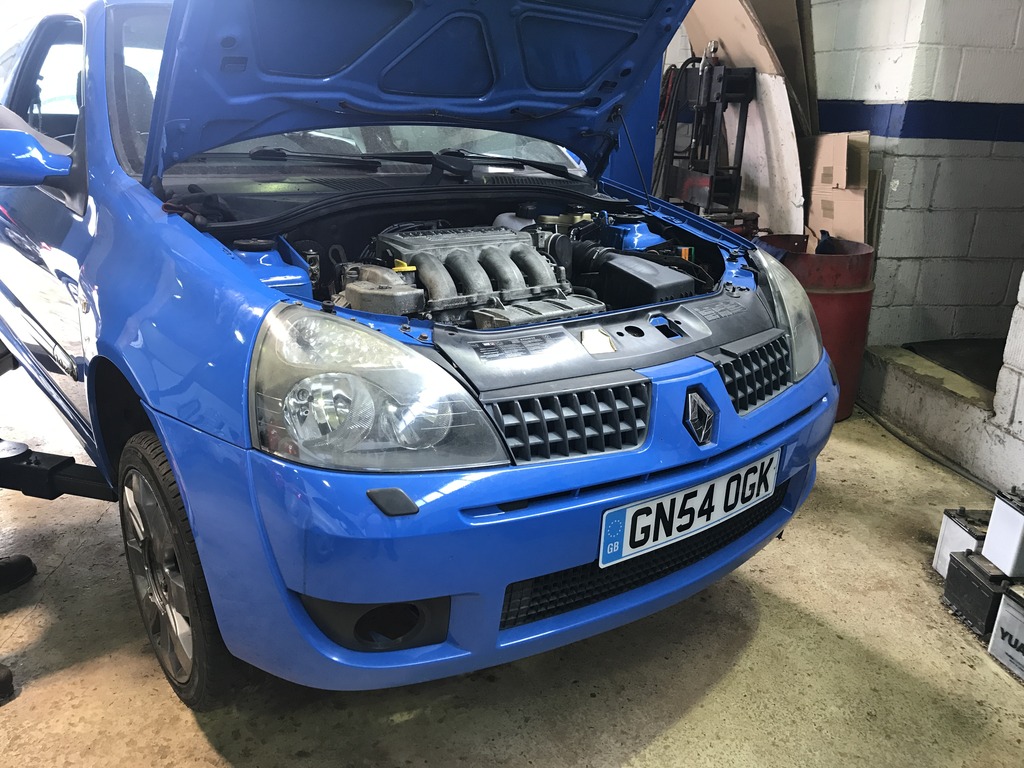

So... my guy has just finished the cambelt and dephaser replacement...
Timing is 100% spot on, but there is still a horrible horrible noise coming from the engine.
I'd been told it was the dephaser that was making the noise. But my guy seems to think it's top end, said it sounded like piston slap :( looks like a replacement engine is needed :(
Google injector noise, sounds like it's more than that of you've sourced an engine mate
Yeah it's definitely not that, it like a nasty scratchy knocking noise. My mechanic said it sounded like piston slap...
I've found an engine that's had belts and dephaser and aux done last September, with proof, and was put on dyno afterwards,
It's also still in the car so I can hear it running before I remove it.

So today plumbed the engine all back in and fired it up...
It was great to hear the F4R engine as it should be.
With only a few jobs left to do now, it's certainly getting closer to MOT time..
Just the front wheel bearing to get sorted now when it arrives.
I also got around to fitting the Eibach sportline springs I bought a few days ago, a noticeable height difference already, and I can only assume it'll settle a little when driven.
