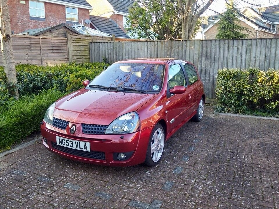

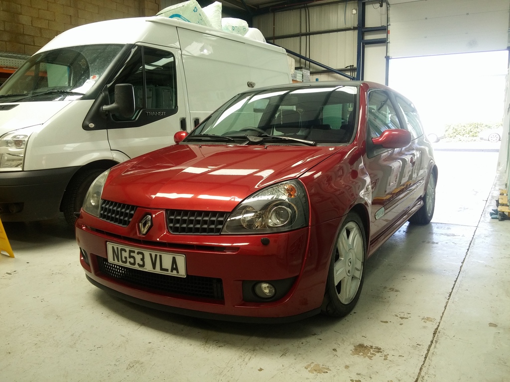

a1axx's Flame red Clio 172 ph2 daily/track hack
Starting a thread of my newly purchased Clio 172!
I'm not a new comer to the track scene, I recently decided to break my Peugeot 205 XL track car, a bit of special one, I built a forged TU5j4 with jenveys for her, completely ground up rebuilt the car and perfected the handling over years of trying different coilovers setups, torsion bars and anti roll bars. I took it to the ring for the 2nd time at Easter, came away with a respectable 8:25 BTG, but still left feeling a bit like I wanted more from the car than the 205 would give.
The Clio decision was for a number of reasons. After breaking the 205 I cleared some debts, we all have them, and I was left with a couple of grand to seek something out I can use daily and also on track. My friends have 172's, well two of them are valvers with a 172 engine, and I can tell you the old saying of 'there's no replacement for displacement' springs to mind! Even with 185bhp on tap from the little 1600 and only 800kg to pull, it still struggled with a lethargic midrange. There's no question that with a heavy 172 I'm not going to reap the same cornering thrills, especially going back to an open diff! That said, I'm sick to death of using a track car everyday, with no where really to build it or store it either! It's also been awesome getting back into comfort again, I was quite surprised when I realised it had cruise control, should be good for the next ring trip!
Anyway, without going into it too much, I could have bought a Honda, but without appearing to have questionable sexuality and friends that are experienced with the clio engine, I decided to follow their lead.

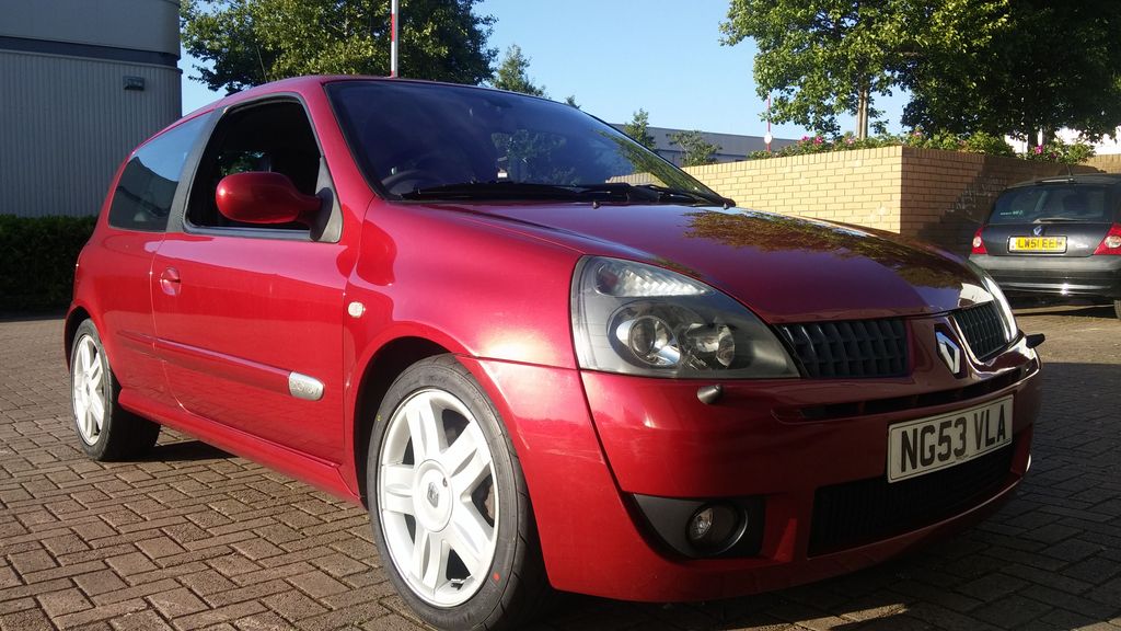

So 2 grand in hand, which doesn't buy a lot these days, I set out to pick a Clio 172 to see what all the hype was about, and I found this flamer!
The car has been laid up for a long time, and has what I've found to be typical problems!
Belts have been done, with no proof, exhaust hanger on the rear perished, thumb grips gone, gearbox dog bone slack, dephaser rattles, cv boots perished bla bla we've all been there!
So in order to spring a new lease of life into the car, before it was driven into the ground I've set out to save it. I could have bought one that was mot'd with all work on paper, but where's the fun in that? I've saved my self £100 and taken on the hassle, but I know when I do it, it's done right!

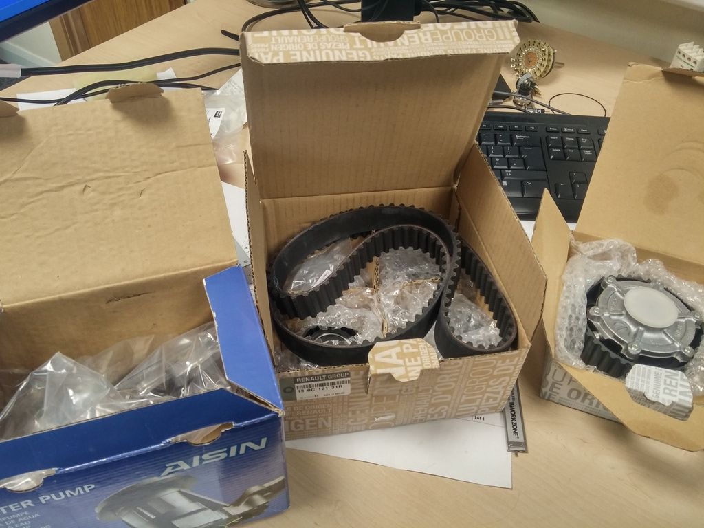

Parts in the post then:
Genuine belt kit & dephaser plus water pump (also the lend of the Renault tools)

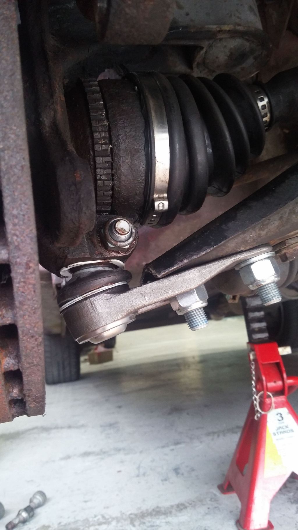

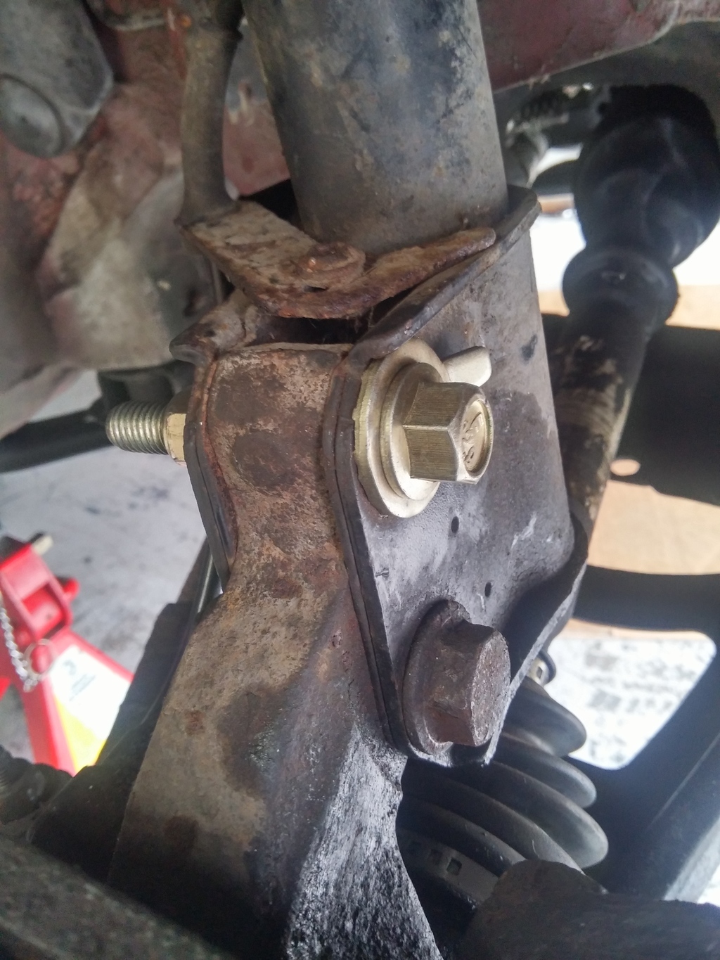

Lemforder ball joints are fitted. The old ones were absolutely knackered!
I fitted some camber bolts. They have made the turn in more responsive, I like how it feels. Also looks quite nice.

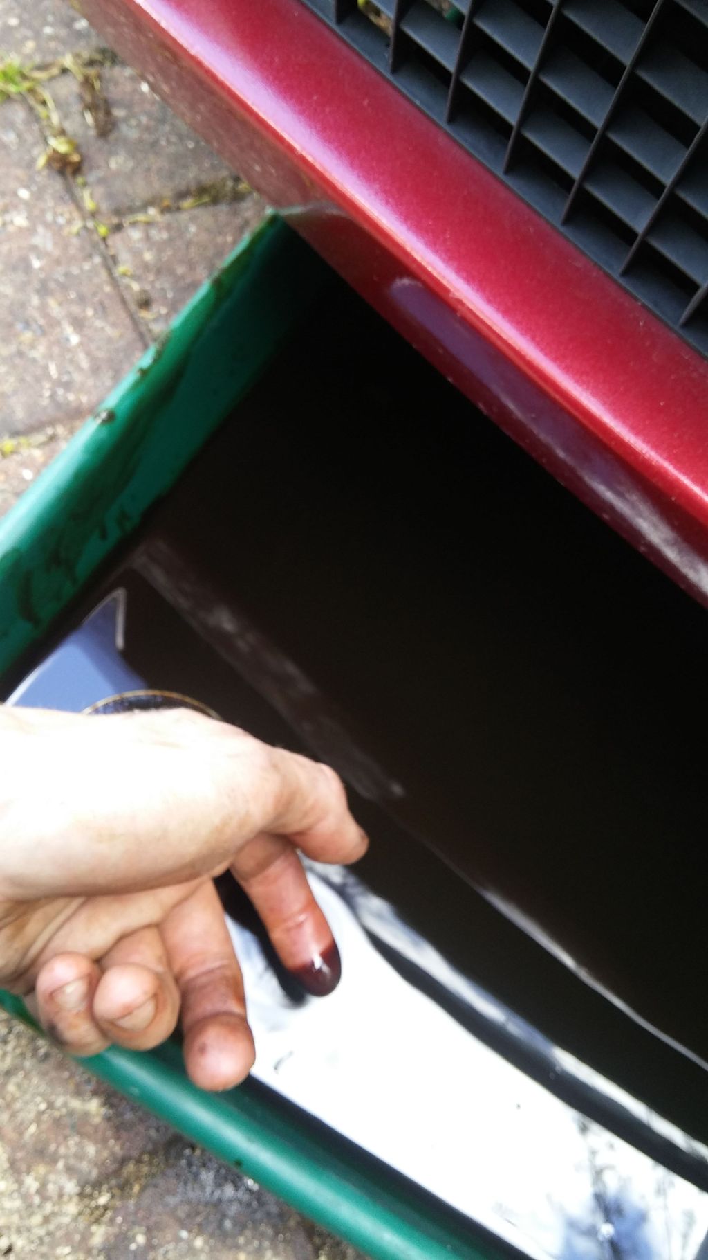

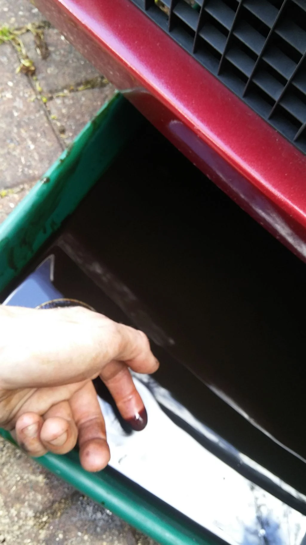

Well deserved oil change too. It came out in chunks!

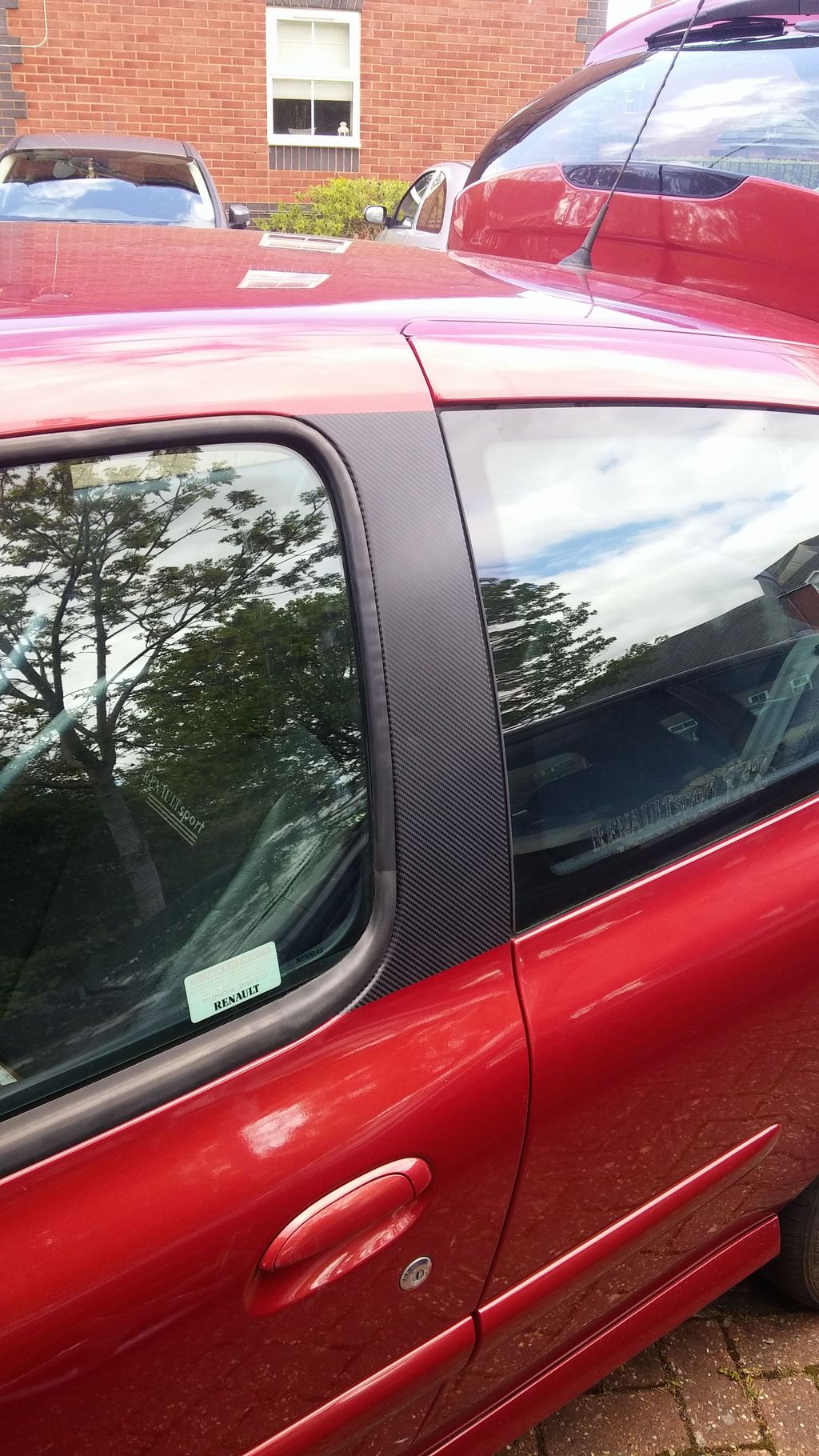

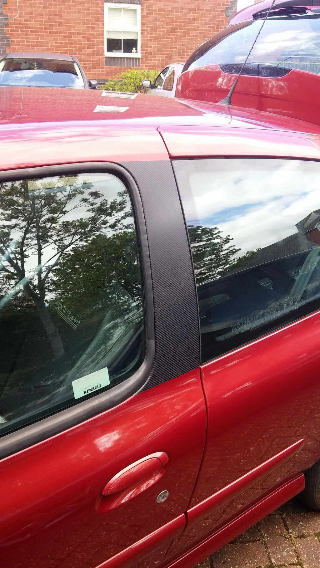

It's not my usual cup of tea, but the doors had been wrapped badly with carbon, and had light cut scratches from a blade.. I re wrapped them

New belt /dephaser and water pump waiting to go on

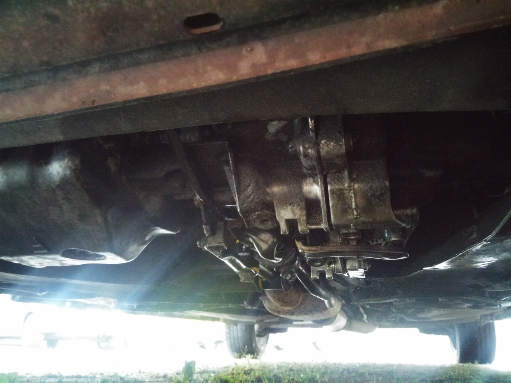

Selector seal mod made by TND to fit, haven't got around to it

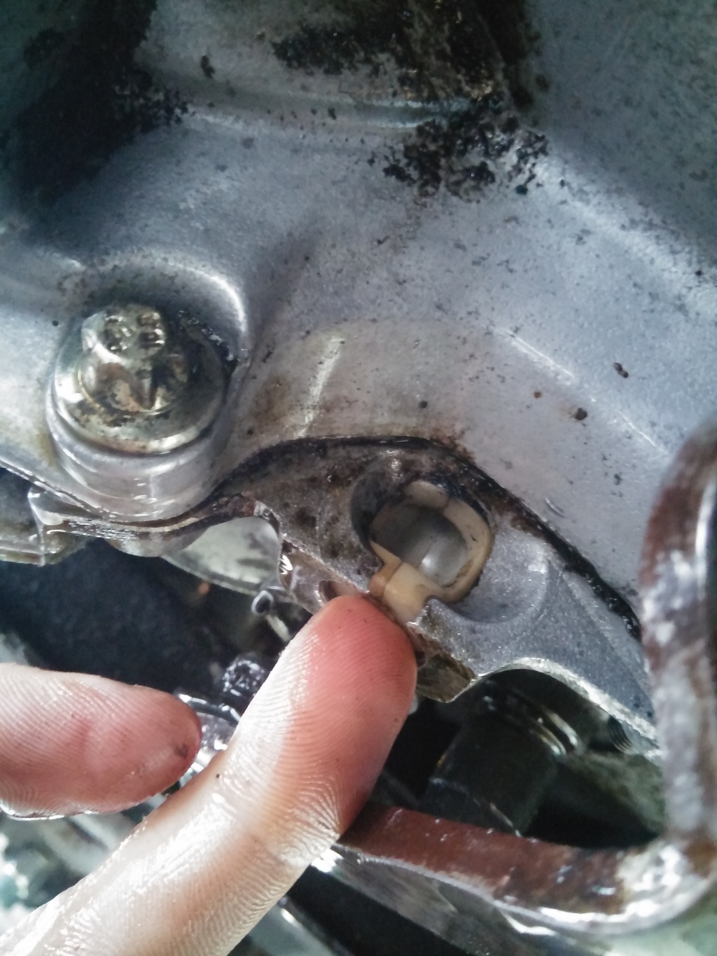

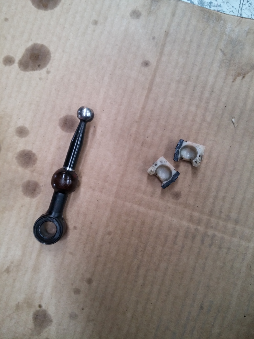

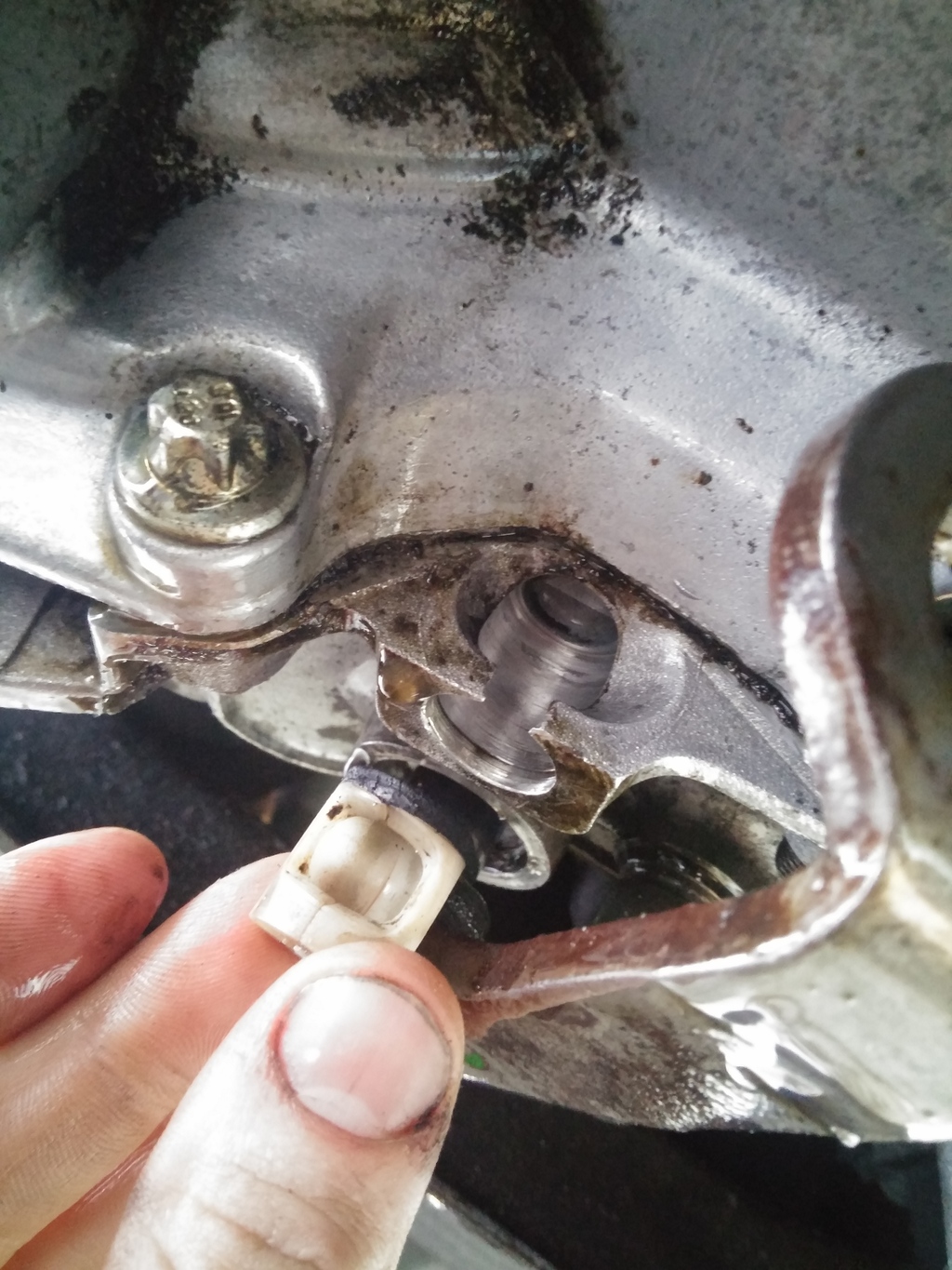

Okay. Fitted the TND fn10 kit from Mapco. It's easy to fit, but the gators etc on the selector lever are easy to tear so bear it in mind. I have to replace 1.
I followed the instructions as per the videos online
YouTube tnd fn10!
Firstly I think a lot of people find the little white plastic insert to be the cause of their leak, I believe both my selector seal and bush leaked.
Here is the part in question
The black rubber seal on it was persished badly. Oil seemed to collect in the bush.
Anyway, I was in a bit of a pickle as I needed to drive home and put sealant above the bush, it seems to have stopped the leak so far.
I'm leaving the lower engine cover off to keep an eye on things
So far so good
Topped back up with some millers box oil it seems to be good as gold. It only had 1l of oil in the box from the previous owner... So I will be keeping an eye on it.

MAPCO seal definately a diy job then? I need to sort mine out.
And did you buy a new seal for the white plastic socket? Or did you use sealant?
Looks well mate, Flame Red is such a great colour!
Yea I changed it on axle stands bud.
Usual socket set
Circlip pliers
Side cutters (snips)
I didn't change the bush seal bud as I wasnt expecting it to be sealed off the way it was, it should be separate from thw box oil but in fact it isnt! I used sealant but need to buy a new bush to he honest with you, it started seaping from there again but not as bad!

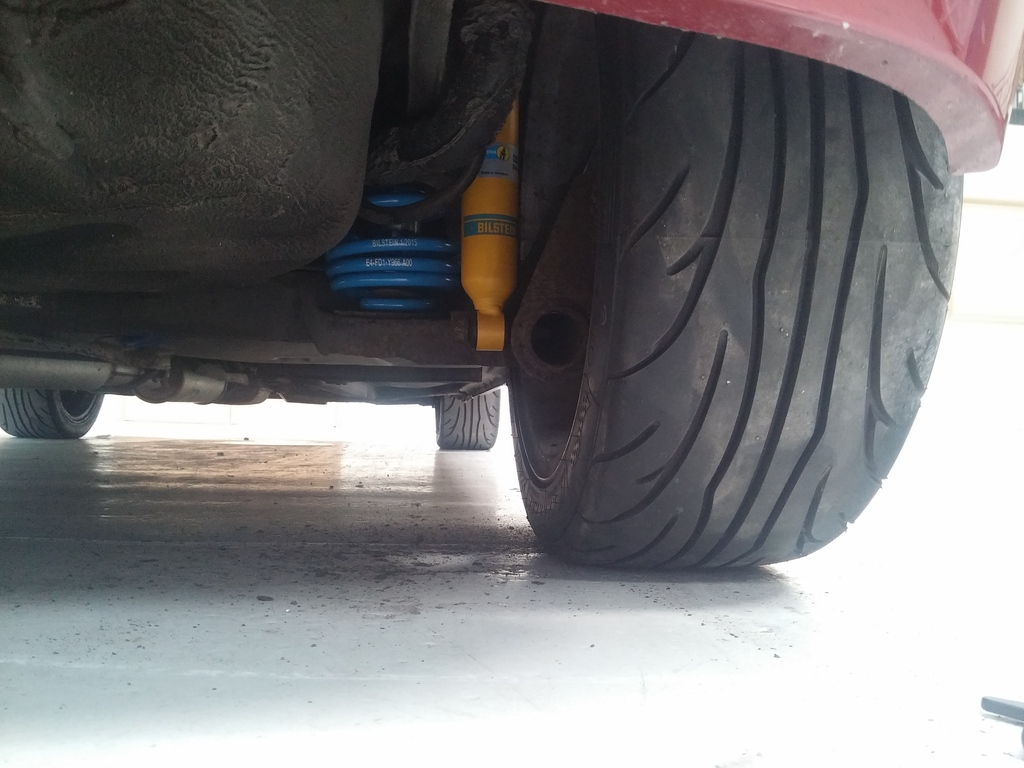

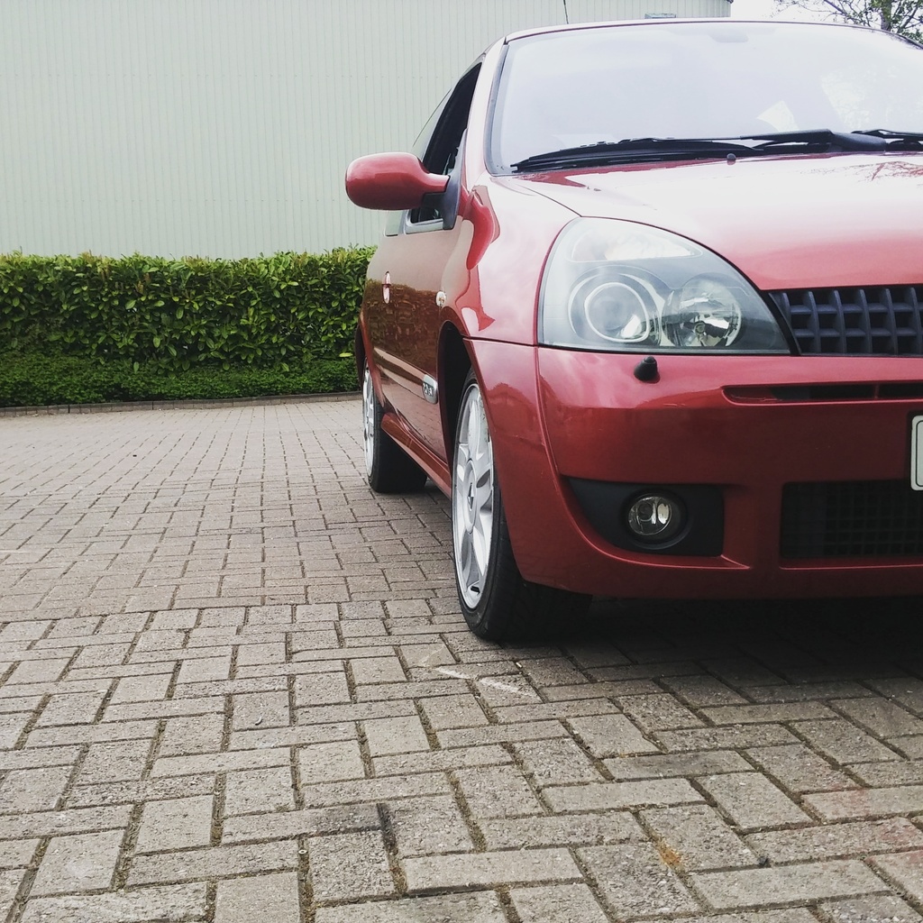

So, eventually got my NS2Rs on and I really like how it is looking, I need to back the camber off though, it's a bit extreme..
It will all be sorted after fitting these :), just ordered b14's.

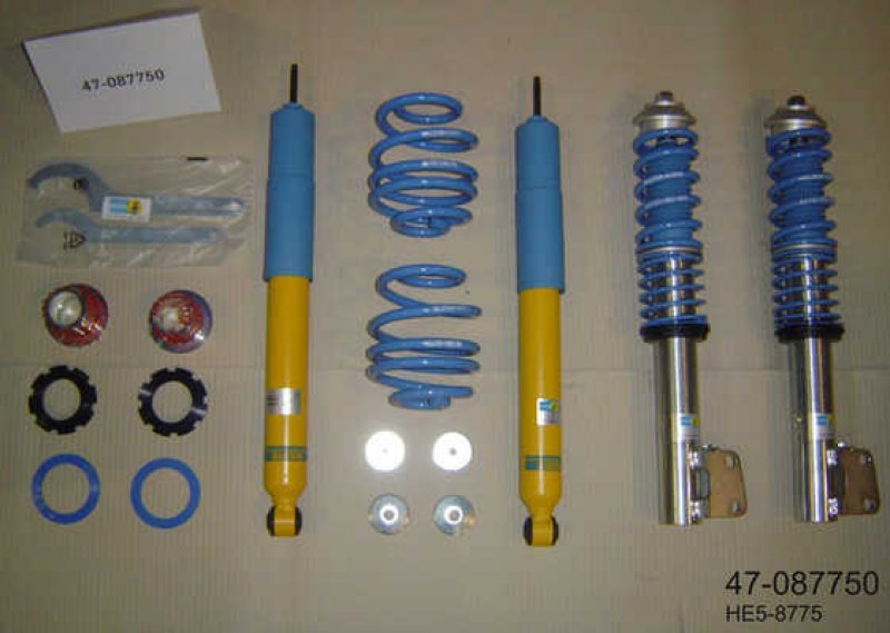

Coilovers arrived.. They look amazing. Glad I went for bilsteins, Roxie got a set for her 106 too :)

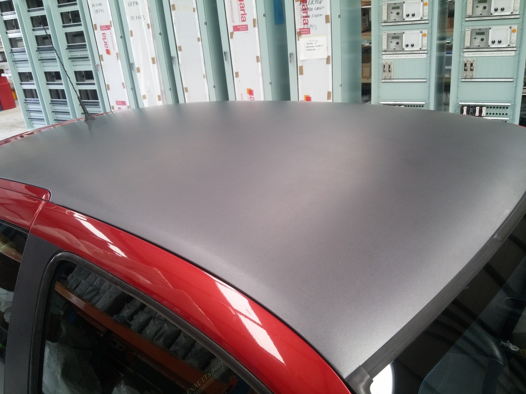

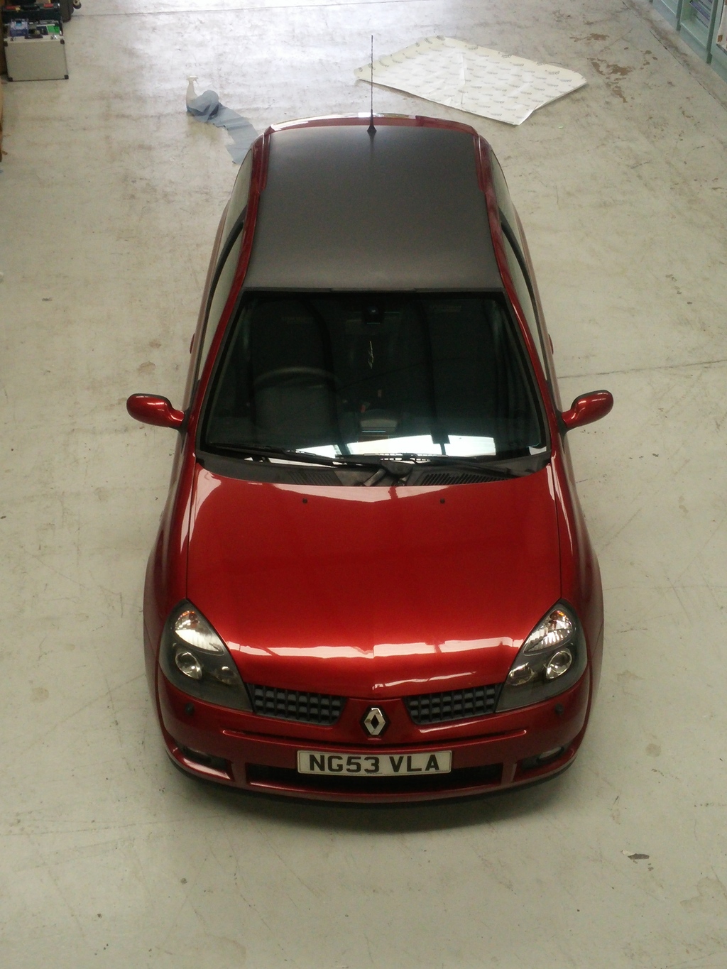

Lastly a few friends and I started on the roof graphics.. More to come :)
A little marmite, but trust me when finished they will help it stand out on track :)!

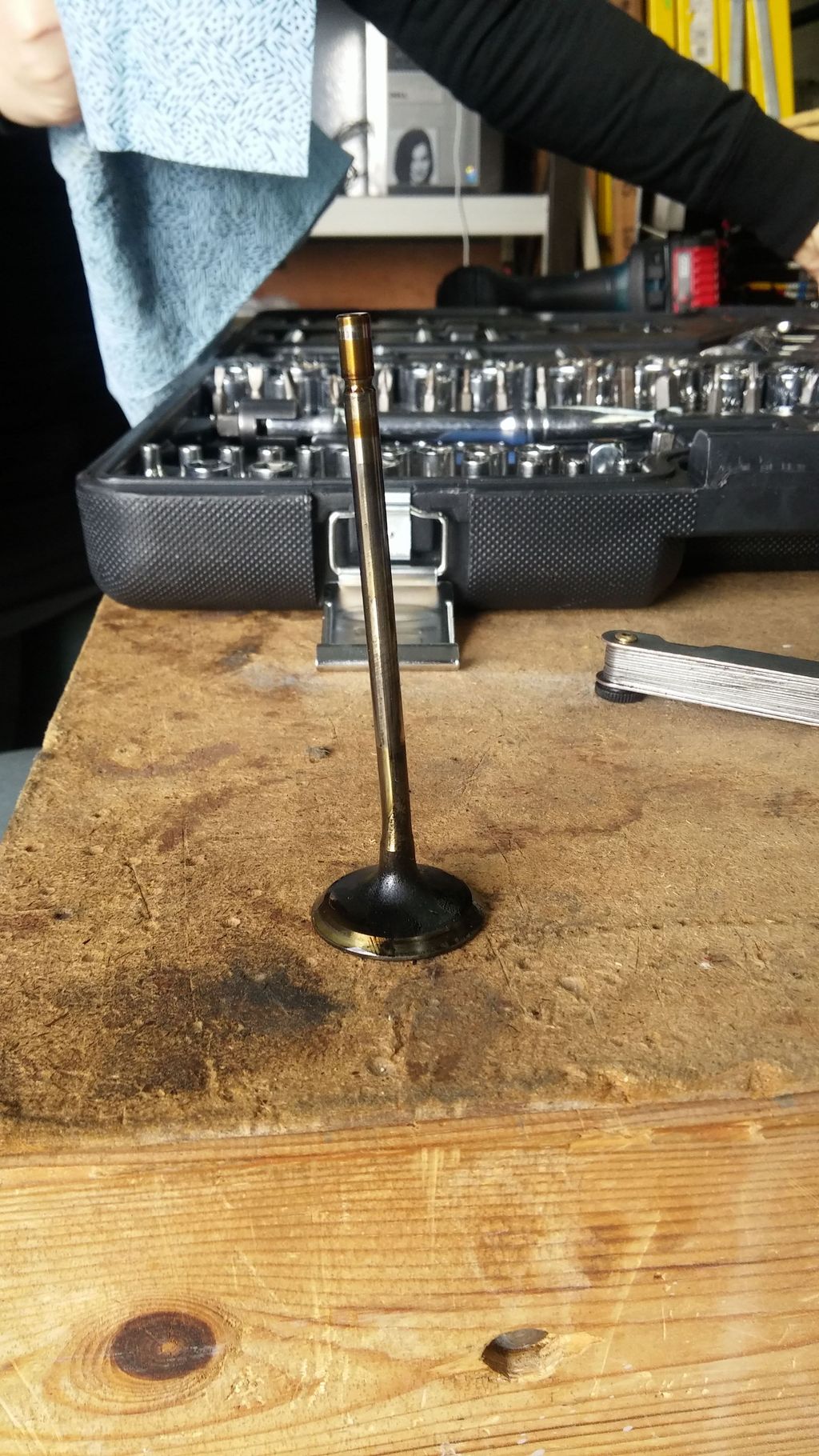

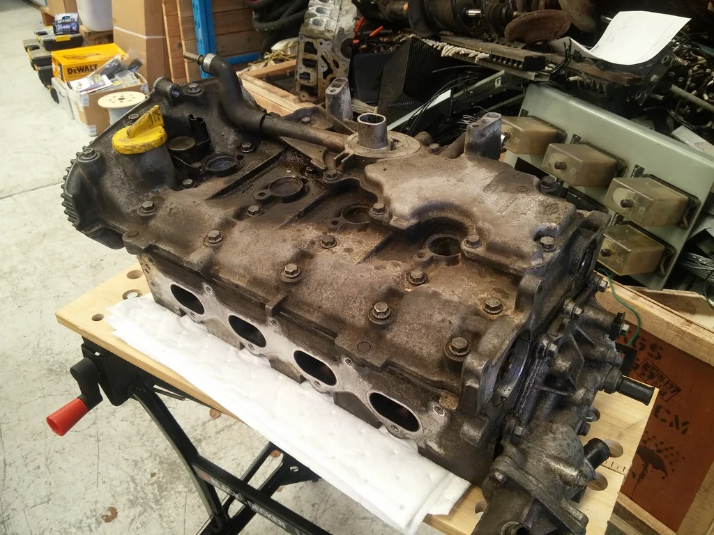

So with castle combe looming on the 1st of August, I've had to get my finger out. I just ordered a ph1 head from Tim Finch. Hopefully just a fit and forget that the valve bending ever happened...
Akay
  Clubman Cooper S
Nightmare! Did the old belt snap?
How is your selector seal fix holding up? I need to do mine but heard reports of them leaking again!
Slipped on the crank mate... Not the end of the world but I didnt want to spend too much on engine bits!

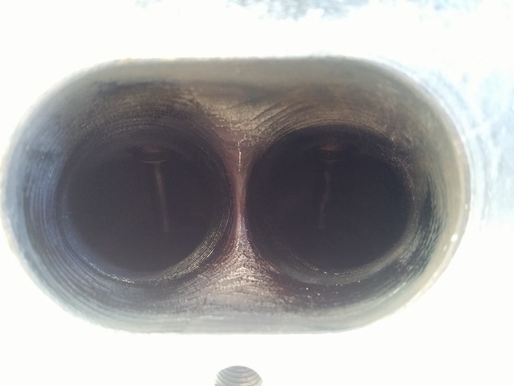

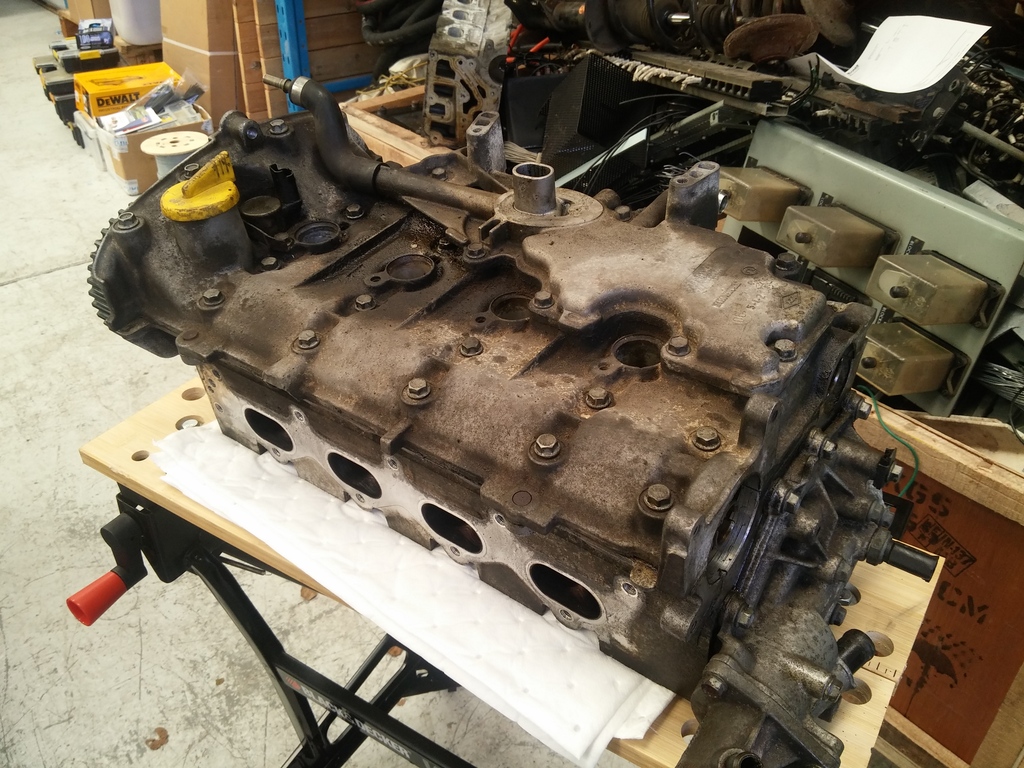

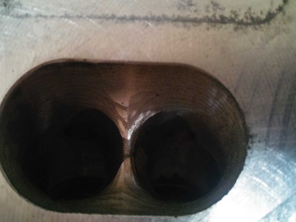

My Ph1 head arrived today from Tim Finch! Of course the exhasut ports are different, but check out the inlet side differences...
PH1
PH2

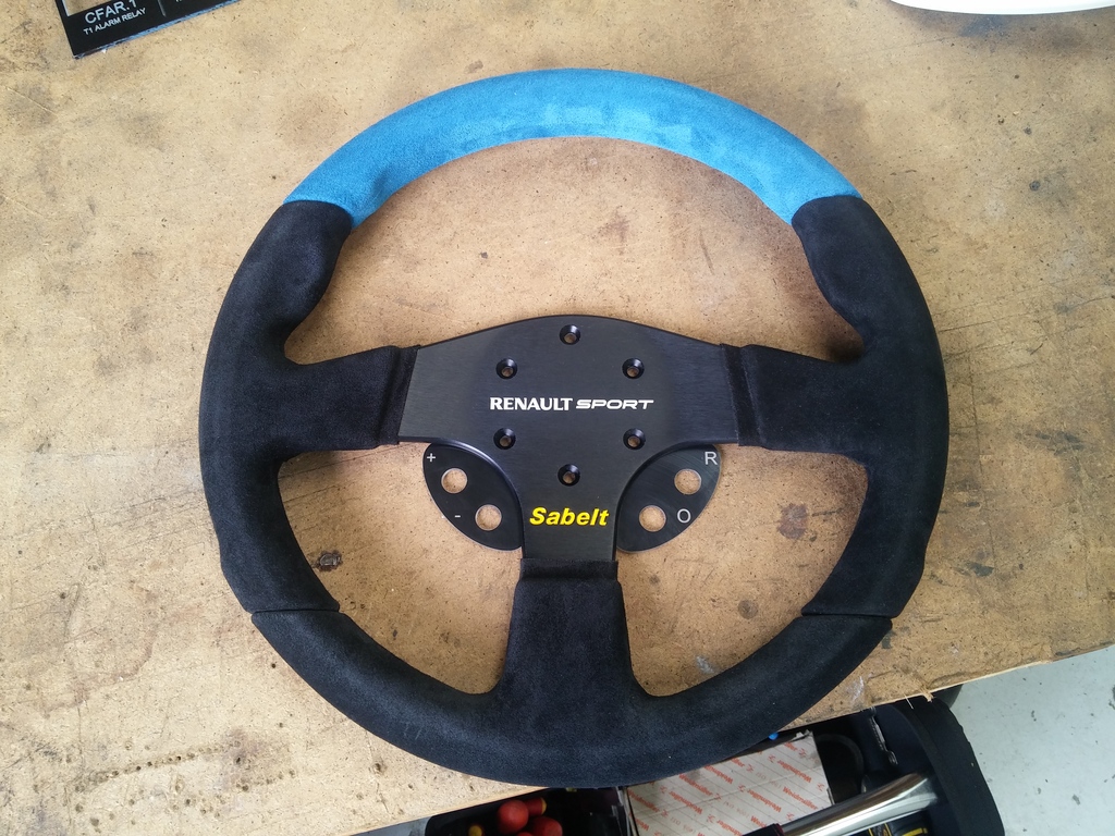

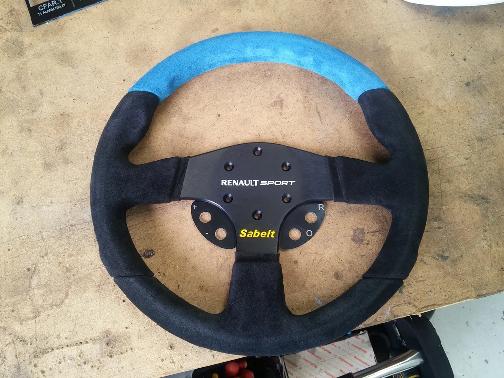

Bought a very beautiful steering wheel!!

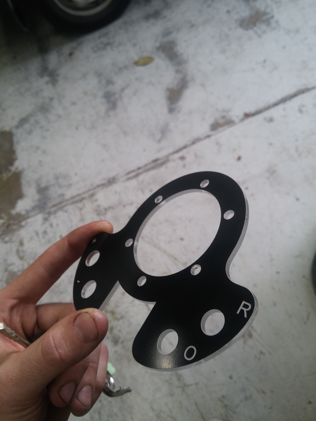

Cruise retro fit in progress :)
Lettering is etched, edges look absolutely spot on, polished finish!
Considered making these? I'd have one for when I eventually get an after market wheel.
Yes Josh I will make a small run of about 10 in the next couple of weeks. Id like to get a couple of hundred miles testing it out, strip it all done and check everything after etc. It will all be properly soldered/heat shrinked and routed to the original plug.. Once I find out the name of the oem plug!
  Megane 250
Oooooh brilliant, PM me when you are and I'll defo have one!
