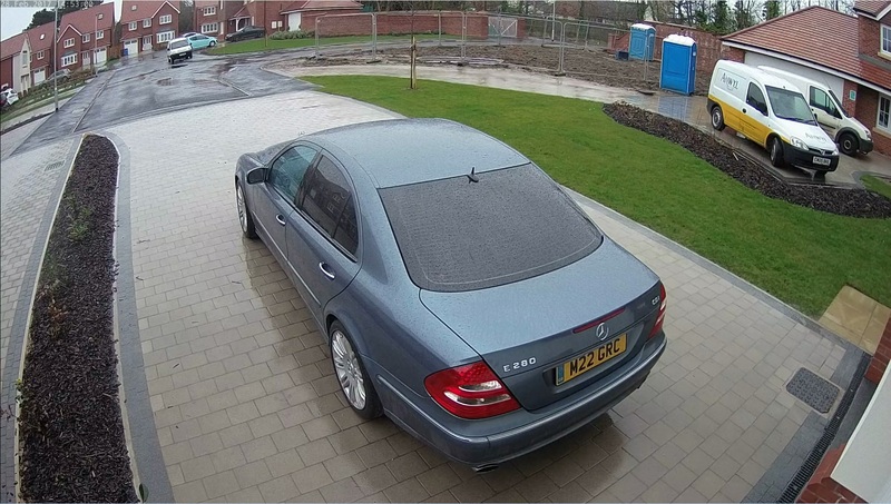

  Turbo'd MX-5 MK4
Thought I'd add an update to say that I've setup my two Hikvision cameras (powered by POE) and I'm pretty happy with them, I've got to run the cabling properly in the garage and wall mount the switch but that'll have to wait for the time being:
