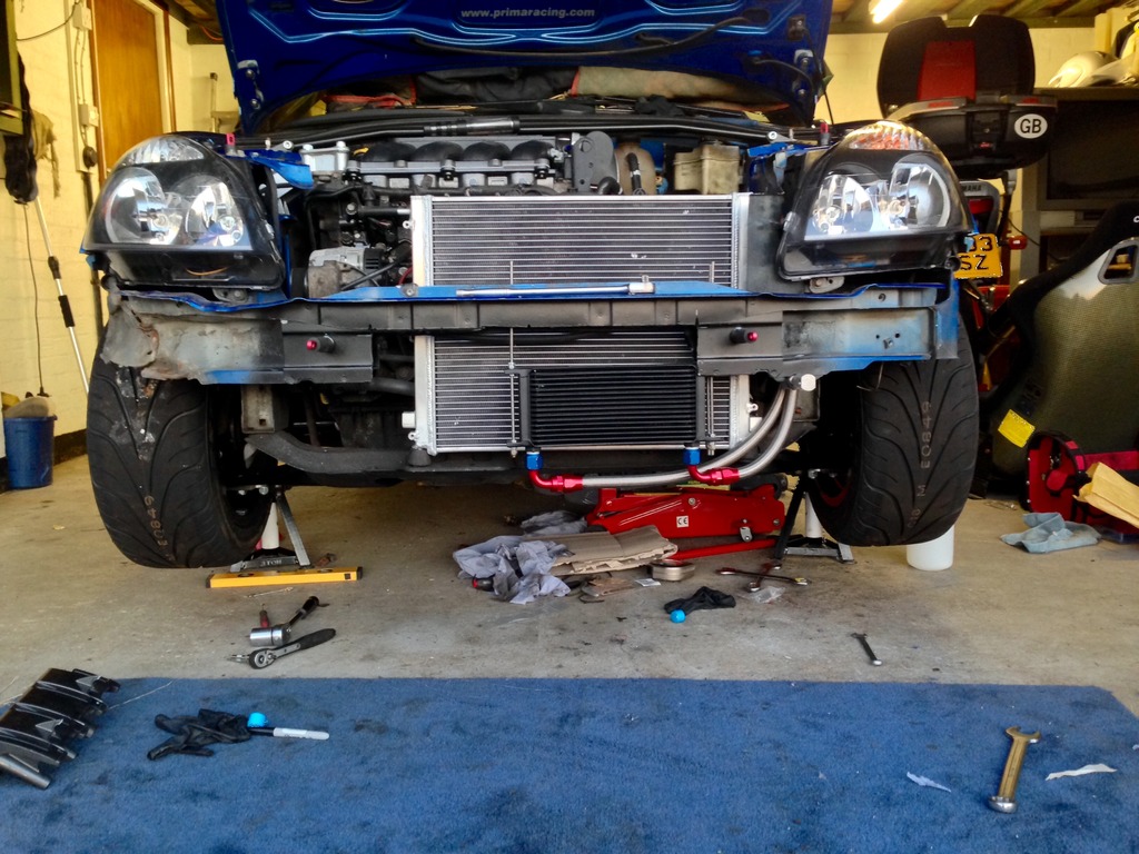

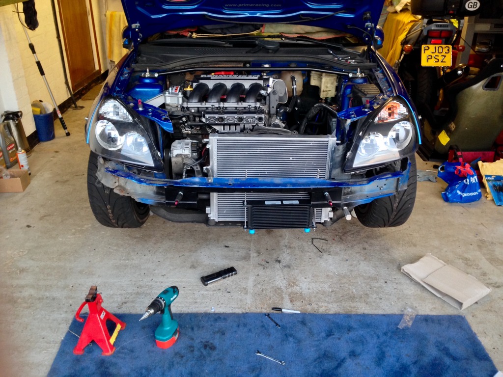

I've got a Golf GTi one to suit ITBs, found it to be good quality. Had to bid on several to get one at right price.

@Arran_ do you have any photos of it fitted, and did you use the standard fan?
@Grats the golf one needs modding doesn't it?
Some 10mm pegs need welding on the bottom and a pipe needs to be re welded on at a angle and something plugged up is that correct

Mines a golf one mate. Piece of piss to adjust.

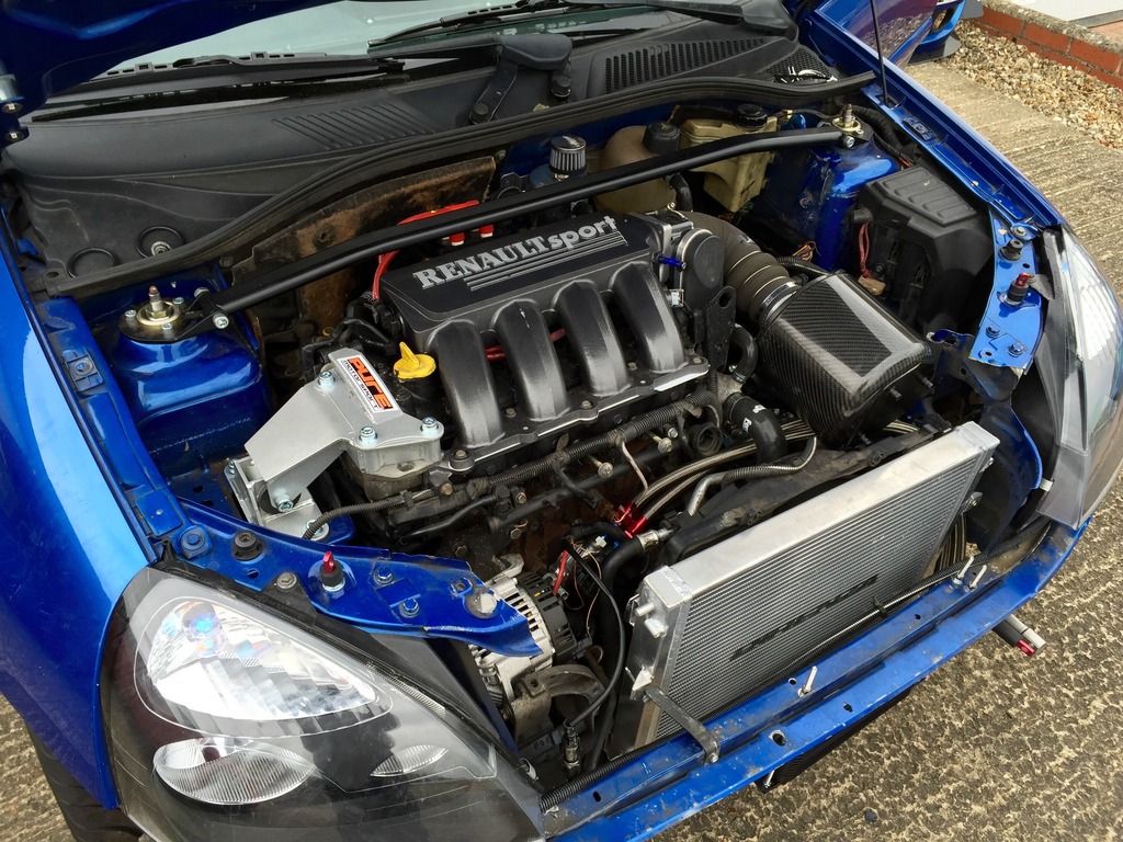

The clio specific rads run with the oe fan and mounts

You got any photos of what you did to yours with it off the car?

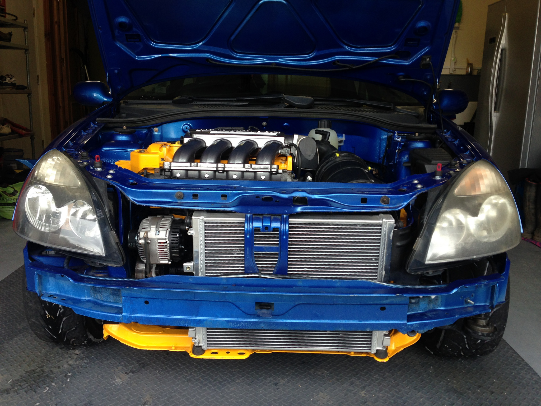

Is the Golf one a bigger core, or it it just a case of it being shorter
None off the car, but I'm getting one done for @Martin. that will be ready this week.
Golf rad is same width as the clio one but not as tall. It's a 40mm thick core though, but so is the clio specific one. Golf rad is ideal if your considering itbs or rs2 xtra at some point in the future.
Standard fan fits perfect mate, as does the rad itself.
