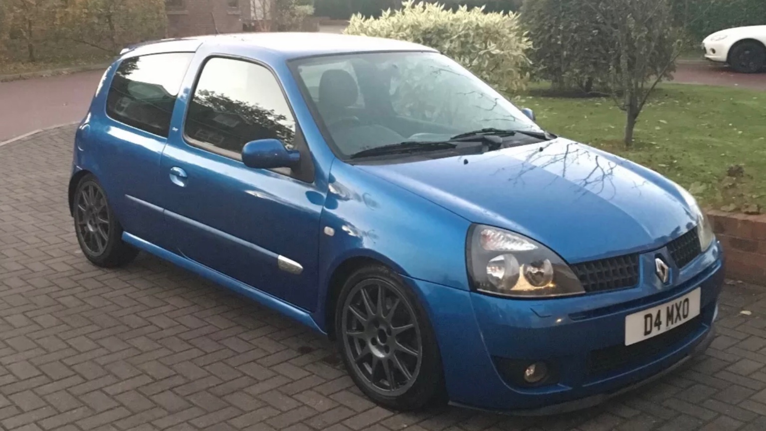

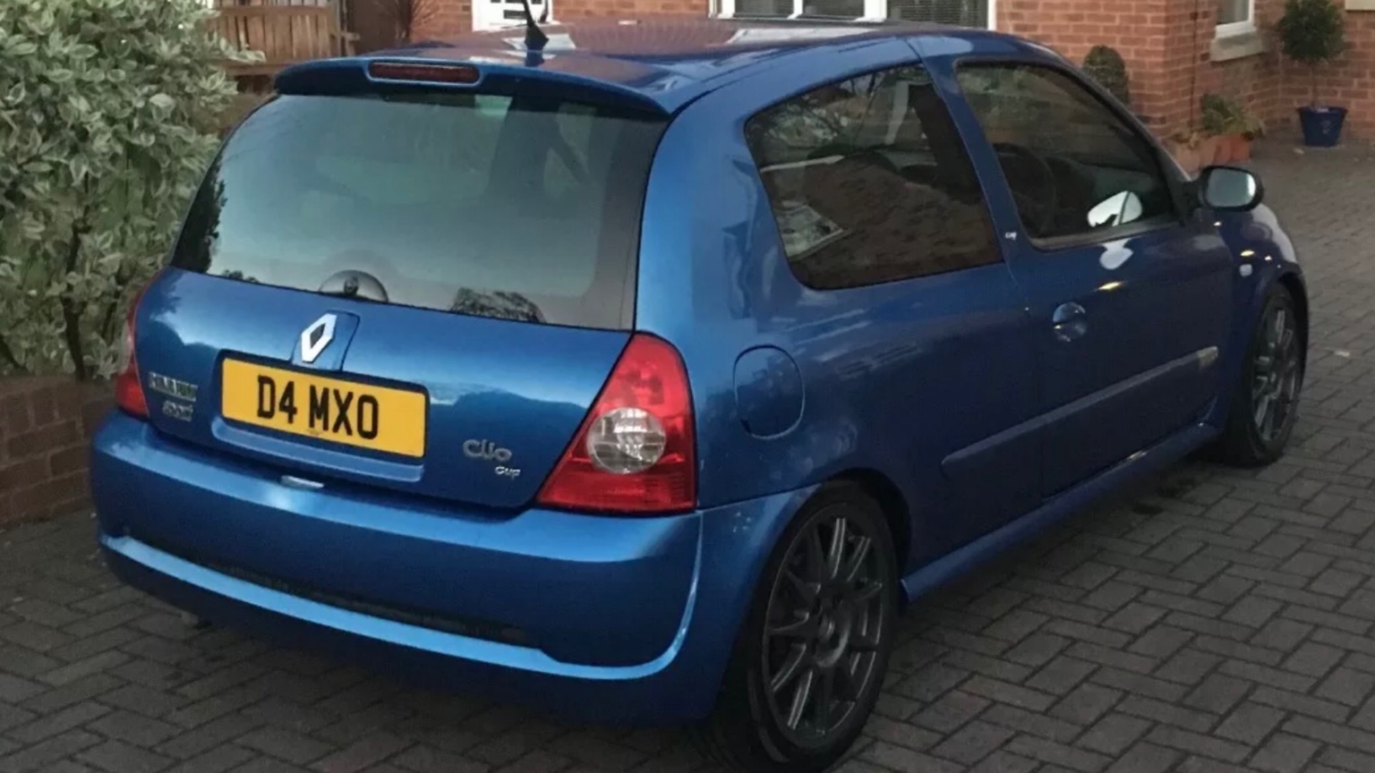

Now just found this on eBay. Going to collect on Saturday so will update with better pics once collected. Picking up from the North East if anyone recognises it.
Can't wait to get back in a clio, been driving round in a mk1 Leon Cupra which is an ok car just far too boring and far too refined for me haha.

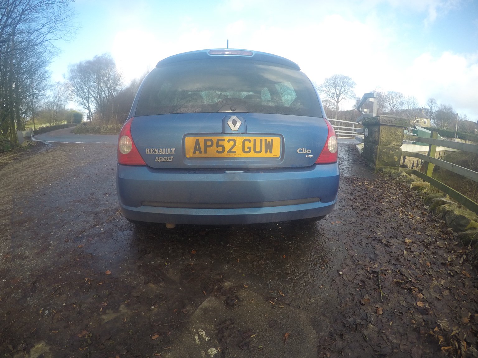

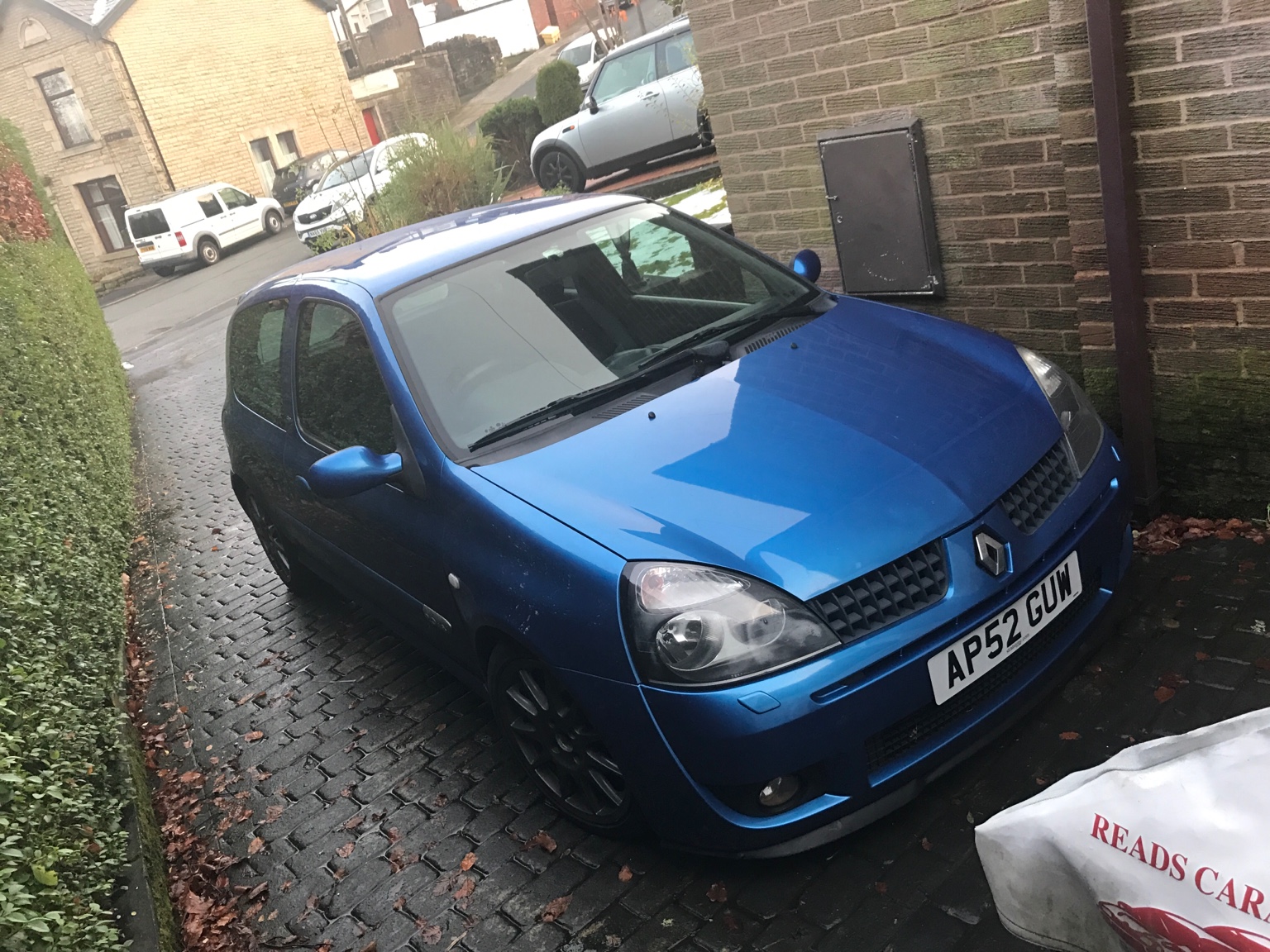

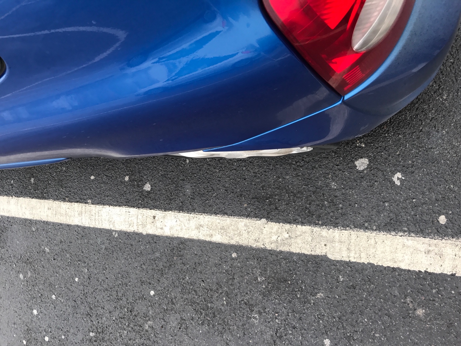

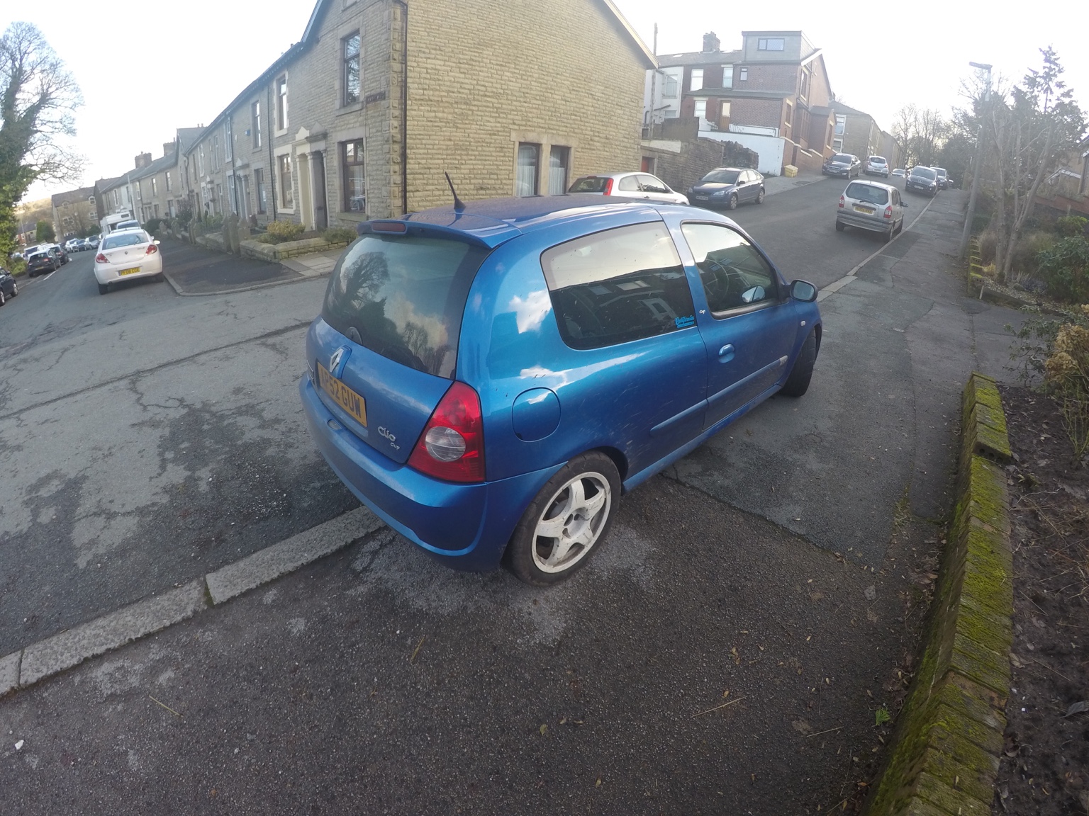

It's arrived, epic little car despite a few niggles but all easy stuff.
Desperately needs engine mounts, has purple bushes on the dog bone however so that's not bad. Gunna get the power flex upper engine mount insert I think. Also in major need of tyres, budgets are a big no no with these cars and it's all over the place ATM so they need changing asap
Nice Cupra R splitter on bumper, never been keen on them but this has had the middle fins chopped down so doesn't sag in the middle.
Coilovers are unknown, green springs on rear and red springs on front so who knows, if they need changing they'll get changed but it drives fairly nice but due to tyres & engine mounts not given it grief yet.
Exhaust is a KTEC resonated stealth system which I quite like, with the sounds of it the cat has been hollowed out but I'm fitting a 182 manifold soon so that's irrelevant.

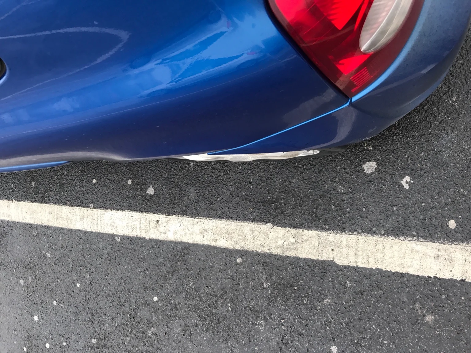

Few little dints around bodywork but not bothered about that.
Will update with some proper pics soon.

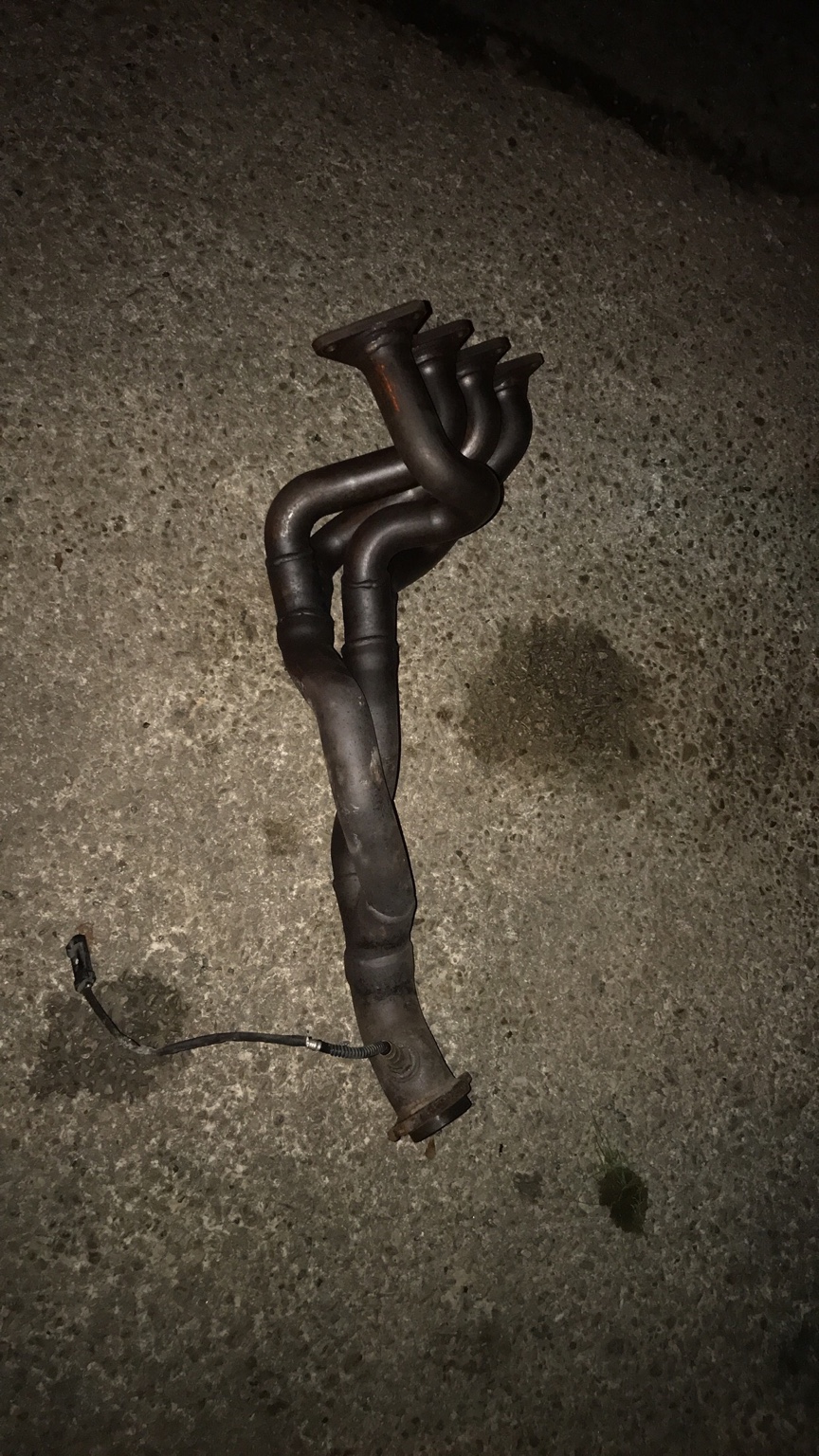

Just need to fit it now and fab up a link pipe
Anyone know what length that I'll need ?
I know they don't add 10bhp bla bla bla but u love the sound of the 182 mani with a decat and it's something I've always wanted to do with my previous 172s so it's getting done [emoji108]

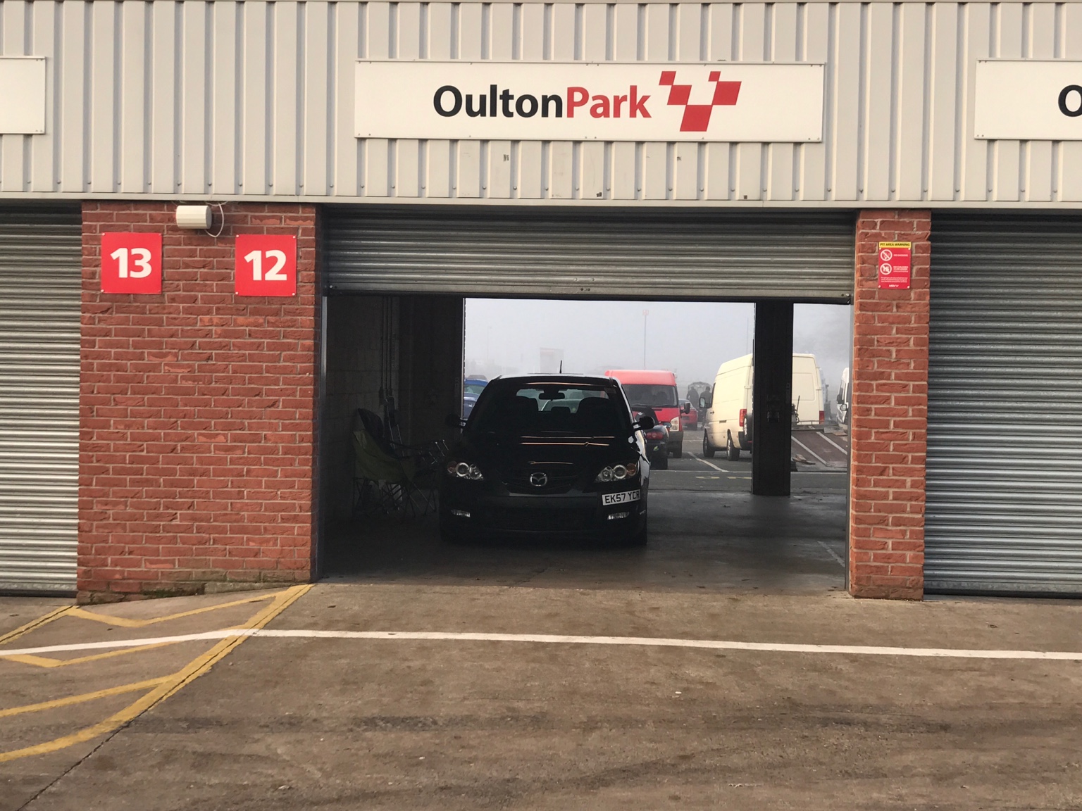

Was meant to be out last week in a friends car at Oulton but we got cancelled due to fog so next time I'm out will either be for a little blast at 3 sisters next week or I will wait till new year and book at Oulton Park again.

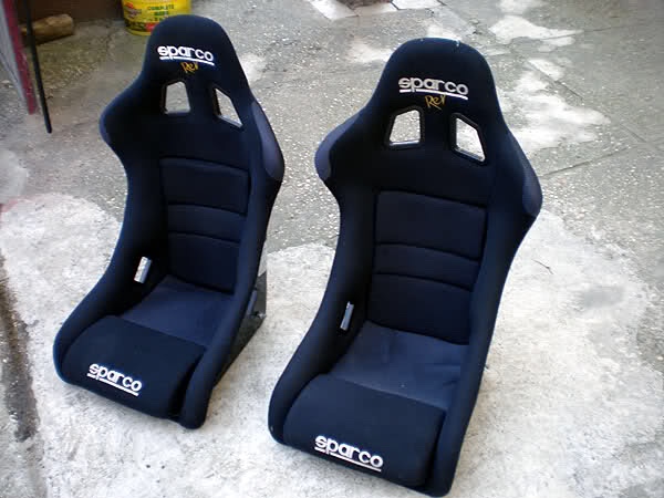

Beginning to get a Parts pile mounting up now, need to start fitting bits lol. Just need to get some X-Low seat frames off Jon-Foz but I've already messaged him will be new year now I'm thinking or late December.
Only google image now of the seats as they're in a friends rally car but they're out of date for stage rallying now but still perfect for track days [emoji108]

Nice update bud , what do they do at oulton when they cancel due to fog do you get a refund or not
Yeah bud luckily they've just credited our accounts with 100% refund so just gunna use money to book one February now most likely, give me time to get seats in and manifold on, and hopefully get some better discs and pads on front [emoji108]

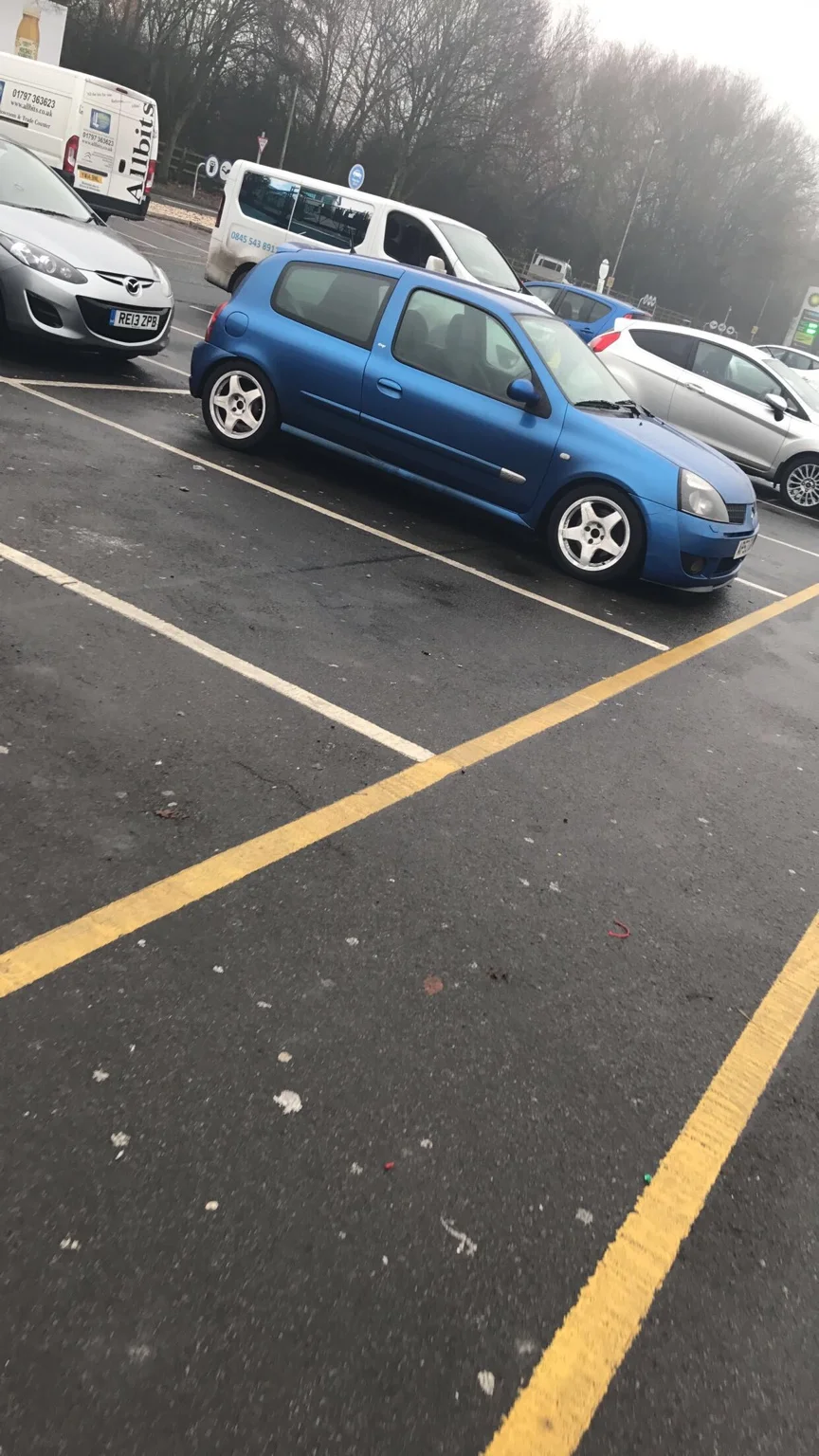

New wheels
Cheers to @DuckHunt
Team Dynamics Pro Race 3
In white (not 100% keen ATM)
15"x7j ET35 - sit really well
Giti Compete 195/50 Semi Slicks
Sorry for the dirty services pics but car isn't getting cleaned for a while can't be bothered in winter..

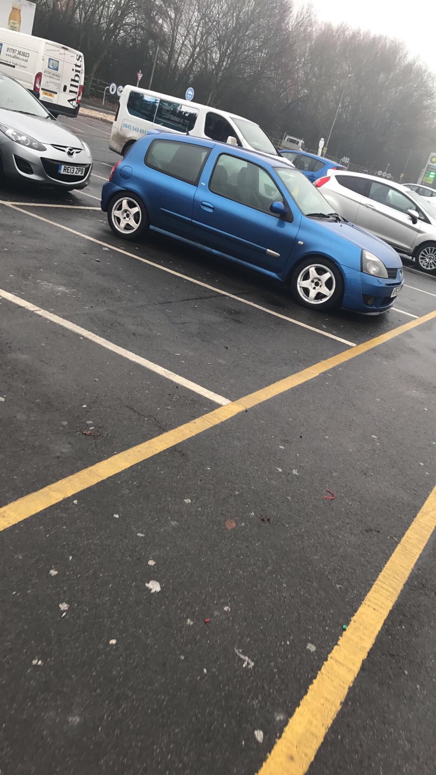

Took the car to 3 sisters today, only a small local karting track nothing major.
Tbh it surprised me a lot thought it was going to be rubbish but it was flying most of the day, on my last session passed a 197 with unusual ease and then was slowly gaining on a meg250 until I had an issue with the power steering pump, but hopefully a new(used) pump with new fluid and new aux belt should solve this, as I think I've boiled the fluid. Will update with pics soon as the cameraman said he got a few good ones, unfortunately a friend in an mx5 span off in front of me so the car is covered in mud lol

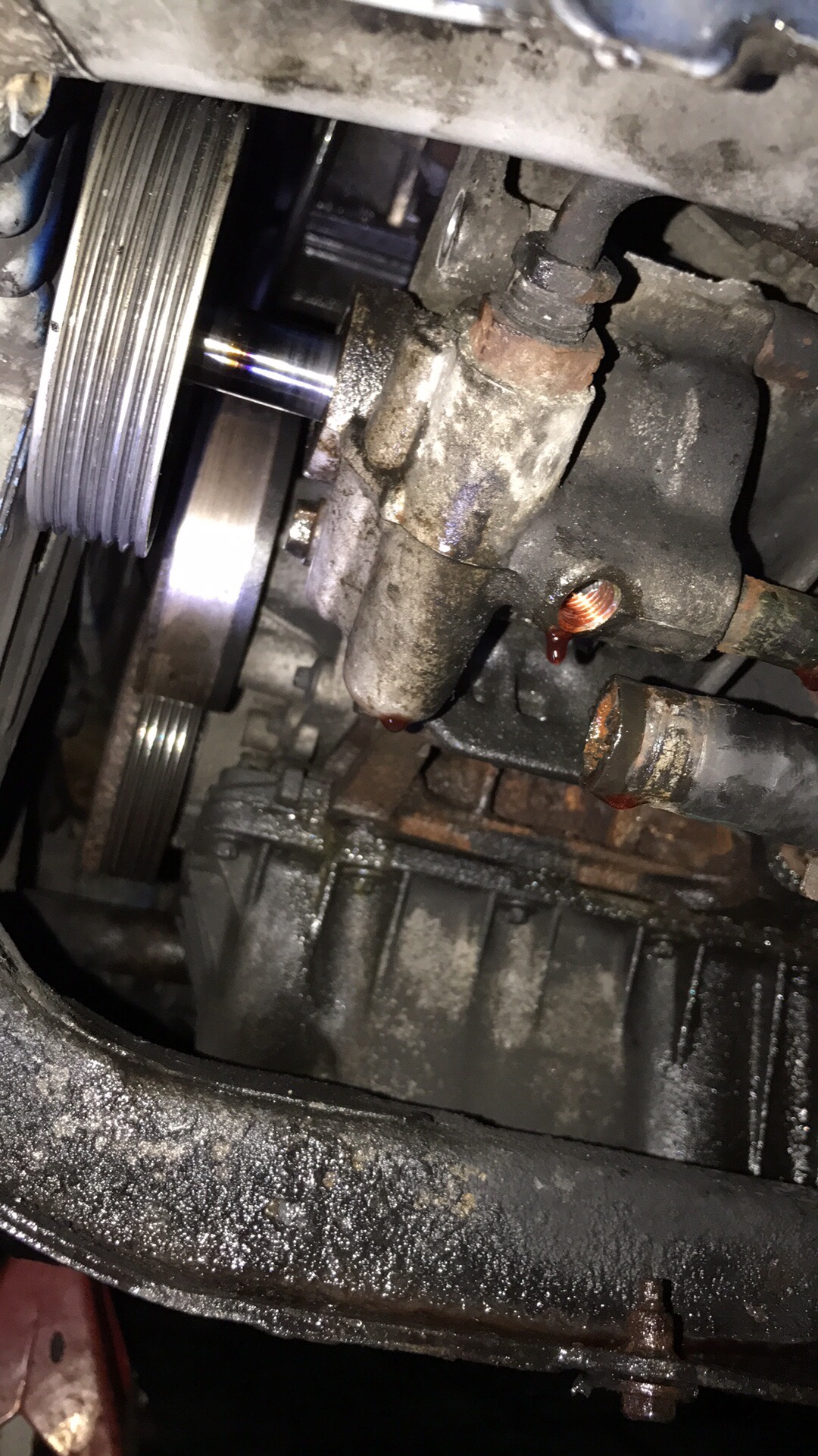

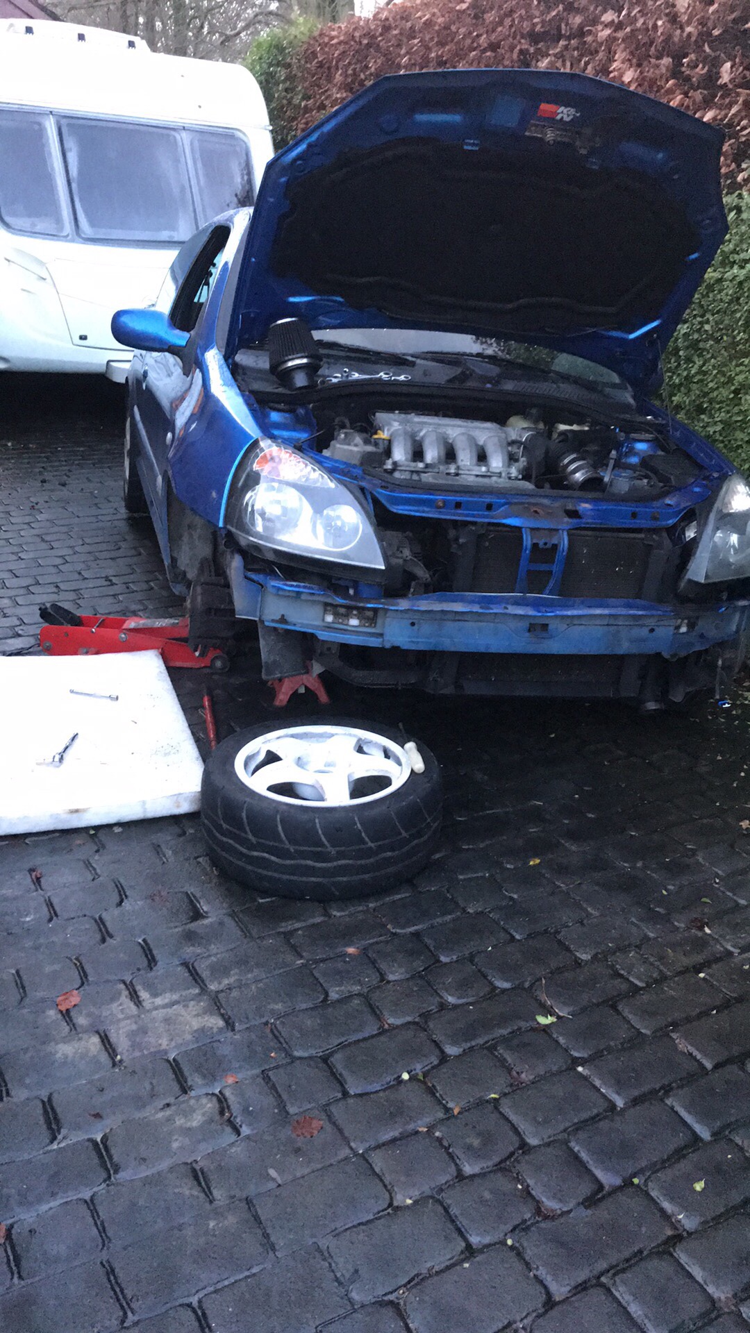

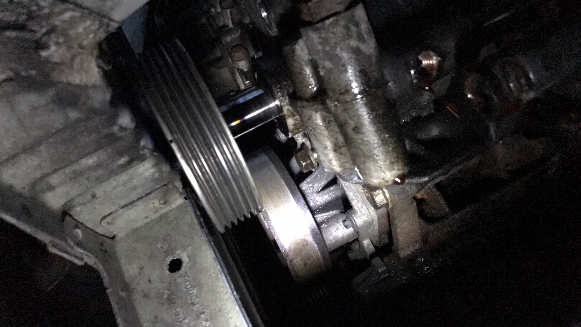

So today's job, no modifying unfortunately but job that was needed to get the car back usable,
Jacked it up got aux belt & alternator off and front bumper and the job was a doddle apart from some crappy pipes that didn't want to undo, bought a used PAS pump for now but will either replace with new in future or swap to EPAS
Anyhow this was the culprit..
Car back together and bled up running sweet.
Had a squeak on initial start up but that's hopefully sorted now it's fully oiled up.
All I can say is thank god I bought a cup cause looking at the aux belt set up on a sport they must be a massive job in comparison [emoji85]

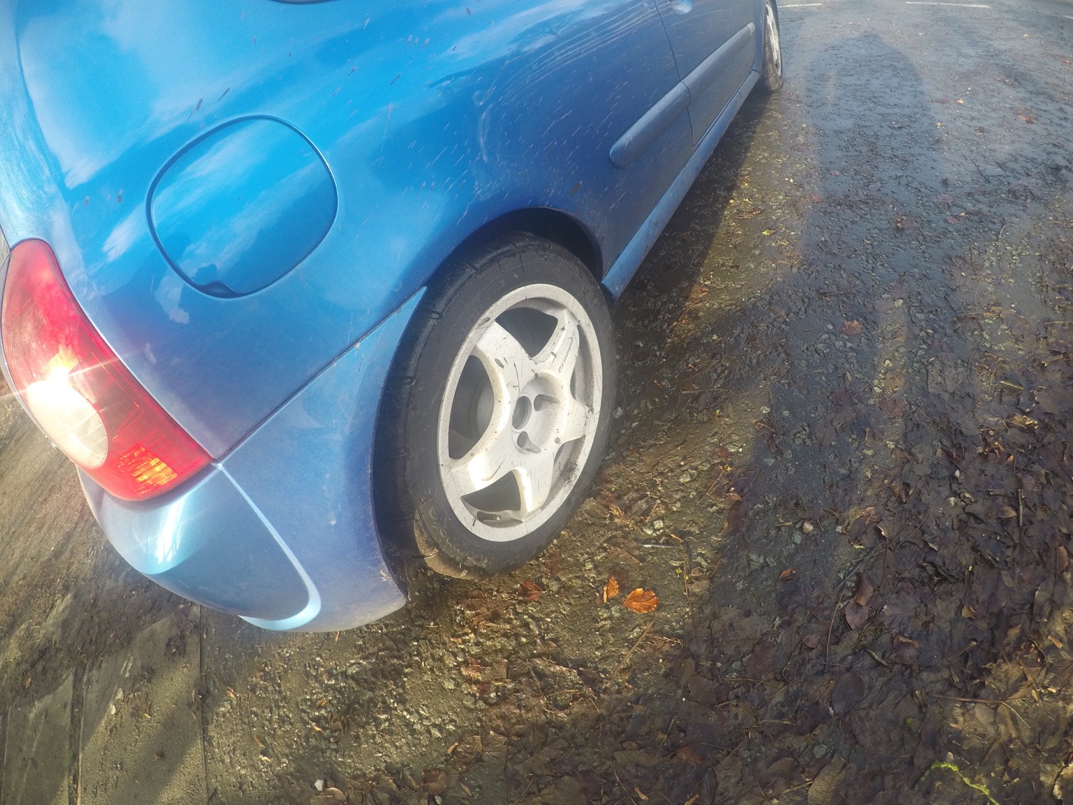

Tyres are good and even better with a little heat and get heat in them
Quick
Yeah they seem pretty decent to be fair, was a bit damp though at weekend so they took a lap or two to get warm but I was reeling in that meg250 which was on regular tyres and with it being a twisty track I was closing the gap once they were warm.

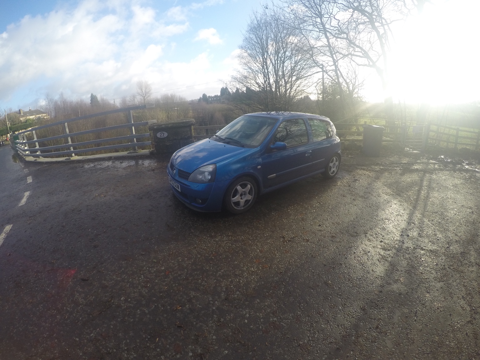

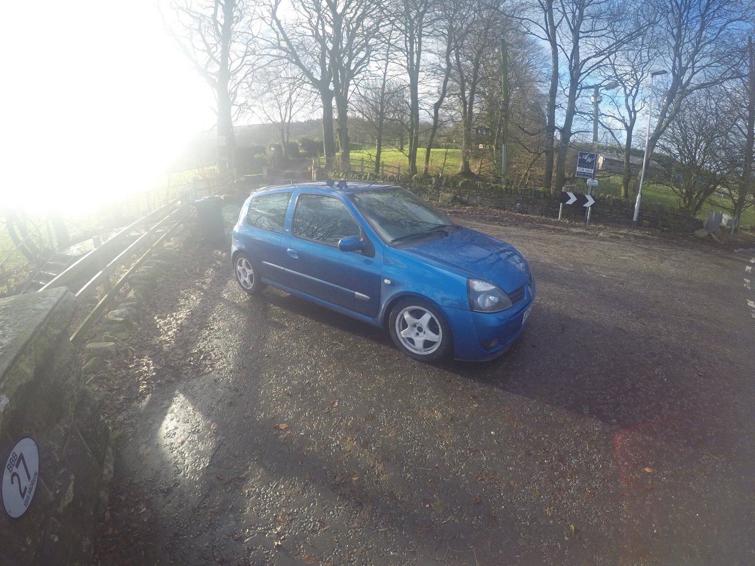

Got a go-pro for Christmas off the family so decided to go out and have a play, need to get a program on my computer to edit but love the widescreen pics it takes, also tried to grab a quick 0-60 but roads are bloody slippy today round here but had a couple of attempts
As you can see the car is filthy and unloved ATM but was trying to get it dirty enough to enter the filthy car contest but it's been too wet round here to even come close [emoji22]
Hope you all had a great Christmas [emoji106] look forward to seeing you all at shows / trackdays next year

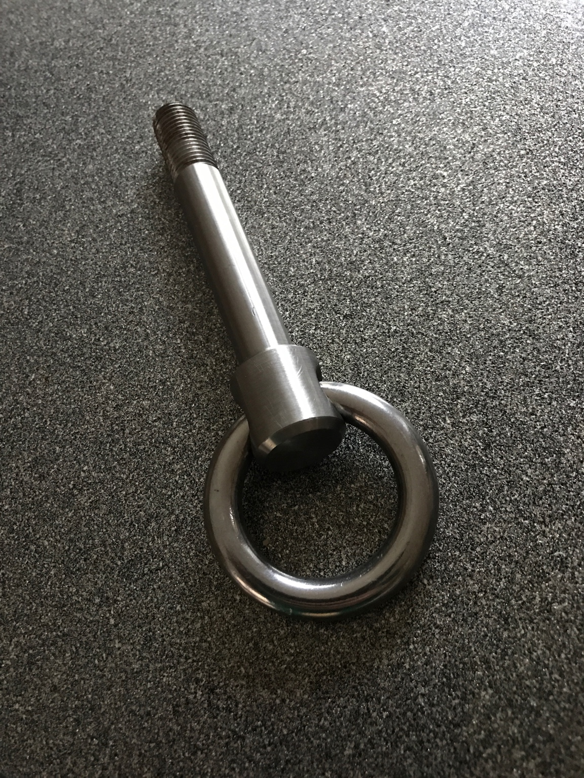

Cup Racer style URL decals fitted ... (slightly pissed but still think they look decent)
And I wonder what's just arrived in this box [emoji848]
Guess I best get me toolbox out garage haha [emoji108]

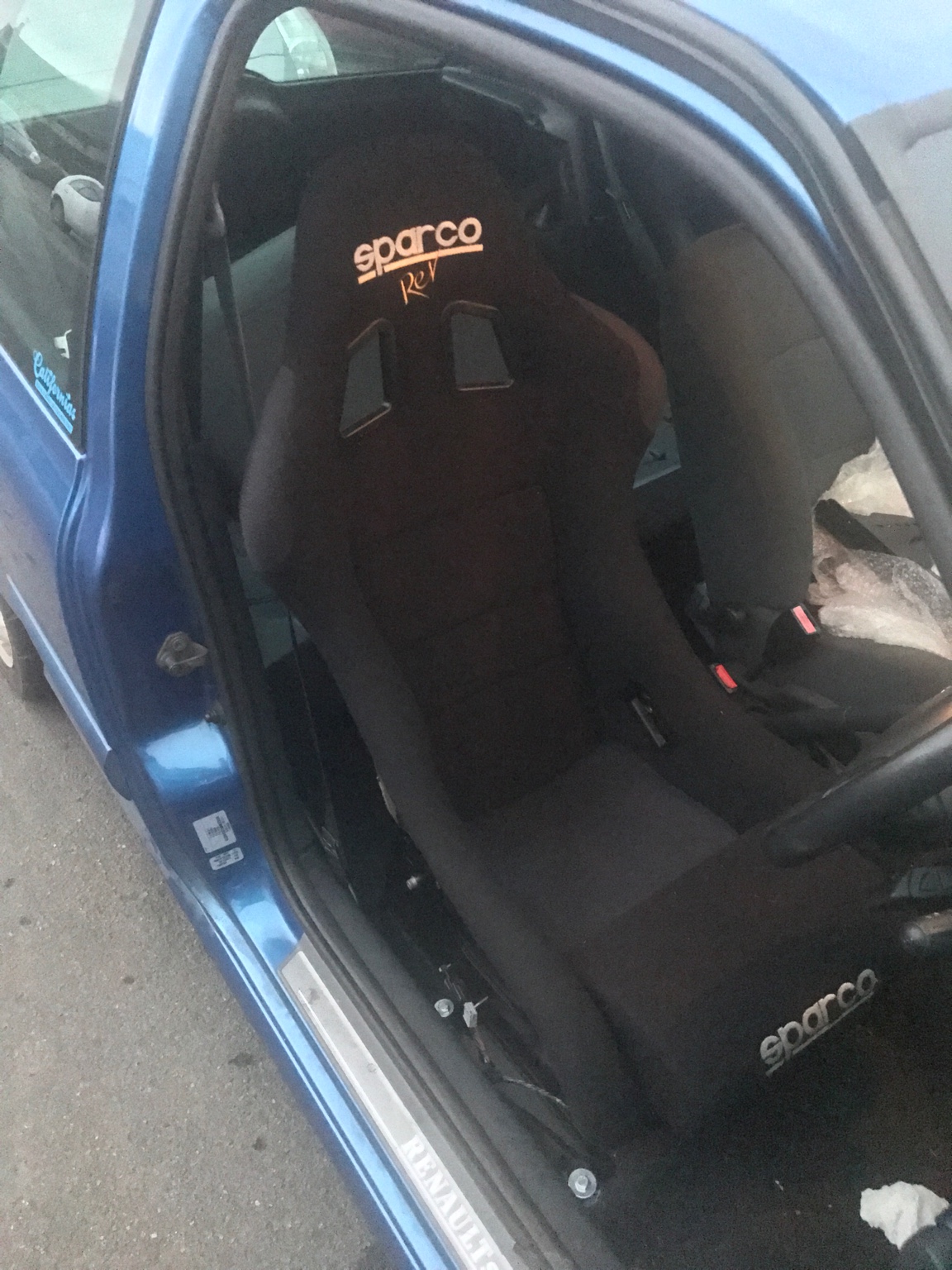

Finally progress, well lack of it, fitted the drivers seat but forgot the seatbelt buckles have pretensioners but luckily had an old mk4 golf one lying around so managed to get drivers in today, more progress tomorrow when hopefully coilovers get fit.
But wow what an improvement, feel one with the car now rather than sat on top of it lol, just need to upgrade the suspension then I can push it even harder
