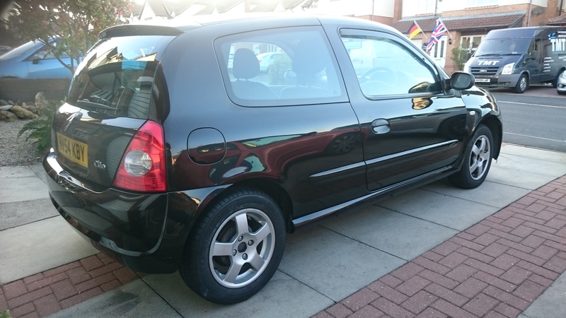

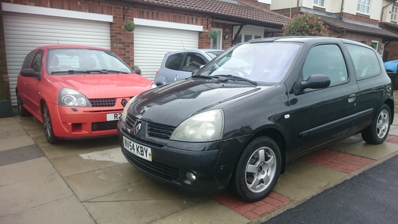

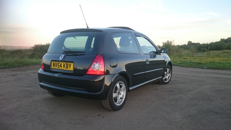

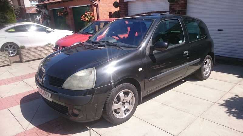

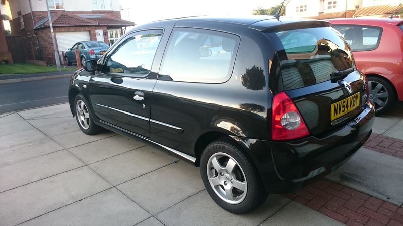

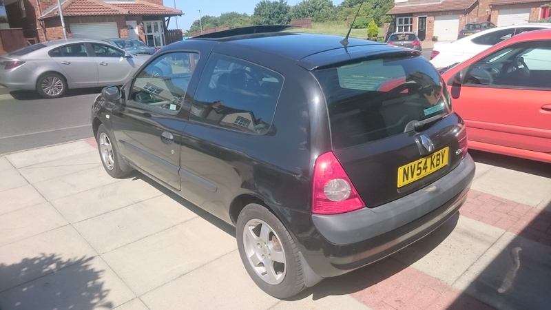

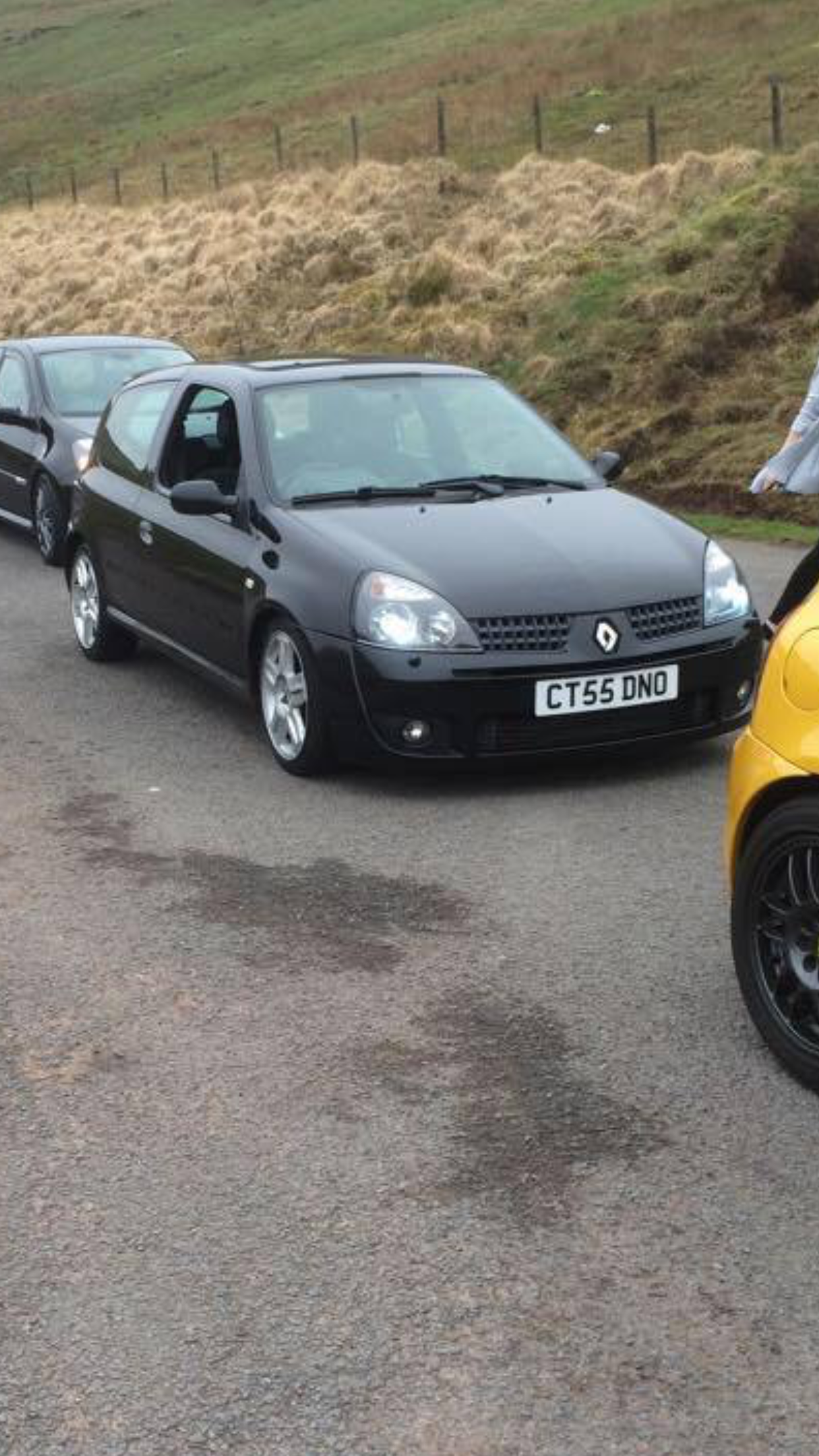

Got this for Doggy transport and as a general runaround.
Paid peanuts and upto now isn't a monkey haha
It was a Px clearance so got it dirt cheap and new it had some issues with the handbrake, noise when cornering and engine movement.
Ended up changing the drivers driveshaft as cv had gone, new handbrake cable for the drivers side and replaced the dogbone mount and all was good.
I have broken a few clios over the years so made sense to use parts kicking around to improve the DCi.

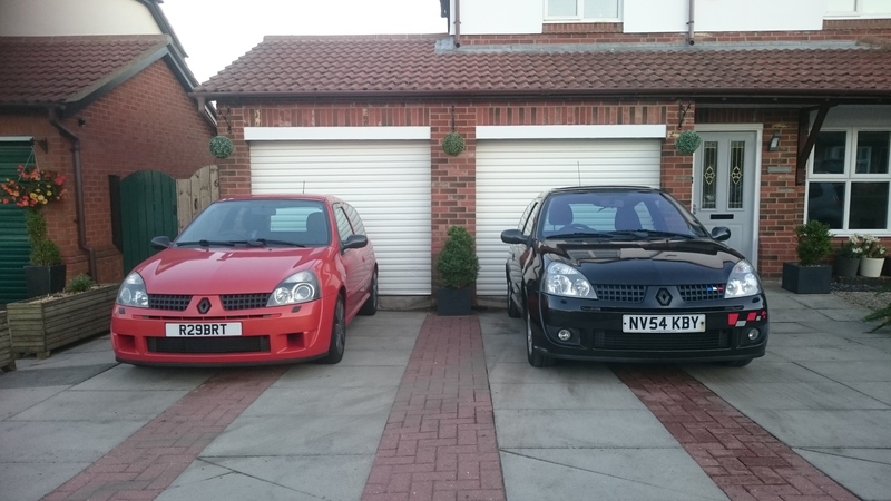

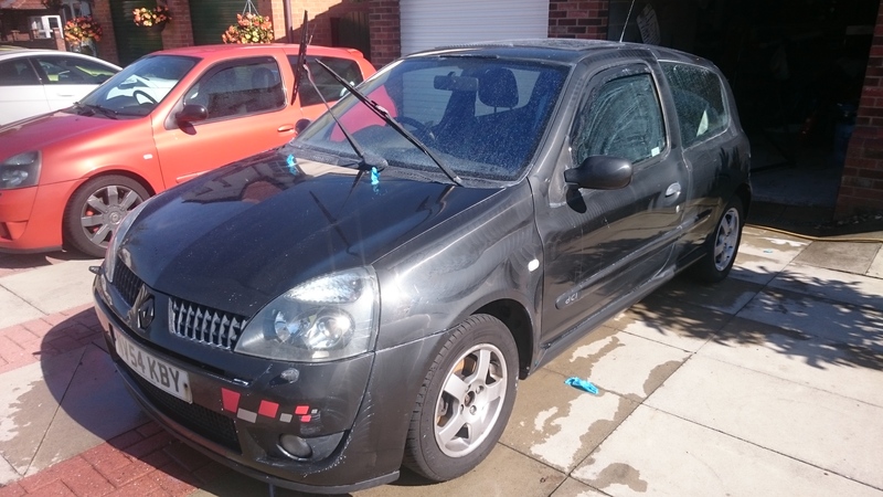

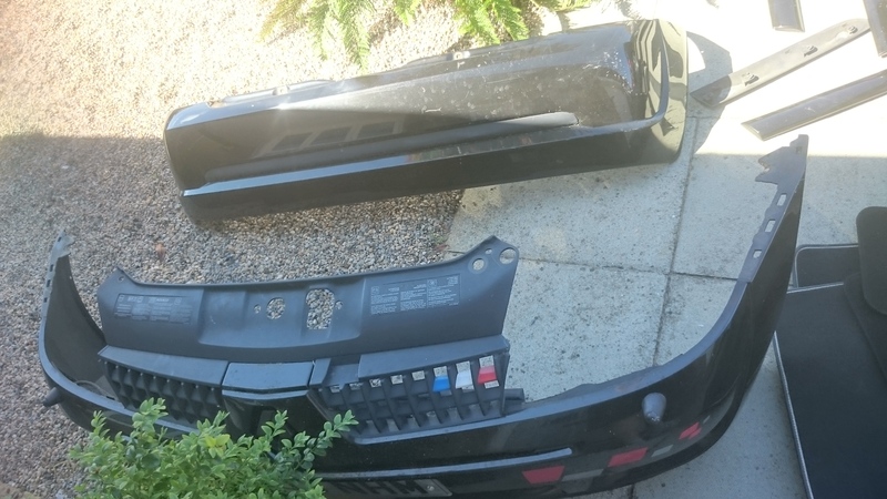

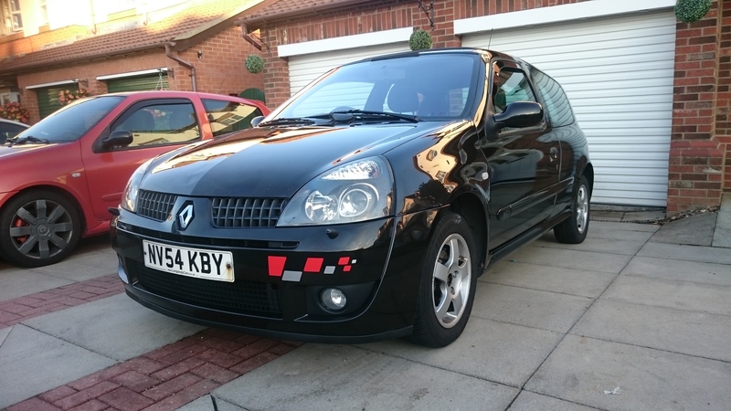

Full black 172 kit went on with Heko wind deflectors, painted bumpstrips and my spare 182 Cup headlights:
Picked up some xenons:

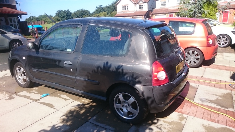

Spacers haven't arrived to fit my 16" alloys so decided to spruce up the paint.

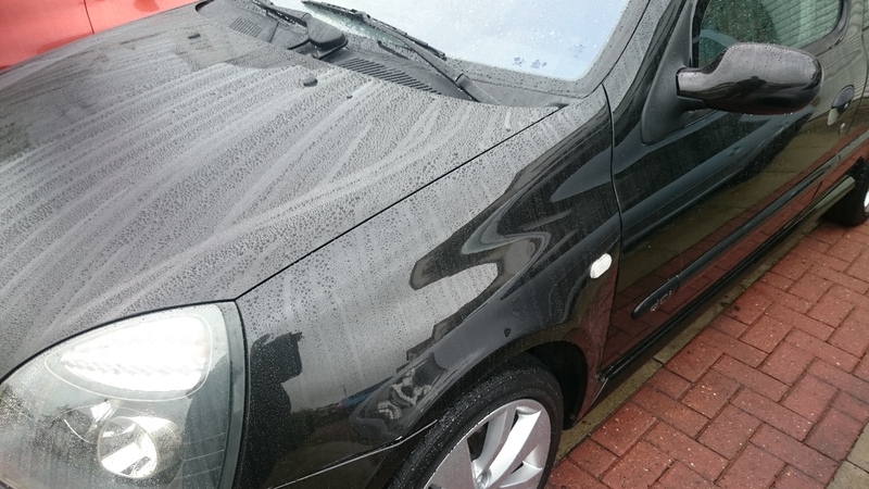

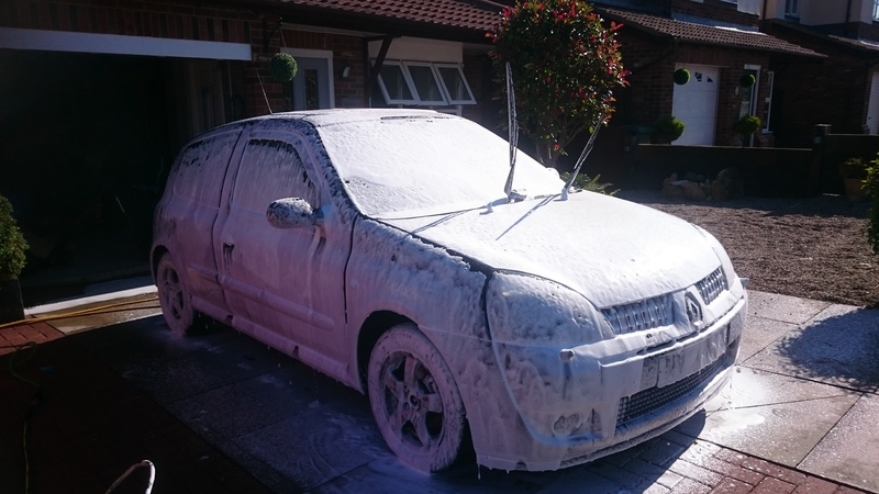

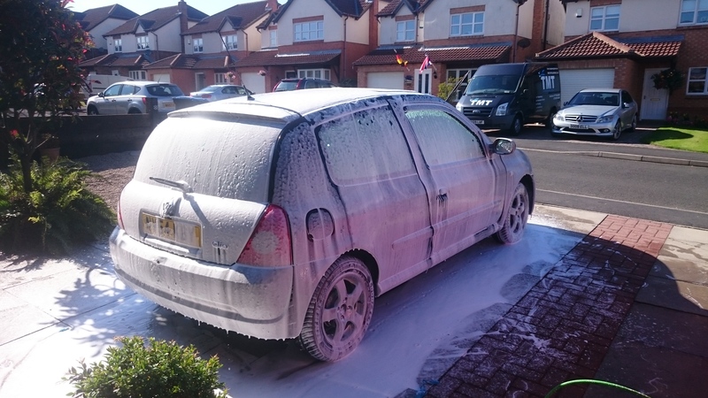

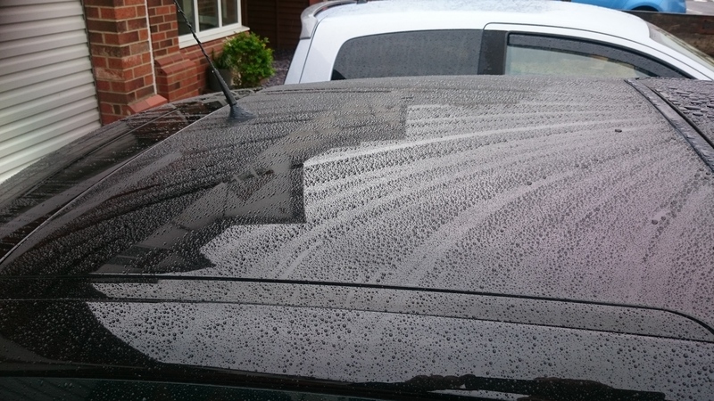

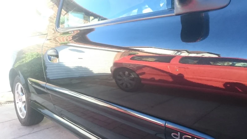

Decontaminated then 3 stage machine polish before snowfoaming, handwashing and sealing:

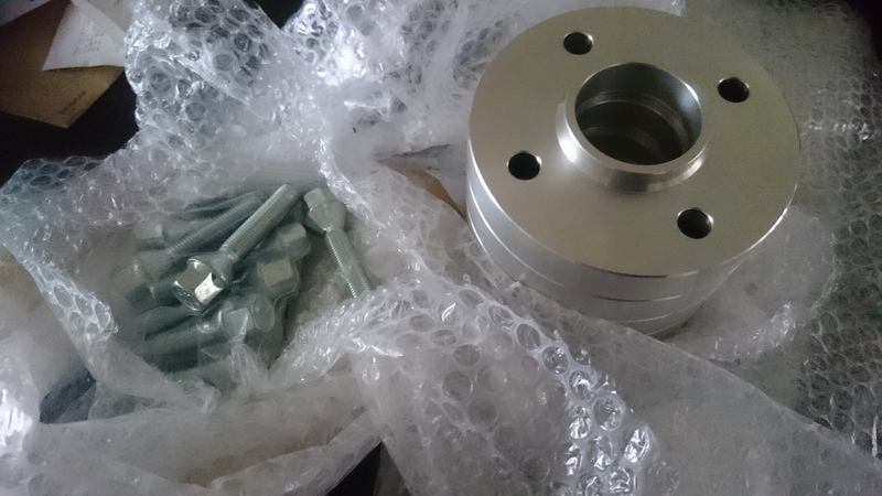

Hopefully my 2 sets of 25mm spacers turn up soon so can get shot of the tragic 14" alloys then can see what lowering springs I need.

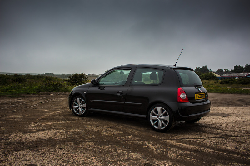

These wheels even sat inside the original arches haha
Couldn't even get the wheels to turn when offered the 16" alloys i have up.
Apparently spacers are arriving today fingers crossed so can get these alloys gone

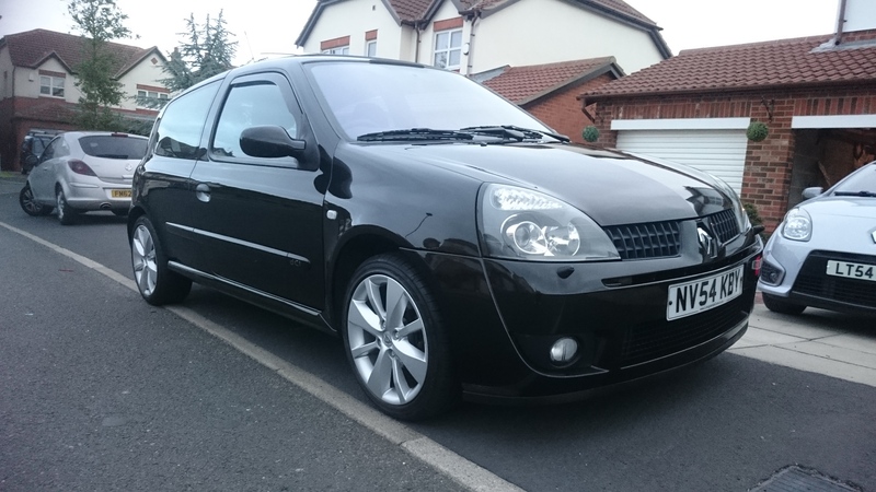

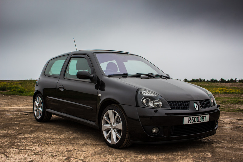

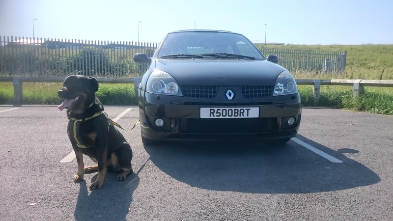

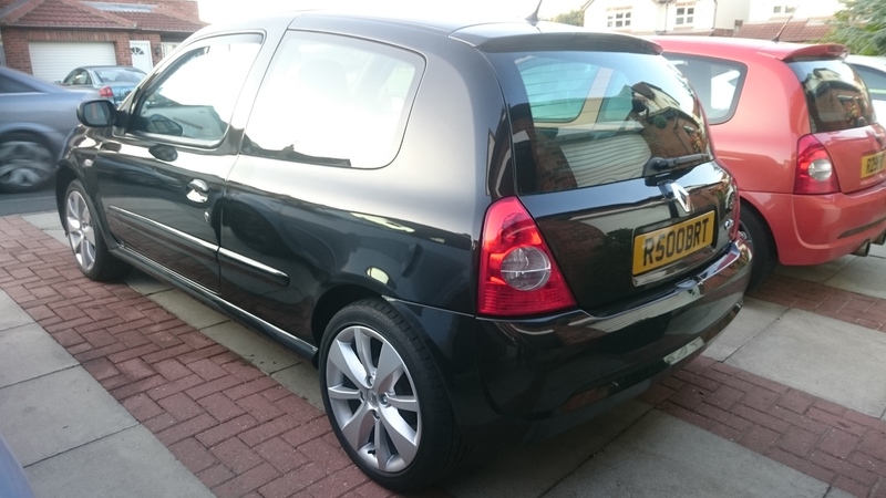

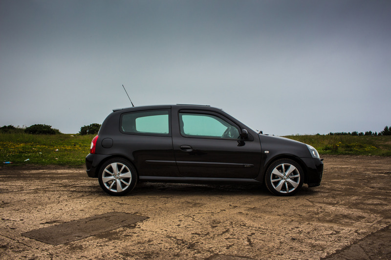

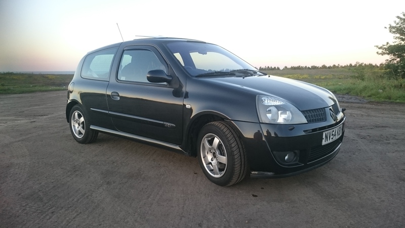

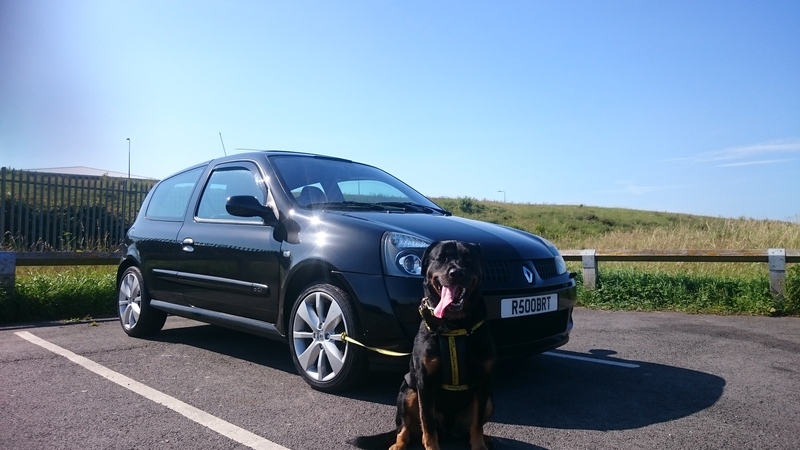

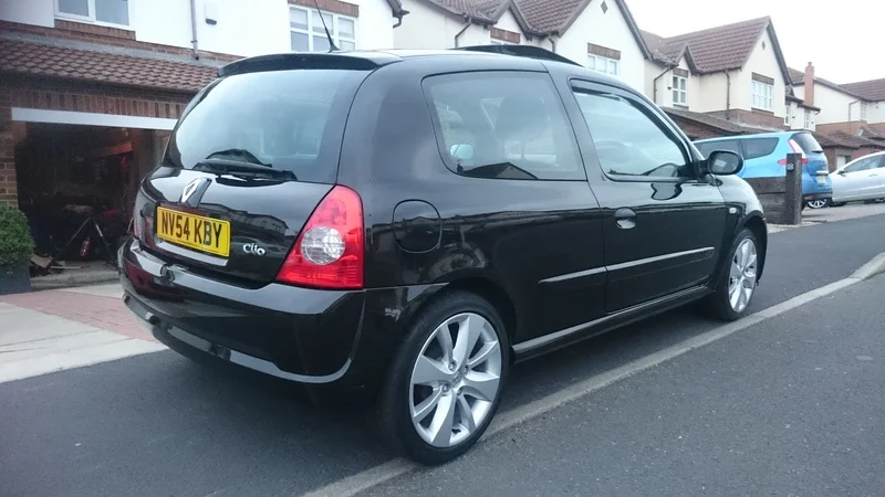

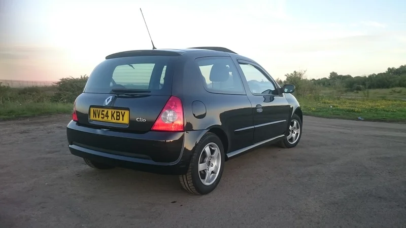

25mm spacers sorted now all round and Twingo RS alloys on as had them in the garage.
Liking it as it's different.
Lowering springs I am now trying to sort and got my logbook through for it so private plate should go on tomorrow
Not a fan of the 25mm long bolt spacers great build otherwise. Quite fancy a dci aswell.

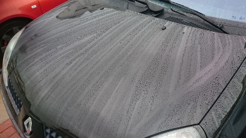

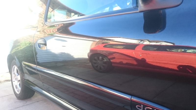

Well after the sealant was applied got superb beading:

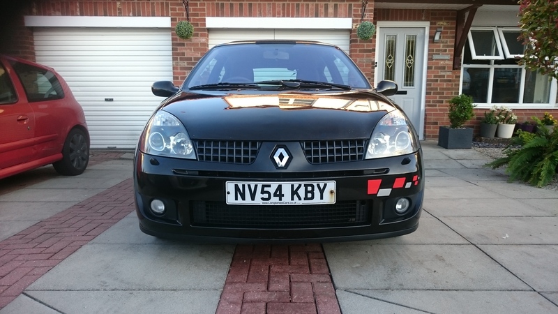

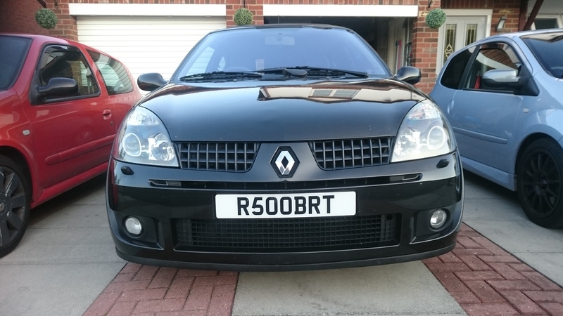

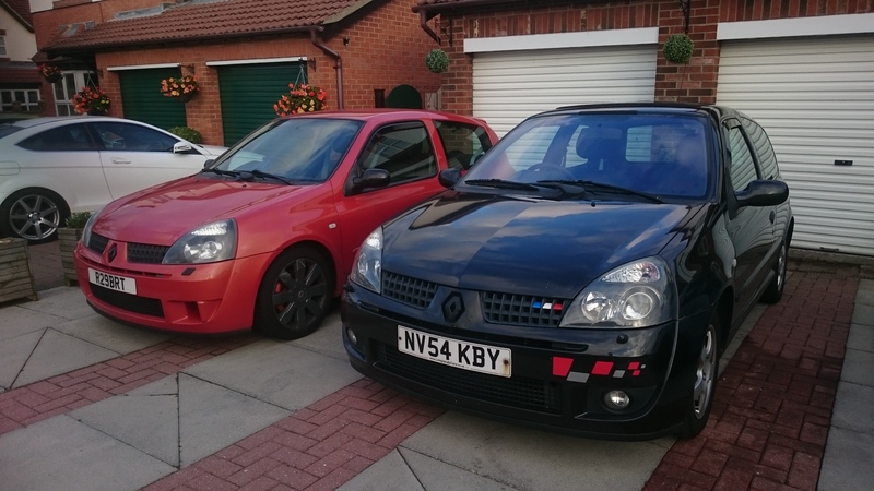

Private plate off my Scooby went on, removed the red and silver stickers off front bumper:
Tonight I also finished the colour coding with matching painted handles.

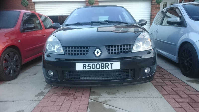

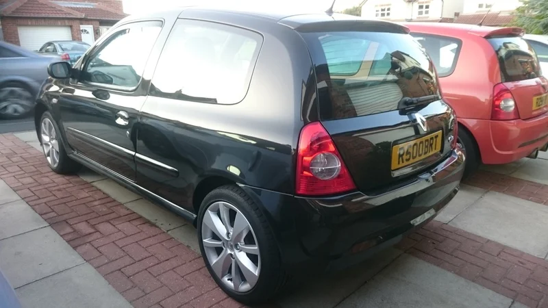

Another couple of days and another boat load of work complete.

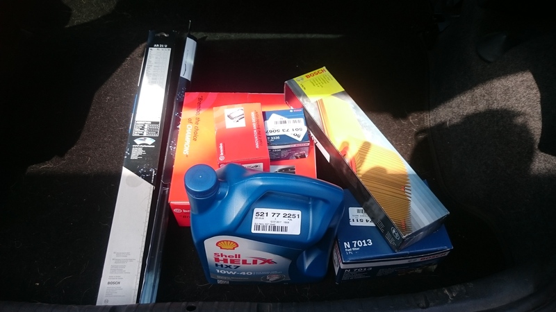

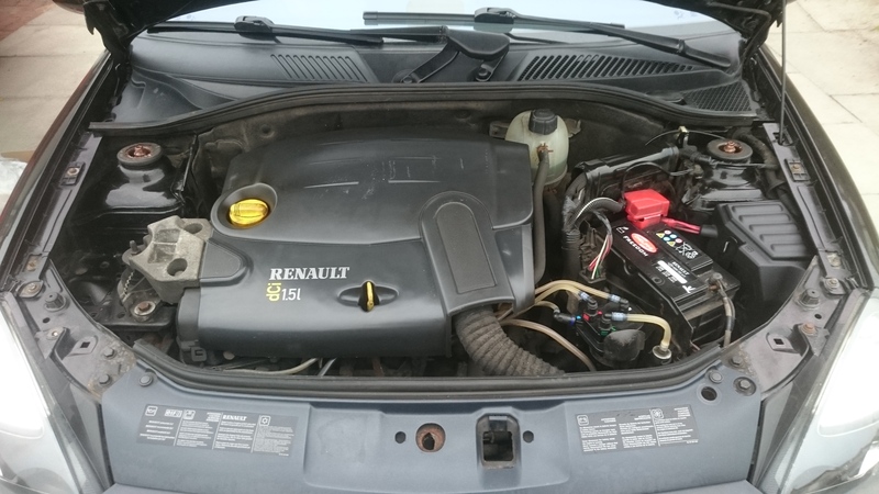

Clio has had a service - new oil, oil filter, air filter & fuel filter. Also fitted Bosch Aero wiper blades.
Then cleaned the engine bay as was showing its 145k mileage.

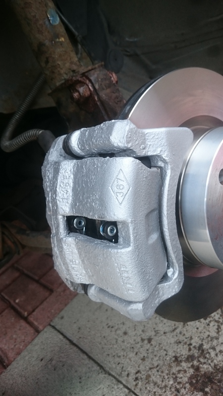

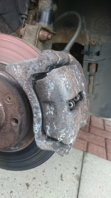

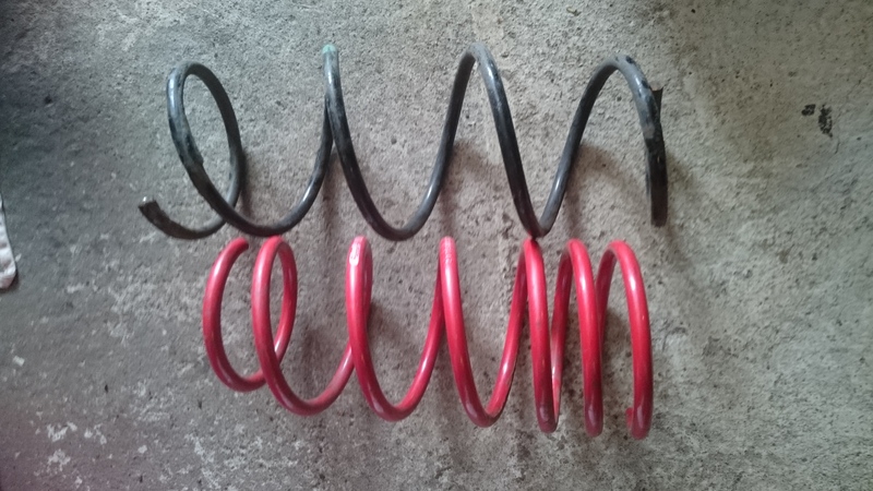

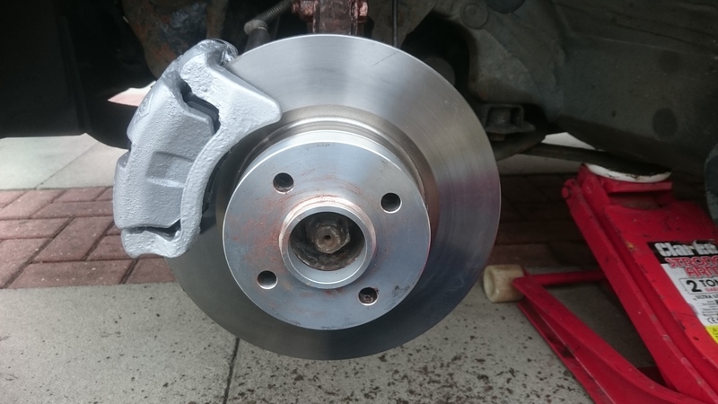

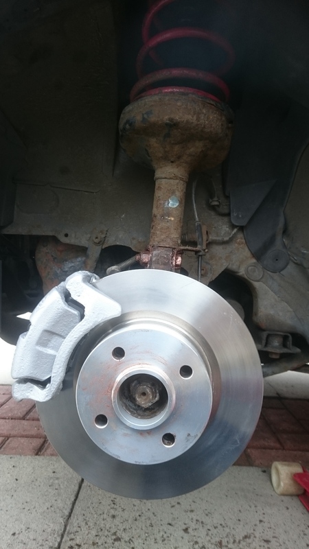

Then fitted some 172/182 Eibach Sportline springs I picked up off here and then set about the front brakes - they have been stripped cleaned and overhauled so all move nice and free and were finished in silver with new Brembo discs & pads.
Just need to sort some replacement dampers at some point. Thinking Sachs the same as I ran on the Volvo.
KNF Autotints should be sorting the rear 3 windows with a 40% tint as well sometime over the next few weeks

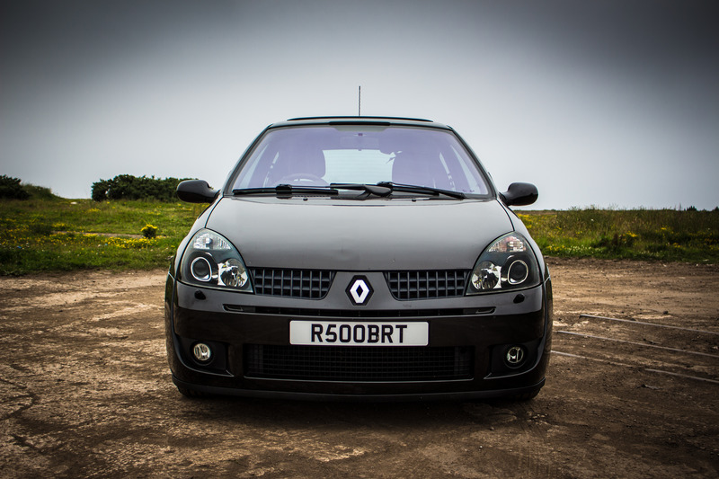

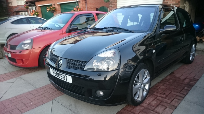

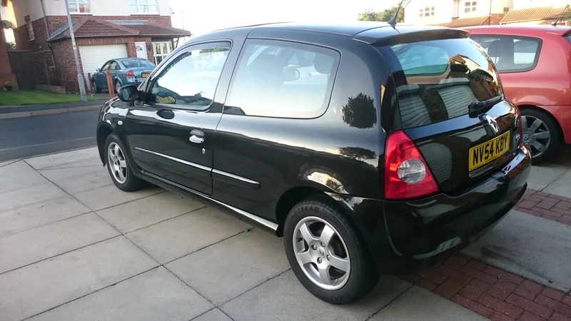

So the finished article......

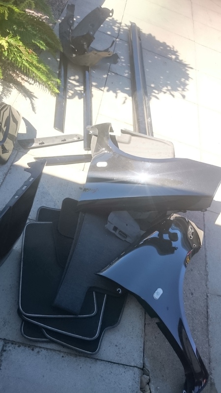

Thanks - I have flame red front wings and sideskirts in the garage if your interested? I have broken a few clios over the years so have these left over.

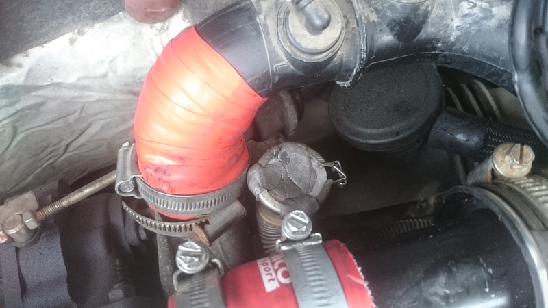

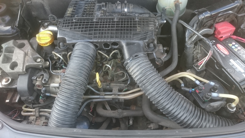

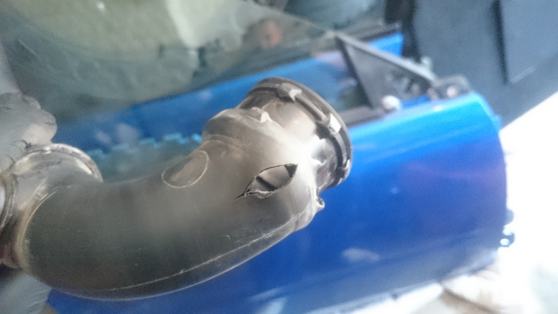

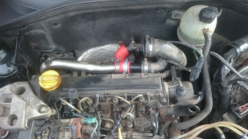

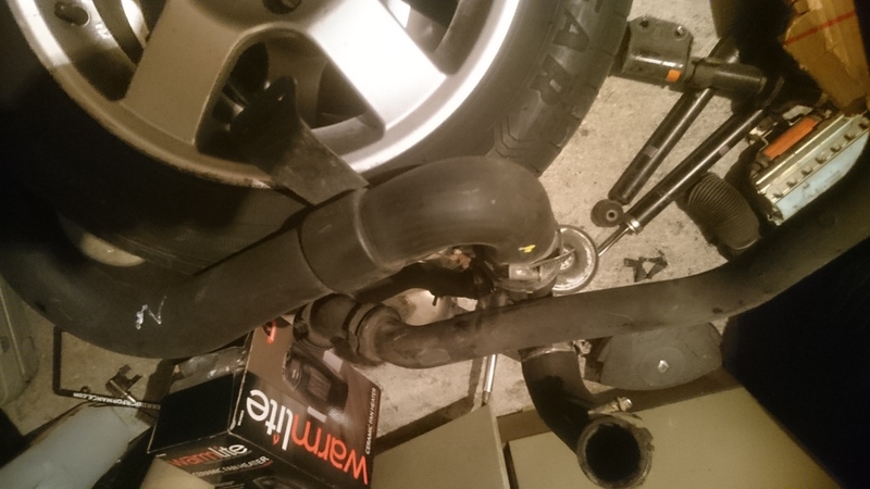

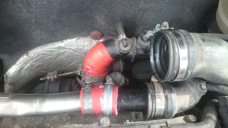

Since buying the car there was a slight whistle on throttle but it got worse until yesterday it was more steam train like.
Quickly diagnosed the turbo to inlet pipe as the cause
It has had a an amazing bodge completed with Samco self emalgamating tape and a jubilee clip.
Not buying a new one as just picked up a dci 100 intercooler and once I sort pipework it will be going on.
Also cleaned out egr and unplugged it. Will be blanking it off when doing the intercooler and also going to 80/100 injectors as well before a remap.

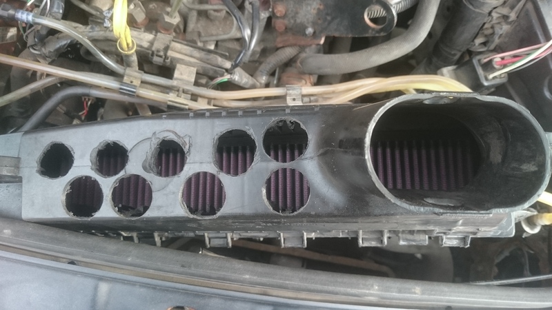

K&N panel filter ordered and will be making a straight pipe to remove the backbox then emptying out the cat as well.

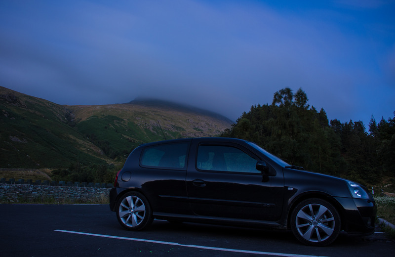

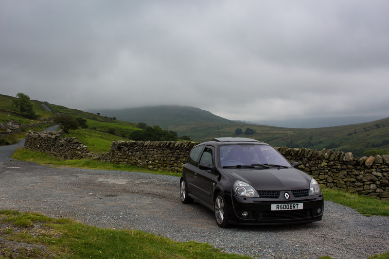

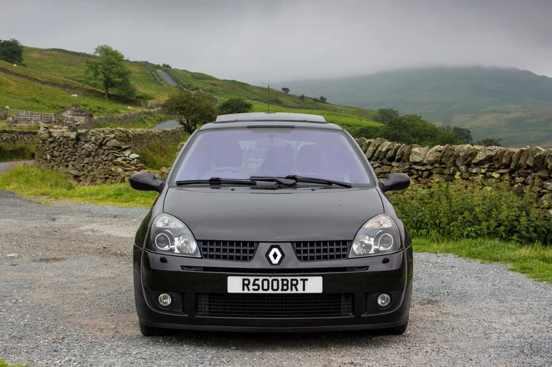

Well just got back from the first decent drive in the rep. Went to the Lakes for 3 days and only issue was lack of power but that's as I haven't had such an underpowered car since passing my test lmao.
Only other little issue is horn doesn't work intermittently haha. Gutted as my average MPG dropped from 65mpg to 62mpg due to all the banks hahaha

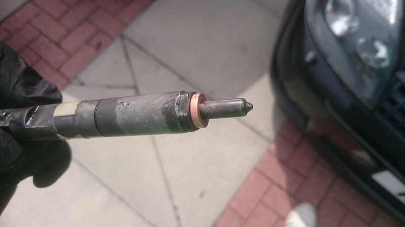

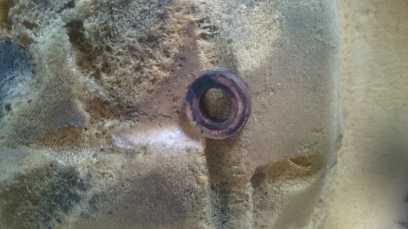

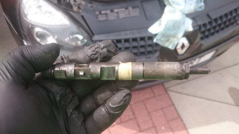

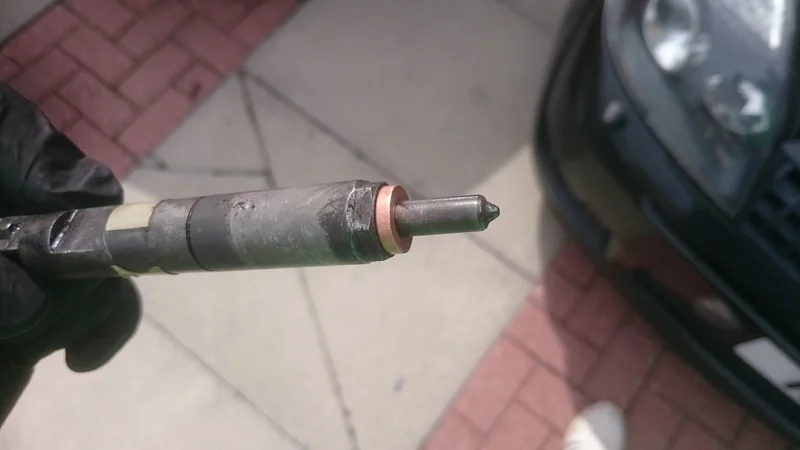

Got some new injector seals as well from Renault as 1 has a slight weep causing the usual waxy residue.
I do have intercooler pipework now on its way as well so hoping to get that on asap but the hunt for some cheap injectors goes on.

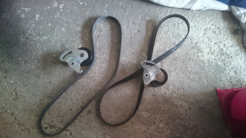

- Horn repaired - wiring was shot so swapped it out
- Injector removed and copper washer replaced as had a weap
- Aux belt & tensioner replaced

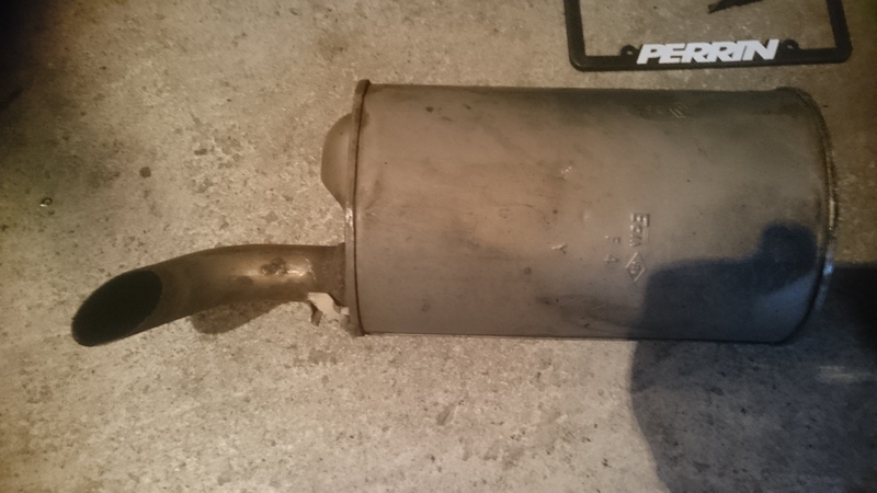

- Backbox chopped off
- K&N panel filter fitted & airbox drilled

Still searching for 80 or 100 injectors so until some come up it will be intercooler going on then waiting for them

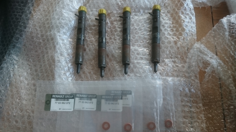

Well got some injectors last night so are on there way to me.

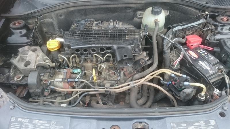

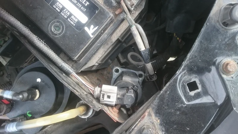

Today I decided to do a DIY egr complete removal and it's worked beautifully.....
Valve for egr is now in battery area connected up so ecu doesn't through a hissy fit.
The egr mixer chamber is gone and replaced with a straight pipe and samco coupler.
The egr feed from the exhaust manifold is blocked with a plug formed out of chemical metal and held with the original renault clip.
Also started mocking up air feeds for the Swiss cheese airbox.
Been to a local garage i know so when injectors arrive they will code them for me.

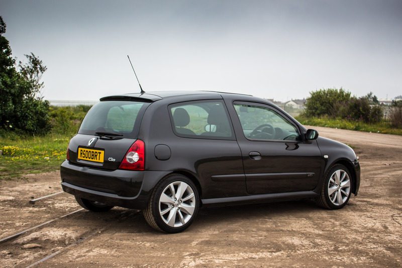

Great transformation from when you got it.
But those wheels are awful.
Definitely marmite but we're free as had them in the garage haha. Turini's will come eventually.

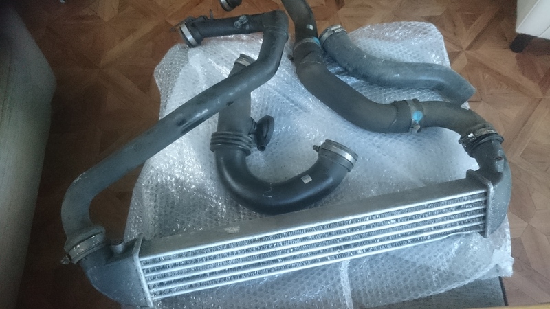

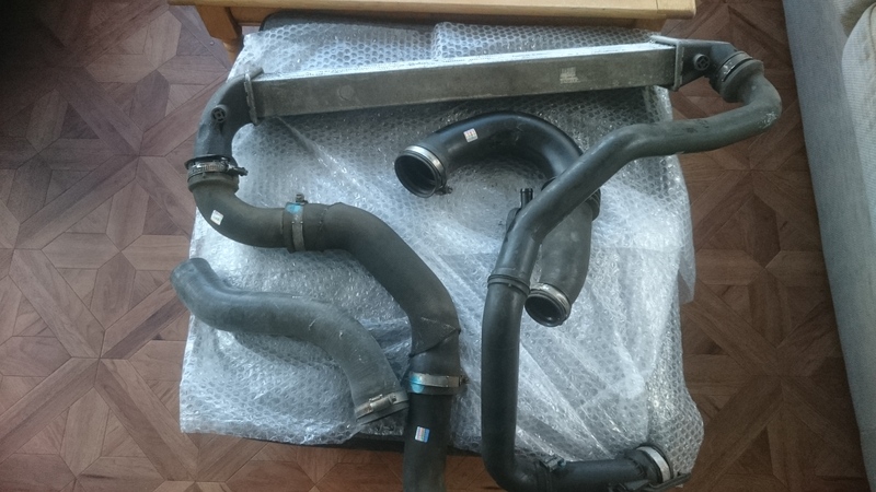

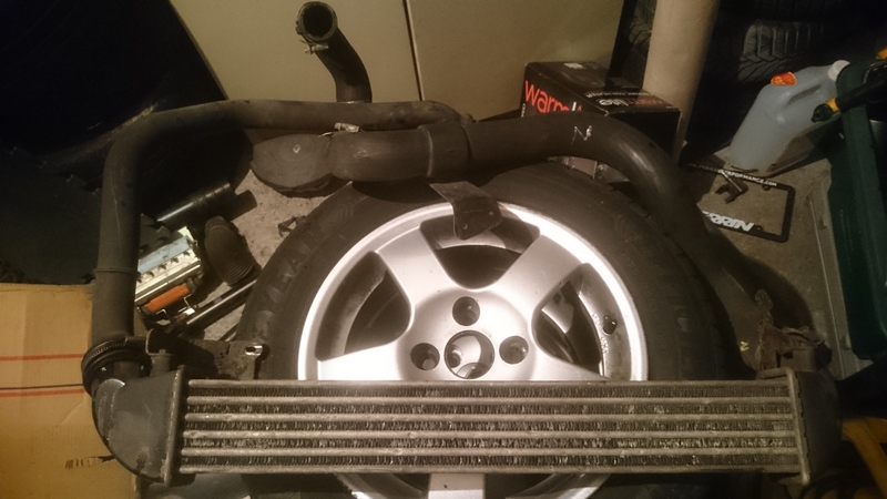

Got a stroke of luck today whilst browsing the scrapyard and found a dci 100 in the breakers. Already had been stripped of most of its nice parts.
Luckily still had the full intercooler pipework and intercooler itself so will be using this instead.
Stripped it off so have all screws, hoses, clips and brackets for a bargain price as well!

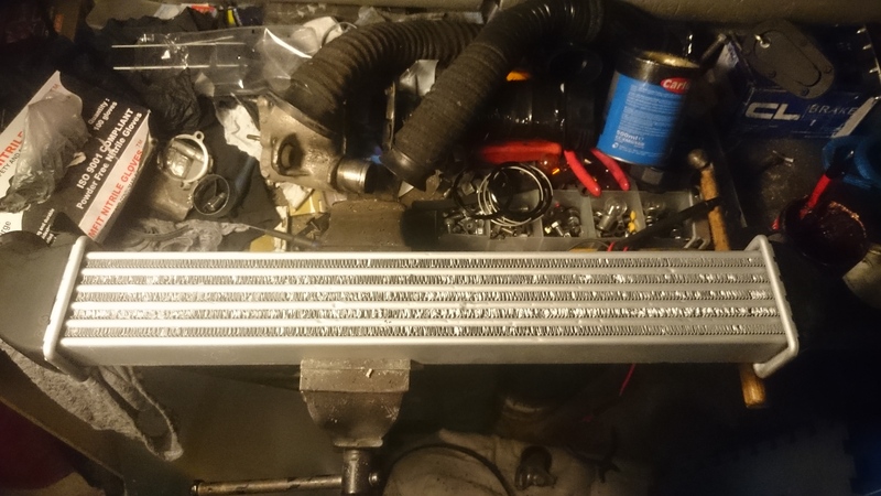

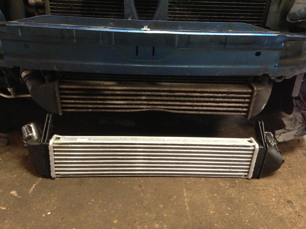

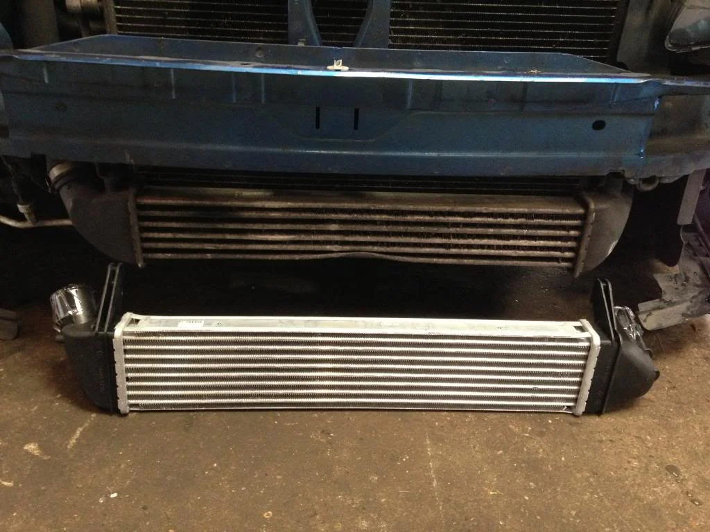

Intercooler tidied up and painted then fitted with the dci 100 pipework.
Replaced the vac lines with samco and added a t piece as only 1 take off for 100 where 65 and 80's have 2.
Brackets didn't fit so made some up and fitted it all....
Looking good on the Twingo wheels, I would try and source the Dacia intercooler instead, that's what I had for my 80, it is a direct replacement for the dci 100 unit
