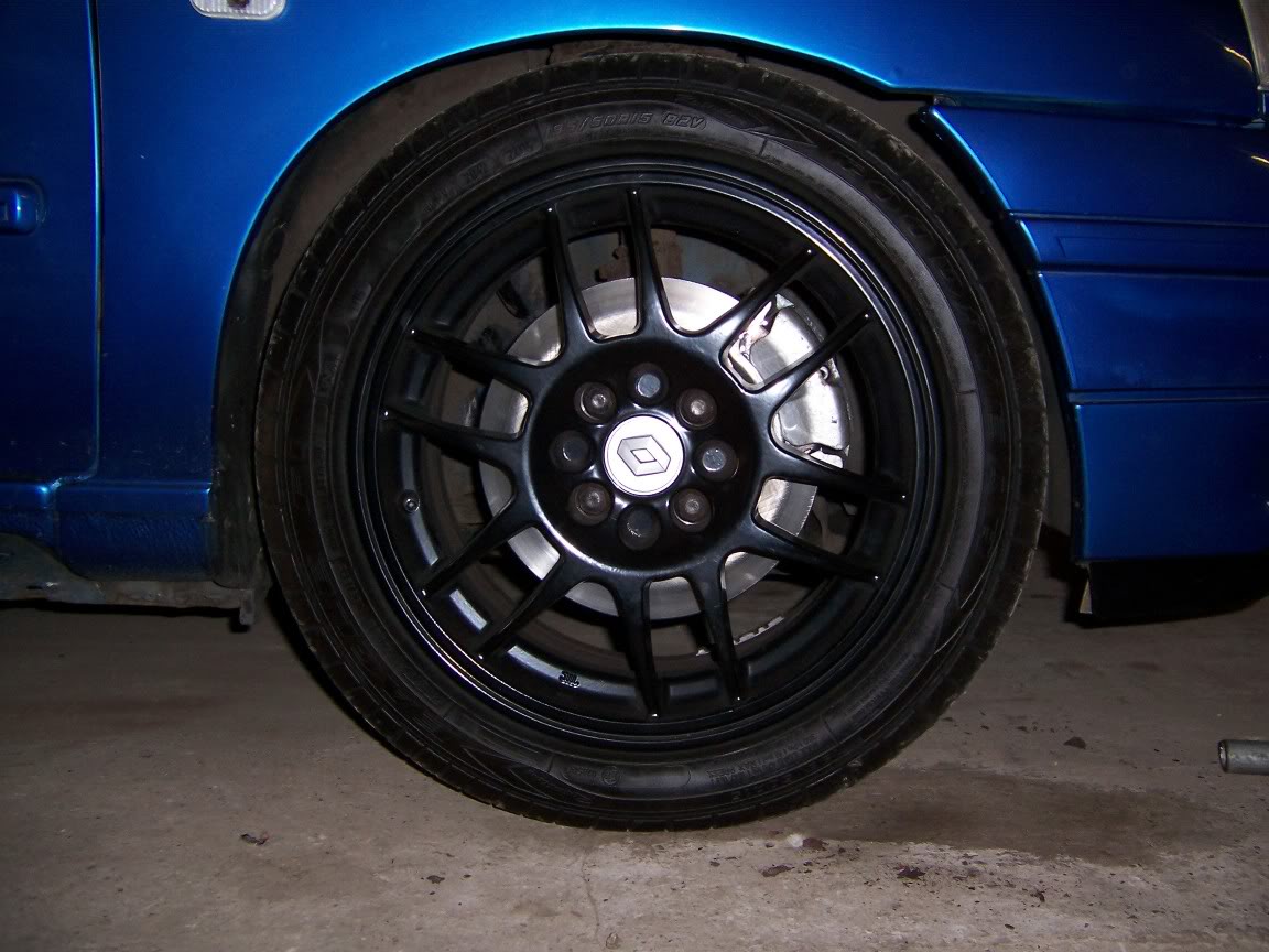

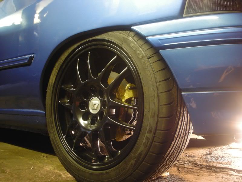

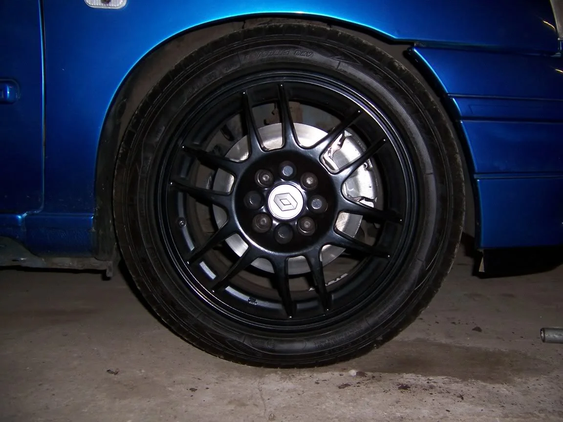

Used 16v brakes on front of mines, and a rear disc coversion from an rsi.
Engine conversions are probably the best £ for performance mod.
Mines runs a 1.7t form a volvo
Hope that helps bud :)
