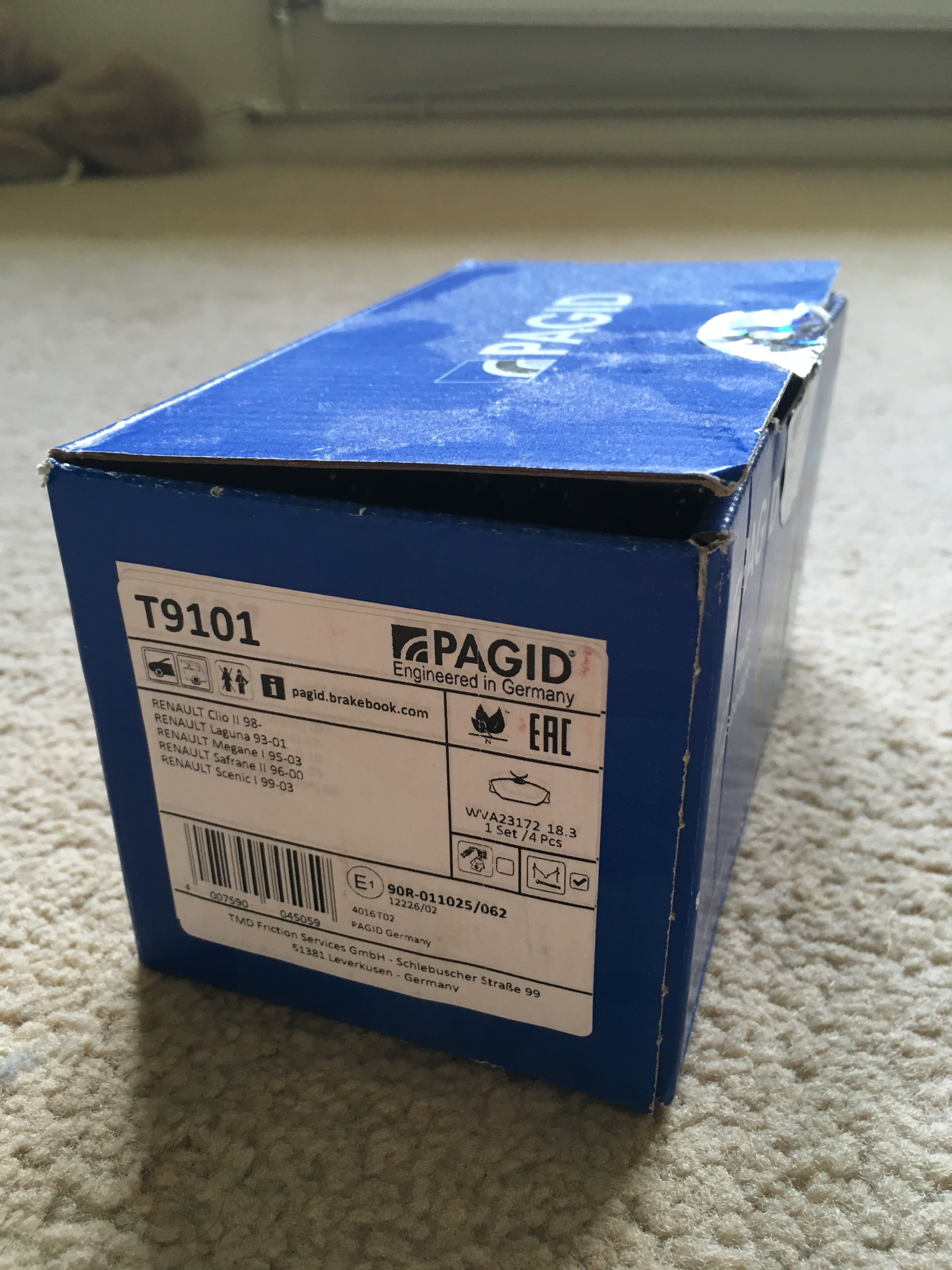

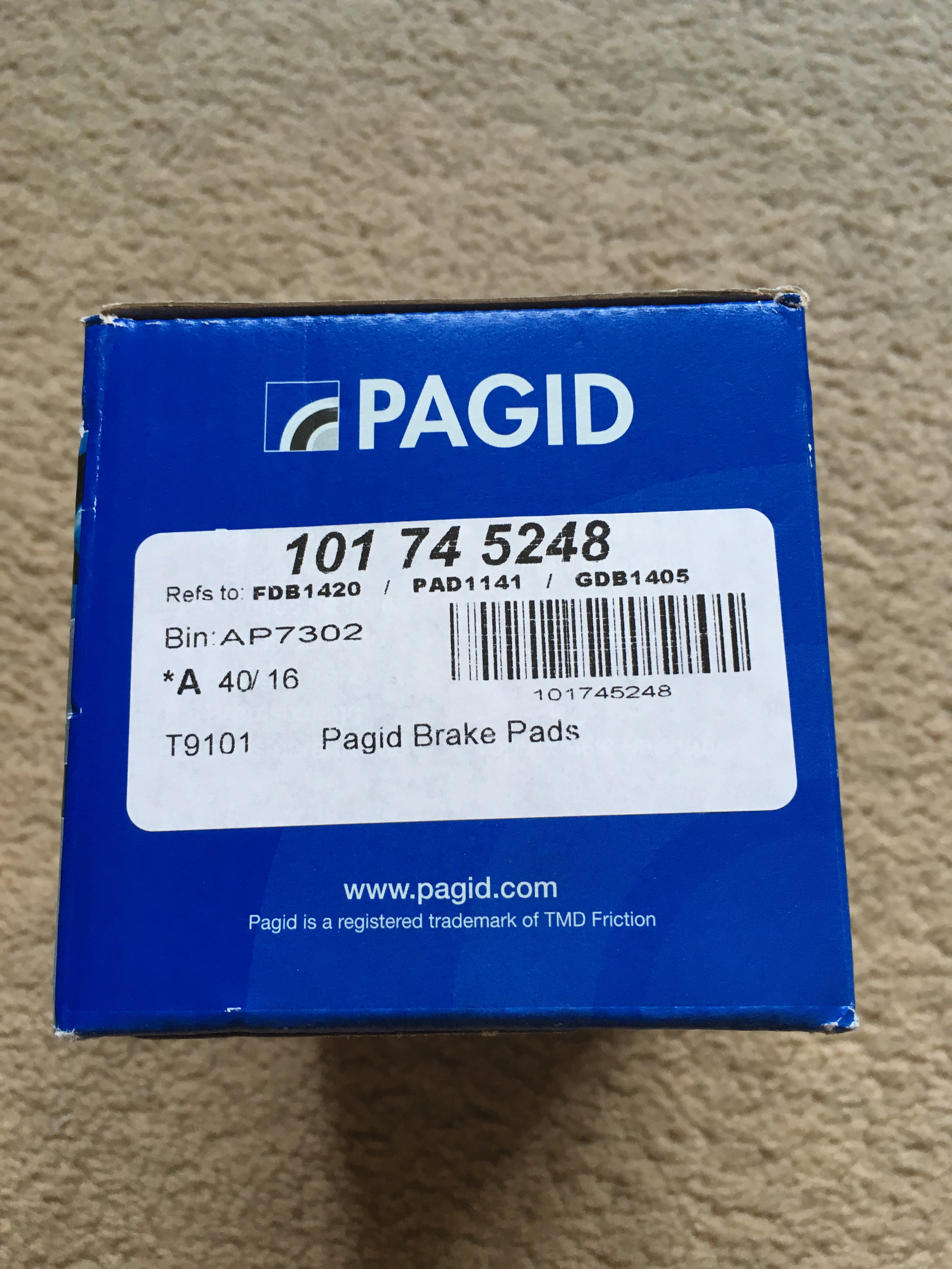

Anyway, looking to try the Ferodo Pads this time around. Does anyone now the correct product number for these?..... Ferodo FDB1420?
aucky
Is that the Pagid code for the Blues? I had them, liked them a lot.
RC5+ also good, as are Hawk HP+, but I don't think they do the latter for Clios.
I believe so. The ones I have were also known as "Pagid Blue's"
~£190 for a front set
So much meat on them. They'd outlast the disk in terms of heat too (brembo hc).
Ah, cool, that's the same ones I had. I liked them a lot and they lasted a good couple of years, with a couple of track sessions along the way, so would buy them again if feeling flush lol.
They had some small cracks in the material when I eventually took them off (think I swapped to the RC5+) but they still worked fine!

How did you get on with the pagid pads mate? @Amos91
It my disc / pad of choice still to be fair. Good on the road and even took a significant amount of abuse at Bedford Autodrome for an evening session. After about 15 / 20 mins they started to fade, but for less than £20 a set of pads its ideal.
I now just stock up on them and change them after the trackday etc.
MrBlonde
Oh good mate,are these the pads you got?.i got them ECP to.
