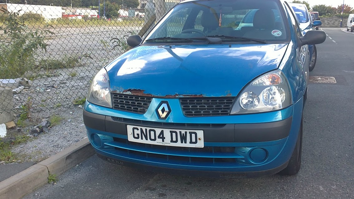

What is it that makes the front o/s leading edge of the bonnet rust on the phase 2 Clios. My Trophy seems to have escaped it up to now but many cars seem to suffer from it. I could understand it on wheelarches and sills where dirt gets trapped but the bonnet surely keeps fairly clean.
Is it a corrosion problem from the inside out or from perforation from the outside and why the offside of the bonnet only or predominately? I'm guessing keeping clean, waxoyled etc possibly helps prevent

Mine has the same rust on the leading edge. I'd guess it's from stonechips on the edge which then leads to paint peel/water getting underneath. The bumpers/wings are obviously plastic but you can see the amount of stonechips they get.

Both my Trophies had this rust spot on the drivers side lower corner.

Well I've looked at 2 Cups recently and both were rusting in same place. I just wondered if anyone had investigated the cause. Just seems strange with it occurring in the same place on the bonnet

it rust from the inside were there is no paint, moisture gets trapped buy the way the seam sealer is applied, best to get a new bonnet.

My bonnets not had paint i'm pretty sure. It needs it now though, or replacing altogether as it's dented too.
You should have seen my bonnet at circa 120k. If any polish went near it, it was like a shower of Tipp-Ex brushes had been flicked all over it. It had corrosion on the nearside front lip - purely through a stone-chip and it was cheaper to buy a new unpainted bonnet, then black-gold it - rather than to fix it.
I do think the shape and angle of the Clio bonnet doesn't help. Although its the longest I've owned a car, the ratio of chips compared to others I've had is shocking. My Evo's bonnet got just two chips that I noticed in the time I had it - something which helped with it being much flatter, imo.
