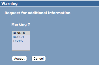

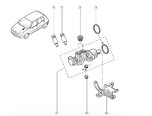

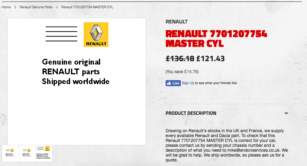

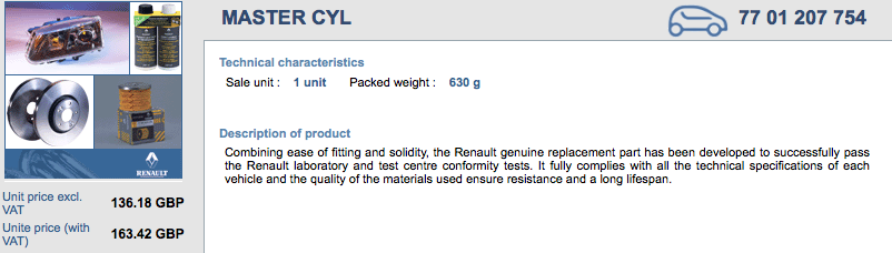

Below is the correct Renault UK details
As above I have had mine changed on the trophy and this is the correct info I have from the invoices.
The Correct part you are looking for is -
Make - TEVES
Pt No - 7701207754
RRP - £136.18+vat

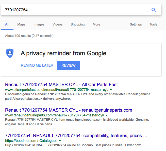

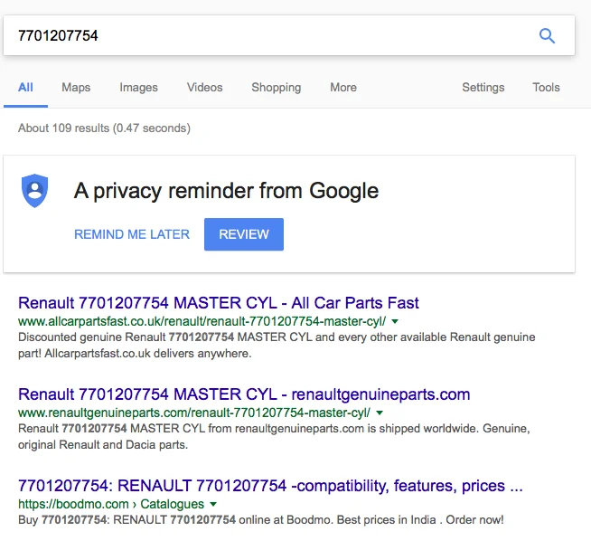

7701207754 does not google or ebay, so I guess that incorrect.
