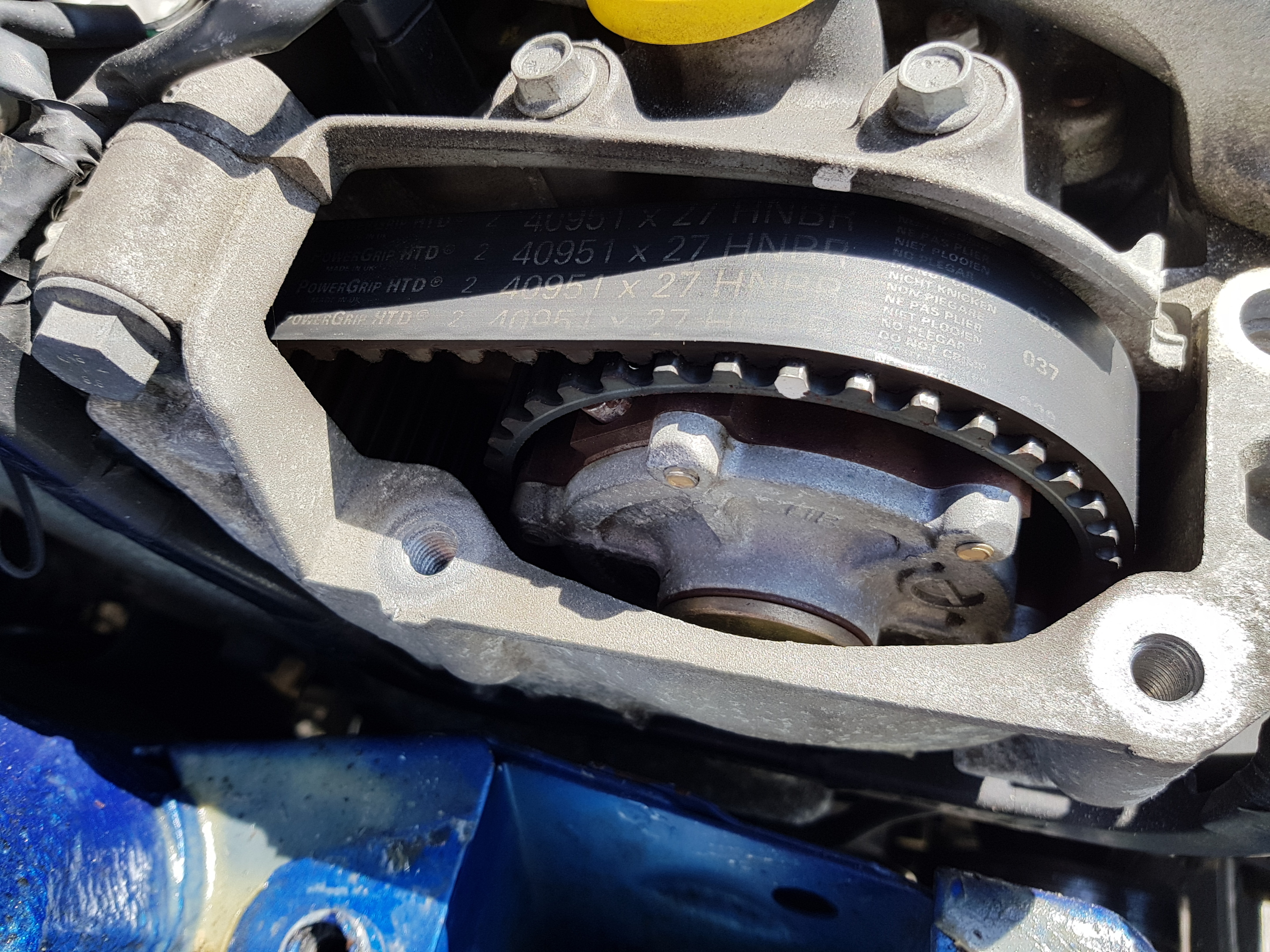

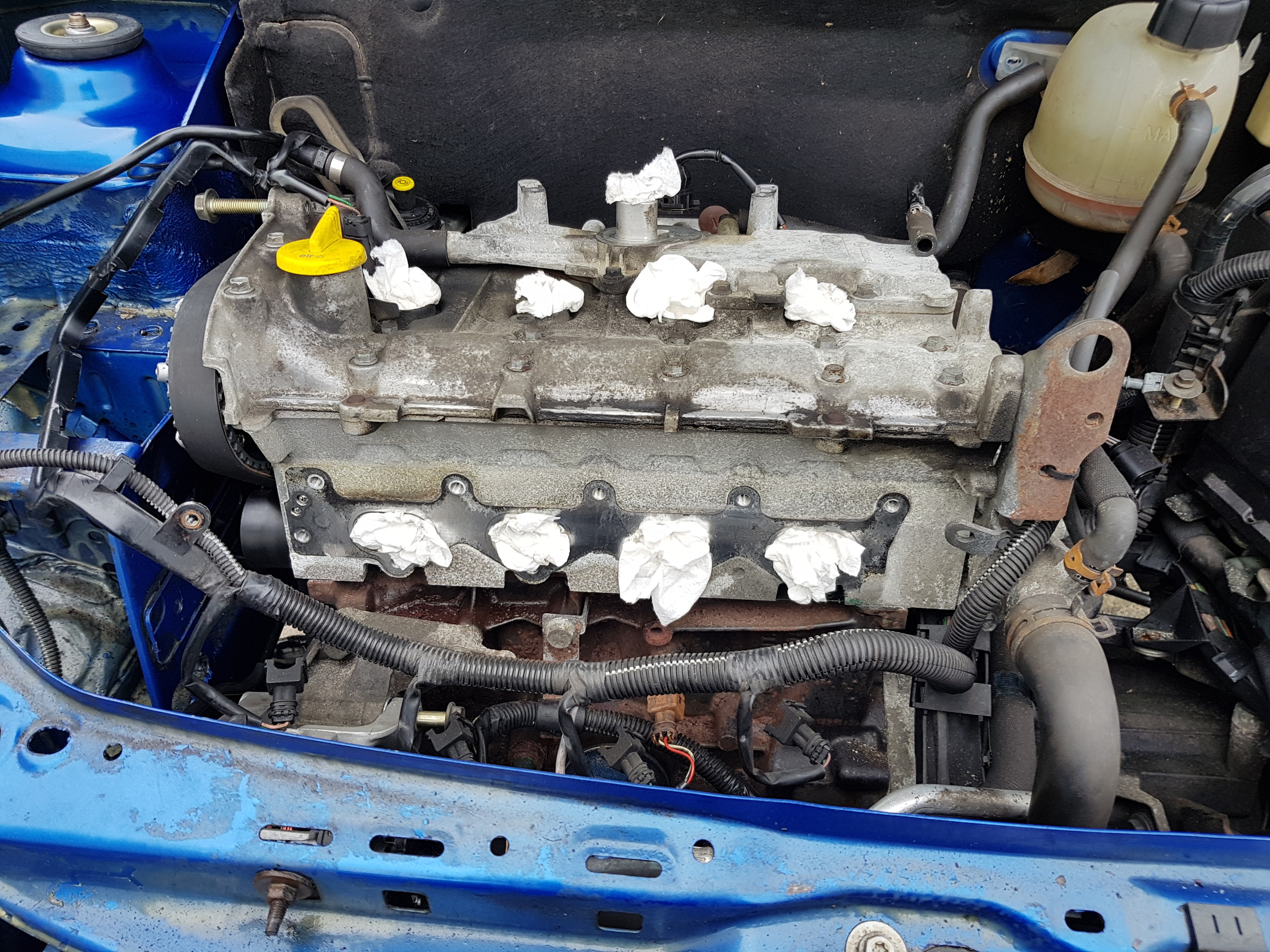

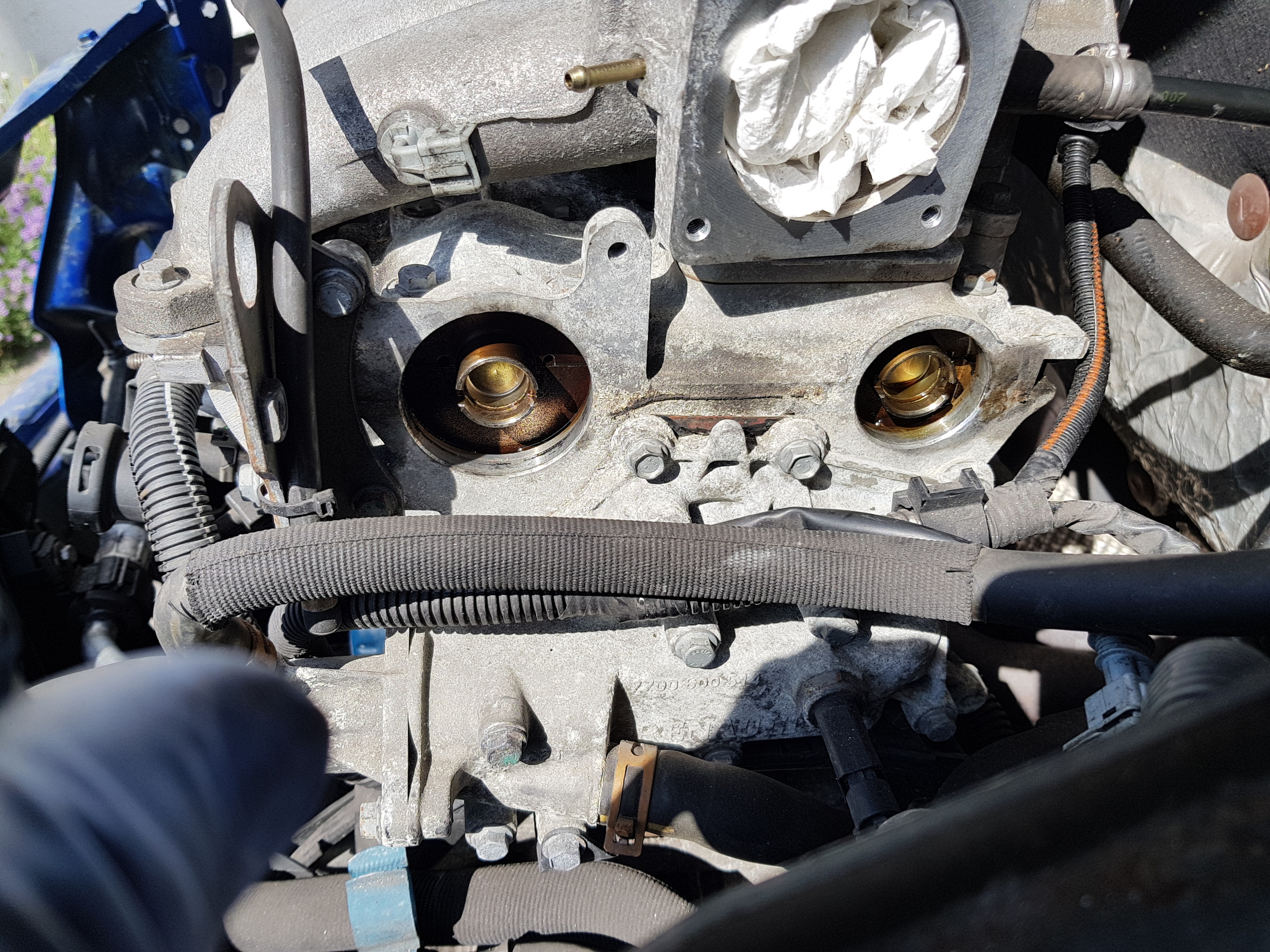

When I stripped the cam covers off I found that everything was timed up correctly from the last cambelt change
Replaced the camshaft oil seals

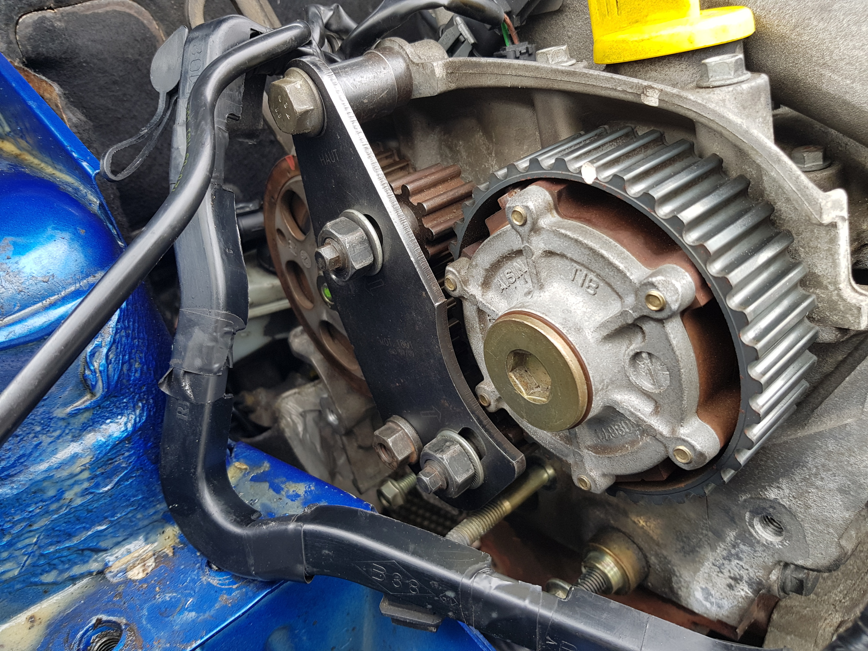

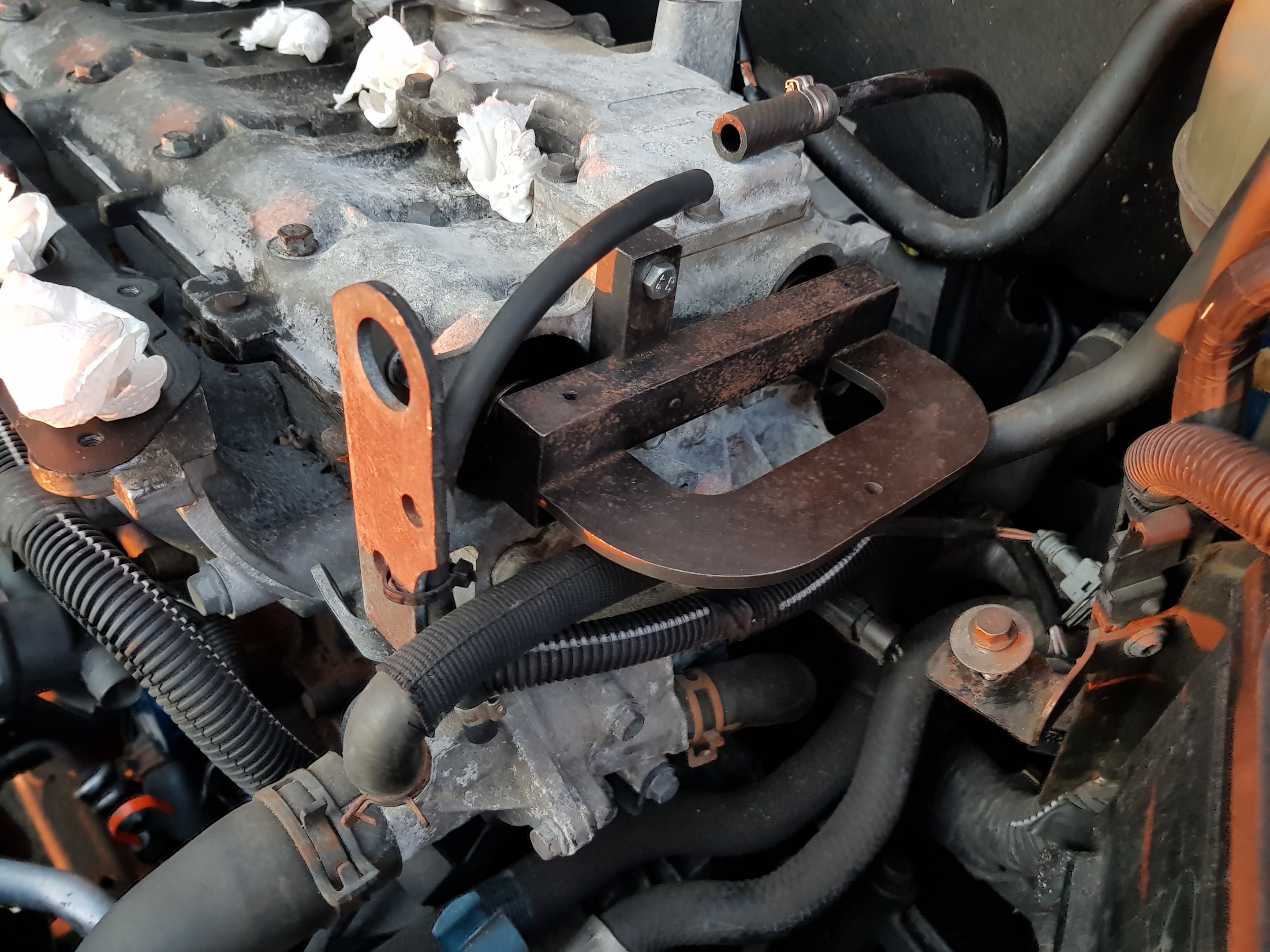

I borrowed the proper tools to get the timing right

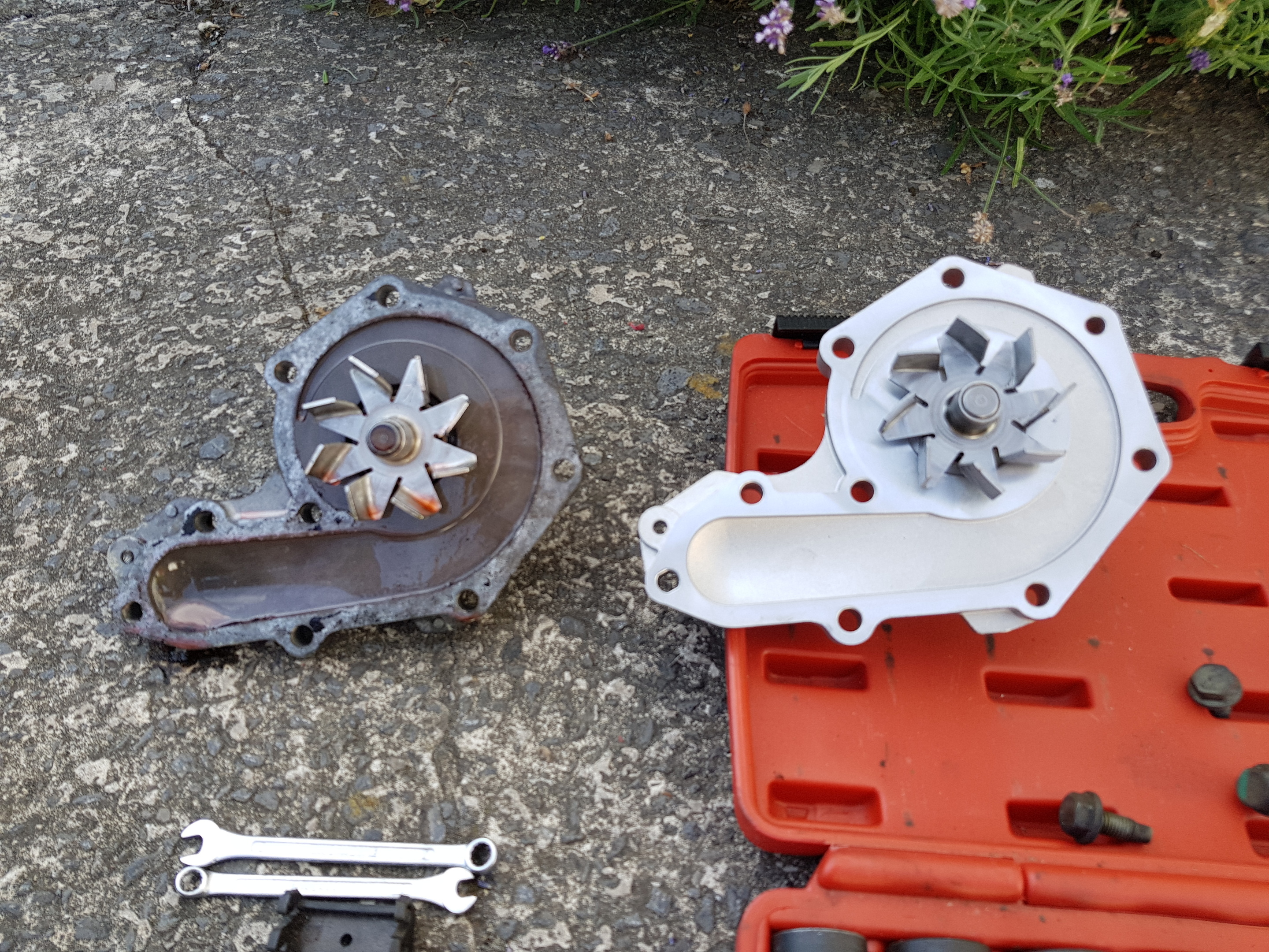

Changed the water pump too, but TBH it looked pretty good

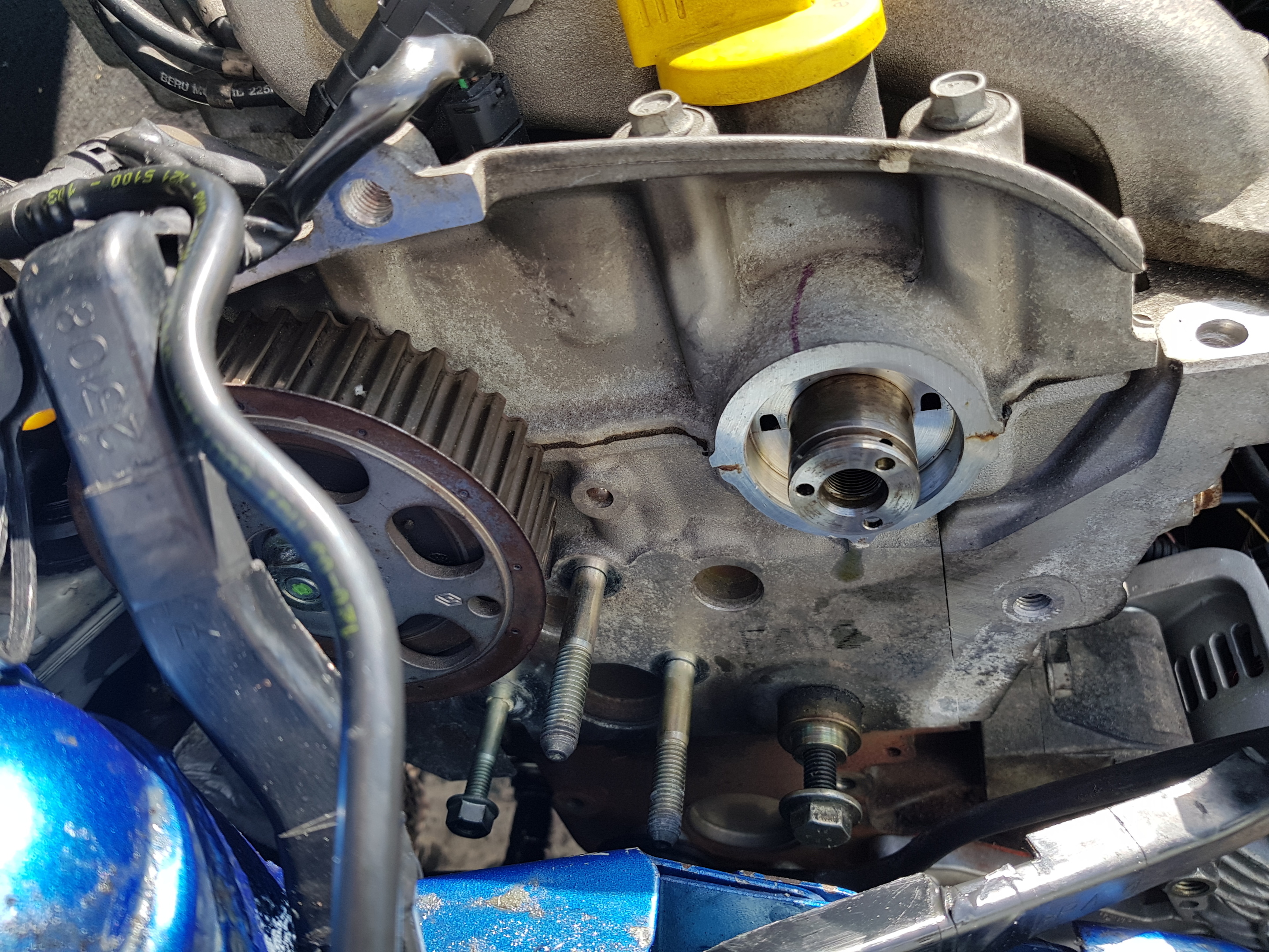

New dephaser pulley

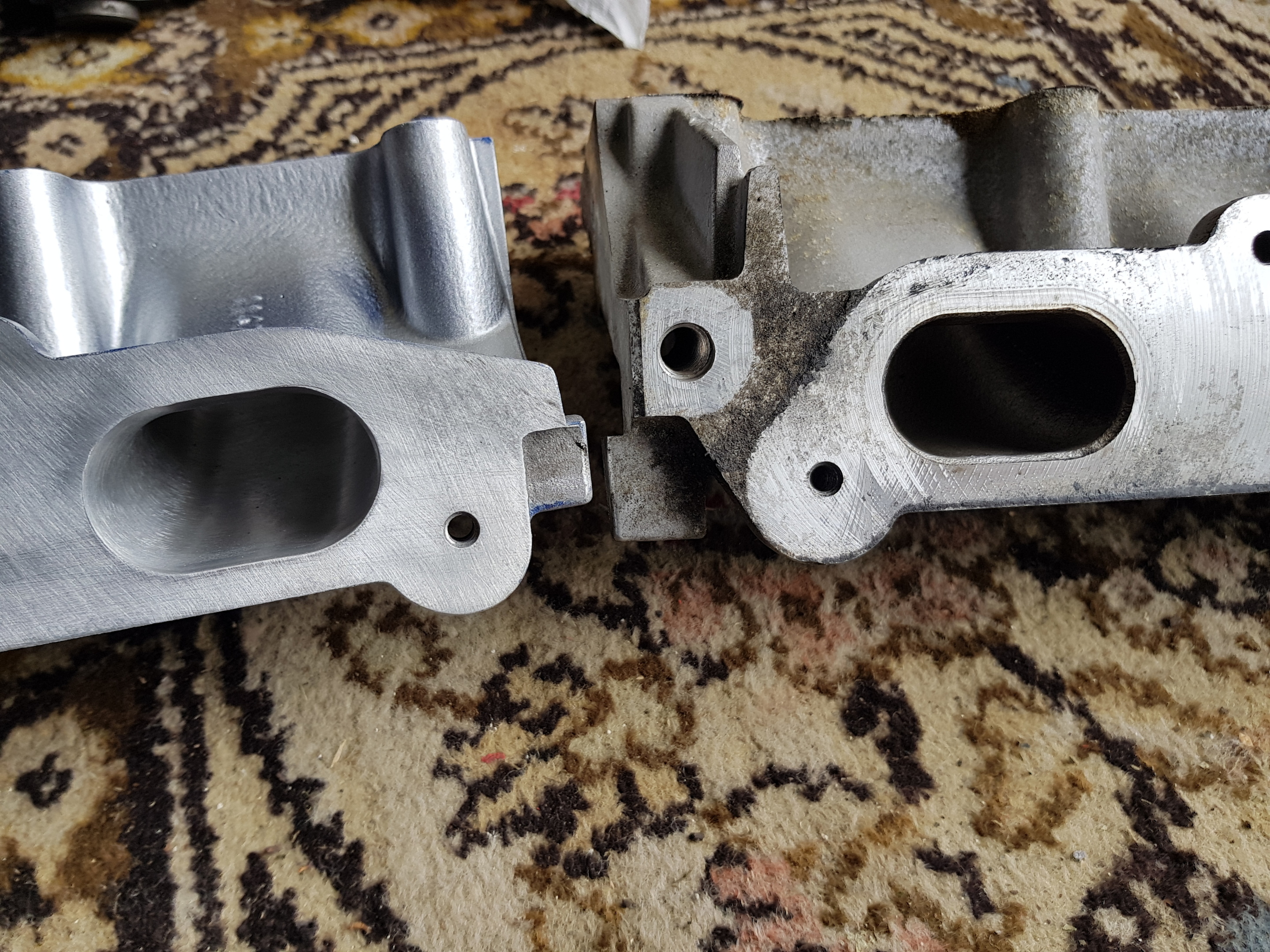

Also fitted a port matched inlet manifold and plenum chamber
New spark plugs fitted and whilst I was here I carried out a compression test. Good result all cylinders the same at 13.5 bar. Did the test on a cold engine for obvious reasons.

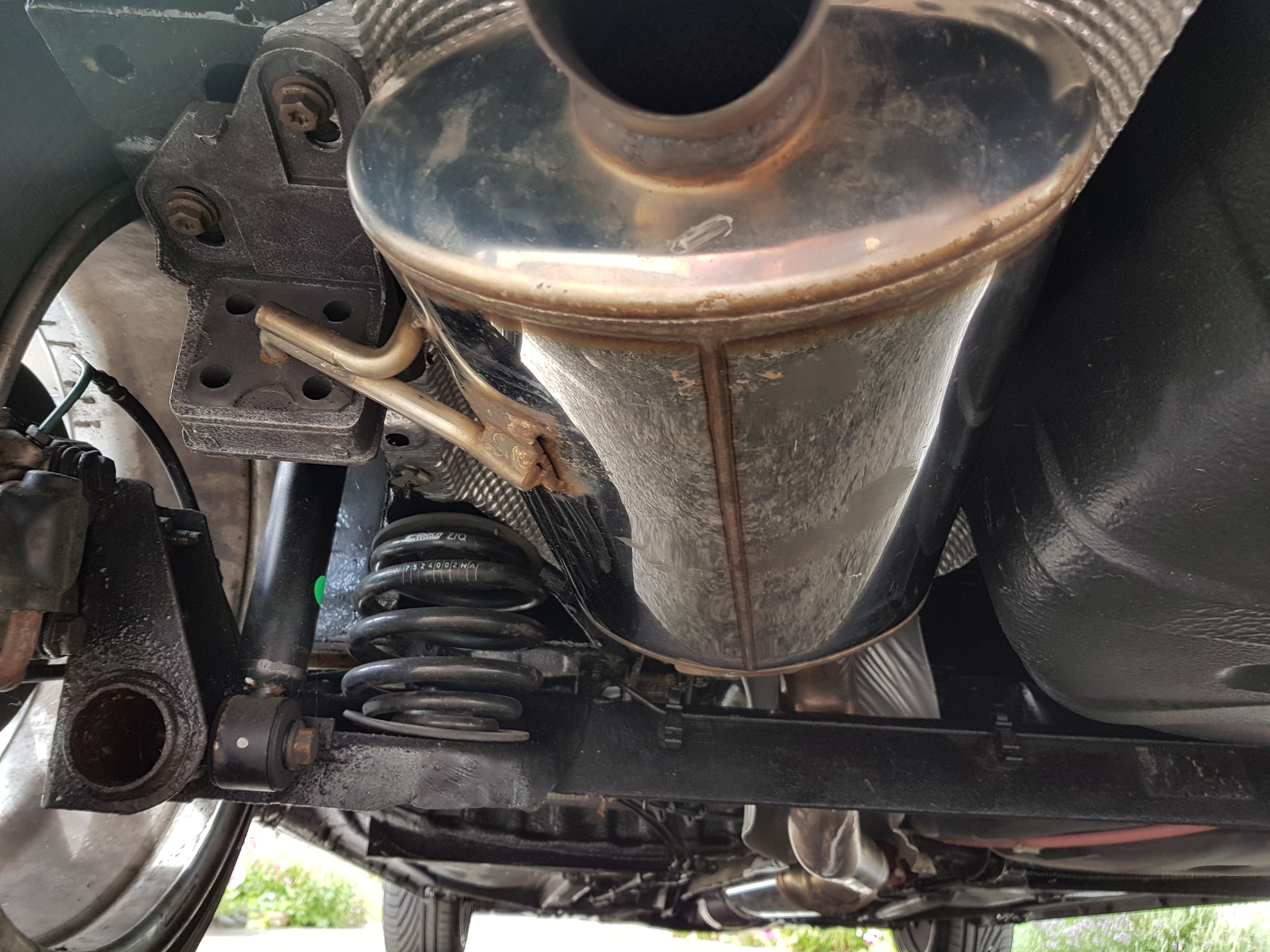

Also fitted a Supersprint exhaust system
All back together and working well, next job. Whiteline sway bar and then change the Rainsport3 tyres for PS3

matched inlets make a nice difference, you get a bit of a lump of torque mid range.
Yea, feels better mid and great at the very top. I even hit the rev limiter by accident on my test run....I usually change gear before I get near the limiter.

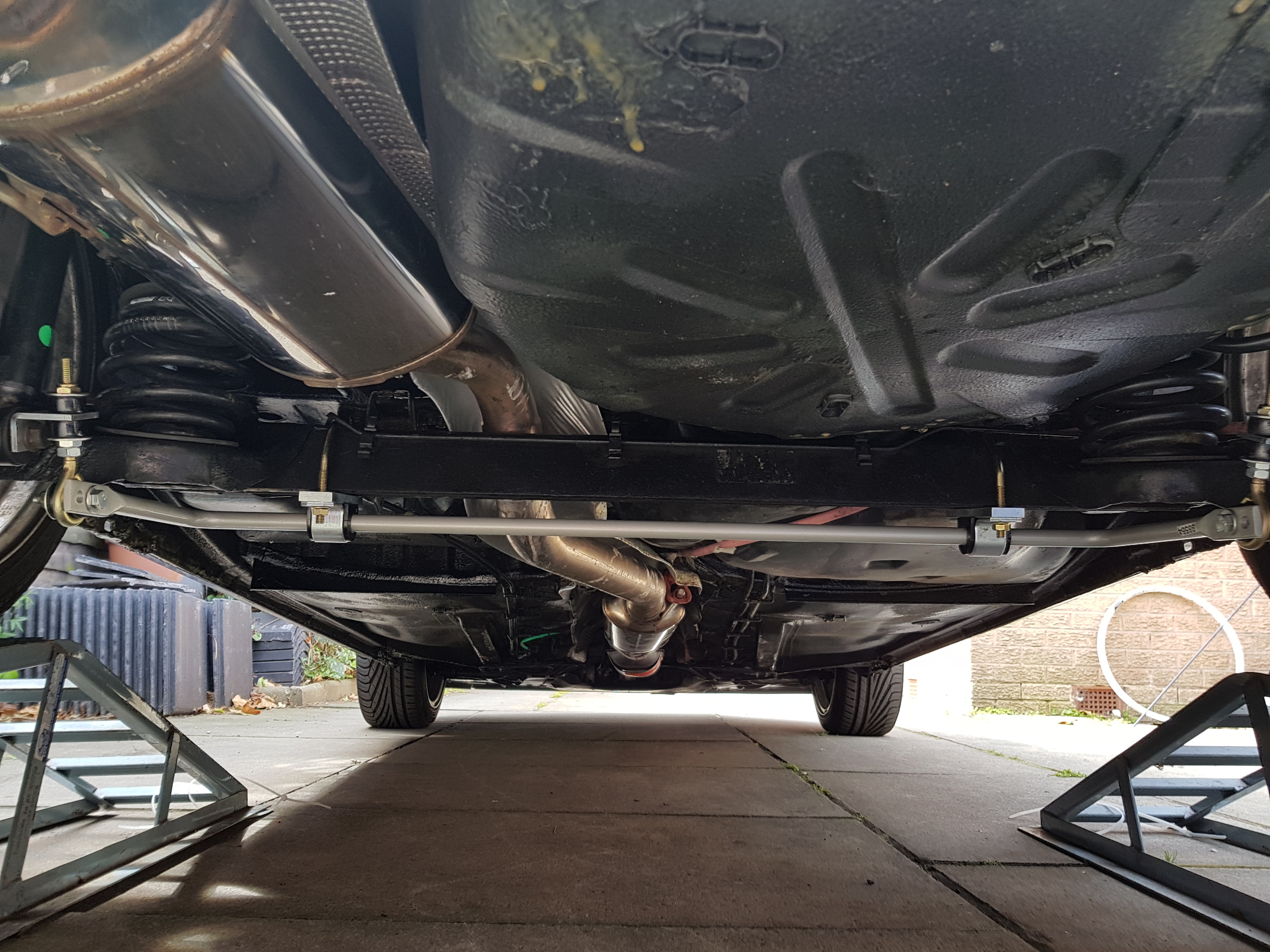

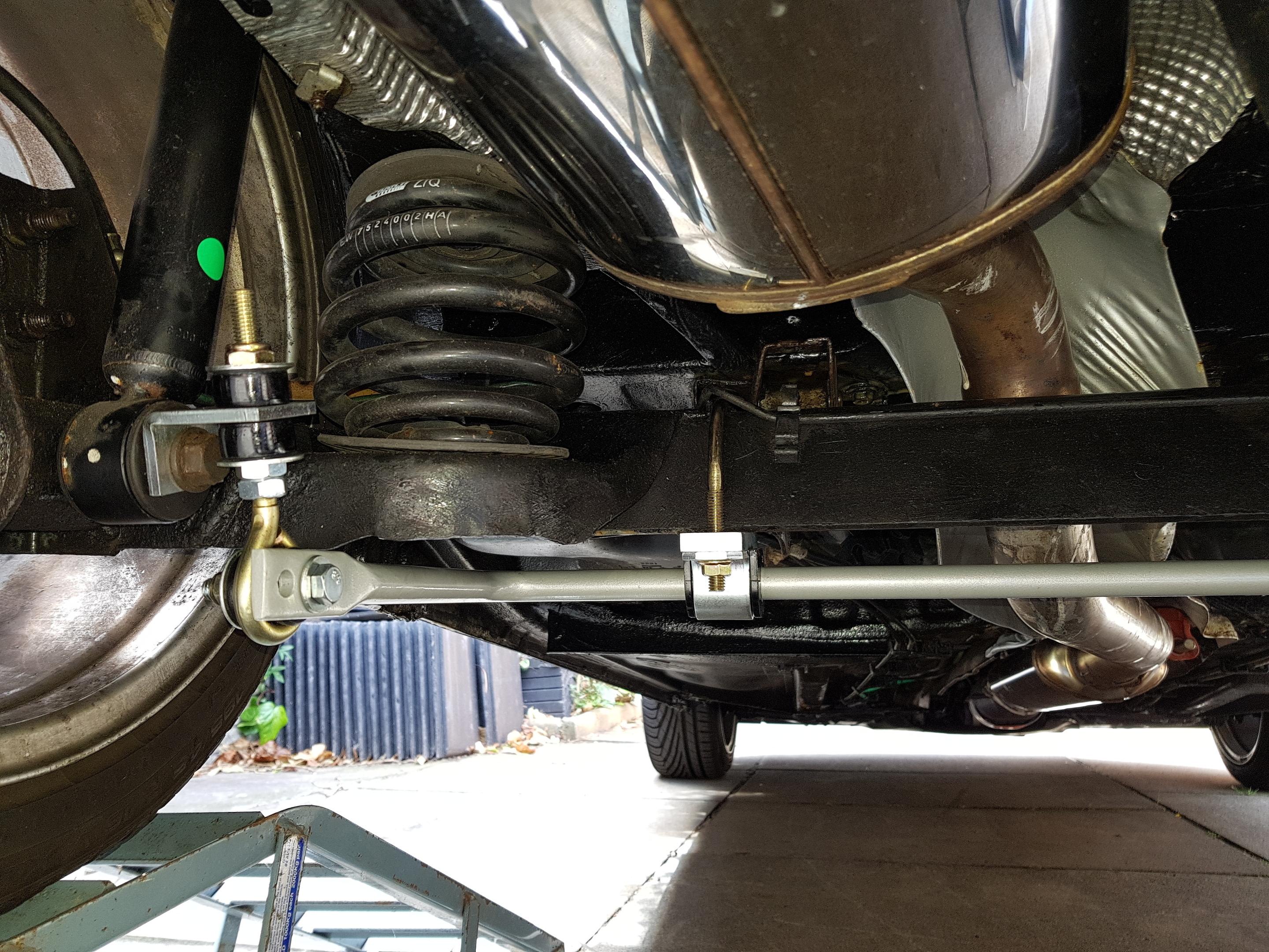

Put the Whiteline swaybar on today.
Amazing! it was a 30 minute job which actually took about 30 mins!
Nothing snapped, broke, sheared or was rusted solid. Mind you I have pretty much gone through the car now so there is not much that can go wrong really.
Only had a short test drive, feels a lot tighter in the corners, the rear end felt a little more lively, which is good.
