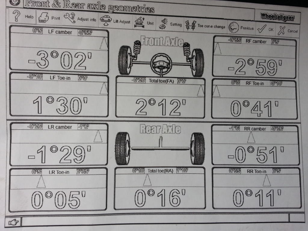

cheers tony, how far out are they normally? or what descrepancy is allowed? before you see if something is bent etc. coz even if one is 0.3 degrees more camber than other side, how dod you level it back out? custom shims?
my allighn ment is going to be done tonight, so i'll post up what im currently at
Heres where its at currently. How would you do it for fast road...and the rear camber...do i just stick a shim on one side to try and level it out? I dont have a clue about geo :(
  182cup & 172 racecar
I'd leave it as it is, seen much worse than that.
​Just need to get the toe on the front sorted out, which will give you about 1 each side (1.6 actually)
