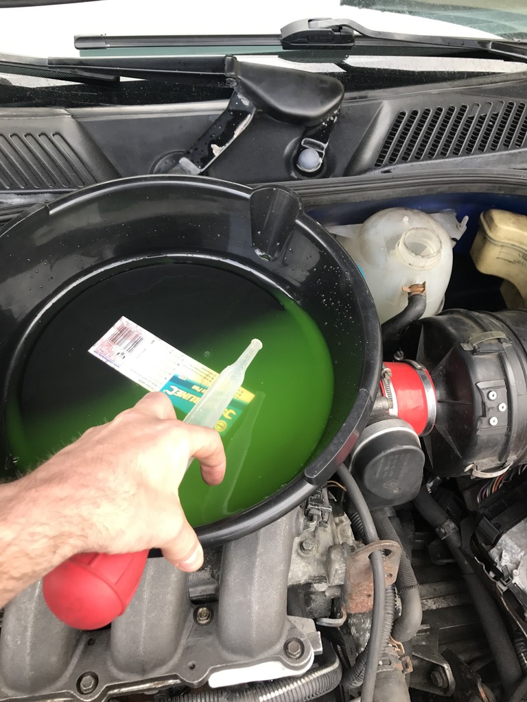

Yeah I used about £70 worth of the stuff, I have heard on the FB page that others that filed up are also facing miss fires? Do you know what this will be down to? Would a fresh full tank of fuel resolve it or do we think it will have buggered something?

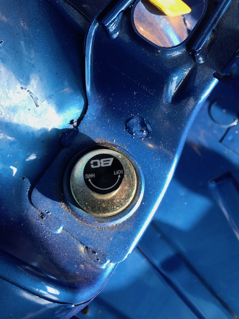

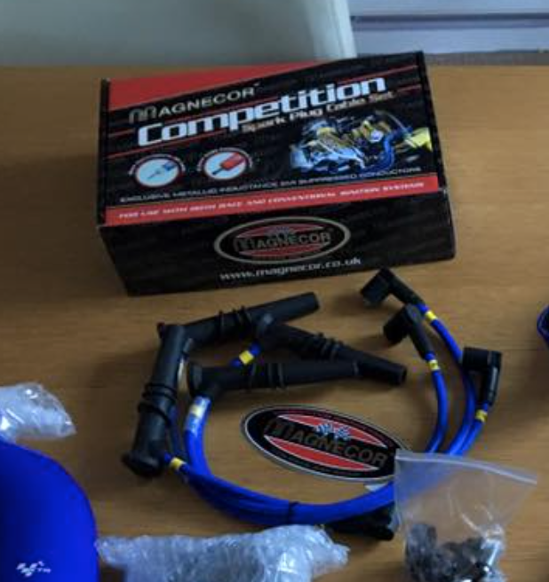

Pay day, so purchase black power flex bushes and stranded OEM rear shocks, also picked up some decent HT leads for £65 instead of £80

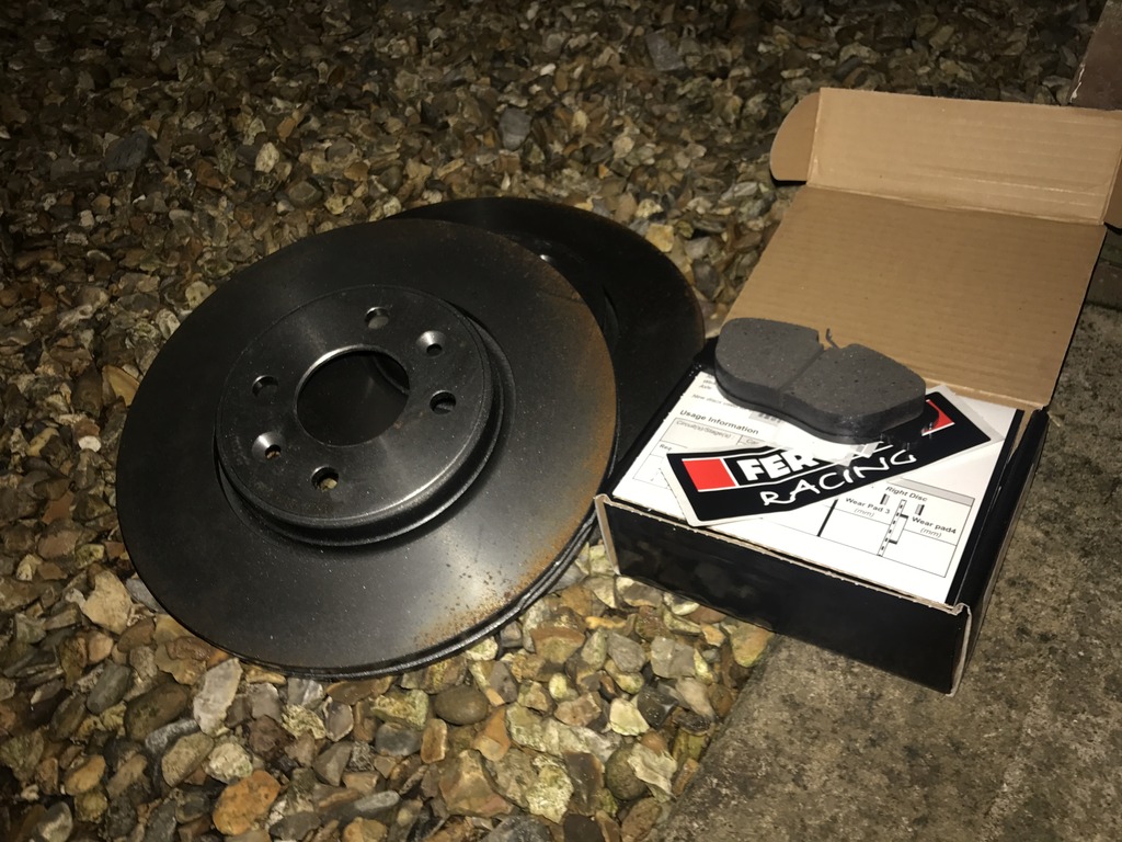

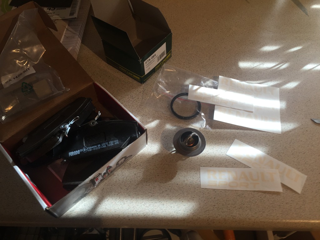

Mate sent me a thermostat and brake pads:
Going to see how I get on with these Ferodo pads for now as I can get them dirt cheap and will do a comparison with them against Carbone Lorraine CL6 pads in the long run, as I can have multiple sets of the Frodo pads for the price of a set of the others, and I don't mind changing a set each track day as only takes 15 mins a side.

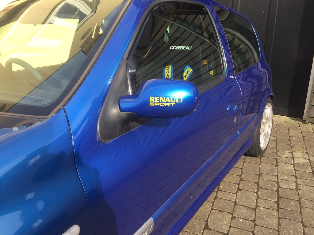

Put the wing mirror Renault Sport stickers on, not to sure about them at the moment but we'll see

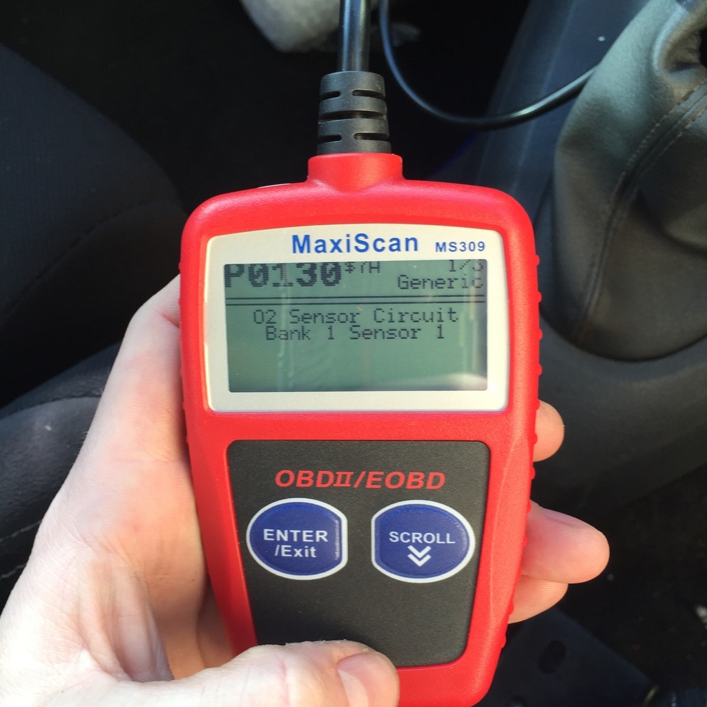

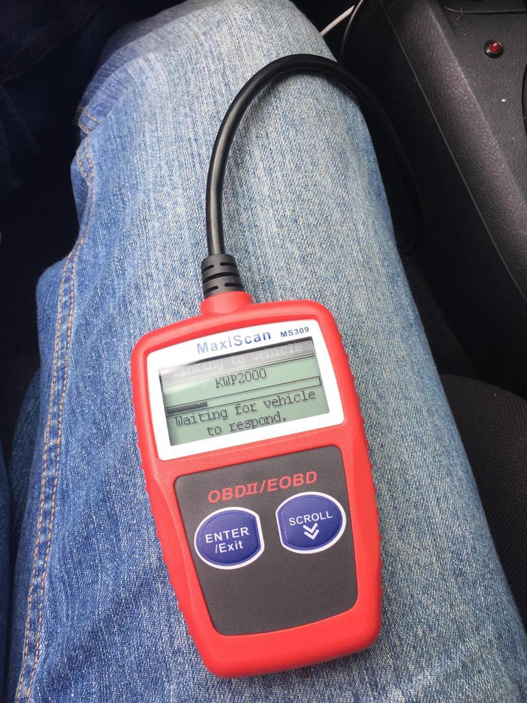

Still can connect my OBD2 to the car keeps saying failed, anyone else had this, its powering up from the port just won't connect and really want to see what the ECU says the miss fire is in relation to. Device works fine on other Clio and has previously worked on my 172.

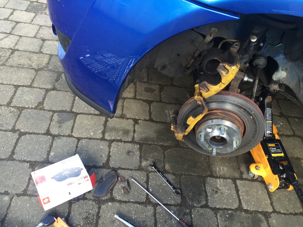

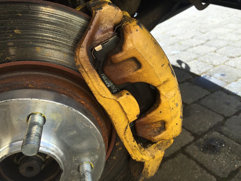

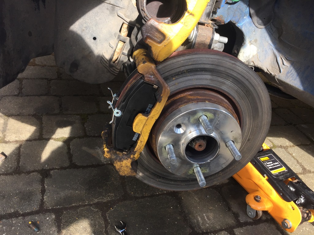

Did a pad change at the end of last week
Really want to get the other set shot blasted and treated so I can have a decent set working on the car.

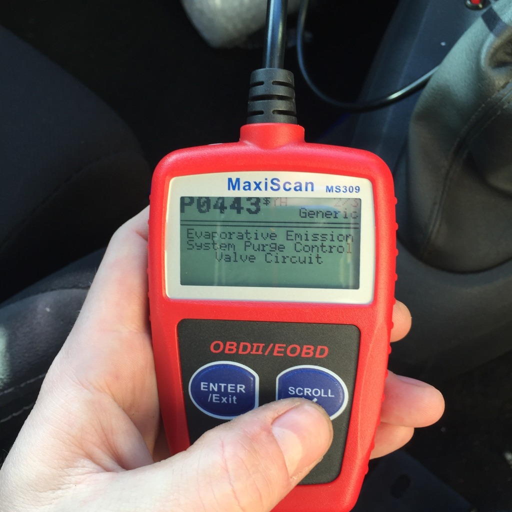

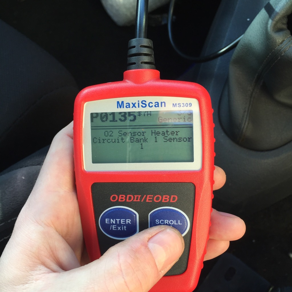

Finally got the ODBII reader to work
Nothing major just carbon canister and indication that the lamba sensor issues but its not fitted hence the fault.

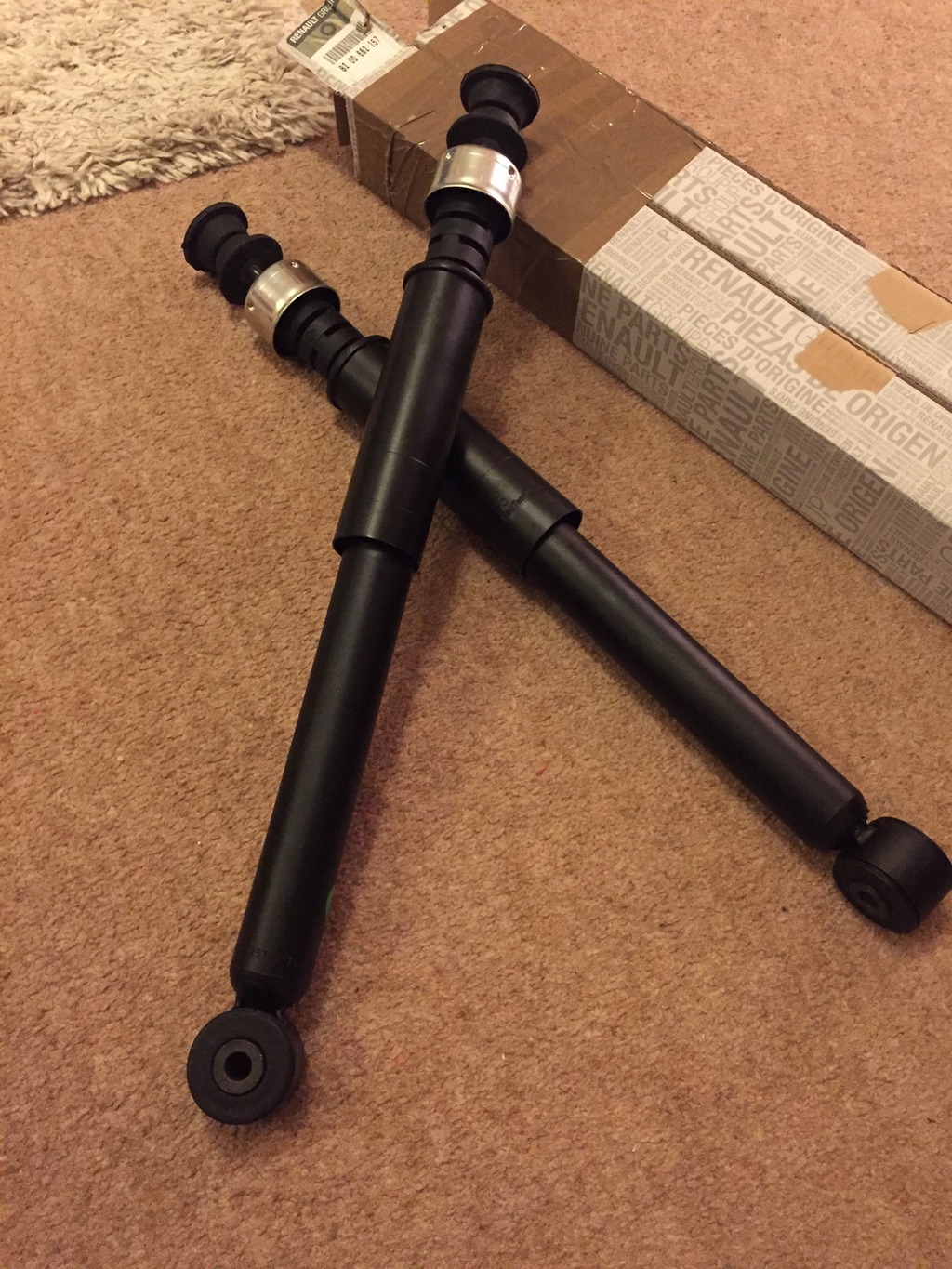

New rear OEM shocks have arrived for £80 delivered.
Just waiting on the rear bushes and HT leads and that will be the next work to carry out.

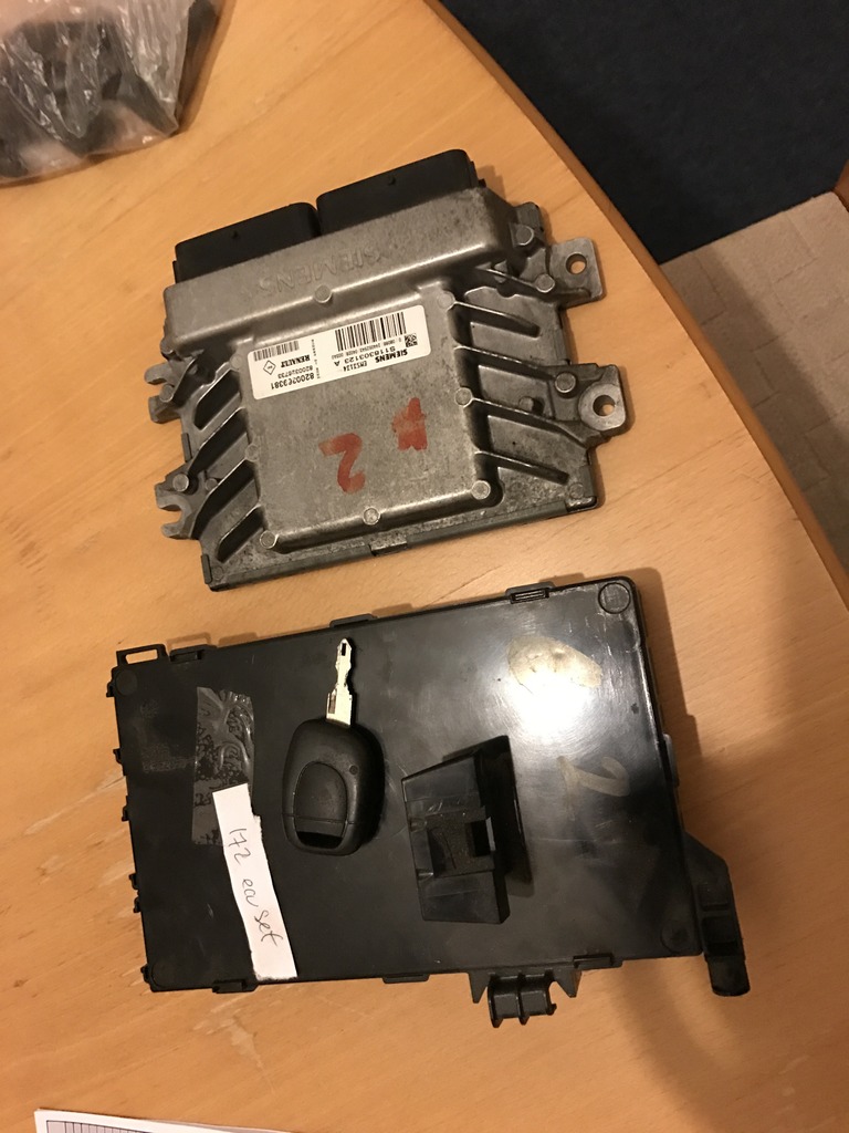

Car still has the misfire but I have found out that there is an issue with the cabling to the ECU so I need to look in to this further, also tonight the car struggled to start and I think the stater motor might be on the way out which is a pain in the ****.
Nothing but electrical issues these French motors.

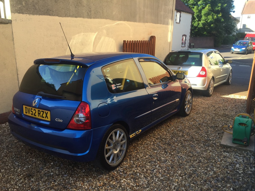

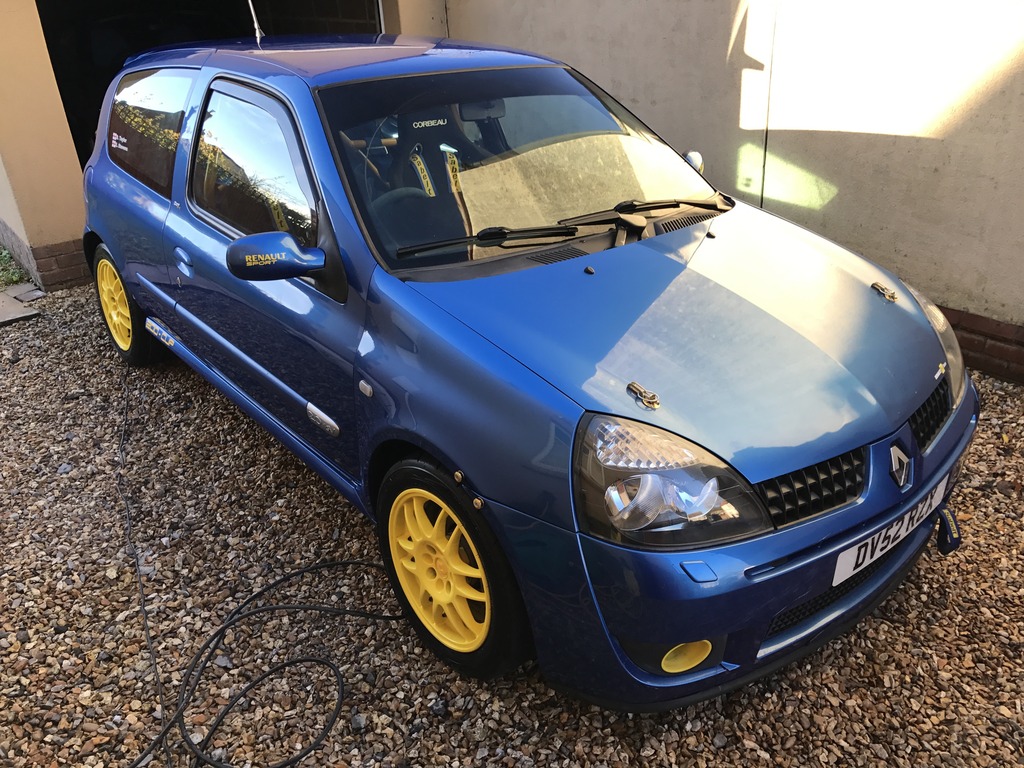

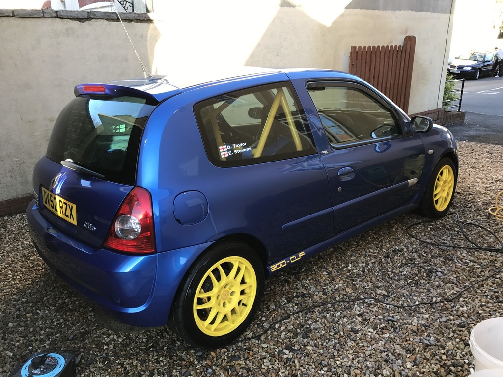

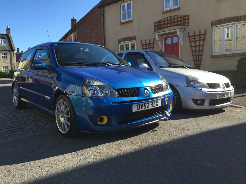

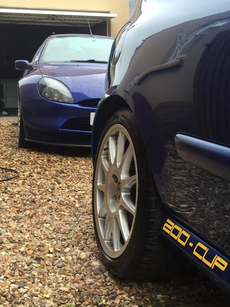

Anyway I managed to find time on Sunday to give the car a full detail, it was a hell of a mess as I had been using it to go to and from Glastonbury festival.
Before:
After:
Whats that lurking in the back ground ;)

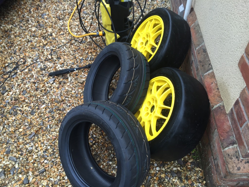

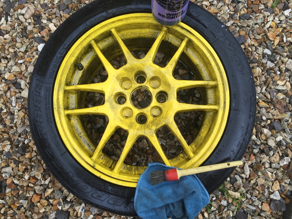

Also started cleaning the track wheels, going to get the R888R's fitted tomorrow.

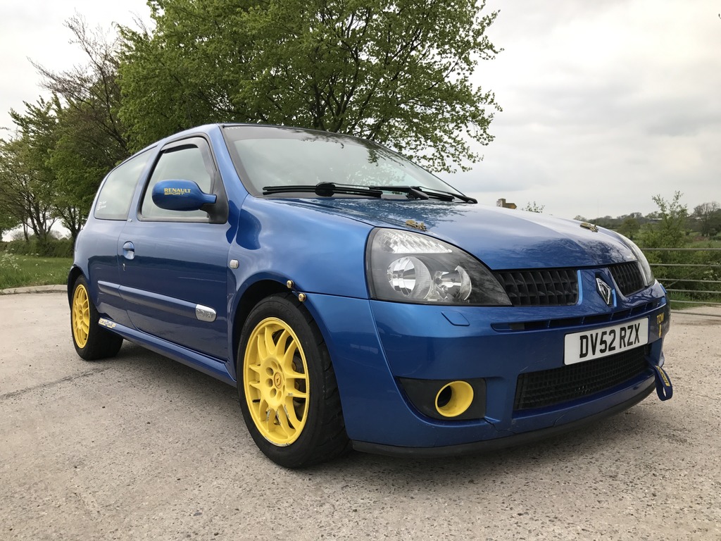

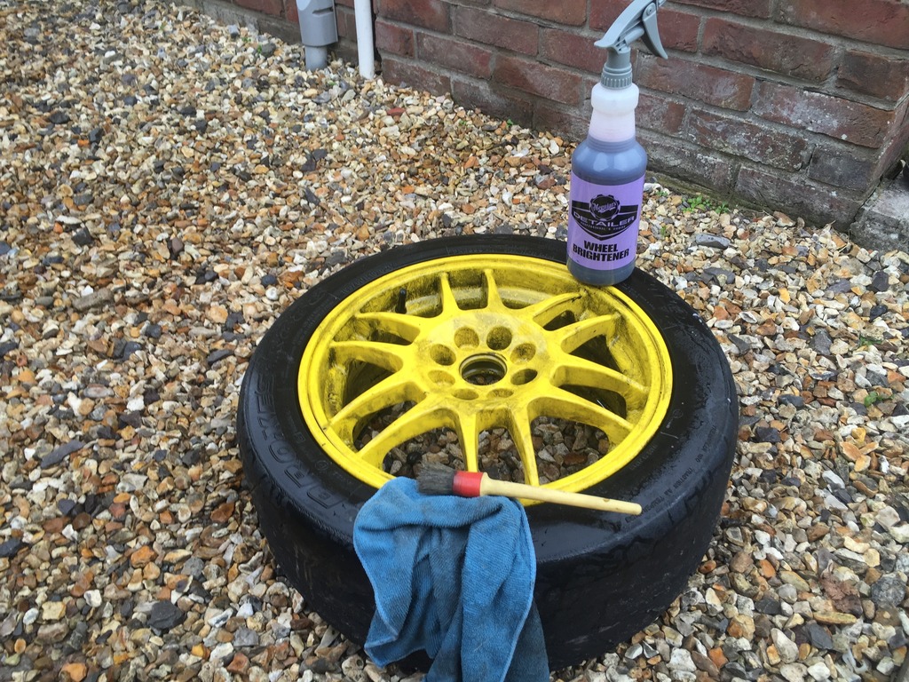

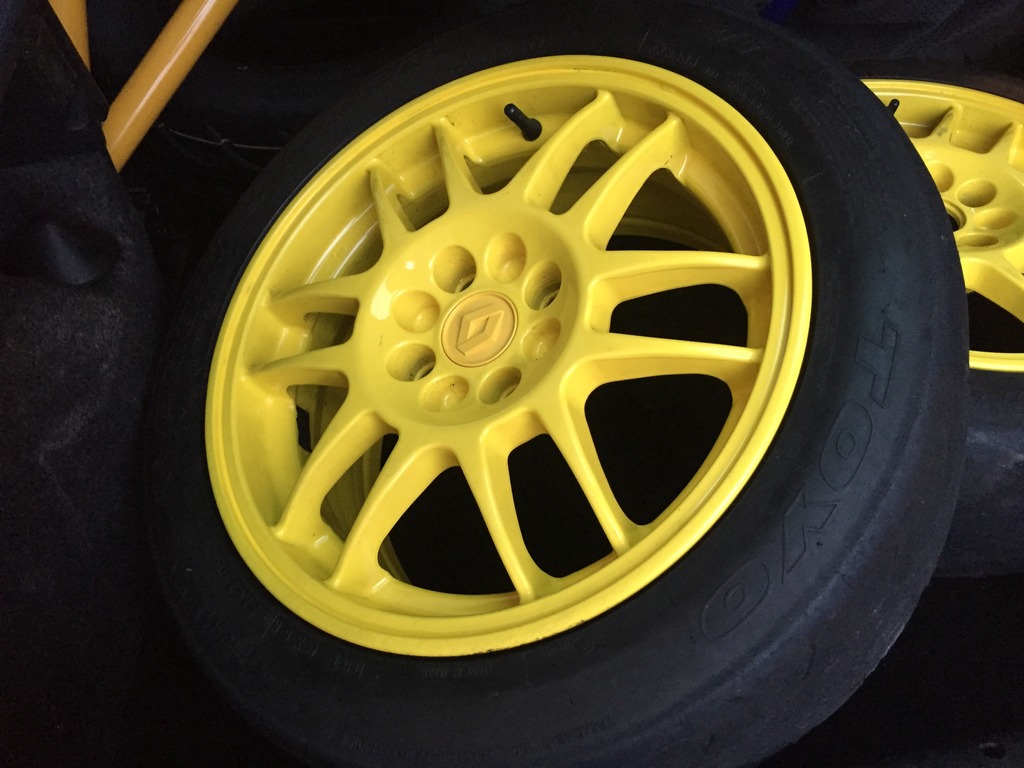

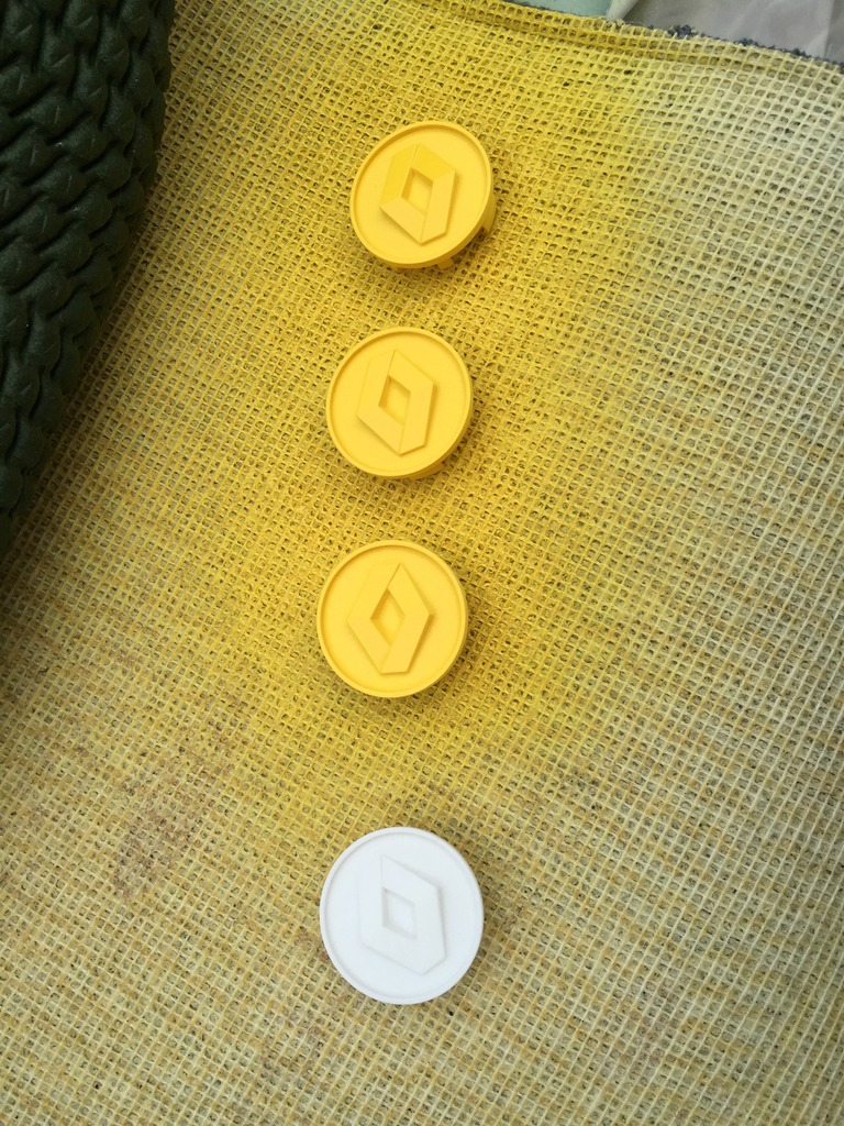

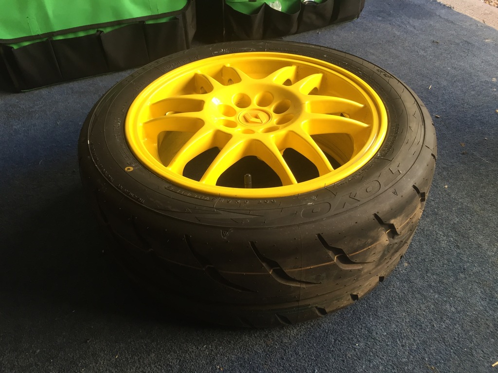

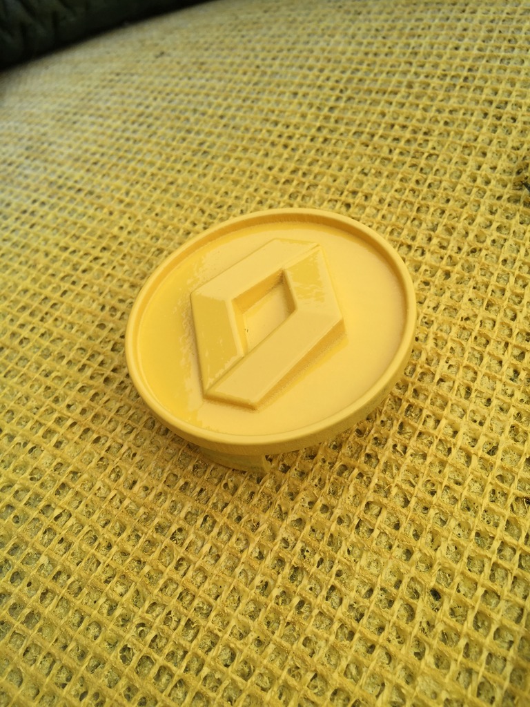

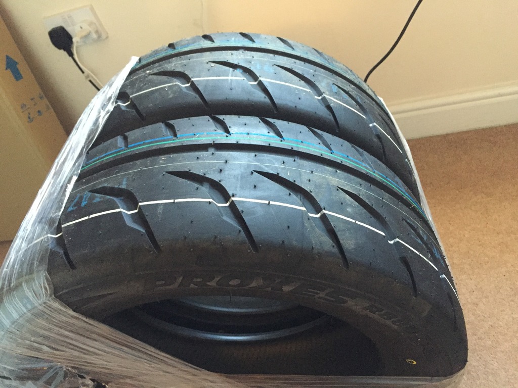

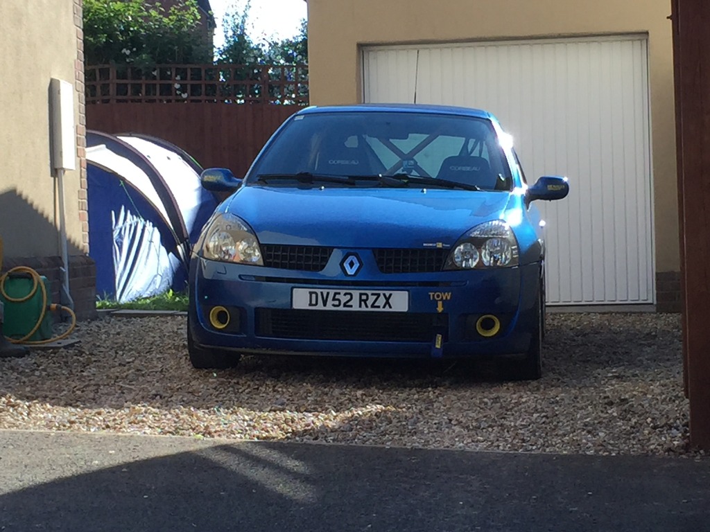

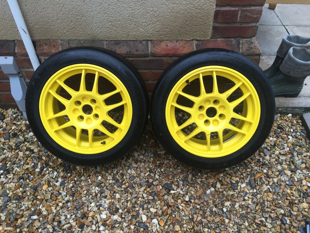

So managed to get some yellow spray paint today to finally spray the centre caps for the track wheels, not the best colour match in the world but it will do.
Got the R888R fitted today

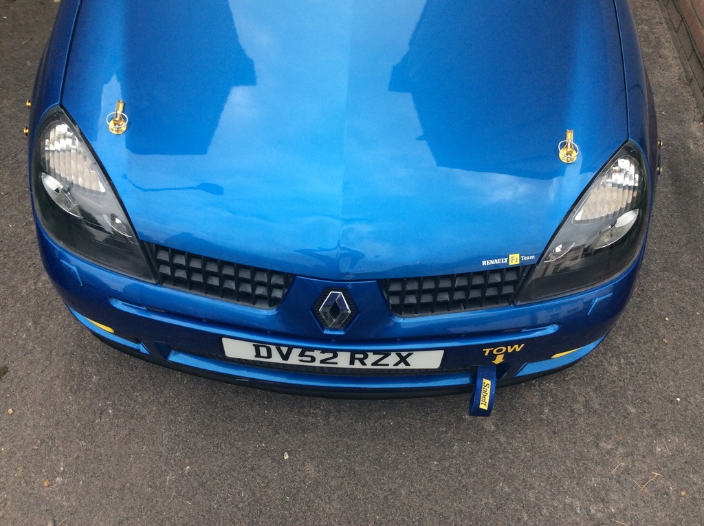

Anyway the bonnet pins are finally in after plenty of swearing and shouting:

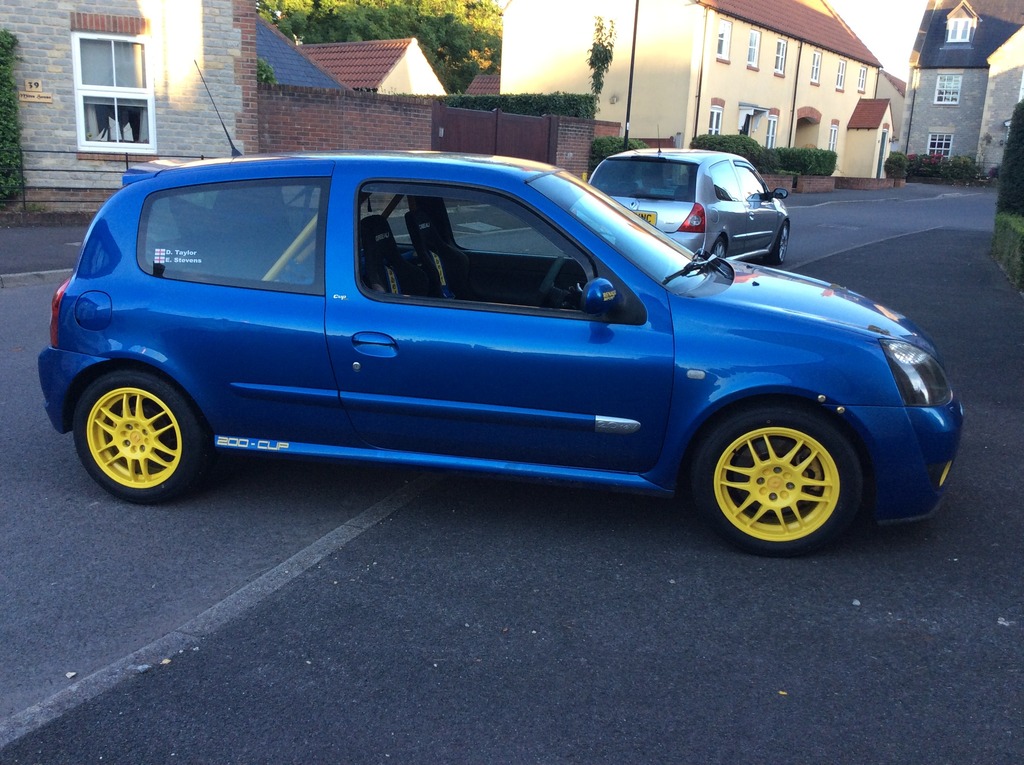

So finished swapping the wheels over this evening, and took the car for a drive, looking forward to testing the tyres out n track, really enjoying the look again with the wheels back on, what do others think?

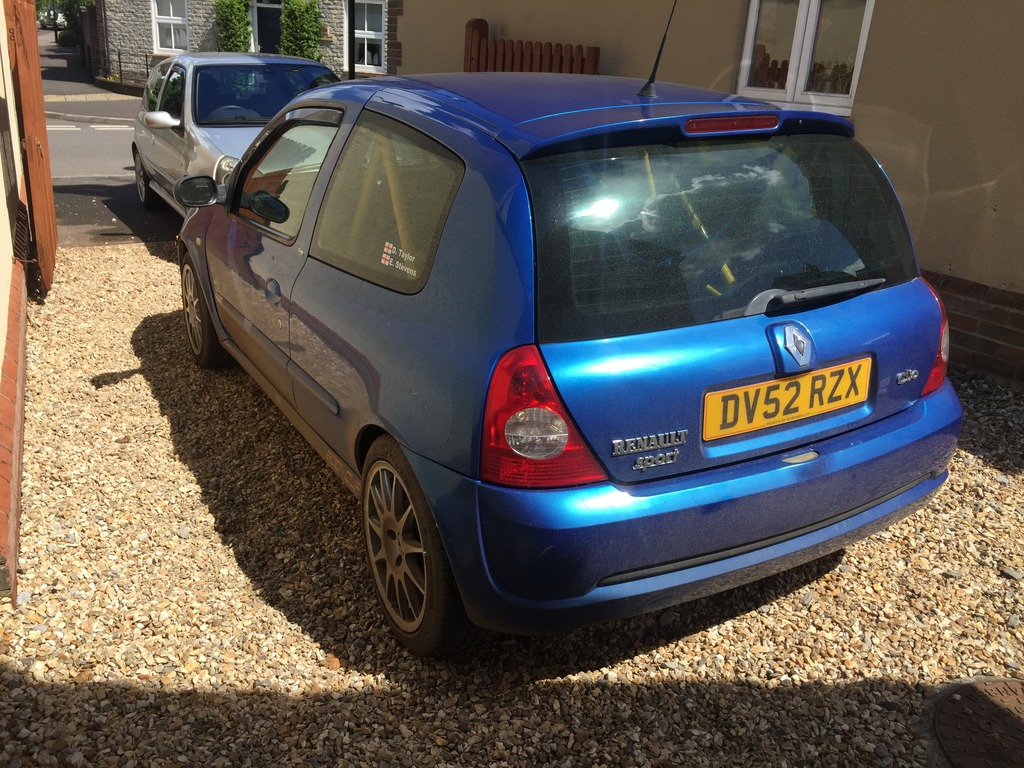

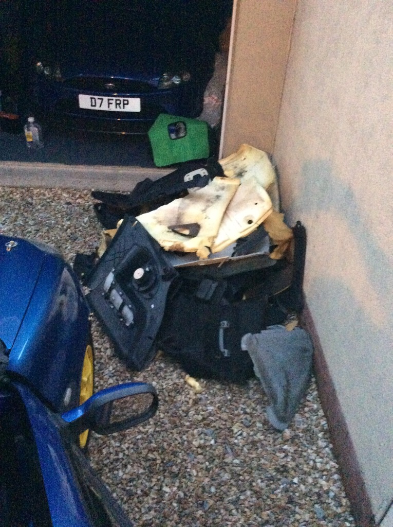

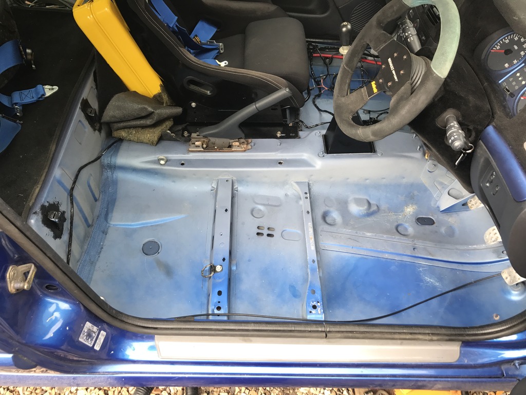

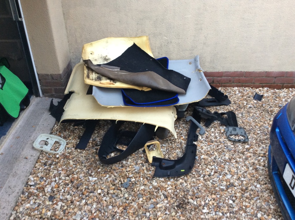

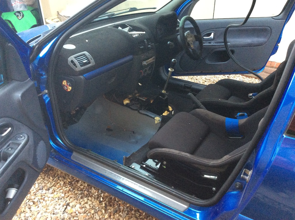

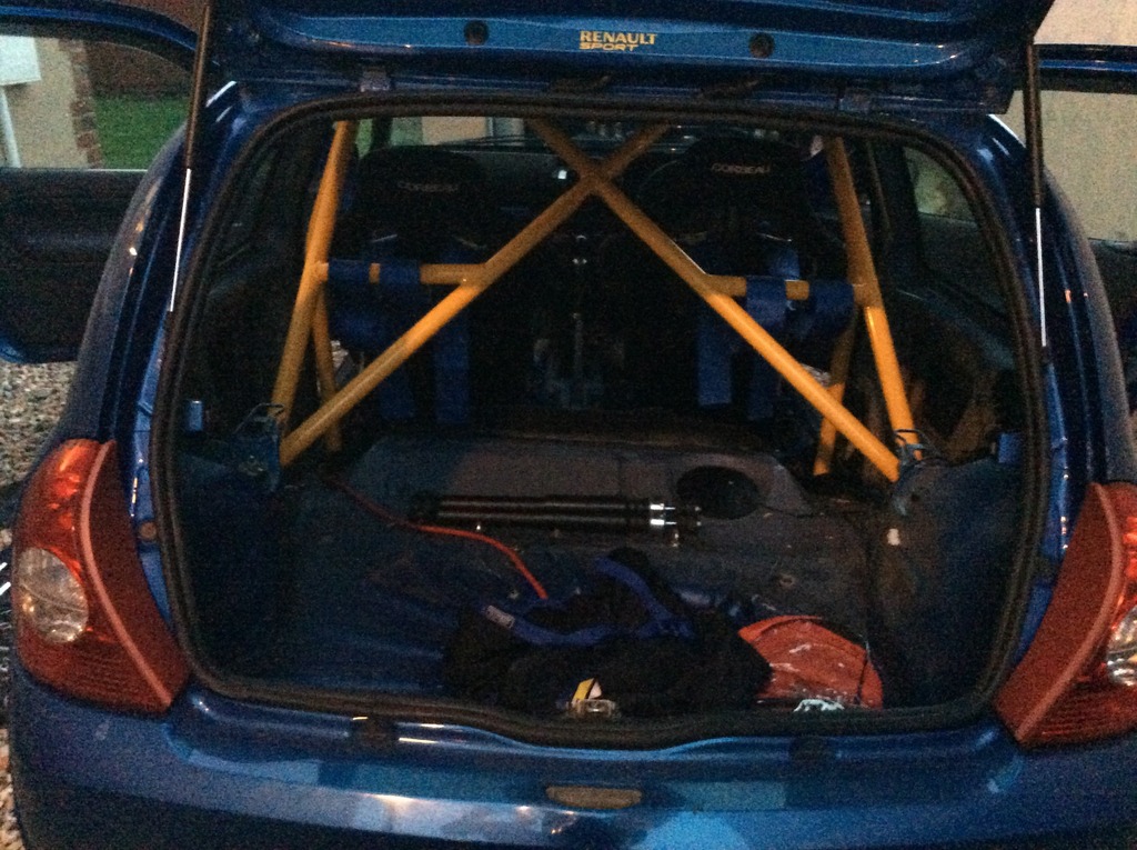

So its started

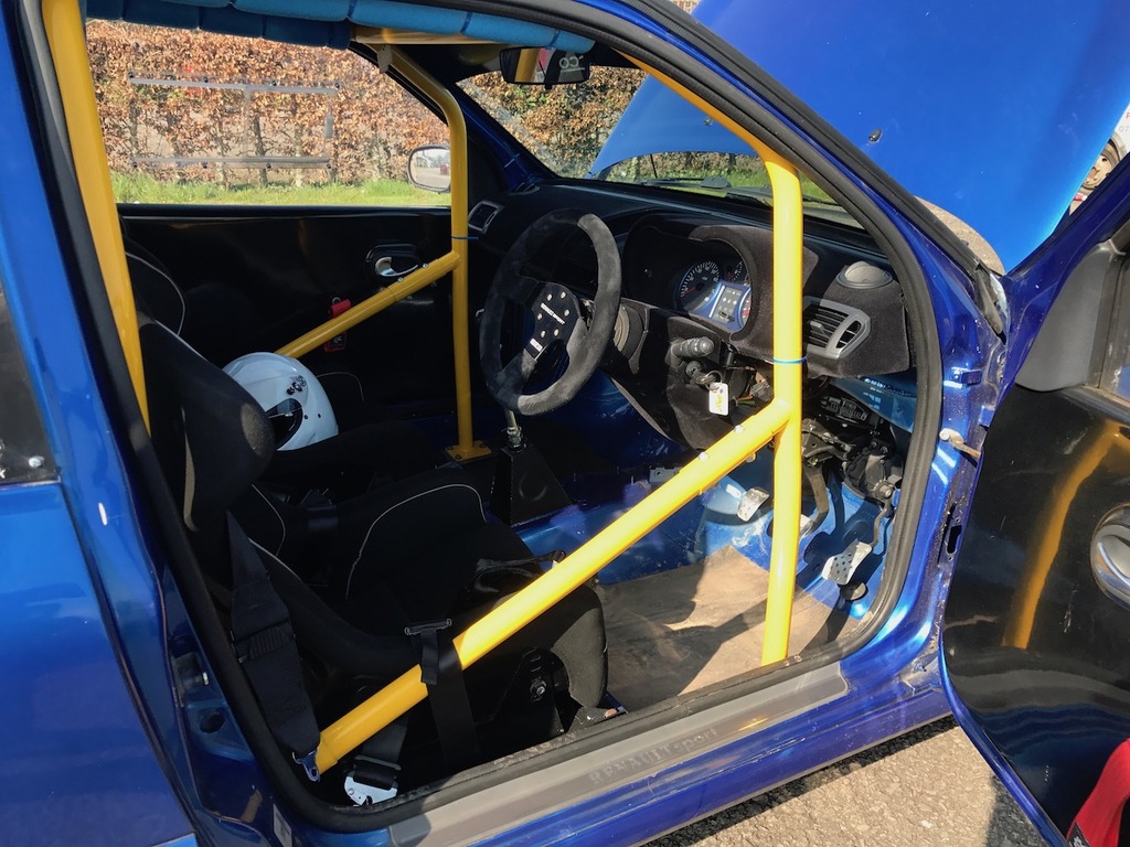

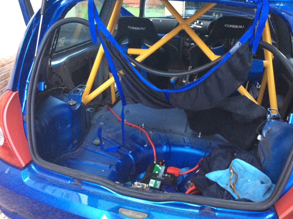

To be honest when I first started removing everything I thought it's not actually that heavy, but it soon adds up, that pile has a fair amount of weight to it, will total it up to see how much I've managed to shift. TBH probably won't even be the weight of the cage ��
By tomorrow I should have all the other bits out as there isn't much left.

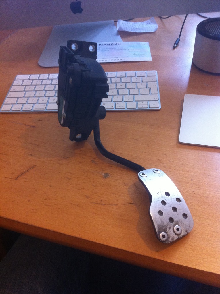

So sorted out a replacement pedal to eliminate that as a possible issues with the car going in to limp mode.
I let the car warm up and took for some what of a hammering, god what a car, bloody love it, thought after driving the M5 it wouldn't feel as good as it used to, but it felt even better, such a raw feeling of driving, so loud, angry, snatchy, grippy, not to mention I can pedal this where as the BMW its all about straight line for now. However this was short lived as the car went in to limp mode again a couple of times before returning home :(
The thermostat is obviously still playing up as it was kicking in around 6600 instead of the potential 7200 so thats the next thing, drain the fluid and swap over, hoping that its something to do with that all be it unlikely.
Really hoping to get it sorted now, as really want to attend another track day before the bad wether sets in.

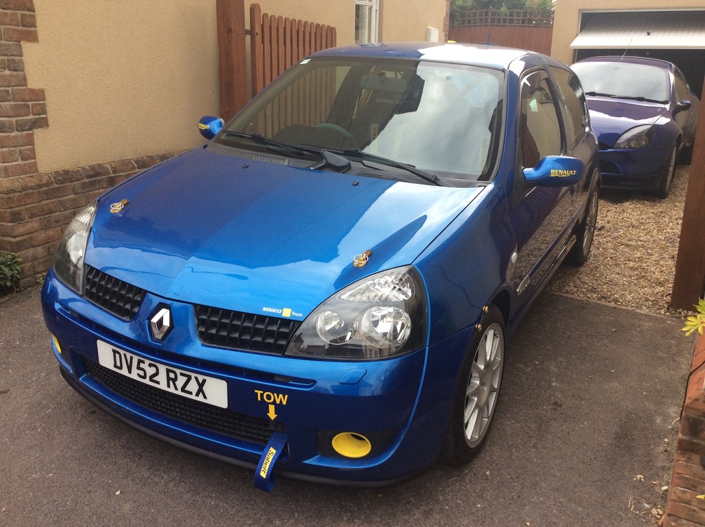

Managed to find time this weekend to give it a good clean, before putting away till the new year in a mates garage.

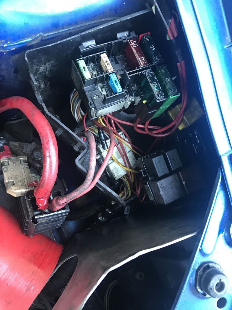

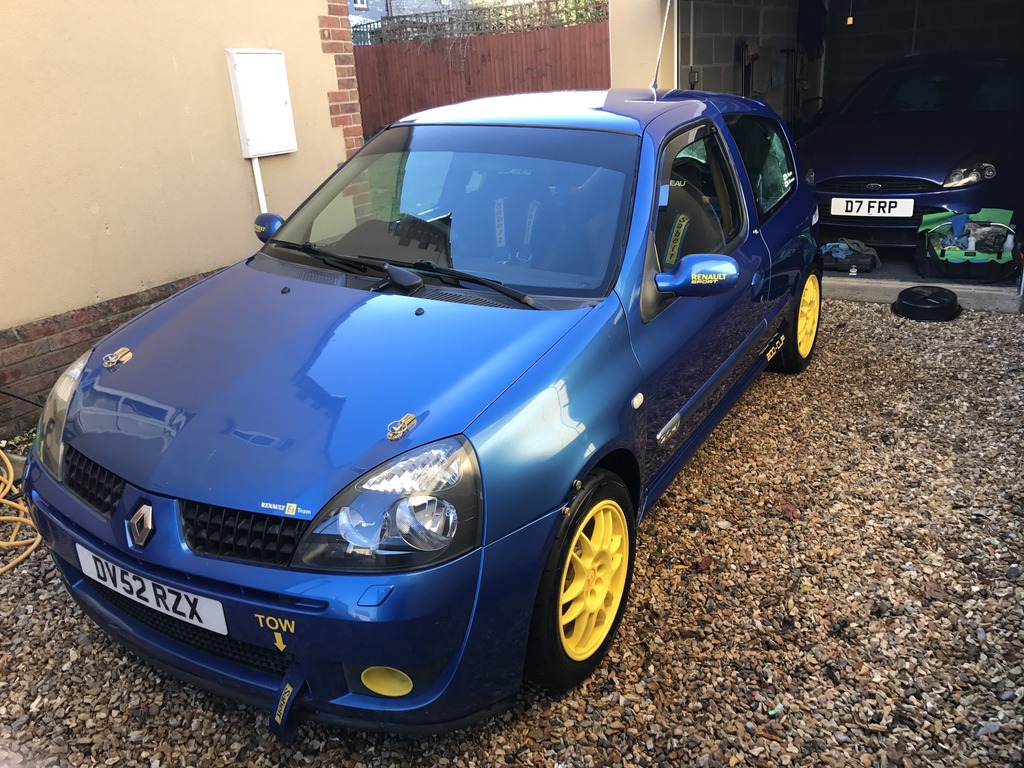

I've got a track day at Combe on Friday so it was time to get the car ready, and surprise surprise more electrical issues, this time starting issues again!
I got so fed up, so anyway checked the battery earth, checked the earth strap on the gear box, still not luck, eventually removed and cleaned the crank sensor and still nothing. Battery was literally brand new as I replaced it that morning.
So after taking some advice and instead of just checking the fuses and relays I removed each one and cleaned up the pins and cleaned the holders with WD40.
Anyway once all refitted car fired up first time without anymore issues and has been fine all evening after starting a number of times, so hopefully thats that sorted now moving forward.

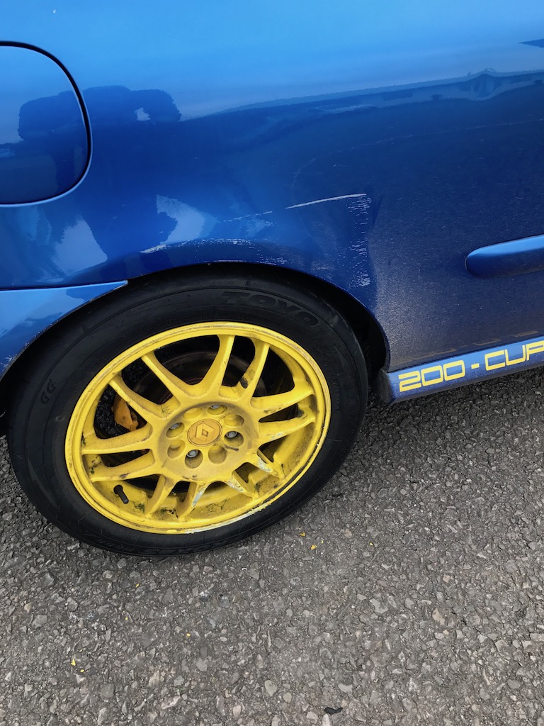

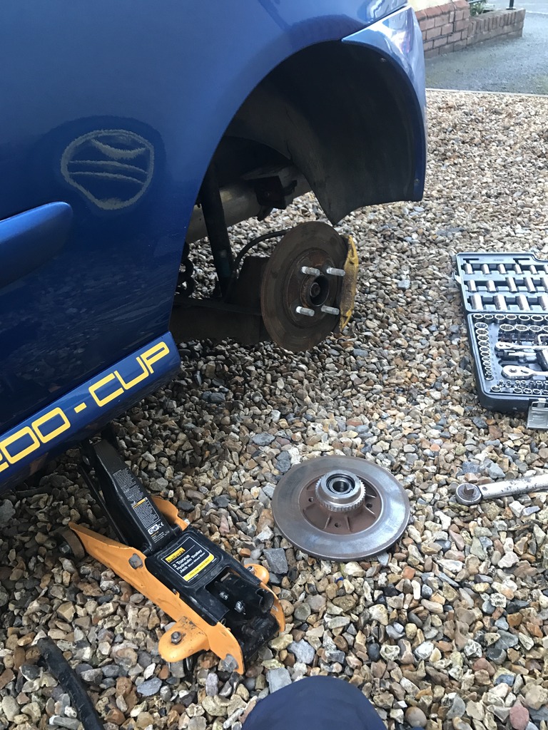

So then it was on to the rear nsr calliper as it has seized and caused the rear disc to crack, was also a good chance to replace the rear pads and bleed the brakes.
So that was this evening sorted, took for a drive and I've fallen in love with it again, what a car, the new tyres R888R are fantastic and really looking forward to trying them out properly.
Forgot how noisy it is now what its been stripped, but what a toy. Roll on Friday.

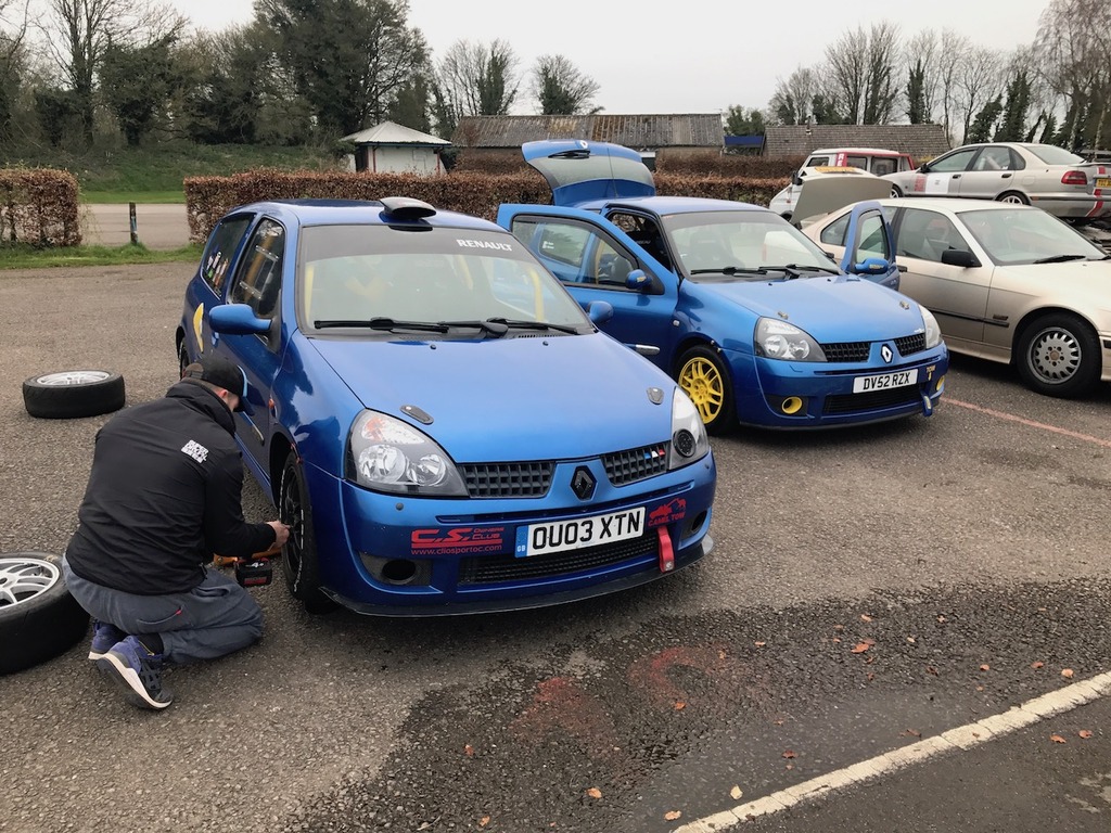

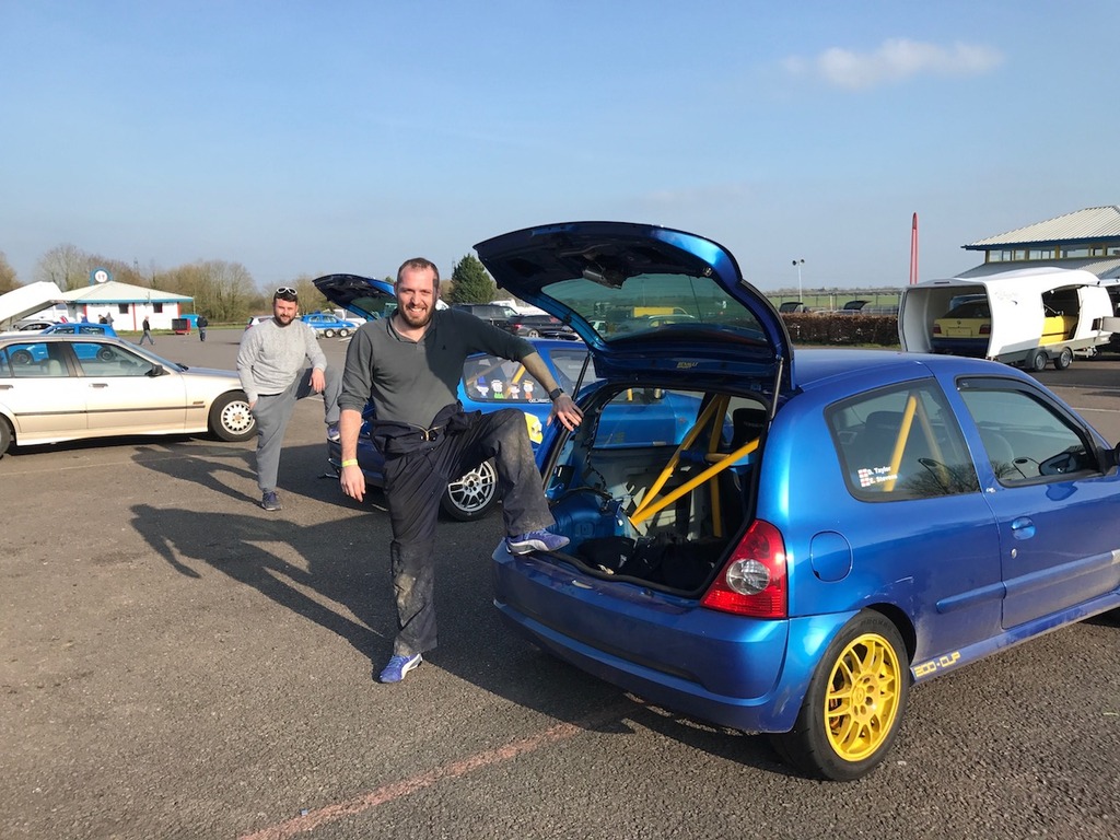

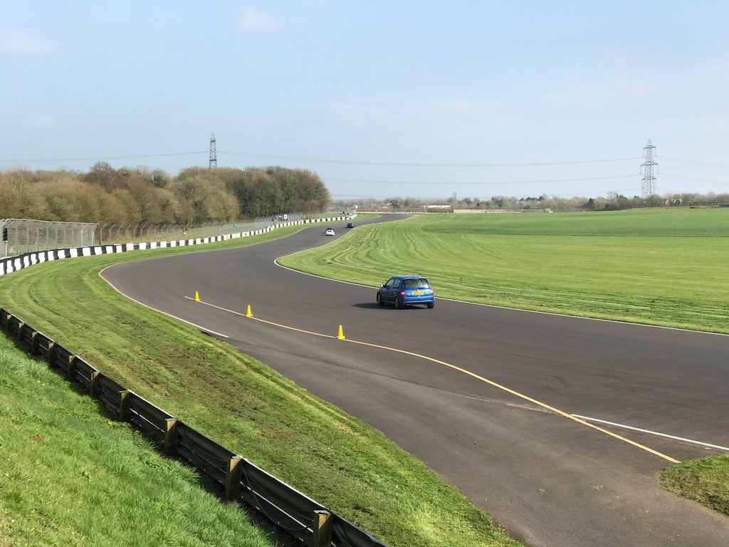

Better late than never I suppose, so Castle Combe track day.....love it, what a great track. Took a while for the confidence to grow but come the end of the day we where lapping at around 1 min 28 seconds and considering there was 2 extra chicane coned sections it was a respectable time.
R888R tyres and DS2500 Wow, game changer stopping power was stunning and never had the car felt so progressive with tyres and be so controllable.
My mate taking the car out for a heated one:
Great to go with a mate in his newly purchased track car, he has coil overs and I took his out and yeah huge difference 100% a mod for mine in the future:
Had a great day, did have an incident before lunch time where I was crashed into with someone over taking on a bend, however I was very lucky as he hit my wheel and caused only cosmetic damage, he on the other hand knocked out his steering rack and ruined his day:

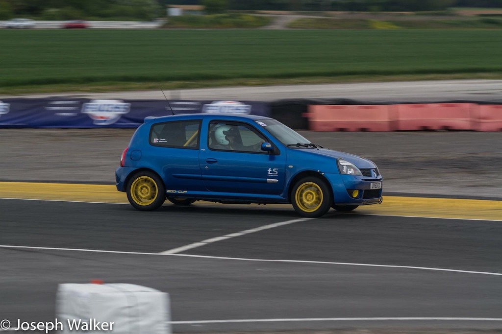

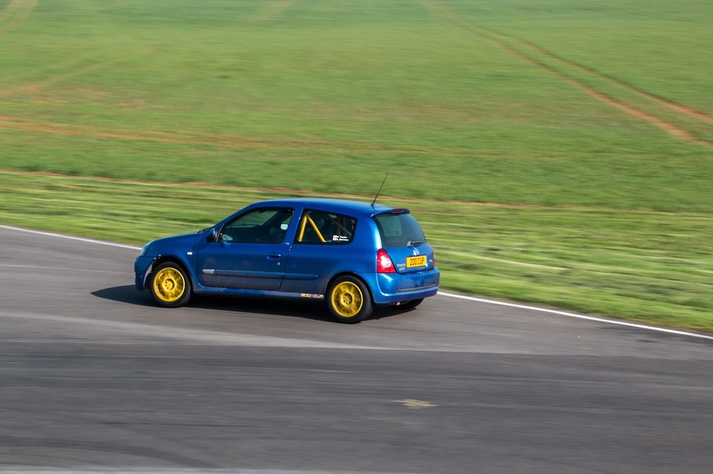

Few track snaps:

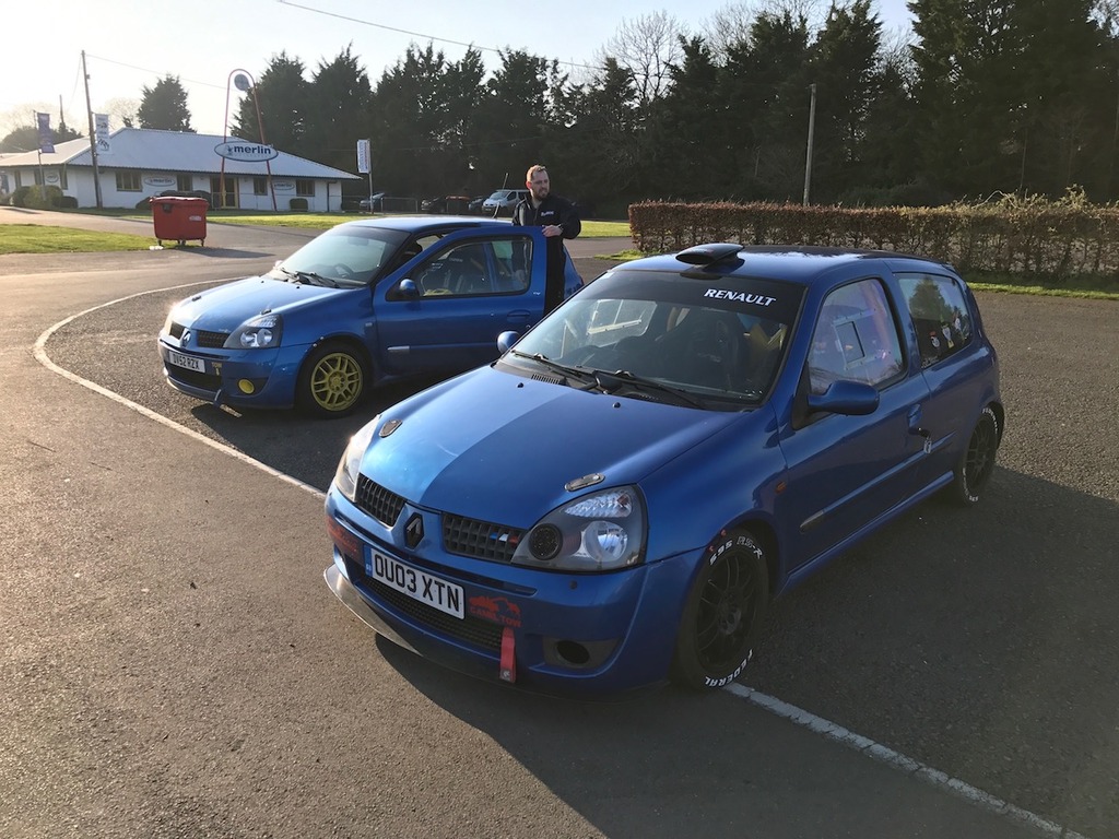

So next outing pretty soon, 7th May Blyton park on the Clio Owners Club Weekender. Cant wait!

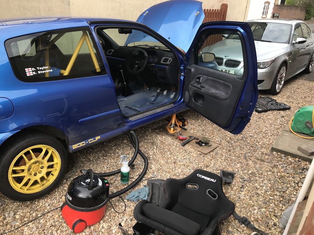

So been busy getting a few things sorted on the Cup ready for this Sunday at Blyton, first off was to get the car jacked up and check everything is in order and get ready to change the starter motor:
Managed to change the starter motor over without to much hassle and not having to removed the manifold :) I also fitted the heat shield so should stop the heat damaging the replacement one. Whilst there I noticed that the bottom of the radiator was lose so I used some trusty zip ties to sort that little issue.

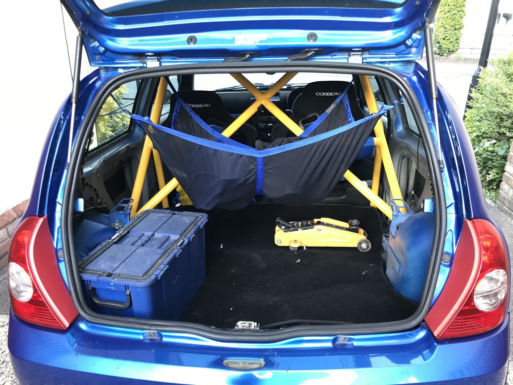

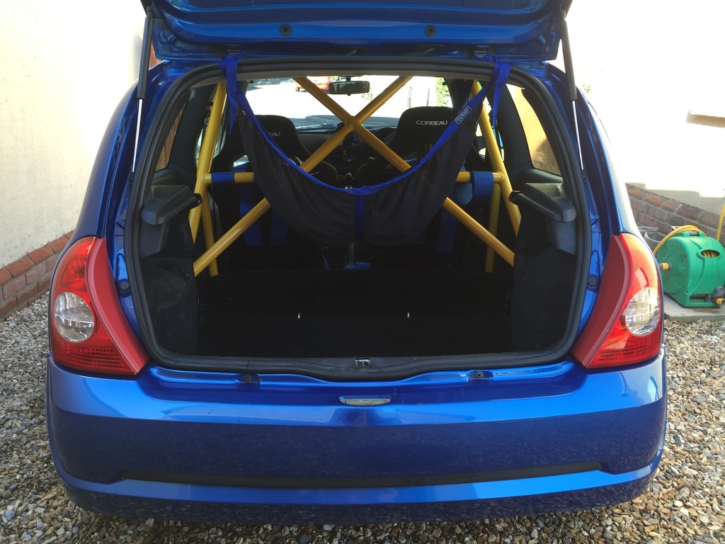

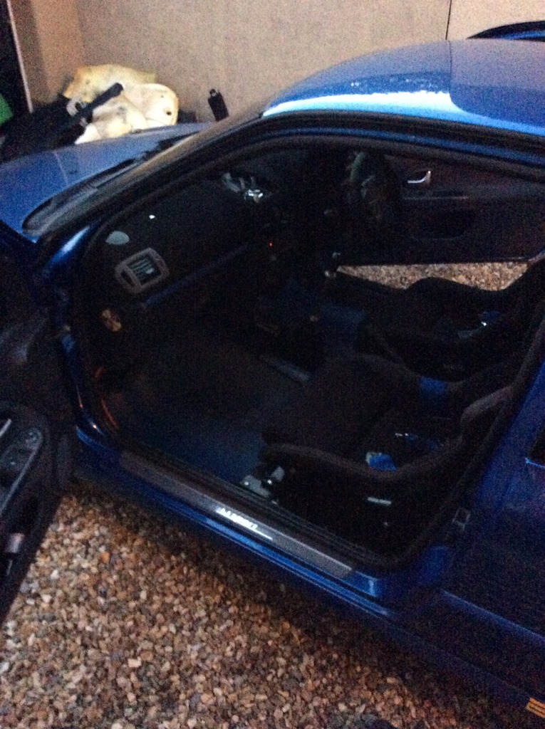

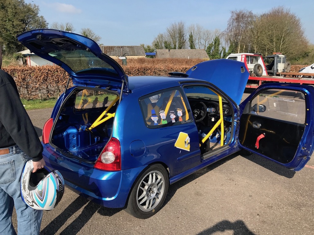

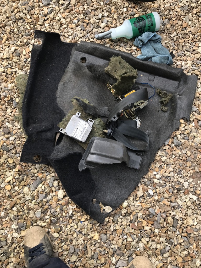

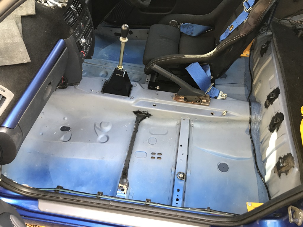

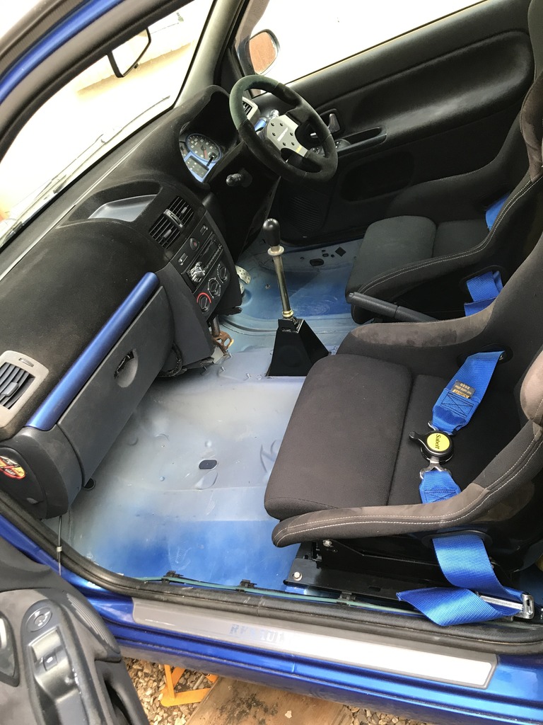

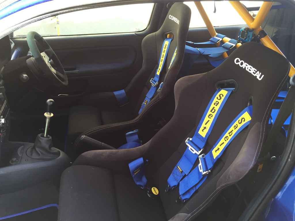

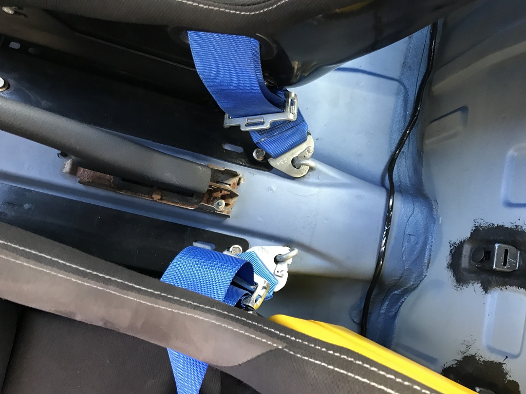

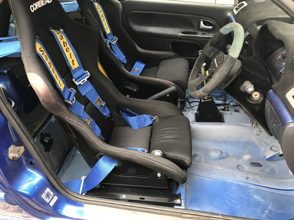

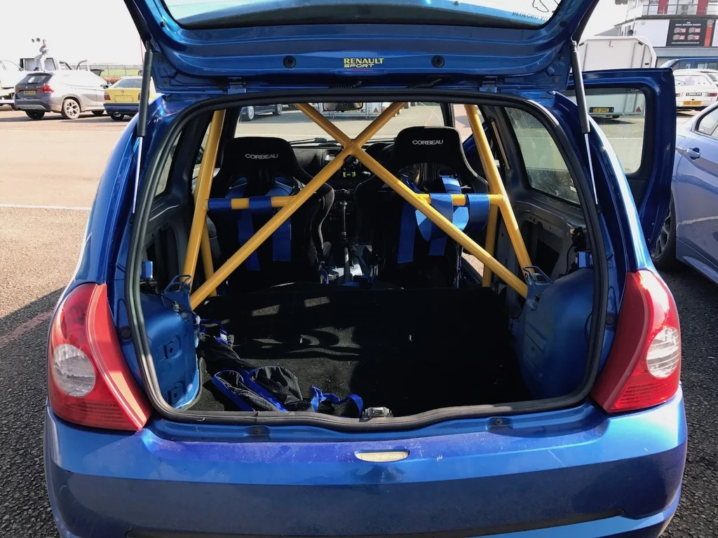

I then removed the front seats and finished stripping out the rest of the interior from where I hadn’t done in properly previously. I also removed the airbag ECU and lots more wiring.
All adds up:
Passenger side:

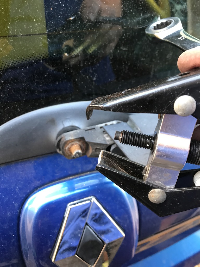

Should of applied some WD40 to the rear wiper blade before trying to remove, snapped my tool. Eventually had to hacksaw it off:

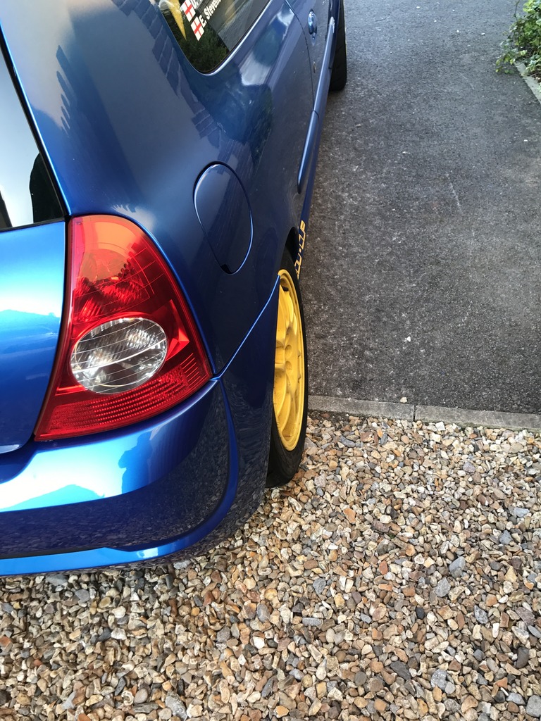

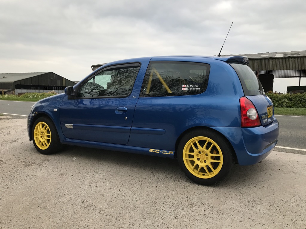

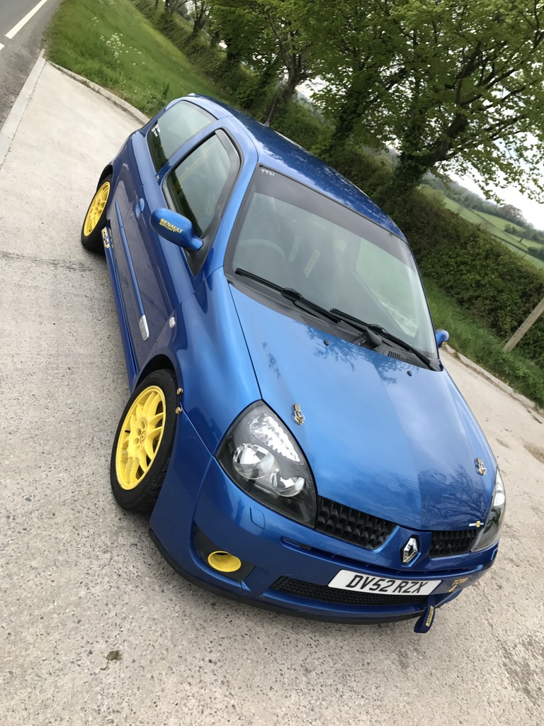

Last thing to do was to swap the front and rear wheels over, it does however seem as if the impact has shifted the rear beam over, it was more to the one side but its defiantly further over now. So after this weekend at Blyton before the next track day I need to get a replacement one.
After that there was just the to give it a wash and a wax:
Applied some stickers from my mates company, highly recommend for Renault and Peugeot parts.

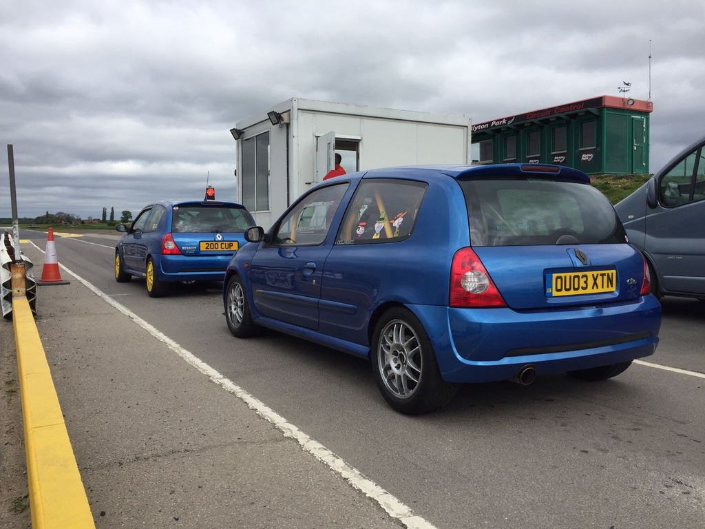

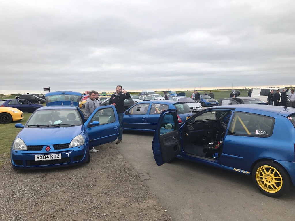

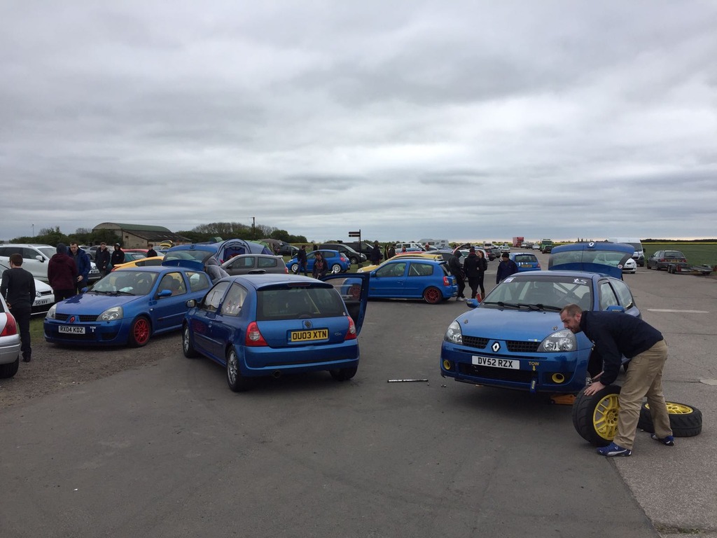

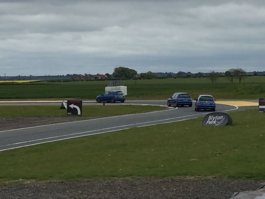

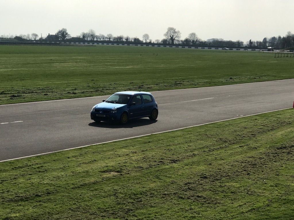

Blyton, well what a day left the house at 5:30am and didn’t get home till 10:40pm and did over 600 miles but what a brilliant day.
Morning excitement:

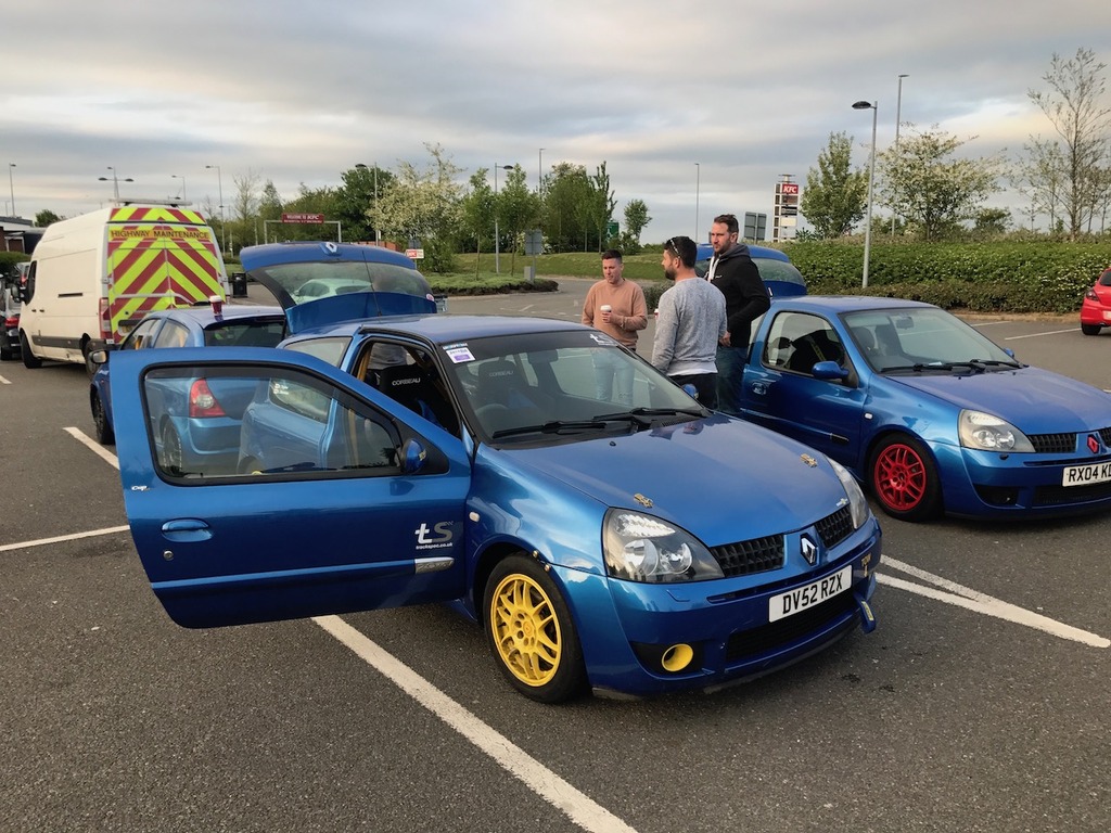

Service station to meet the other lads:

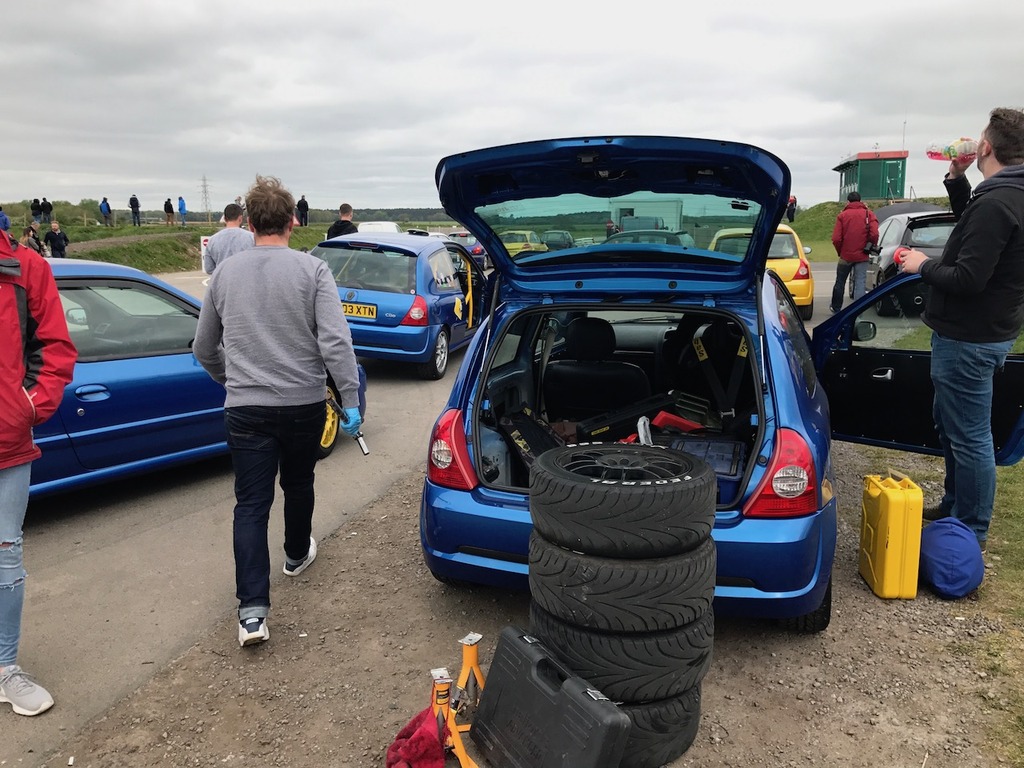

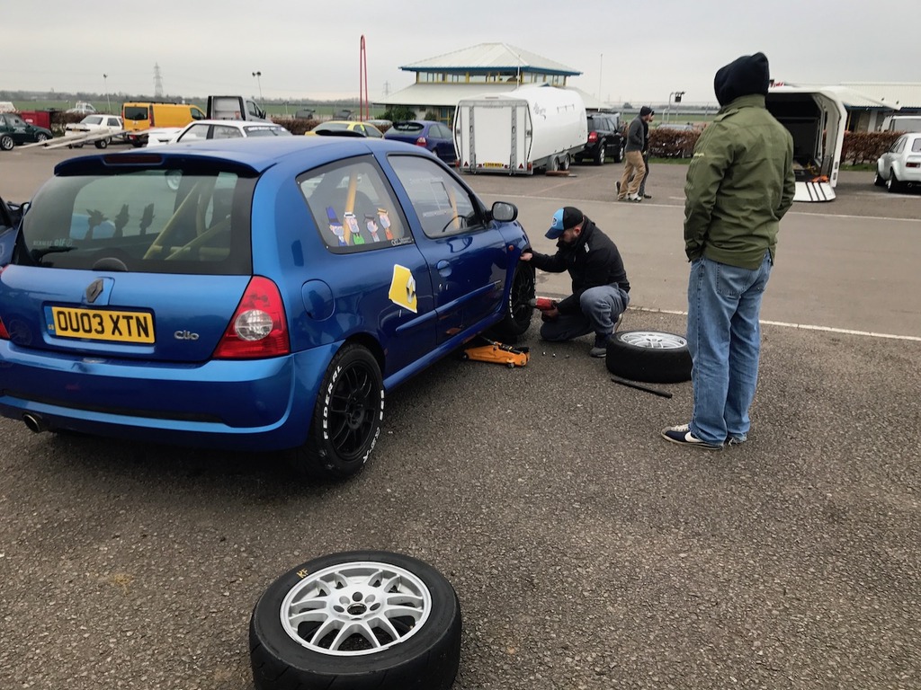

Checking tyre pressures and shifting tyres around for equal wear.
Itching to get out on track:

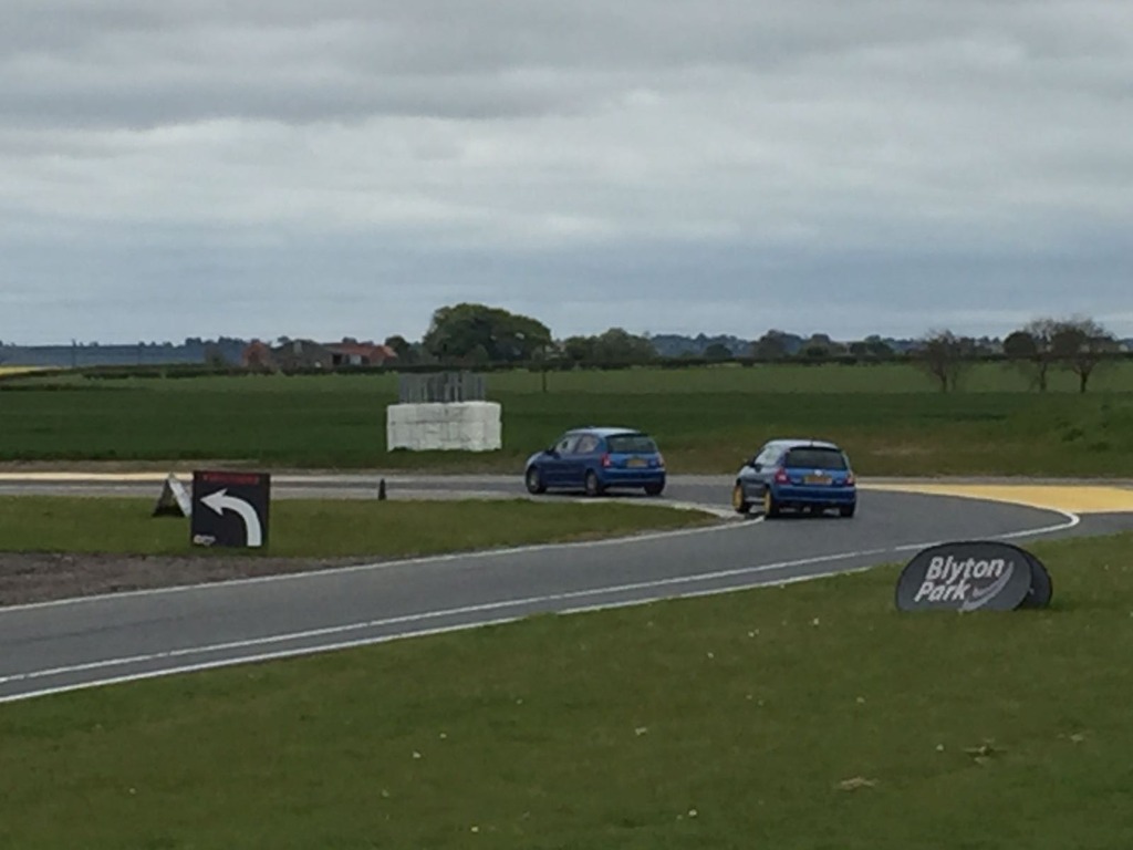

Took a while to get used to the track in the morning and after myself and my mate went out and had done a few laps we decided to re-connect the rear ARB as since I was last used I have replaced the tyres and rear bushes. We are so glad we did as the next few sessions the car felt great and so much more controllable.
Little video of the morning session:
Clio 172 Cup - Blyton - YouTube
Slight issue with the car with the fan not kicking in again but whilst out on track the temperature stayed at the midpoint. Also to note at this point how bloody good the DS2500 pads where, all day absolutely brilliant.

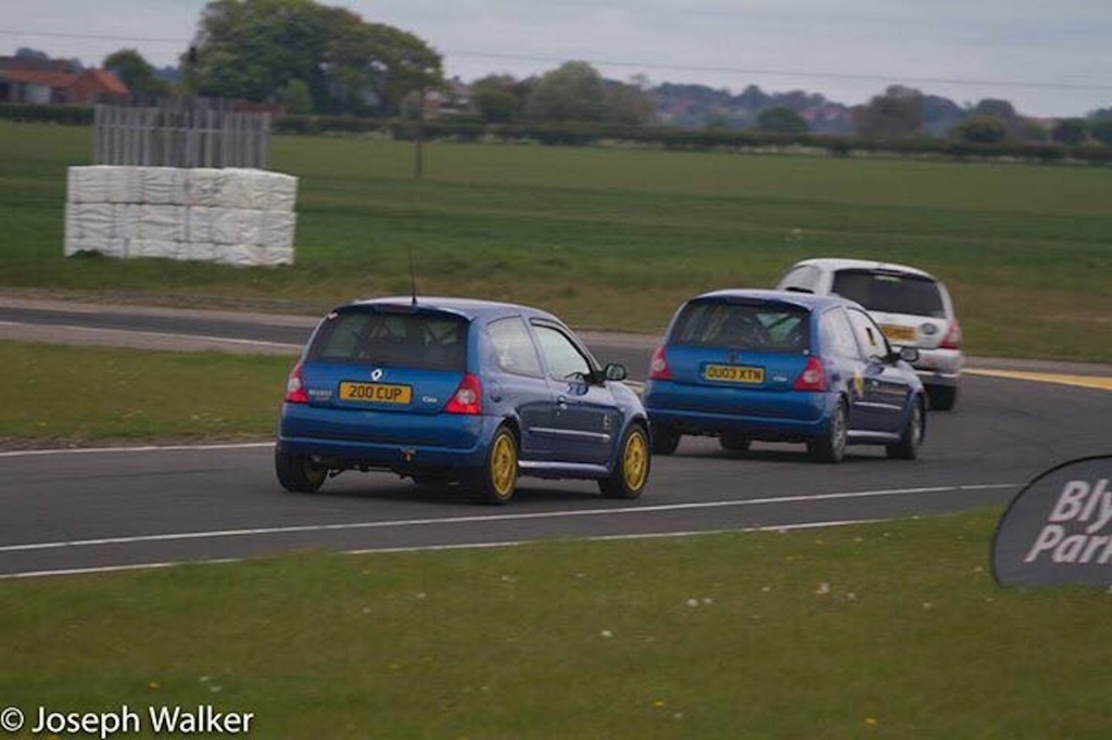

Me and Tom who owns the other Cup where battling relentlessly and god knows how many laps we put in but it was a lot, unfortunately the Go Pro’s ran out of battery so we had no footage of us going head to head but was great fun as they are both very evenly matched. Where he has the better suspension I have the more BHP.
What I have noticed is that as I don’t have a motorsport gear box mount but a motorsport engine mount and dog bone its putting far to much stress on the standard mount and I must get this replaced before the next track day as its allowing far to much movement and its knocking.
Here is a video of me doing pretty well against a lot of the other cars there on the day.

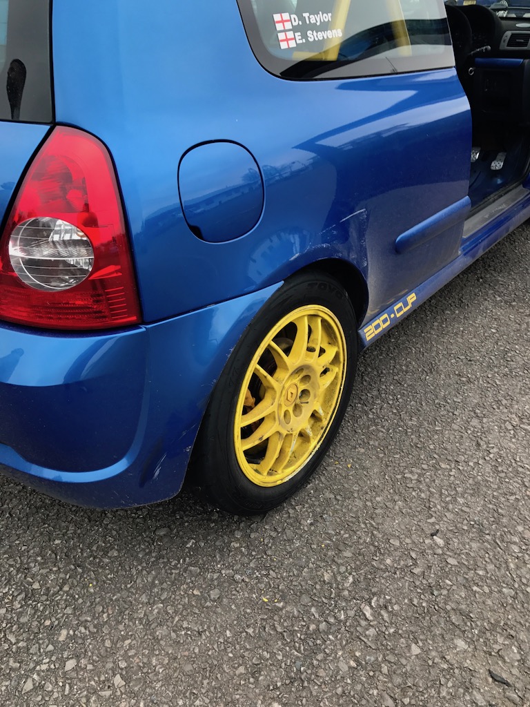

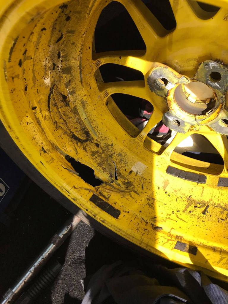

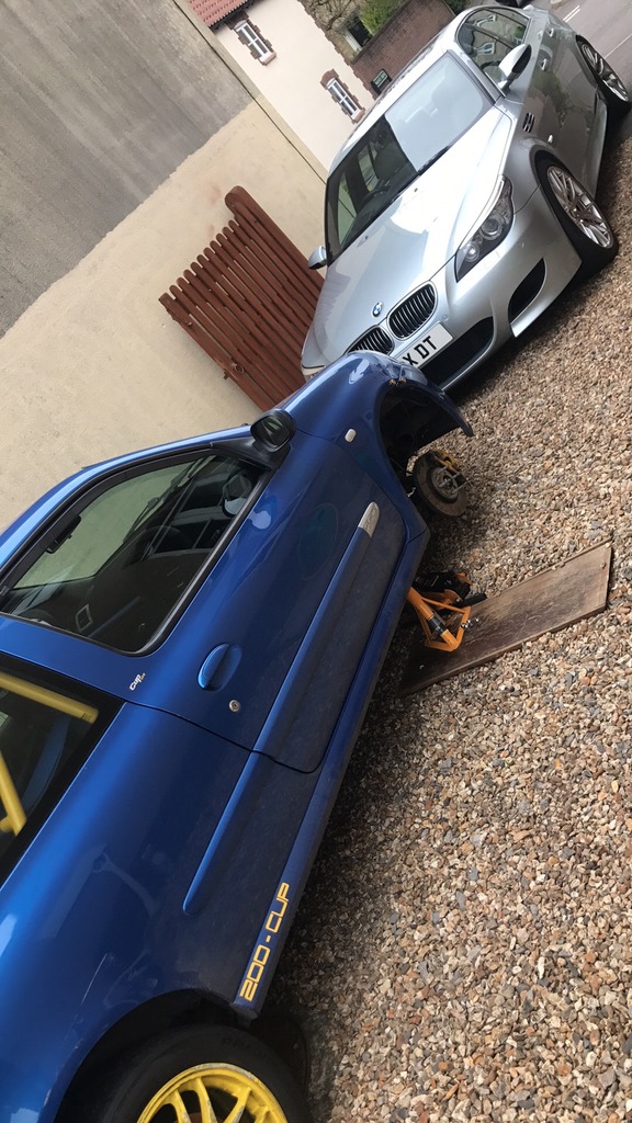

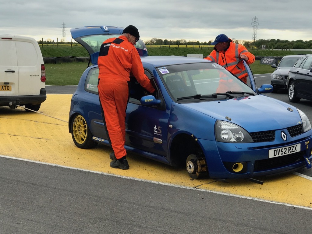

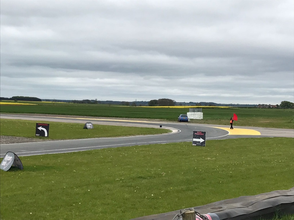

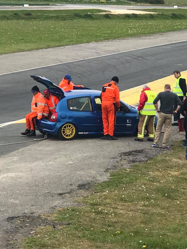

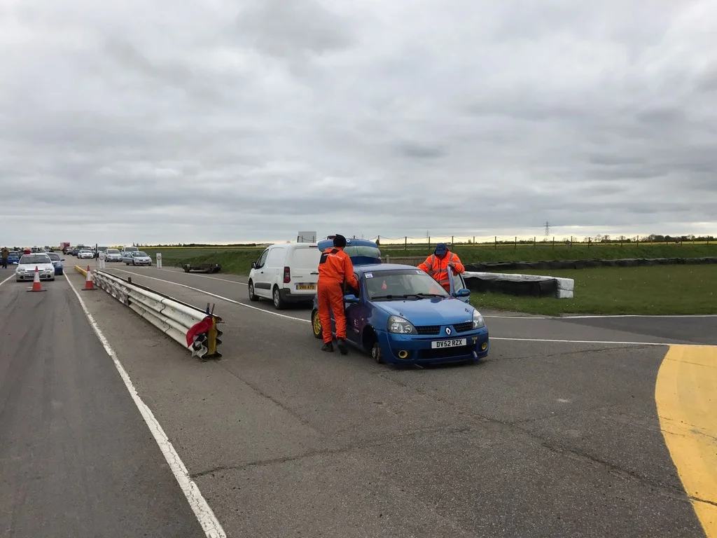

Now around 4pm towards the end of a good few laps and really pushing the car, disaster struck, round the slowest corner of the track (the start / finish) my wheel decided to leave the car, cheap eBay studs snapped. The wheel over took us and went off in to the field. I was expecting to get out to see the whole front of the car smashed up but apart from the disc which was no longer round, the front splitter being smashed to bits and the callipers being on fire lol it didn’t seem to bad.
Can see the smoke from the callipers:
It wasn’t long before the marshalss had the fire put out and had the car removed from the gravel trap:

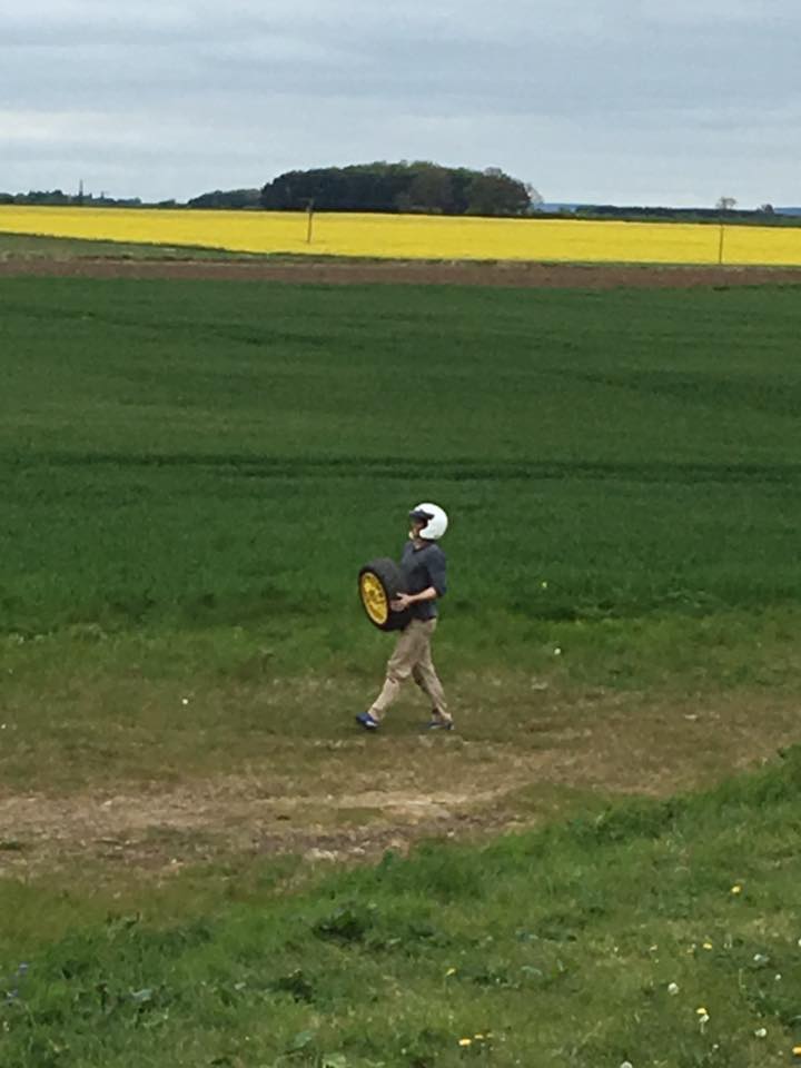

Meanwhile I went off to find my front wheel:
Needless to say the wheel was ****ed from where the disc had struck the alloy:
Now I was very lucky to get away with the damage I did tbh and that it didn’t happen on a quicker corner, in order to get home I needed to borrow a wheel and drill out the snapped off studs in the hub, we managed to get two out and I careful drove home stopping every so often to check they where done up enough.

So given the fact the bloody wheel left the car I think I got of lightly. I would just like to thank my mates that where with me for helping me out and all the marshals and other Clio owners who lent me tools and a hand to get the car back to a suitable state to drive home.

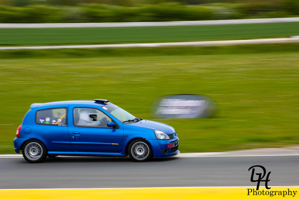

Thanks to those who took these great photos of my car out on track :)
