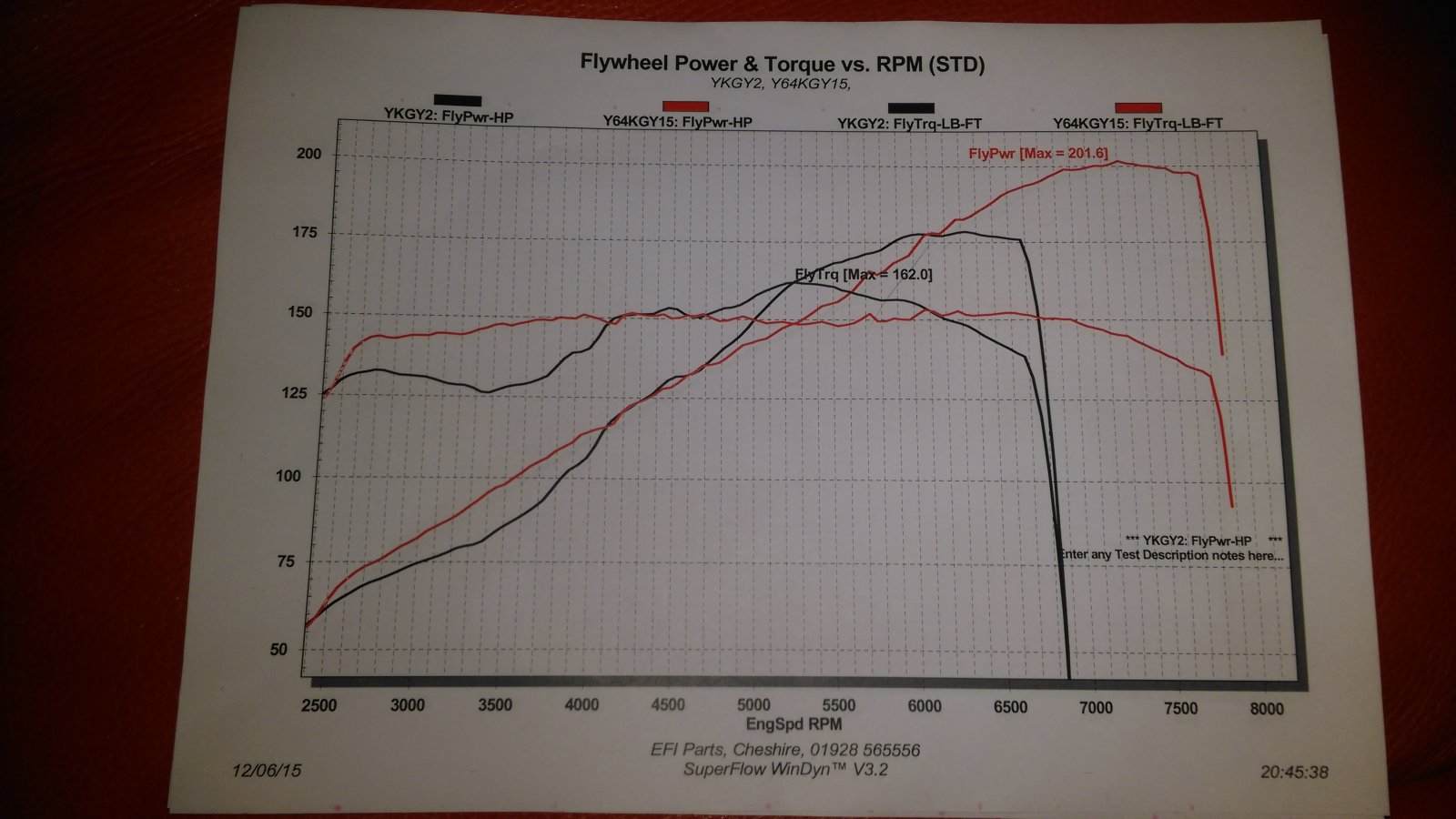

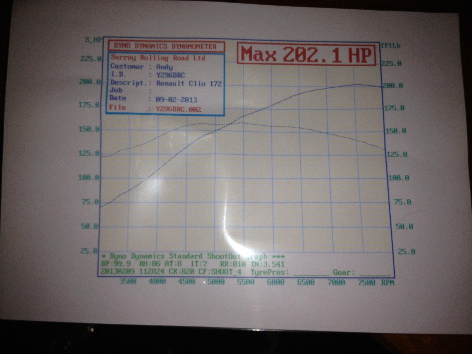

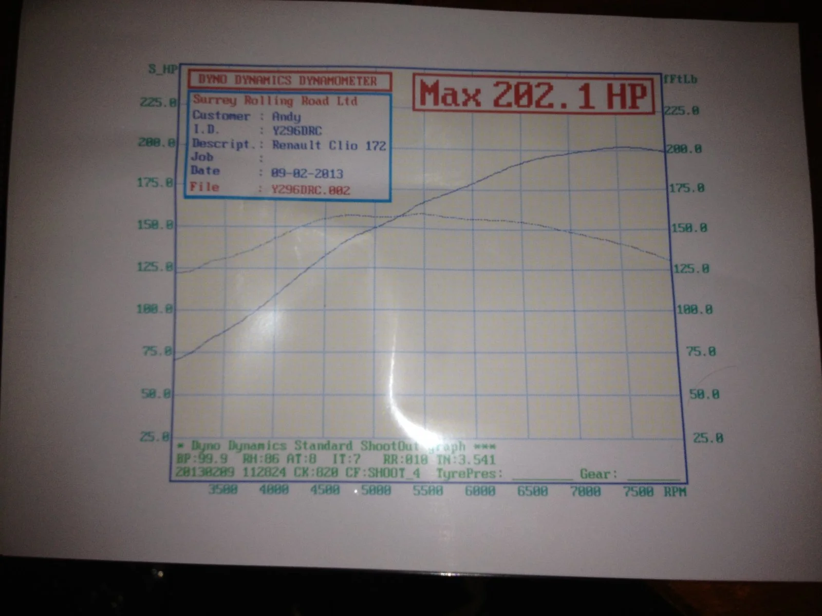

  Hi comp phase 1
This with standard head and high compression bottom end with ITB's.
green
  Hi comp phase 1
Bloody he'll that goes well. What's the spec your running?
My spec is
DTH throttle bodies
Block prep,84mm Forged pistons and rods 12.6:1,re faced head and valves, standard 172 cams
I was just after a bit more power to make it a bit more exciting to drive. Once it's warmed up fully, it's like it has another 20bhp.
Have had this engine 4 and a bit years, 20odd thousand miles of road and tracks and never had any problems.
It's definitely an event when going out for a blast!
