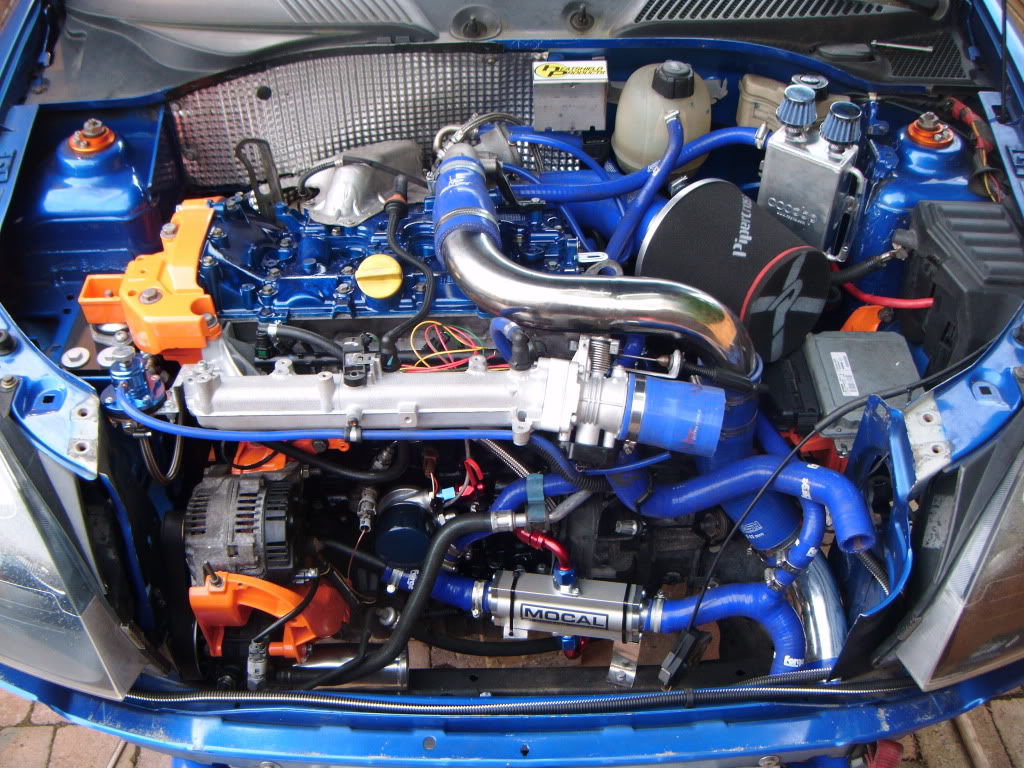

That's a nice setup you have there! Very blue :)
Do you have a link to the oil cooler kit you are using?
So you would recommend a catcher tank but make sure there is enough for the pressure to escape! Was it expensive to repair your crank seals ?

  172 cup, Impreza P1
Thanks
Thanks mate! :)
The catch tank is not fancy. It a bulkhead mounted baffled tank with the ports in the correct place for where I wanted them. Got it off ebay for about £50 iirc.
IME a catch tank is definitely needed on turbo cars. No one in their right mind would run a performance car with oil vapour spraying all over it when giving it the beans. I have heard a few stories of fires caused by that. Chip wrote something about losing a lot of oil through his breather to a catch tank and then into another separate catch tank as it was so bad. This was quite extreme but if you had an issue that your car decided to spray already hot oil vapour onto a very hot manifold or turbo, you can see why there would be an issue. The full catch tank install on mine cost about £65 and took about 10mins to fit once I decided where to mount it. For that reason I cant see why you wouldn't fit one.
The crank seal cost about £12 and as I was doing other work on the engine not much more time but you don't want to be changing them a lot thats for sure.

Thay was my logic, due to them being readily available and cheap to implement why not. I was thinking about just getting small one and bolting it to the bulkhead. Can you just drill straight into it tho I wouldn't wanna do it and end up spilling wires behind the dash! I can see what you mean about a turbo setup last thing you want is oily air going on a hot turbo! Could make a mess

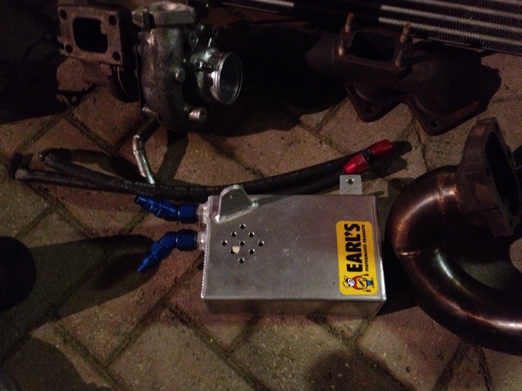

Steve do you have a link to your catch tank can't find and double filter ones on eBay. As mine has 2 outlets on it and no filter so just going to buy one with 1 hose and 2 filters like yours
Also your engine bay looks f'ing unreal!
  Ph1 T
Rubbish picture I know but this is mine.
Could I just use 1 inlet and make the other a breather with filter then? Or are 2 filters needed ideally?
