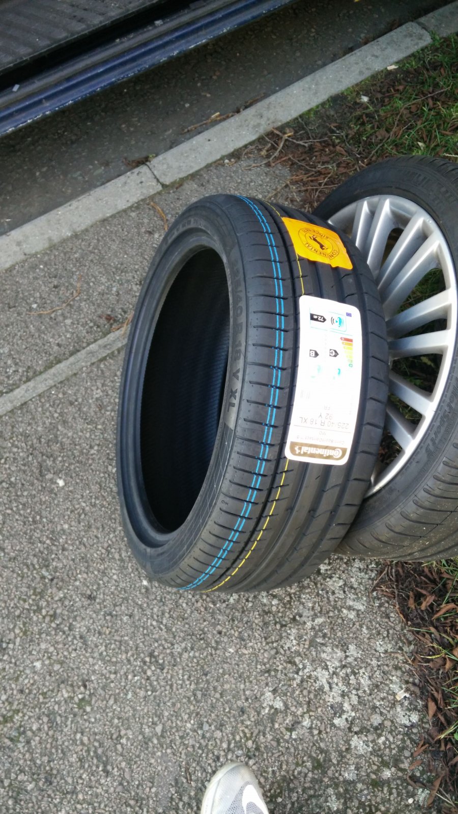

New tyres ordered, fitting on Monday. Fuckayou Golf, you have finally won.
So costs in the last month..
Wheel refurb @ 285
Insurance @ 312 (which is about the same as the M3 was)
4x Conti Sport Contact 5 @ 384 inc balancing etc usual s**t
Just a smidge under a grand. Birthday next week, going to buy myself a shotgun

Was updating my post as you quoted! Sport Contact 5's, same as I put on the M3. Sooo much grip.
Winter tyres are mostly irrelevant for the UK, aside from the one time it snowed and they were actually useful on the Clio.
I just changed from conti 5 to the new Goodyear f1. Much better for daily use.

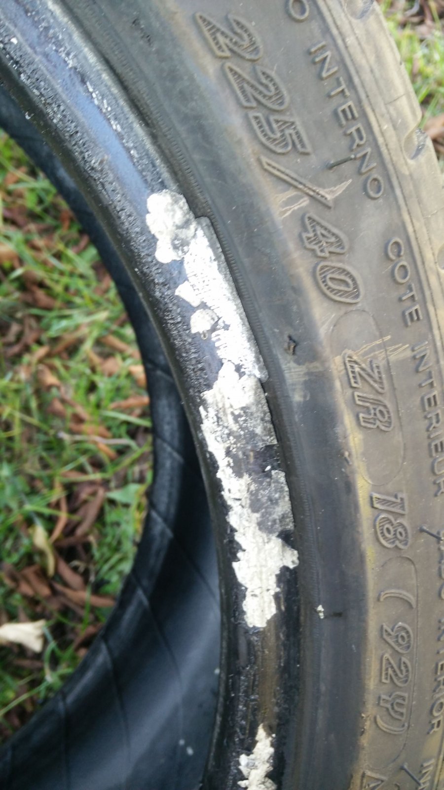

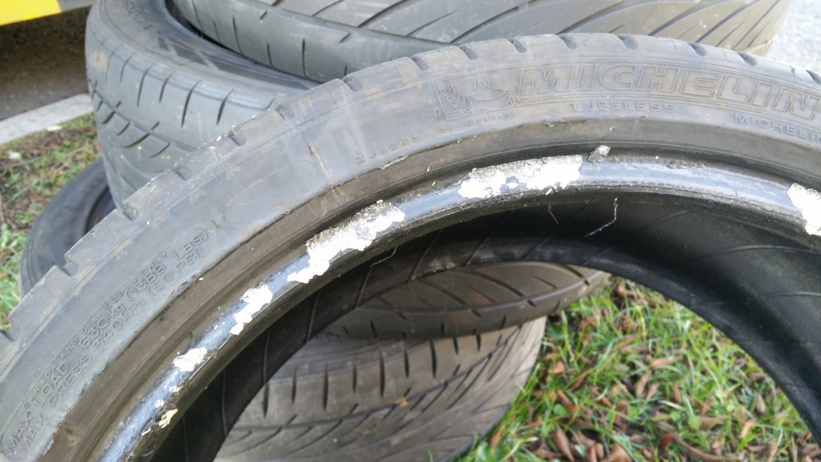

A selection of images. Think I found the reason the tyre leaked

So it's exactly what I thought all along. I thought you had someone remove them, clean and refit? 🙈
The fitter I took the car to originally clearly didn't check the bead on the inside of the rim, just outside
The guys that refurbed the wheels a month ago also didn't think to mention it!
