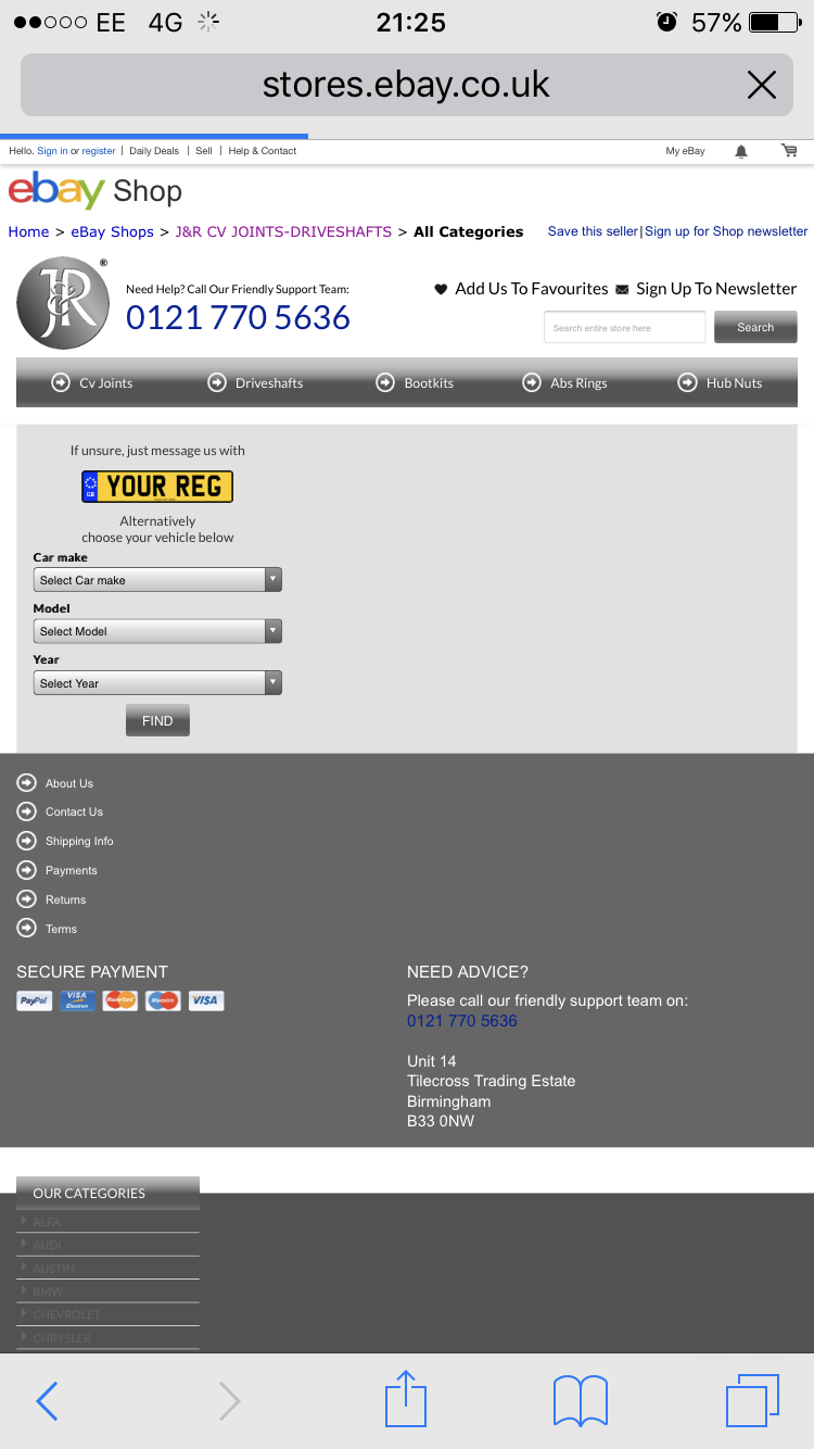

Are there specific boots for these cars, or should I go universal? ECP brings up just two inner boots when I search by car type, and 8 different universal ones with a general search 🙈.
Do I remove the shaft from the hub and slip the boot over? Some are stretchy as well, but why do they need to be any more stretchy than others. Arrrrgh :imp:😂.I've read there are split ones too, but that seems like a cheat :tongueclosed:.
If someone would be kind enough to point me in the right direction that would be super, maybe even a cheeky little linky :grinning:?
