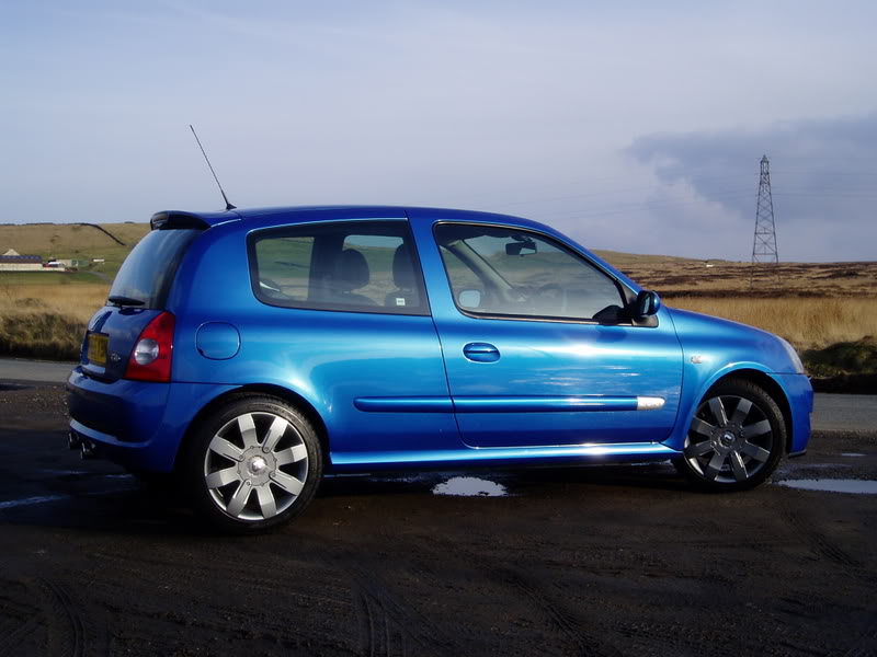

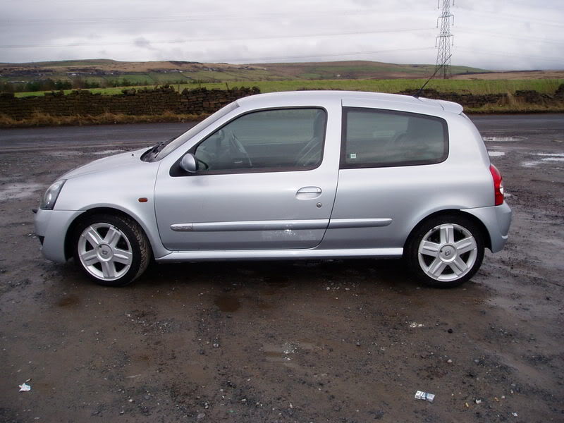

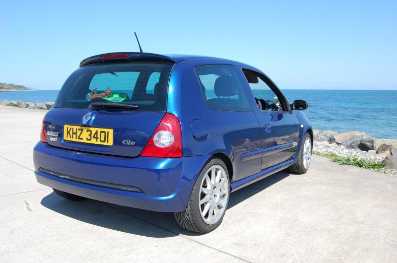

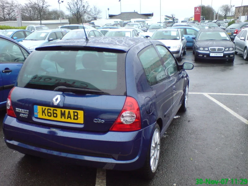

The normal 172 spoiler is curved slightly down and has a ridge across it , whereas the cup spoiler curves up slightly and is smooth .
Cup spoiler .
172 Spoiler.
