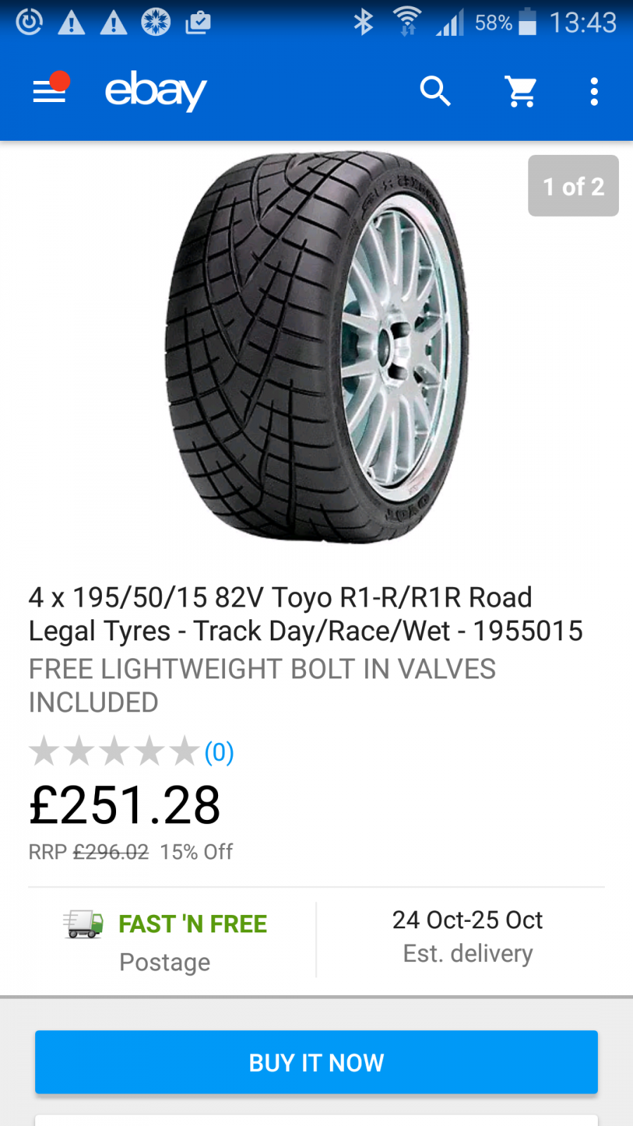

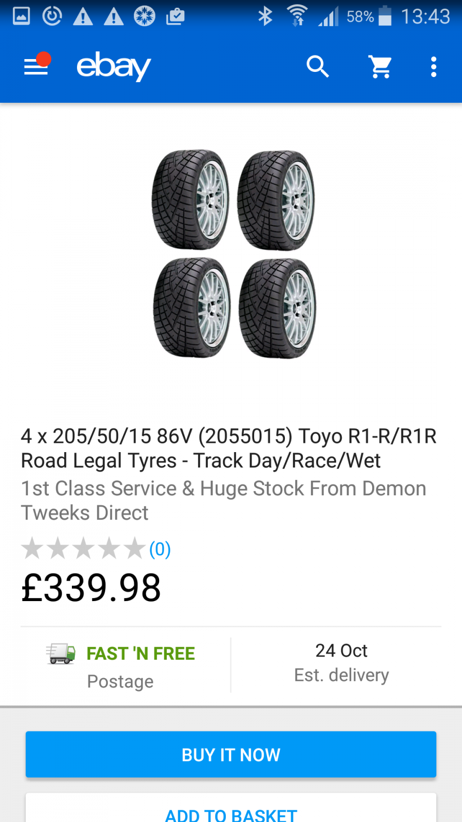

R1r's are available in both 195/50/15 and 205/50/15 for definite, I've just made the switch from rain sports to r1r's, not had the chanc to run them yet, next track day is 4th Nov so we'll see.
Great- could you post a link?
  Clio 172 Merc ML55
Sure, I got mine off ebay (195s) this is the one I ordered, arrived within 48 hrs too
And the 205's
