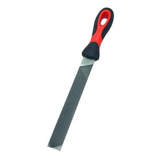

im not sure how much ill need to shave the down by, dont think I have any thing to shave them with either, would i need a metal file like this?

if not using genuine pads, i take the sliders out and also file the metal edge that comes into contact with the sliders (track where pad sits) this is usually where they jam up when they get hot, also use copper slip in the sliders, only speaking for my track 182 as i run DS3000 pads and they are tight to say the least if you don't take a little off them,
