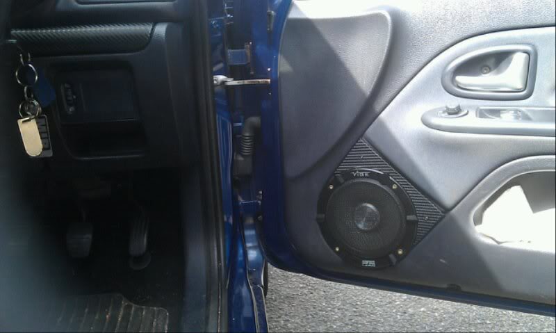

Fitting them is a piece of piss so long as you don't mind cutting your doorcards and making up a mdf ring.
Excellent, is it just the doorcard plastic you have to cut, and then fit the spacer onto the door ? Think i read somewhere 10mm for spacer, is that ok ?

can be done without cutting the card but it will be alot of work
  Renault Clio mk2

Bionic, I’ve seen your custom 6.5 speaker grills and just wondered if you had any tips on how you’ve made that? Presumably you’ve managed to fit 6.5 speakers in without cutting anything?
