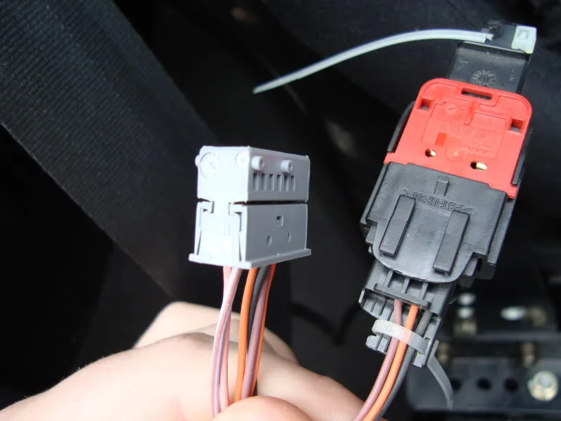

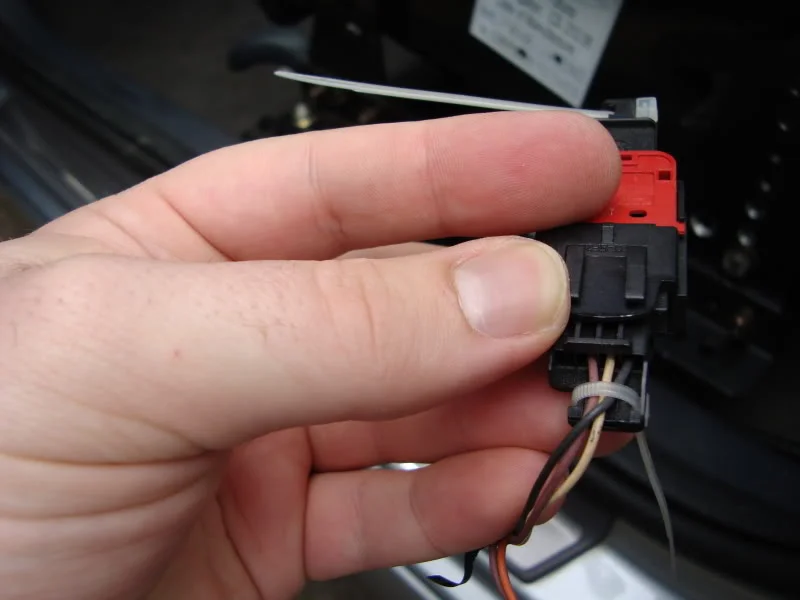

This is what I have, I have some 3.3 Ohm resistors, but where do I put them? -
  Golf GTD Mk7

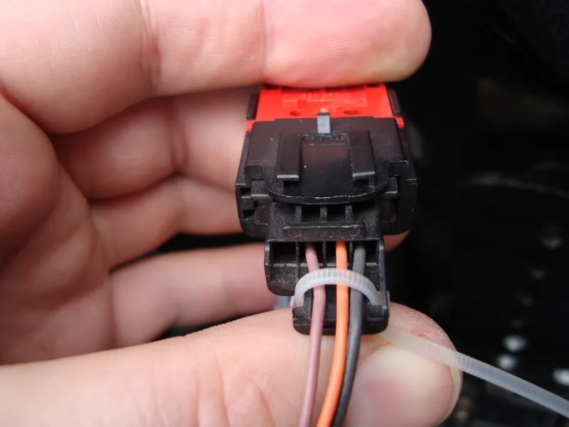

On the last picture, the resistors go between the brown and orange wires. Black is the earth. Is the one of the left the one that was attached to the seat?
Just cut the red/black connector end off, and attach the resistors to the wires Pikey style :)

So is it only the Brown and Orange wires on the Black connectors that need the Resistor?

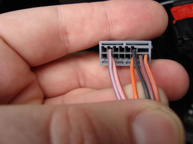

The Grey connector I presume is the Airbag connector (Do 172 cups even have seat airbags?) And the Black and Red connector the Pretensioner?
  Golf GTD Mk7
Yes to the first one.
The grey one is the pretensioner that sits into the one on the seat IIRC. Not sure which you'll need to put the resistors into on that as I put trendlines in mine, so it was like for like in that respect. Best thing would be to put the resistors in to the holes to see when the light goes out on the dash.

Ok So I'm sorted with the Black one, Nice and straight forward, Now I just need to sort out what to do with the Grey connector. :)
  Golf GTD Mk7
As said, connect the resistors to the black on to eliminate that one. Then just trial and error on the other one really. Not many combos to try, unless you've taken both seats out already ;)

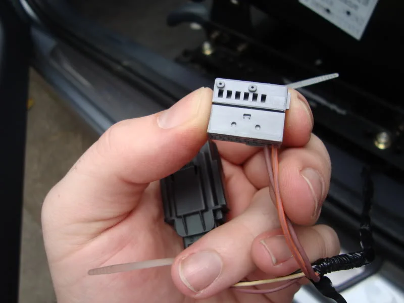

Ok, so to sum up, all you did was put a resistor between the brown and orange wires on BOTH of those connectors? Cut the plastic black and red clip off altogether and join the orange and brown wires with a resistor?
What about the weird microplug thing as shown in my pic?
On the black/red plug, the black wire is the earth, so you bridge the two coloured wires with a resister. You don't need to cut it off, you should be able to pull it apart (The red bit will probably snap)
If you're using existing seatbelts, just leave the grey connectors connected.
The bit you're holding in your hand is the seat position sensor, normally sits on the driver side rail nearest the handbrake.

Much apreesh James. I've seen your guide thanks. I've plugged in the grey block to the seat on the driver's seat and put a 3.3Ohm resistor on the same plug on the passenger side (as there was no plug from the seat as it had been butchered by previous owner).
This has got rid of my lights! Can't help thinking it was too easy!? Guessing cos it's a cup and didn't have seat airbags anyway, plus I'm using standard seatbelts?
So the seat position sensor plug and the black/red plug are now redundant and my car will be ok for an MOT?

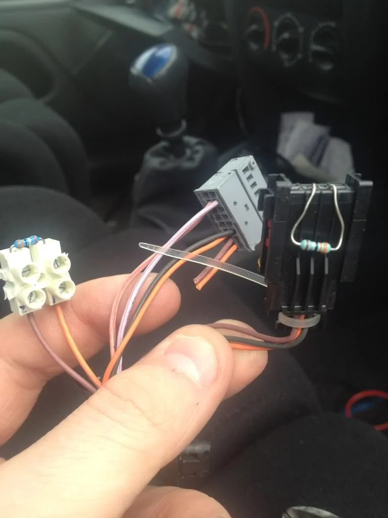

I have fitted to my car a Sabelt steering wheel which I placed two 3.3ohm resistor's between the two airbag connections I doubled over the resistors to make a good connection.
My car is also stripped out at the rear so I have placed two more 3.3ohm resistors on the two rear seatbelt pretensioners.
I have also fitted aftermarket Bimarco Futura seats not using the orignal seatbelts and harnesses instead.

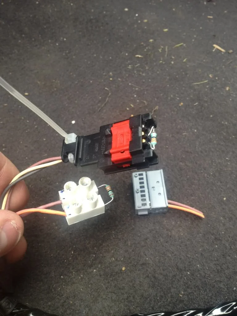

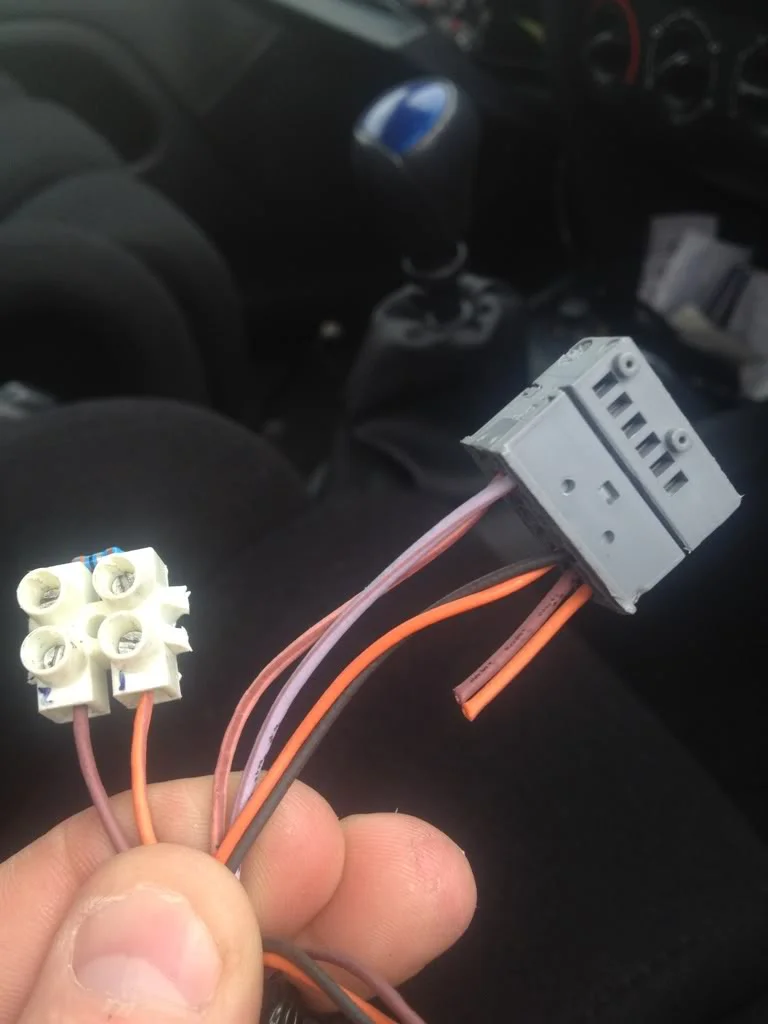

On the drivers side, one resistor is connected between the ORANGE & BROWNwire's on the BLACK/RED plug. Once the resistor was placed into these connections I used a meter which read 3.3ohms between the connections. Which I take it, it has made a good connection?
The other resistor was placed between the ORANGE & BROWN wire's again on the GREY plug. I cut off this plug from these wires to get a better connection using a coch block. Once the resistor was placed into these connections I used a meter which also read 3.3ohms between the connections.
As shown below:
The passenger side was done exaclty the same and 3.3ohm was read between the connections.
The rear seatbelt pretensioners where also tested and read 3.3ohm between them so these must also be working correctly?
Now I have done all the above and followed all the guides and my light is still on! I turn the car on and it comes on, goes off and then comes back on!
