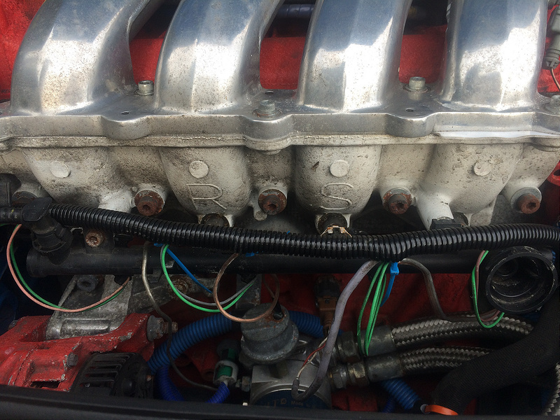

Hi guys,

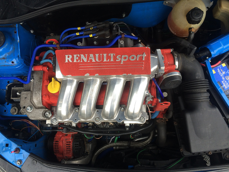

In the process of tidying my engine bay up even more and noticed my car had no fuel rail guard? (No idea whether this is something that all cup models are missing?)
I have bought one that needs a polish up to match the inlets but im missing the bolts needed to fit it properly, does anyone know what they are and where I can order a couple? :)
Thanks guys, here is a picture of what its like currently! Loads of space for the fuel rail guard and will also look the part when its all polished up.

As said above drop Adam a PM with this part number - 820 058 4570
  Trophy Turbo :)
The bolts snap some times. When doing a oil change.
Easyer to get to filter. Hope u get sorted if not ill have some second hand ones j cos have for the price of a stamp
  Ph2 172 Iceberg

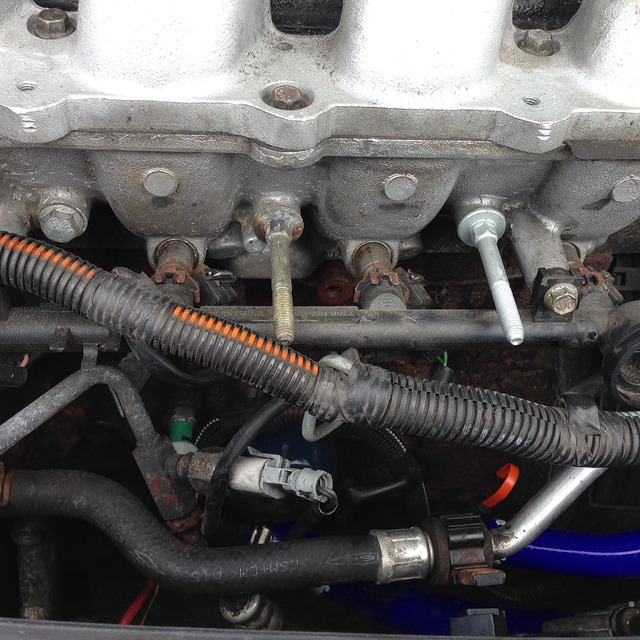

I nearly snapped the threads when removing my fuel rail guard, nuts had seized themselves on.
I put some grease over the threads, now the nuts come off easy, less stress on the threads when undoing the nuts.
