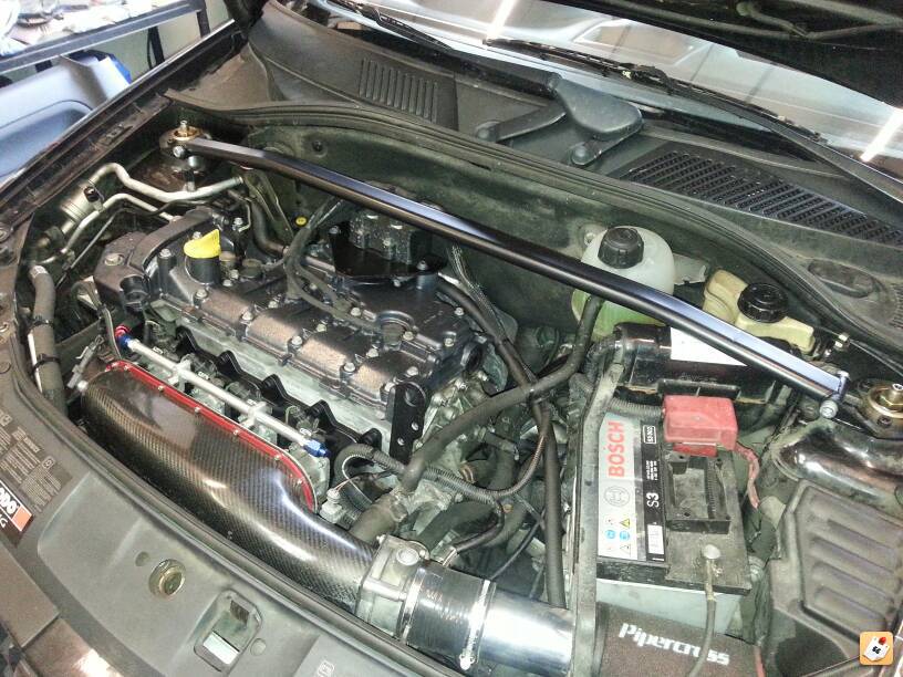

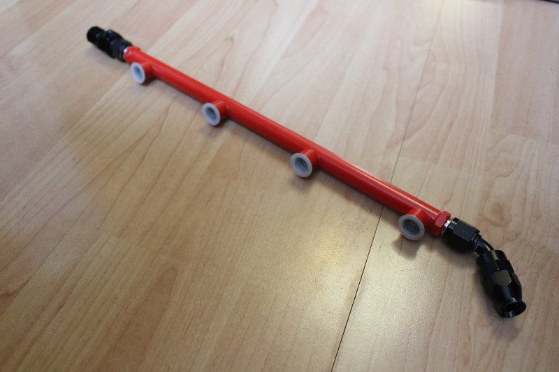

I use Jenvey
- it is with AN-6 on both ends. And Torques UK braided PTFE hose and fittings (black):
You can order to do it for "Bosch style" or "PICO stylle". OEM Clio 172 are PICO style (really OEM are Magnety Marelly IWP042). I use Megane 225 injectors, they are PICO style too (while Clio 197 are Bosh style).
Just drop e-mail to Simon Joyce Sales@jenvey.co.uk and he will send you some order form ...
  Clio 172 ph2
This is what I wrote in order form:
Part number: MFRxx
Description
: Steel Zink plated -6JIC male fittings 4 x Single fuel rail, for Renault Clio 172 inlet manifold (y2003 F4R736 engine), LHD car, Pico injectors

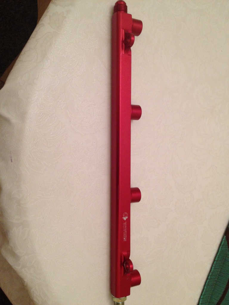

A quick phone call to R-sports in London and asked them if they could get one, turns out they have one in stock :rasp: so he asked me what model car and if i need a return or not.
172's had a feed only (apparently)
formula 2000 had feed and return.
The price was £177.95+vat and should be here tomorrow so will upload a pic.

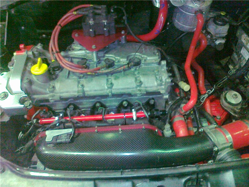

I run the Jenvey rail and mounts with my RS2 which I had to make some spacers for but it works perfectly (unlike the standard fuel rail)

Ive designed them for FA applications 172 182 so you can run a return , but have others for NA as well ;)
