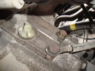

Hiya, on a 172 cup does anyone know where to fill up gear box oil ? I think. Mine is running low
Any diagrams would be a real help

There's a butterfly bolt on the front of the box. Unscrew it and fill it through there. The oil needs to be level with the bottom of that hole.
I think thats the plug iirc! Its roughly 3.5 litres altogether I think. I just used a bit of tubing, and poured it in till it splilled out the hole.

Thats the one^^^^ Sometimes a black plug. Its on the front side of the gearbox facing the radiator, Yer probably have to remove the airbox to make it easier.

thanks for the helps guys,
any chance of getting a pic/diagram of where to drain it.

Drain plug is on the bottom of the box, you cant miss it
