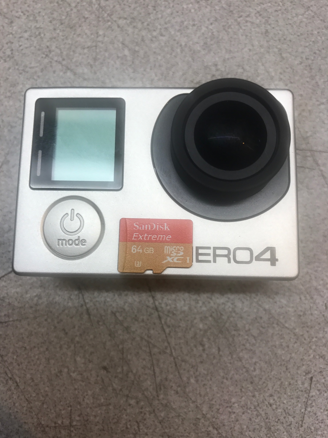

Hi all, random forum to ask but I know there's loads of you on here who do trackdays / motorsport etc etc
I got bought a Go Pro Hero 4 for Christmas and first time taking it out on a trackday in March.
But from a few test runs when I have taken the car out with it I keep having issues when videoing.
Basically what happens is, I'll start recording no bother but normally about 10-30 seconds in to recording it will come up with SD error and corrupt the recording??? But the recording is still in memory etc just not viewable or transferable. Now I know it's not a dodgy fake memory card as I bought it from currys and it's a decent brand. Sandisk from memory.
I'm stumped with this as I'm no technology guru, thought I was doing well firing the thing up and recording but it's gunna annoy me if I get it rigged up for the day and can't get a decent non corrupt recording [emoji36]

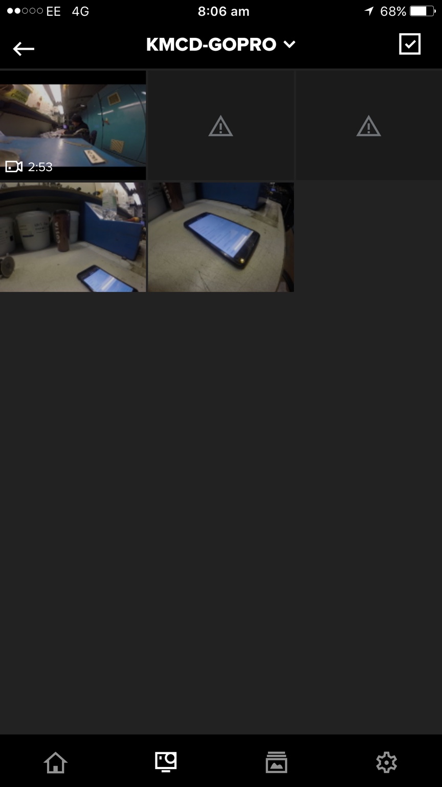

Just formatted the card like you said and I've taken 4 pics and a video for nearly 3 mins on 1080p
Two of the pics worked
Two aren't showing anything on app
Video plays back fine
[emoji848][emoji848][emoji848]
I'm stumped.

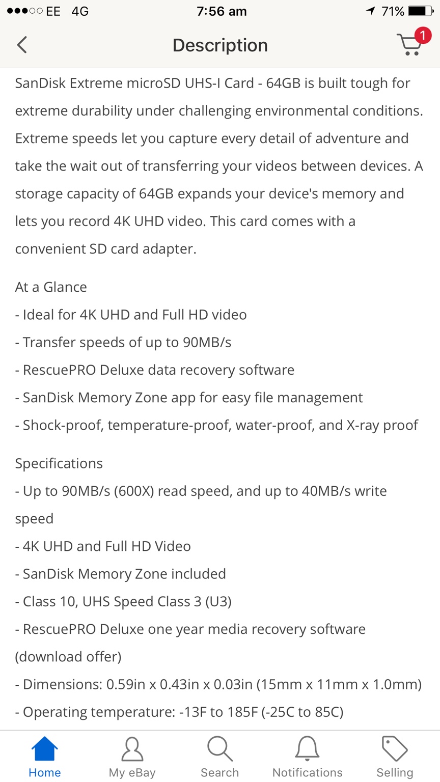

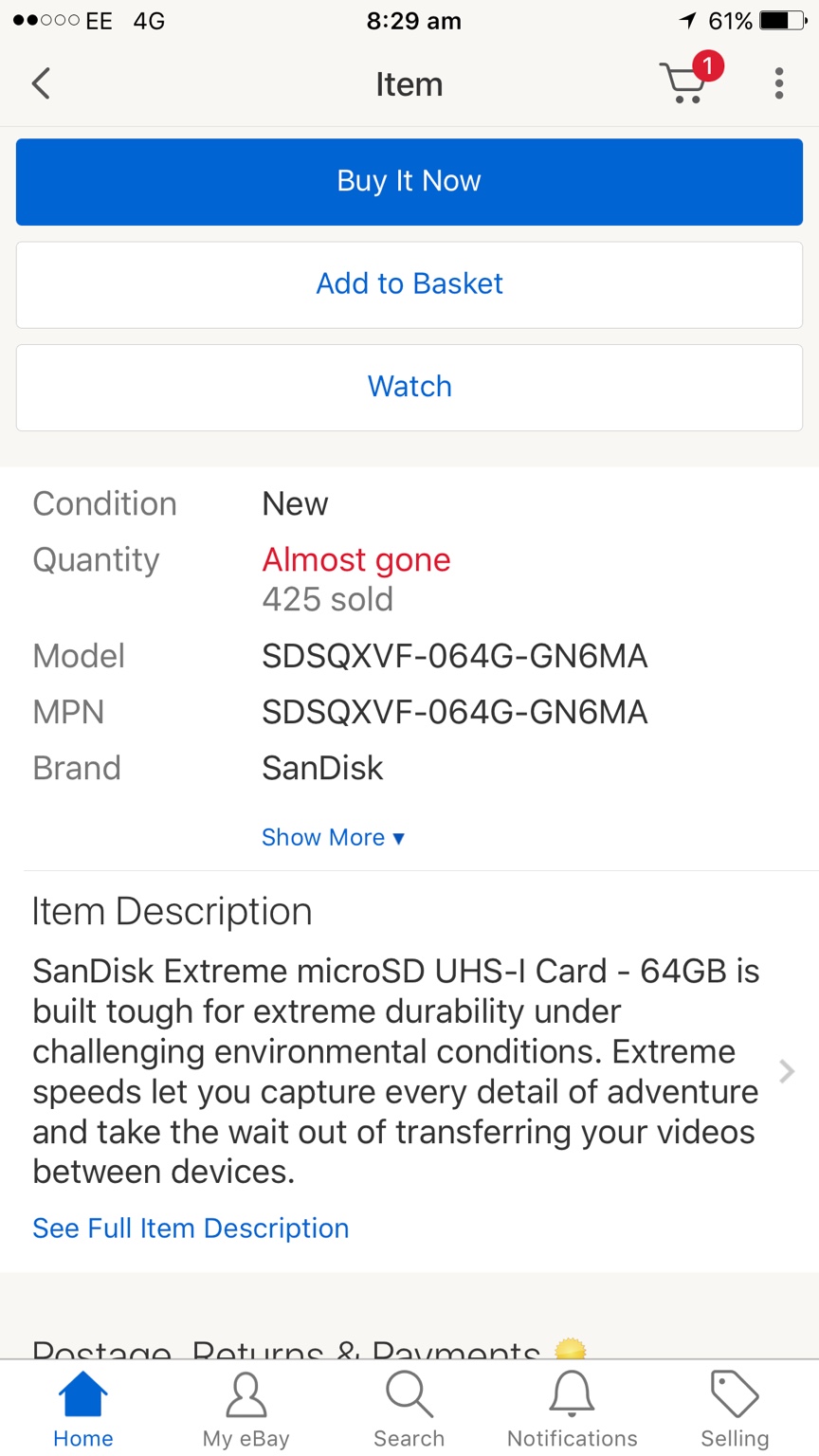

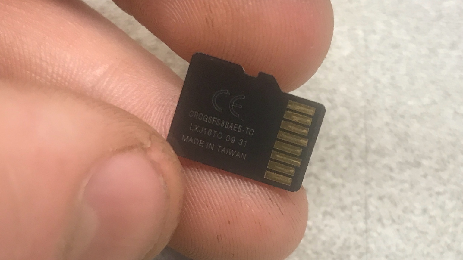

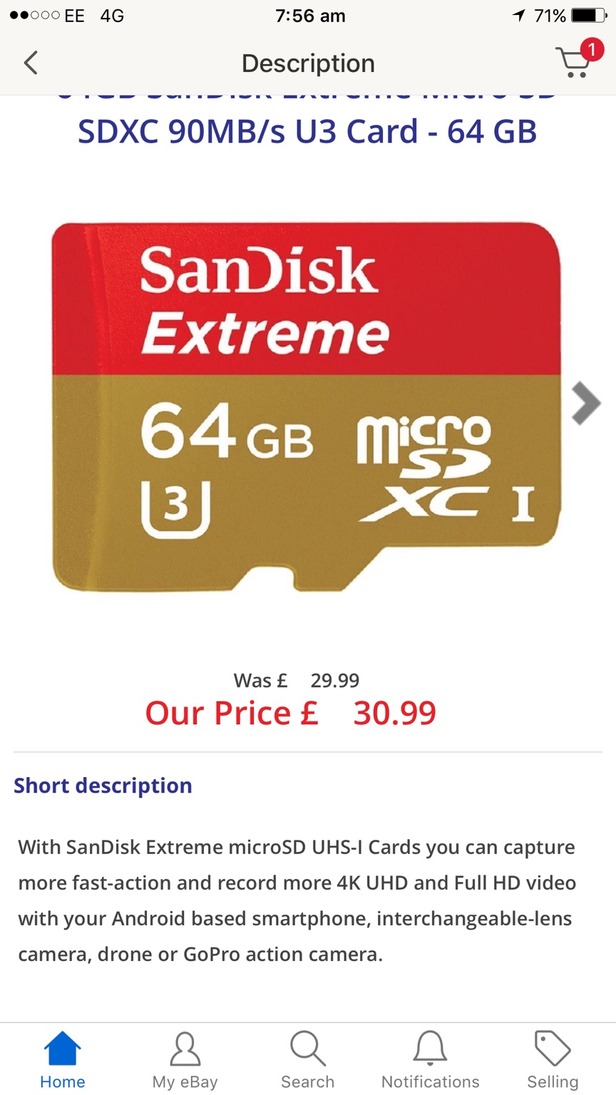

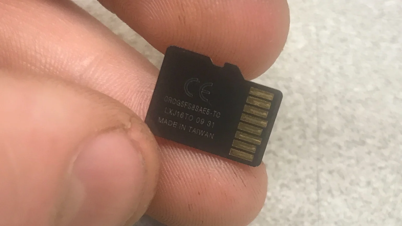

Is there any chance the SD card could be non genuine?
Just looked on another eBay listing and the part numbers are completely different for the same card?
K_McDermott
  Megane 230 r26
The same card is £35.99 at currys so might just go buy a new card tbh from a proper shop rather than eBay, but since reformatting just with the camera it's working fine videoing today. Bloody thing
