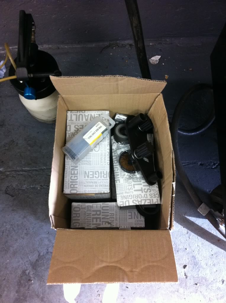

going to attempt fitting all this tomorrow eve....
  clio 182
so ive spent a whole total of £368.14 on the following:
cambelt kit
aux belt kit
dephaser pulley
and the genuine cam locking tool (with adaptor for 182)
also got to fit:
front brembo hc discs
front ferodo ds2500 pads
rear discs and pads....
got to start this at 5:30 after work tomorrow...gonna be a long evening
  clio 182
thank you :D im a mechanic so should all go swimingly, also the locking tool will be for sale after tomorrow ;) boss doesnt want to buy it off me

Hi guys so was at te garage till 10 last night fitting all those bits. Yes those are trade prices by the way. Went well with the tool very easy to do actually.
  clio 182
3 1/2 hours but I'm a fully trained mechanic so knew what I was doing really and had a ramp and all the proper tools to hand. Hardest bit was getting off the lower cambelt cover..and putting it back on.
