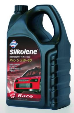

also what engine oil shall i use as i will be doing the service at home?

5W-40 fully synthetic, check out the traders sections for a decent deal.
Last time mine was changed I used this stuff.
