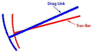

To add to Northloop's 4:30am (?!?!) comments...
Bumpsteer occurs whenever the arc described by the steering arm (blue line) is different in any way (length, angle, radius etc.) to the arc described by the wishbone (red line for arguments sake) when you look at the car approximately head on. So to eliminate bumpsteer the two lines need to completely overlap.
The difficult to imagine part is that they only have to overlap when you view the wishbone dead on. Because cars have inclined wishbones (from a side view, to give some anti-dive force under braking) "dead on" is actually a bit of a funny angle and not quite head on to the rest of the car.
The perfect steering arm (for bumpsteer only, ackermann would be set to zero if you did this which is bad) would be parallel to the wishbone from the front view, inline with both inner wishbone bushes in the side view and be exactly the same length as the wishbone. So you'd potentially have to raise/lower the entire steering rack as well as fit a "correction kit" to get it all lined up properly in all planes.
I am sure that makes very little sense unless you can picture it in 3D and know what it should look like xD There's probably a great animation of all this on youtube or something...
