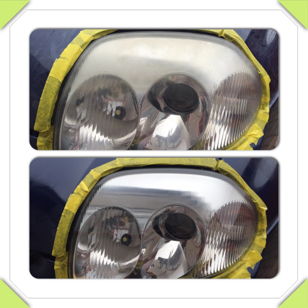

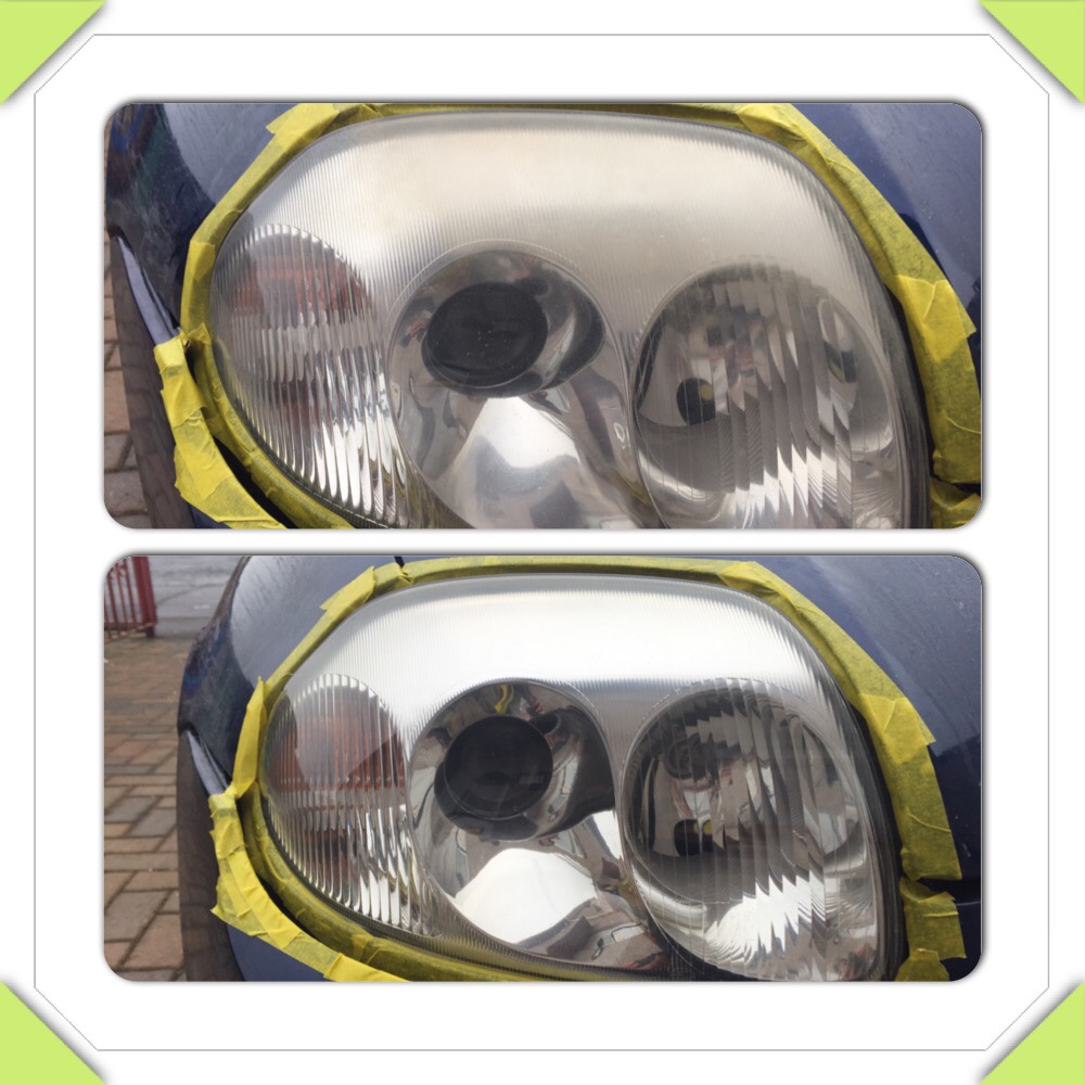

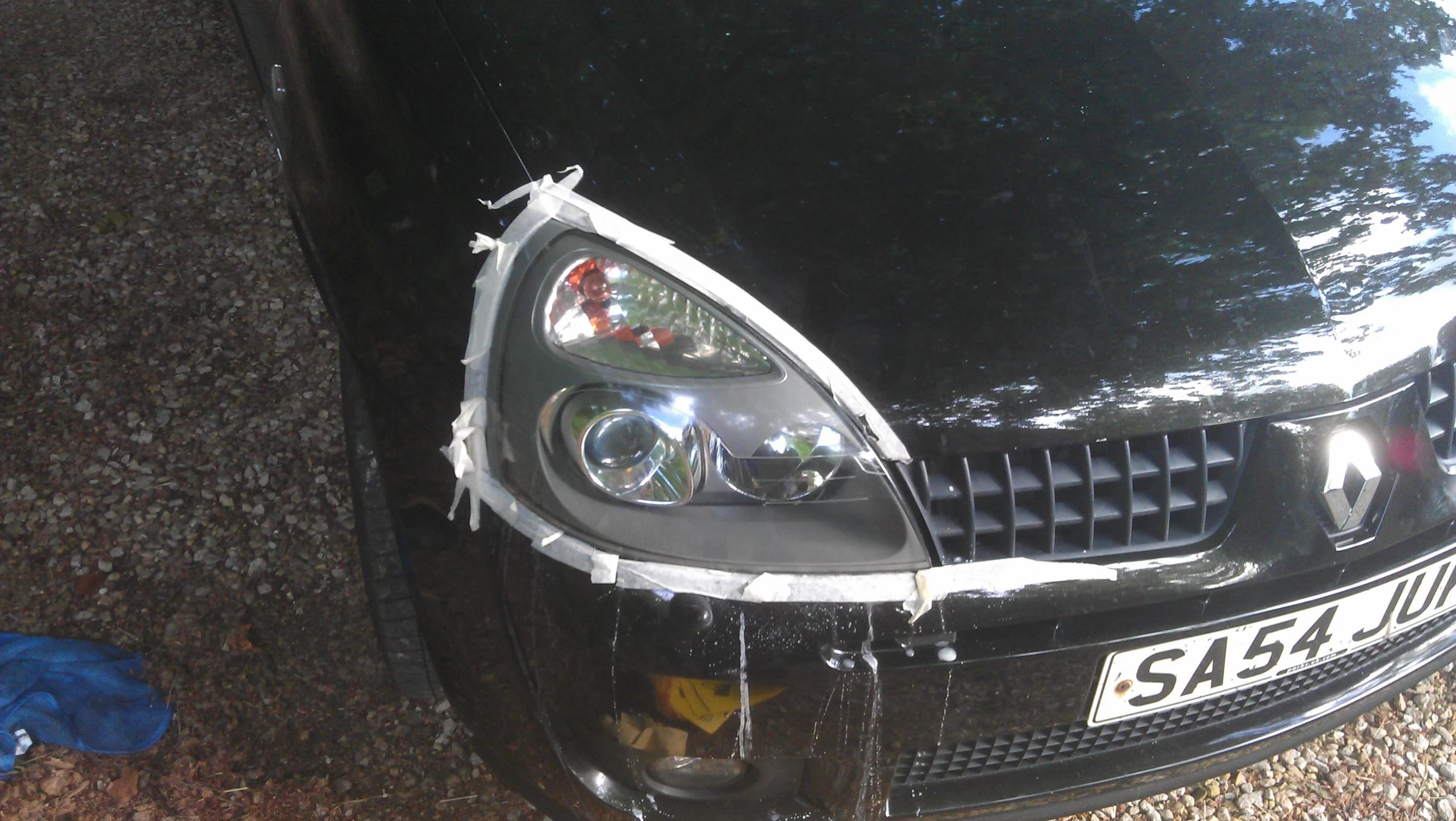

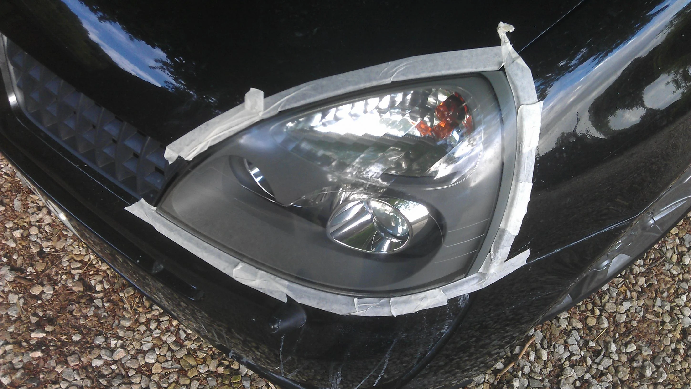

Took out a few hours of my weekend today and had a crack at doing this. I don't have a DA/rotary polisher, so it was all done by hand over the best part of 4 hours.. but I'm massively pleased with the results. I used 1200 & 2500 grit Wet & Dry sand paper from Halfrauds and about half a bottle of Megs Scratch X and a random spray bottle for the water!
​Not the best photos as taken on a camera phone, sorry!

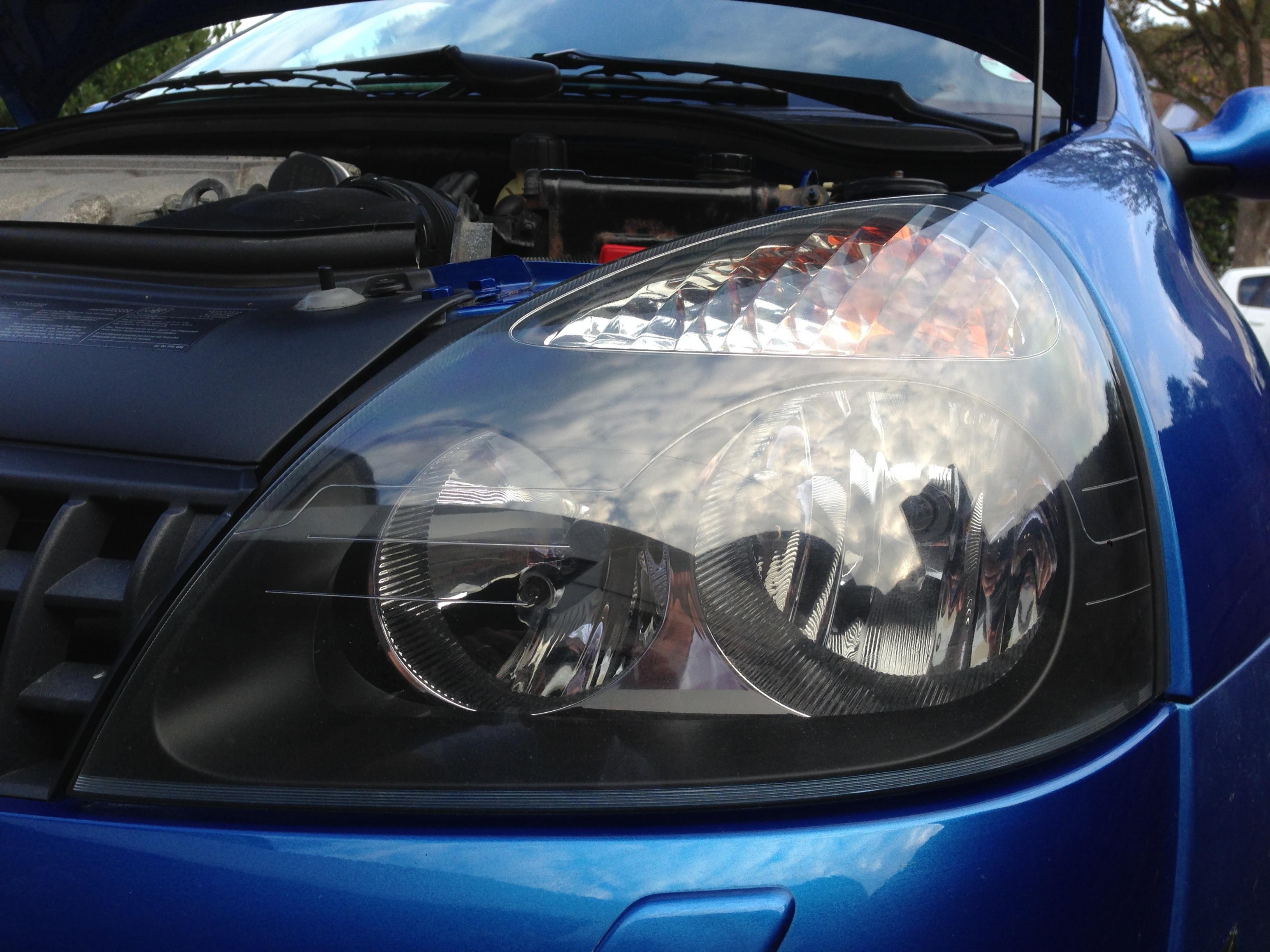

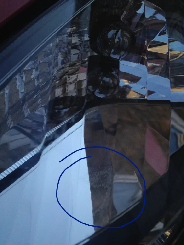

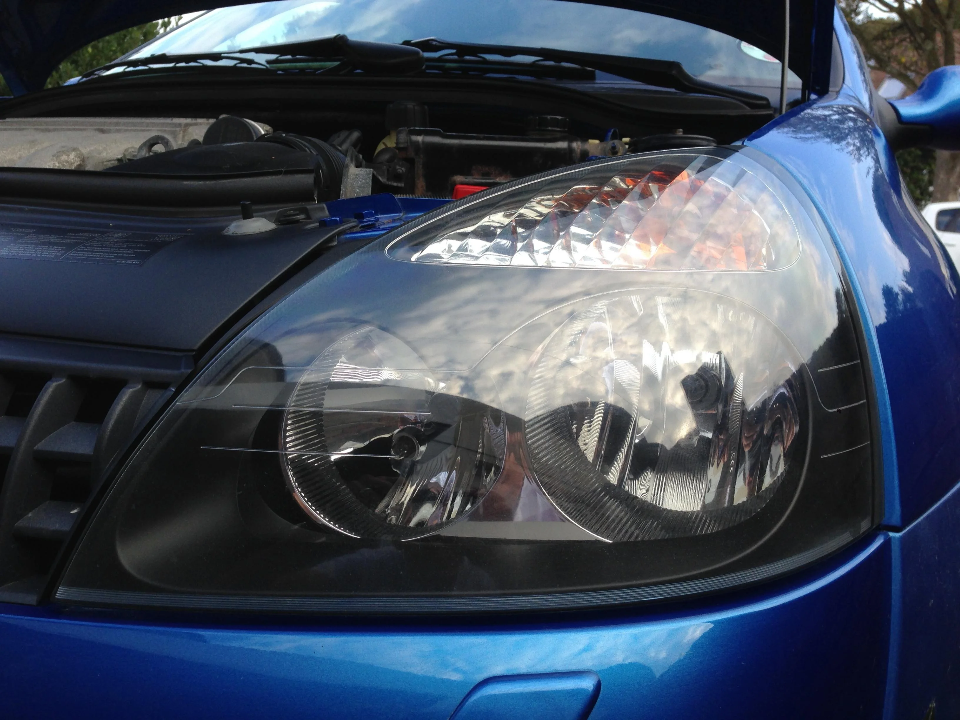

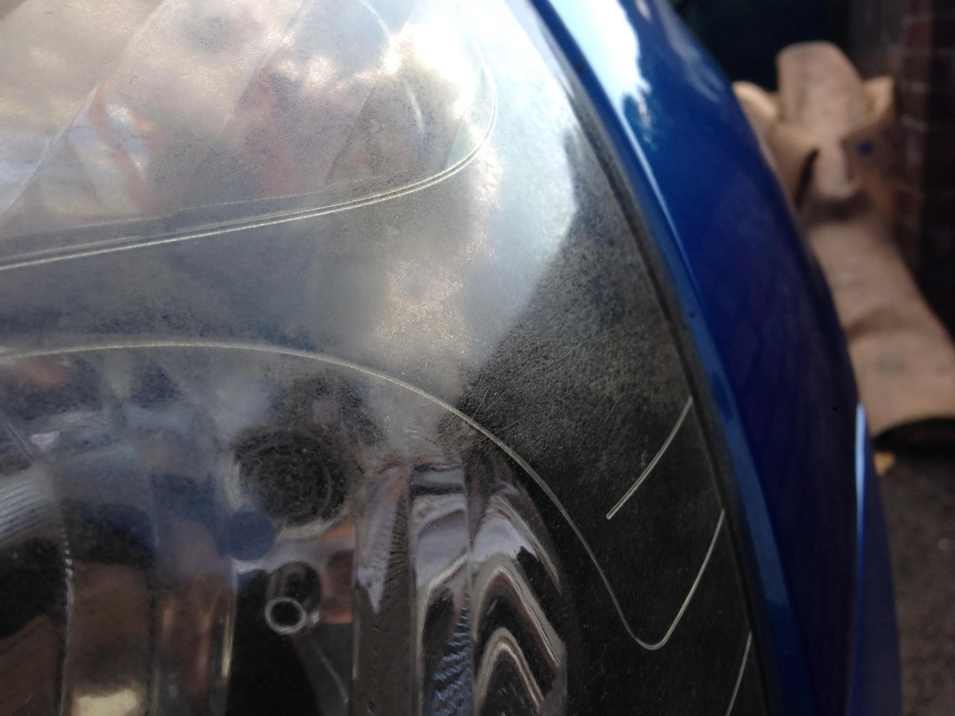

Hi all

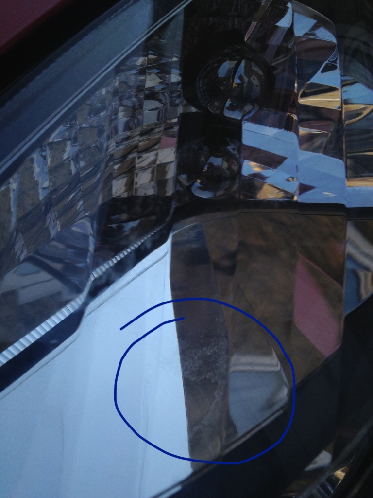

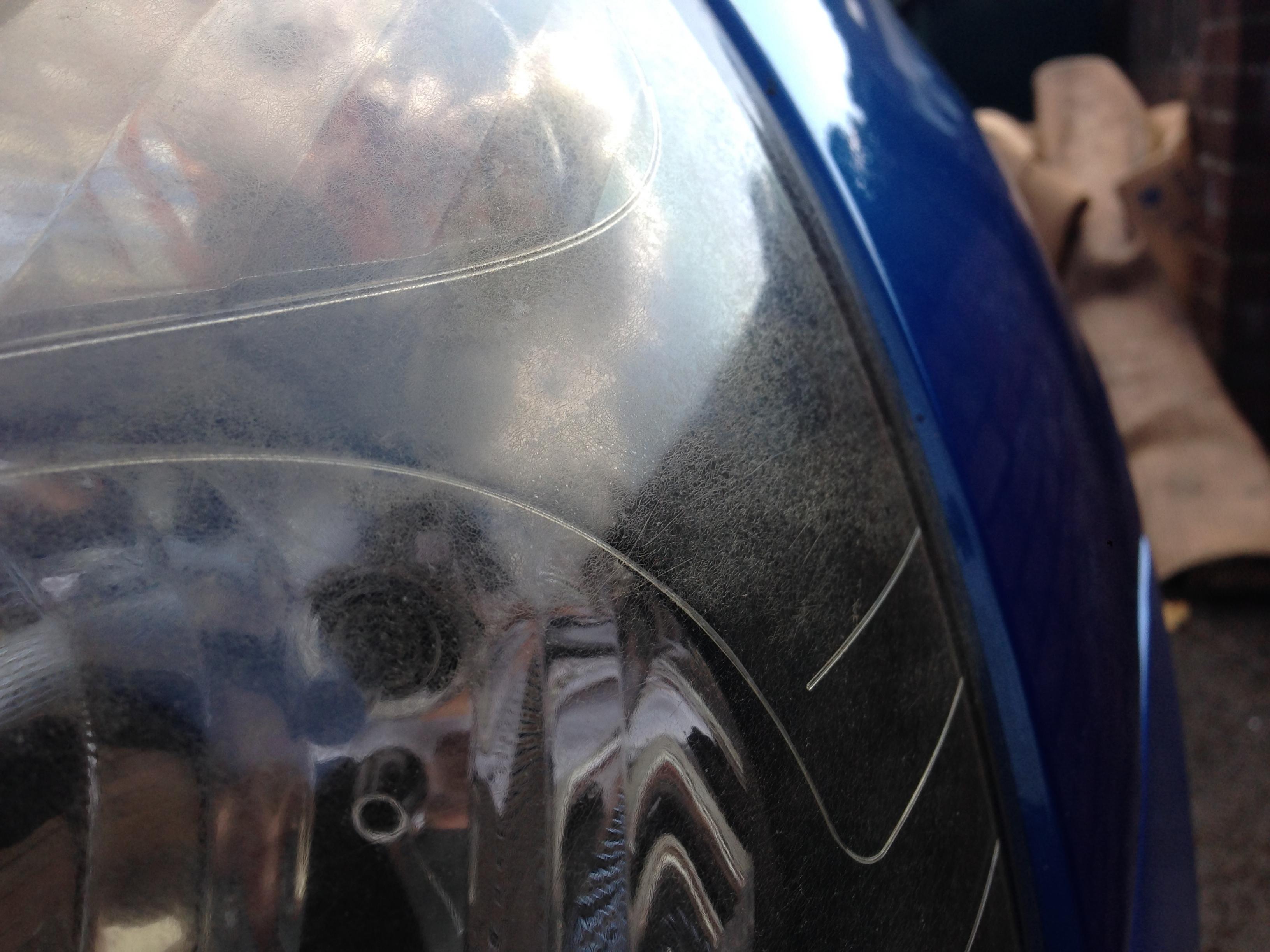

Think I have the start of this hazing effect on my head lamps I tried some g3 with A cloth then polish but it didn't make much difference I was scared if putting to much pressure on the lamp tho or are they pretty sturdy. Here's a picture after I had spent about 10 mins on it. Sorry is just a iPhone picture I don't really use a desktop anymore. You can see it near the lower part of the picture.
Hope this picture works.
Would using g3 but putting more effort behind it get out these marks?
Thanks
Chris
I had the start of this that has appeared over the last few months (since C4 wore off). I took some decent cutting polish and solved it by hand. Yet more proof you don't need a drill or the ridiculous 3M kit.

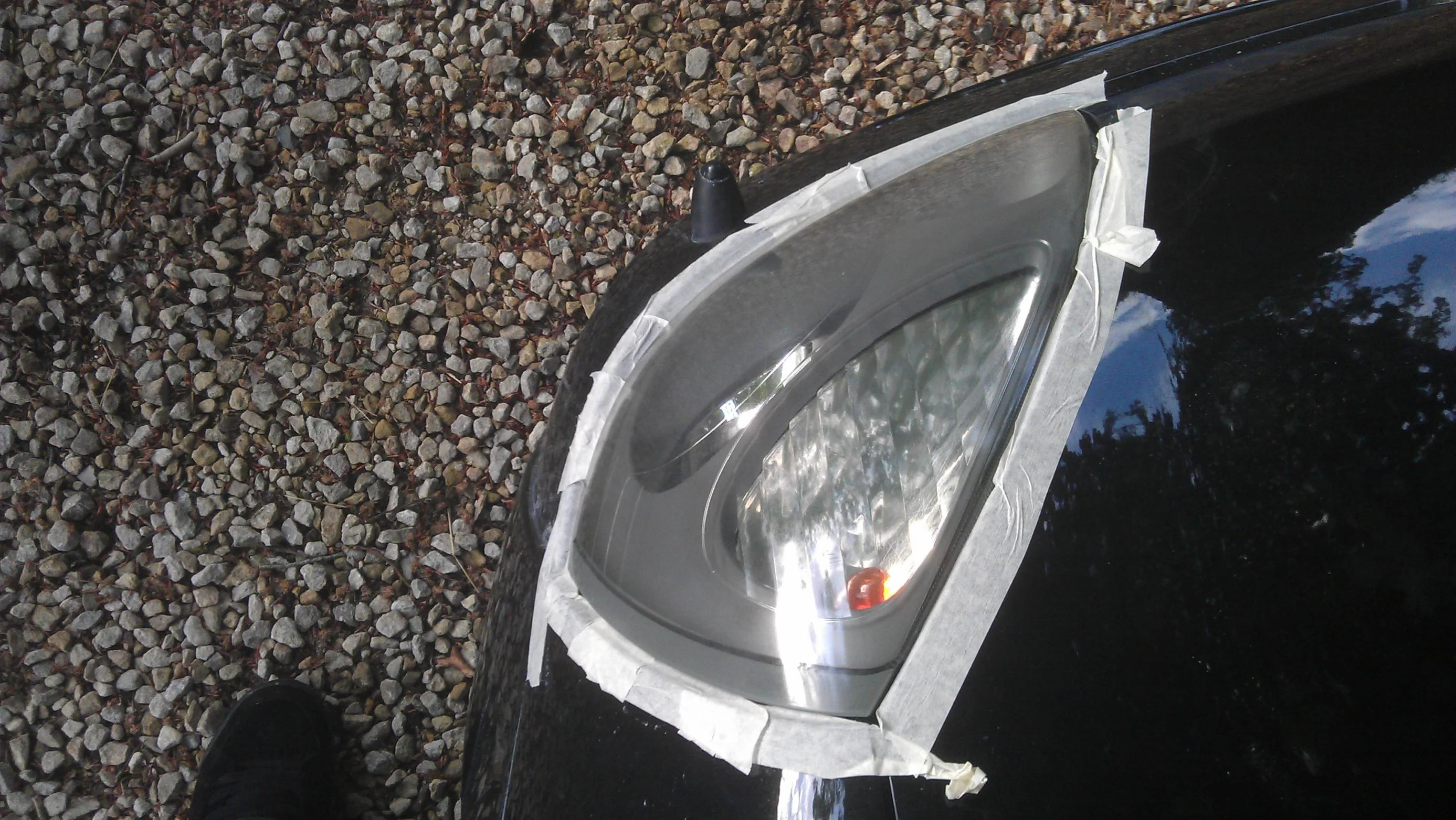

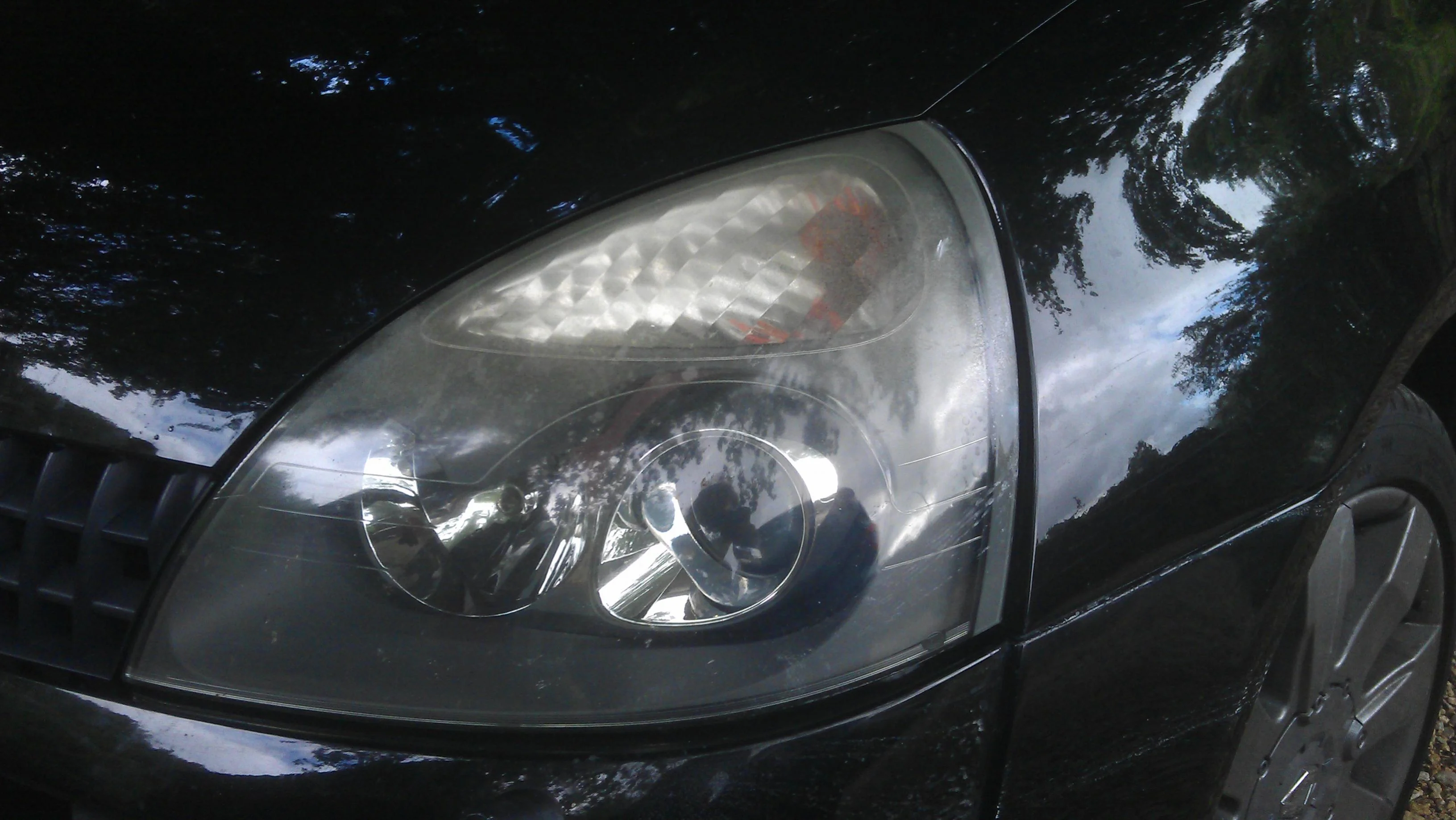

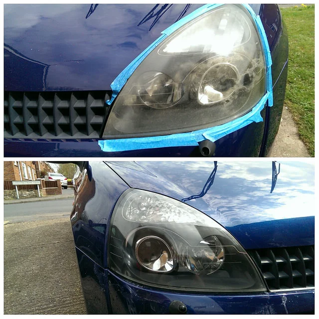

Finally got around to sorting mine at the weekend, they were both awful! Only remembered to take a before pic once I'd done one already oops!
Process was:
1500
2000
2500
3000
Menz 203S on a white hex
PO85 on a black hex
Sealed with G5
PhotoGrid_1429206421548 by terryclarke13, on Flickr
