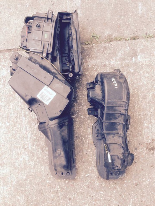

    Mine. Not finished yet but you get the idea.....
    [​IMG]

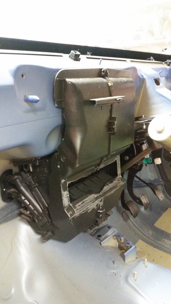

    Any tips on how you achieved it? Looks exactly what im after! Assuming you just cut the bit off you see in the pic and blank it and then run a simple on/off switch?
  15. AdamCup
    AdamCup ClioSport Club Member
    Joined:
    Mar 17, 2012
    Messages:
    290
    Location:
    West Sussex
    Car:
    182 FF Cup Track Car
    I chopped off the front bit and locked the vent flap (inside) in the screen demists position. I will be gluing and sealing a piece of acrylic to fill the gaping hole.
    [​IMG]
