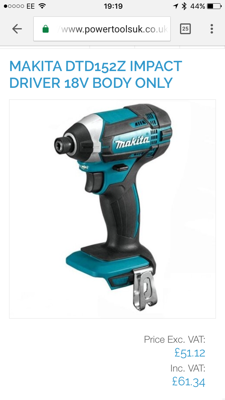

While we're on the subject, what is the difference between the impact gun Dave is after with the 1/2" drive built in, and something like this
Does the above have hex adapters or something? I take it they're not as powerful/don't transfer the same torque as a proper 1/2" driver?
No where near the same starting torque I'd imagine
Jaff.
I imagine if they do take hex adaptors the torque would shear straight through them in no time
You can get hex adapters but the weakest point on them is the collar for locating it into the chuck. They are what...? 4-5mm in diameter?
Even 120nm wheel bolts would give that a good run for its money. The gun no doubt is capable but the head is just completely not fit for purpose

An impact driver is nothing like an impact gun @Knuckles.
They take hex screwdriver bits for screwing things in hard wood without pilot holes.

@Knuckles that one you've posted at the start is a drill driver. You can get the adapters for 1/4,3/8,1/2 sockets. I had one for light work , ie stripping engines or gearboxes. But it's not got enough guts to do what a proper anvil type gun has

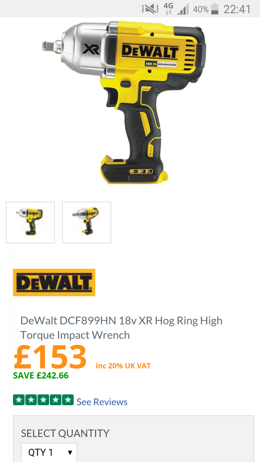

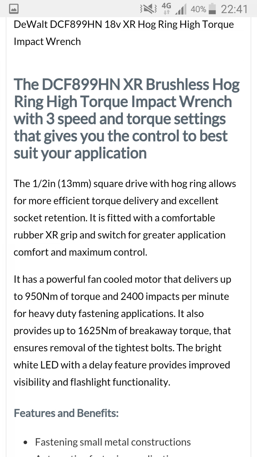

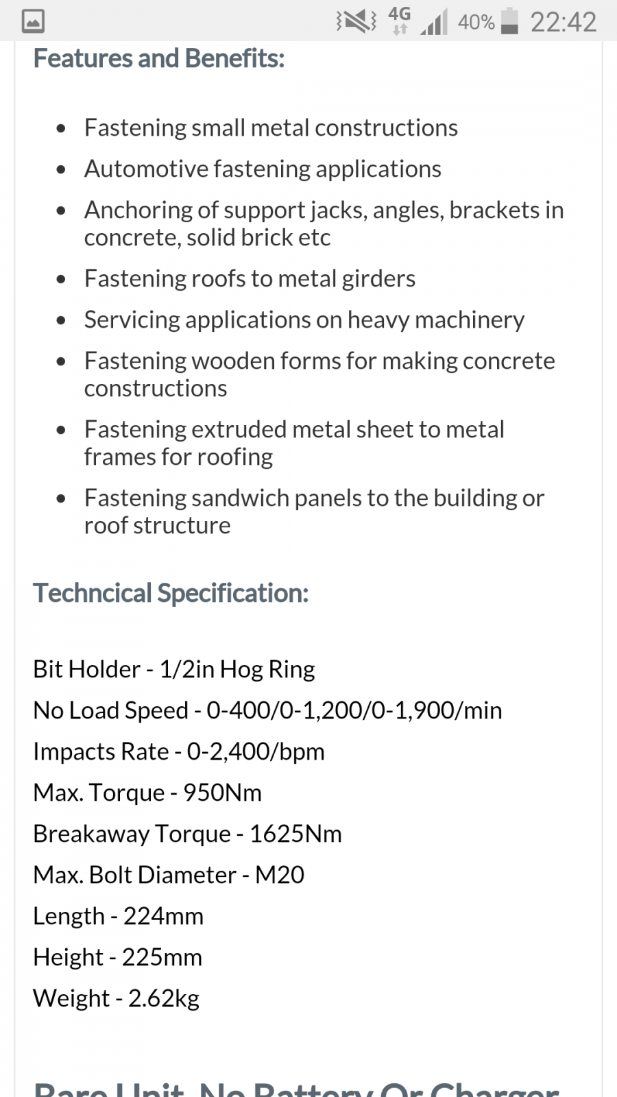

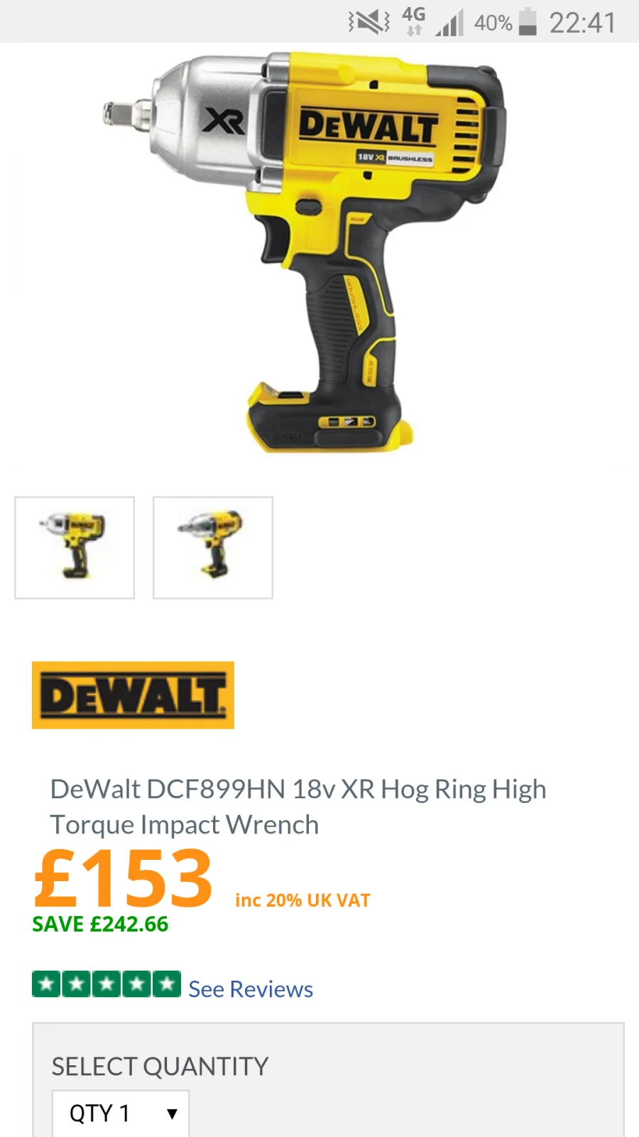

I got this Dewalt and its done everything iv asked of it
