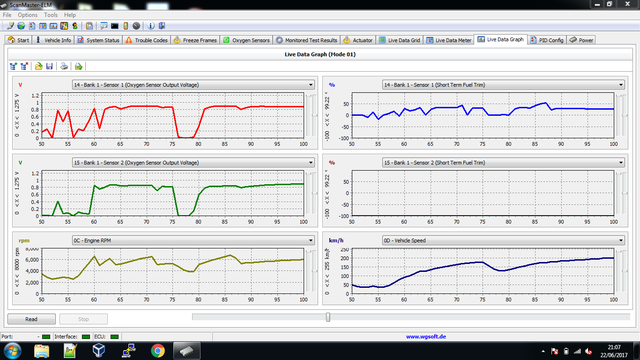

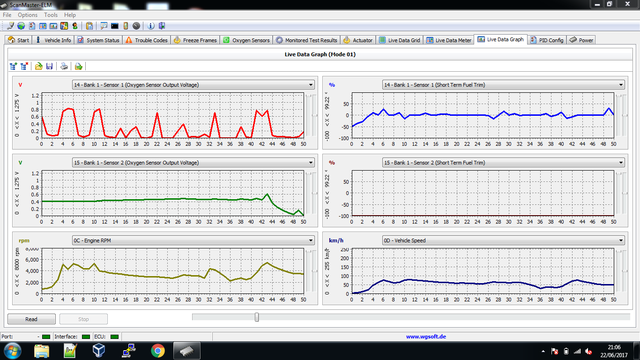

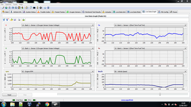

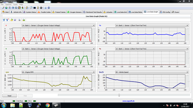

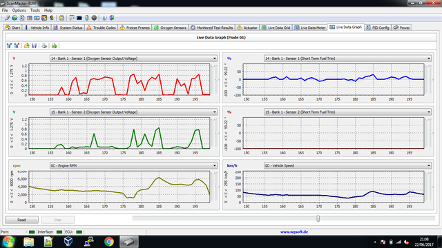

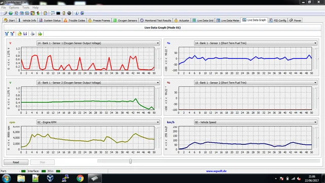

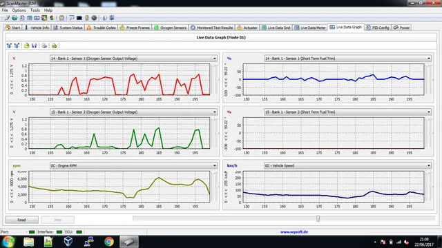

Hi All,
So i managed to find a copy of ScanMaster EML and graphed the Oxygen sensors data via a bluetooth ODB scanner.
I took the car for a run after starting it up for 5 minutes.
Looking at the graph for sensor #2 I can see no movement in the voltage at first. It only starts switching when I took it for a blast and probably got warmed up.
The two graphs seem quite similar. Am I right to think that the sensors are switching correctly?
I'm hoping a mechanic or an engineer can shed some light on this.
RED = Sensor 1
GREEN = Sensor 2
Clio_fool
I think the post cat sensor should be a flatter line. They definitely shouldn't be the same. Mine were both the same and I had the emissions light on shortly after buying my 182 and it turned out my cat was completely empty, so my lambda traces were identical.
Ahh, i see. My cat I believe could be a "motorsport use only" cat. Because there is a little tag that says that on it. So either Its fine because the Cat that is on it is empty/motorsports use only cat or that the cat is messed up.
Not sure.
