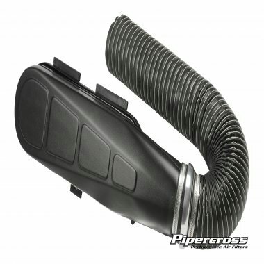

I'm hoping someone will be able to help me out.
I have the ktec itbs on my car which I love but I am suffering with drive by noise limits at track days
I saw this fitted to a mk2 golf at the weekend as they where having the same issue
I'm wondering if anyone would know if this will fit under the bonnet of a clio
I know it's tight for space under there.
And yes I know I can let off at the sound meters but where's the fun in that.
I'm open to any other alternatives if you know of anything.
Thanks in advance

It looks like it'll fit , I guess it'll depend on how long your runners are .

Think they are pretty restrictive also, I'm sure years ago someone had a custom alloy one made that went down behind the front custom member and had the inlet behind the lower bumper grill.
Ph1 Tom
I lost quite a bit of power with one of those airboxes.
I'm surprised you're having issues as my exhaust was slightly louder than my itbs and with cams it was 94/95db static. Drive by is quieter
