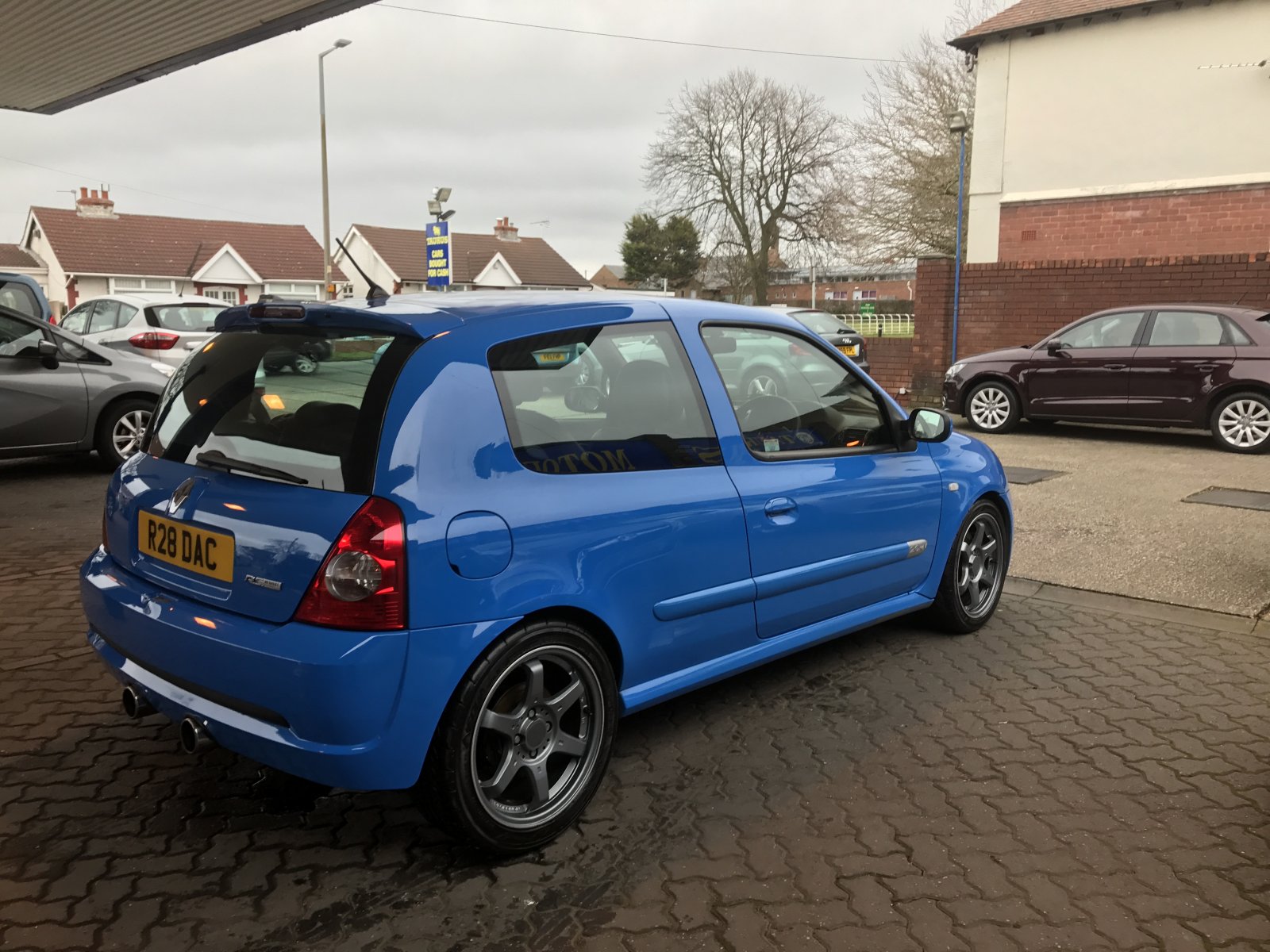

Think the reason I don't like the fronts is that the wheels are tucked in and I don't want spacers.
But then I'm not sure 15's would look okay as it's not low enough. Third world issues.
So 15's, would they look daft?
