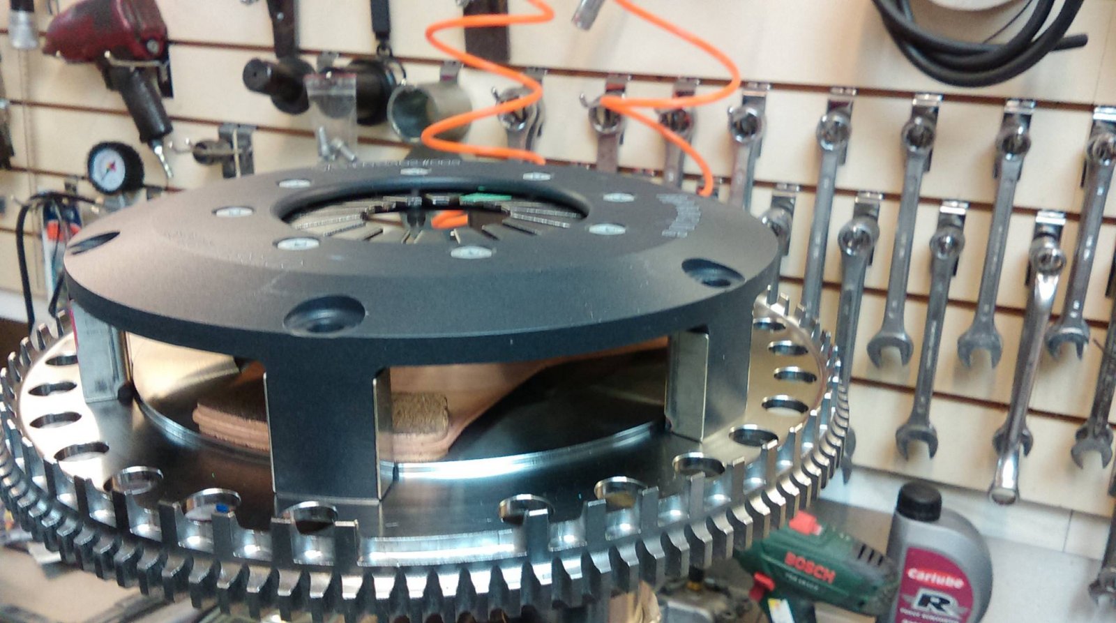

the nice little zing when the starter hits?
Mine does but it's for a 7.25" clutch so less mass the the item for standard fitment clutch.
