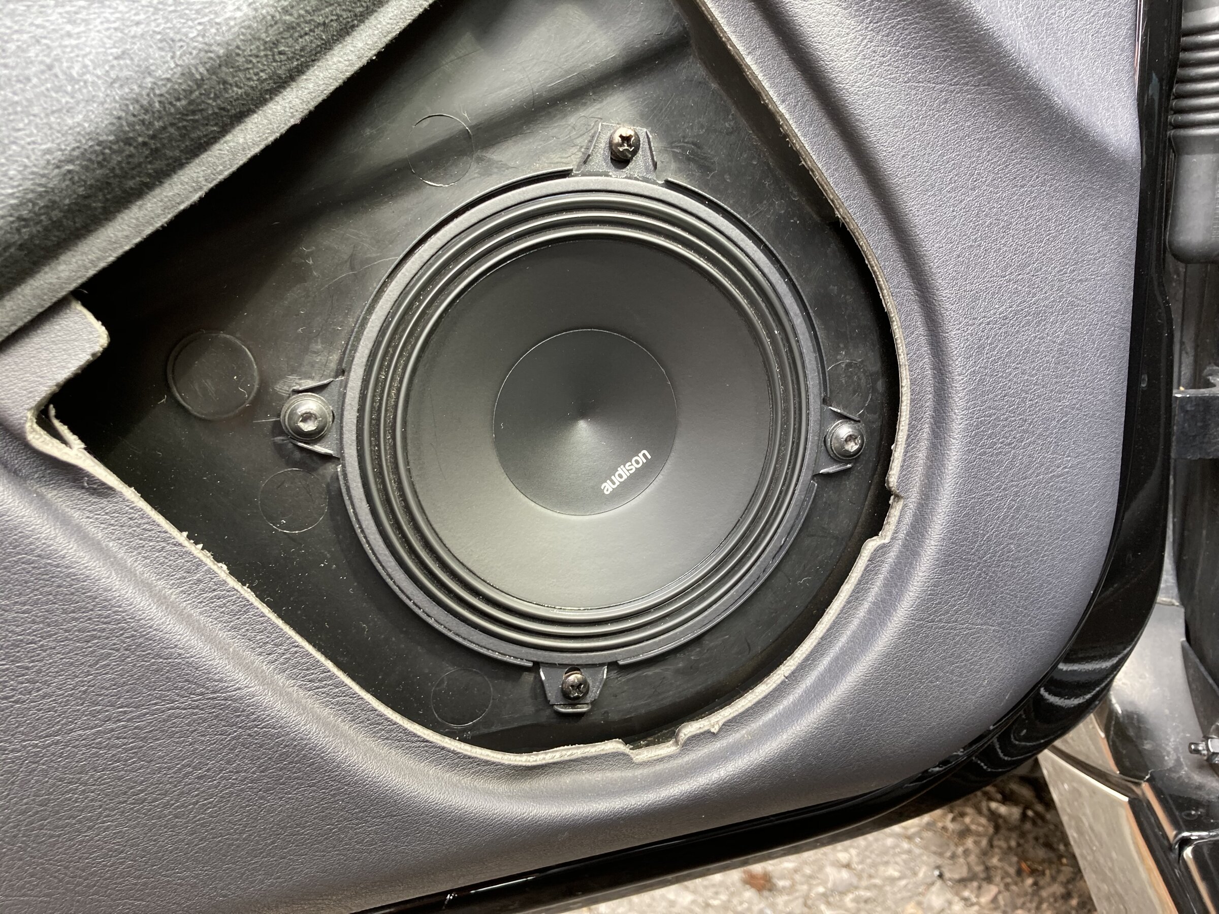

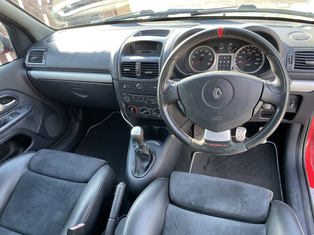

I grabbed a few pics of the fitment for anyone interested. I'm quite happy that it was possible to fit is all discretely.
New vs. Old - If this doesn't offer a decent improvement once driven properly, I don't know what will!

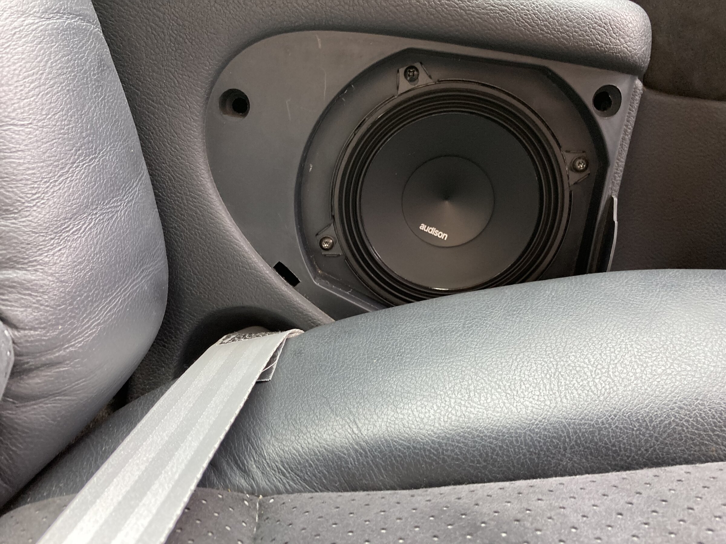

and the rear;

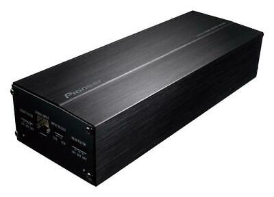

45w RMS at 2 ohms but nearley all car spears are 4 ohms so the power is halved to 22.5 RMS.
In a ideal world you would match amplifier power to the speakers.
Alpine head units rated at 50W x 4 are 18W RMS X4
Where did you see that the power rating is at 2 Ohms?
The manual says 4x 100w at 2 ohm / 4 ohm. Which is confusing, but I think it means that you achieve 100w per channel either way because when you drive a sub directly (the only time you're running at 2ohm, which is configured via a menu) you give up two channels to do so.
  megane 285 sport
Its telling you theres 2ohm speaker load option, for running more than one speaker on a channel. not that its 45w rms at 2 ohm. Click the 2 at the end of the statement and it tells you.
mikeh
  182 Trophy
It's 4x45w RMS at 4 Ohm. I believe it achives 45w RMS at 2 Ohms for the direct driven sub by combining both rear channels.
