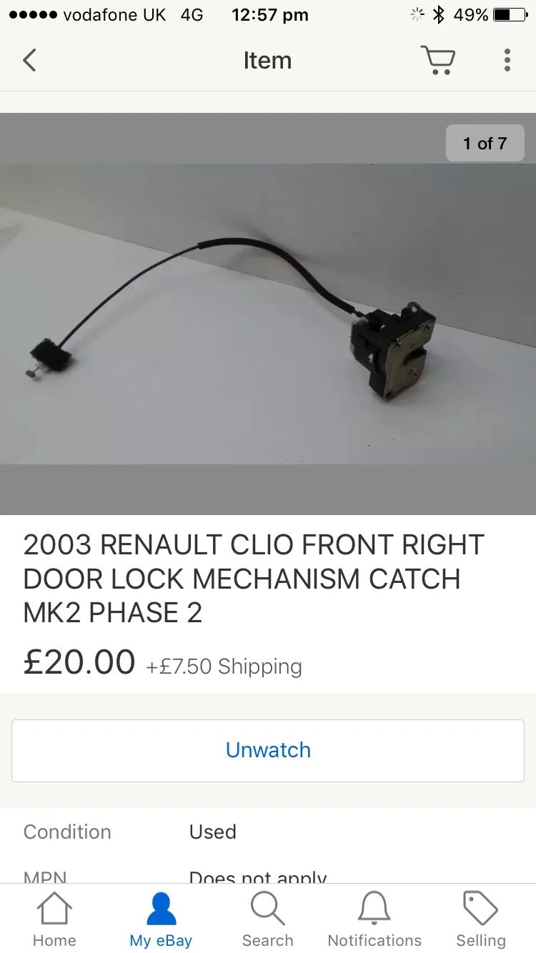

Other morning I went to my car as usual to go to work, unlocked the car but the drivers door wouldn't open, after a few mins of unlocking and locking the car I gave up and had to go through the passenger side to open the door.
After research it seemed the door mechanism had give up, so I ordered a new one;

I've replaced the mechanism though, the old one was rusty so I initially thought it was that, still no luck. Hopefully the weather brightens up today so I can take the door card off again.
  Clio 182 - RB
For anybody else who may stumble across this with the same problem;
It appears I put the rod linking the outside door handle and mechanism in wrong.
