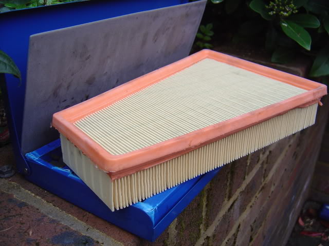

Off come the standard air box with the standard Filter
the standard Filter was so so clean, infact it had only doen 1k miles
then with the new filter back in the air box it was all fitted back together...

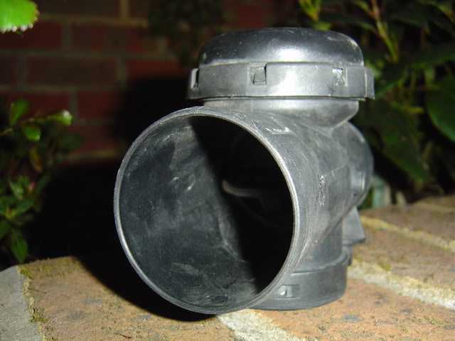

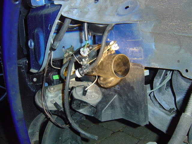

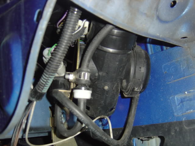

but as well as the new filter we wanted to remove the Acoustic Valve fitted at the bottom of the cold air feed. The valve is fitted to make the filter quieter which obvoiusly had to go. So off came the ns front wheel
then with the wheel off and the inner arch off too we could clearly see the valve at the bottom of the cold air feed
after a lot of fiddling around the valve was off

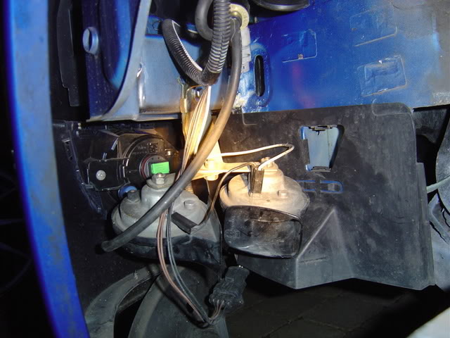

now all that needed to do was fix back the bracket which held the vavle and the car horn and job done

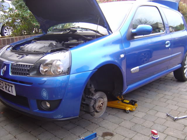

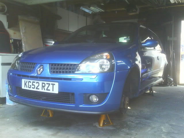

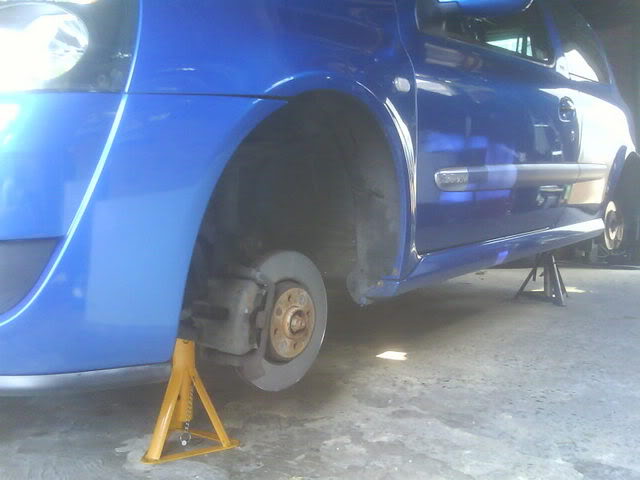

the car now sits on 4 axle stands!! i hav taken off all the wheels and they go off for a refurb tonite!! the previous owner had curbed 3 of the wheels, only lightly, but i want them 100%. They are gettin done not only coz of F&F next weekend but also coz i can sell them for more if they aint got any scuffs on them!!!
am still waiting for the brakes to arrive but the exhaust should be with my by monday or tuesday!!!
sorry bout image quality, pics took using phone!!

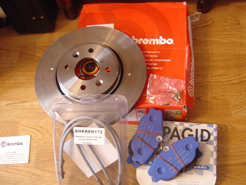

the day b4 F&F show my brakes and exhaust finally arrived!!! atleast i could get the exhaust done and hav the car on the road for the show!!!
my Brembo High Carbon Discs and Pgid Blue Pads alone with Moqip Braded Hoses!! happy days

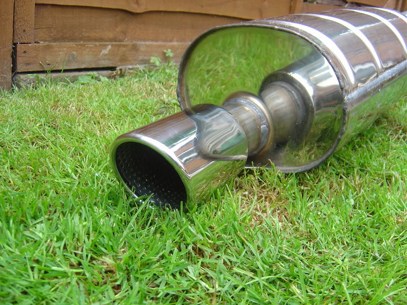

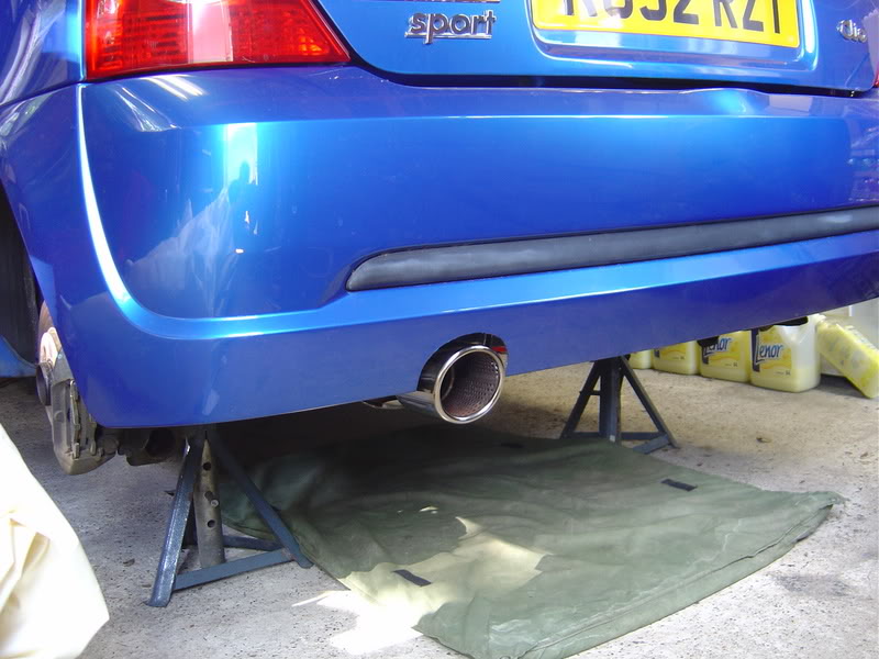

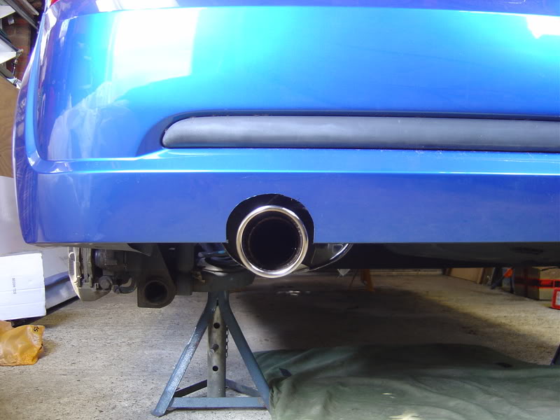

Update: New janspeed Exhaust system and De Cat
on the friday b4 the F&F show my exhaust finally arrived and so did it came the Norris Crew on Selsdon ( Mr Frost )!! we got started around 3pm and as i had already removed part of the exhaust it made things a little easier!!

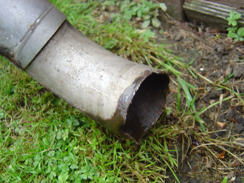

here is a pic of the rear of the back box where the pipe has jus perished!! the backbox was literally jus on there!!!

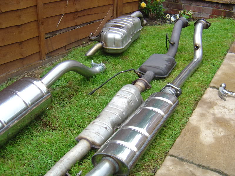

now with the full sytem and cat off the car we could put the old and nerw system together and compare!!

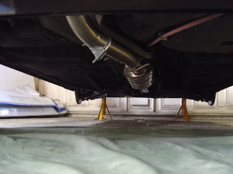

the exahust system was a full Janspeed system and Janspeed straight through de cat!! the back box was a recessed system so the rear bumper would need cutting for it to sit right!!!
after a couple of hours fuckin about we finnaly got it fitted!! it wasn't too bad to fit but the hardest part is bolting the de cat onto the bottom of the manifold!!! it really is tight and u cannot c what ur doin!!!
i really like the system as i really wanted a recessed system instaed of the normal exhaust that hangs below the rear bumper!!! the sound is really good too!! not too loud but jus right!!! :) there is still a surround to go onto the bumper above the exhaust to finish it off but toher than thats its all good!!!
i big thanks to Norris Selsdon yet again for a great job in gettin the car back on the road!!

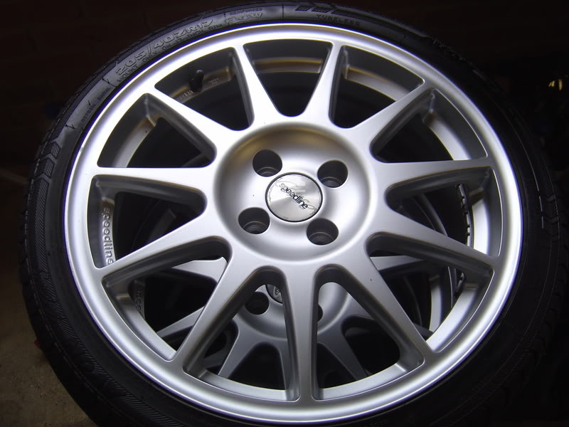

Update: Refurbed Wheels
As my car was off the road without an exhaust i thouhg ti would get my 17" Speedline Turini wheels refurbed!! Tony's ( 206cc ) mate Lee would do them for me on the cheap and over the weekend b4 F&F so that sounded good and i had them done!!
tbh they wasn't even all thats bad b4 the refurb but i wanted them spotless ;)
here is a pic of the wheels when i got them back!! as i can tell... god as new :)

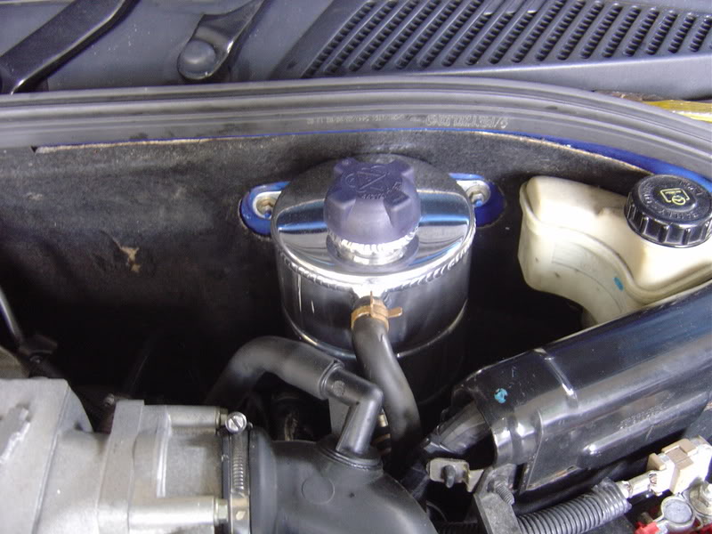

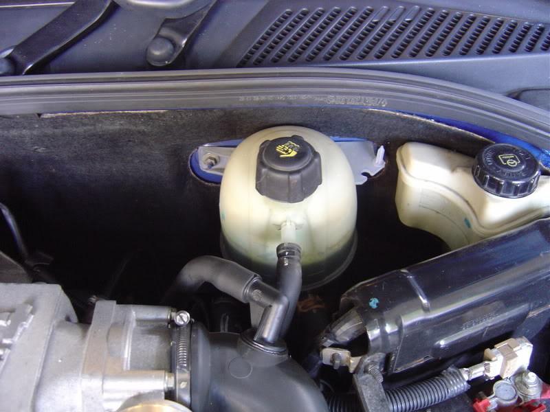

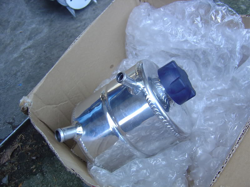

Update: Polished Coolant Tank

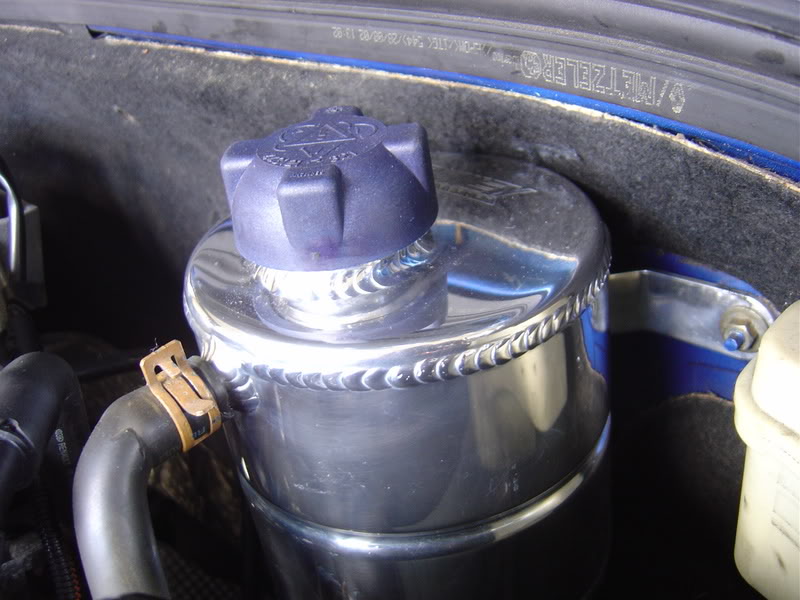

I managed to pick up the polished cooland tank from Ed via Jay at F&F show!! as he striped his 182 i thought that i would hav it to look good when i end up gettin the rest of the engine tidied up:)
I managed to fit it the same day as my breaks, last Friday ( 29th June )!!
Here is a few pics of the WIP!!! from the old coolant tank to the new one fitted!! hope ya like :)
old tank
polished tank in box
polished coolant tank all fitted!!!

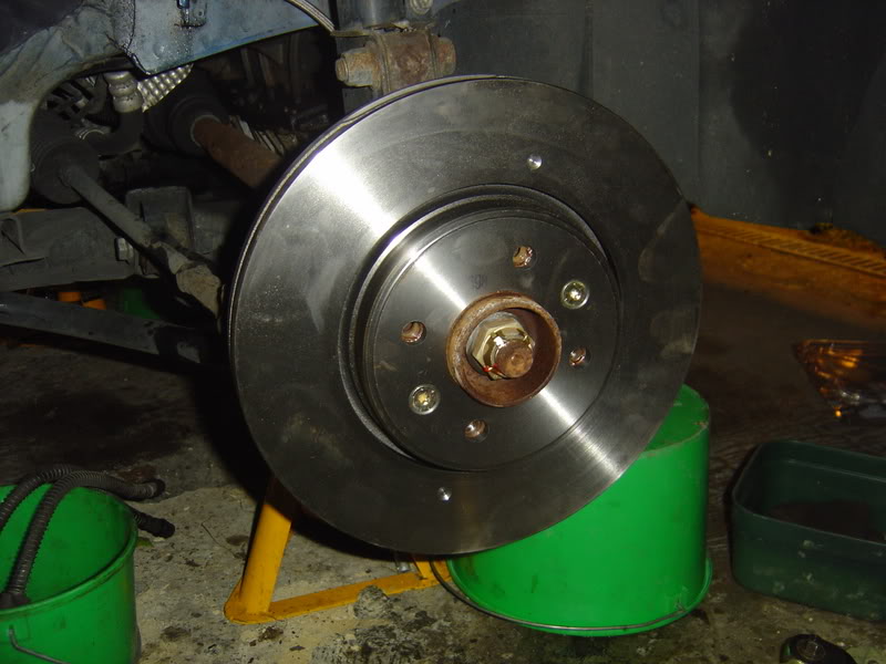

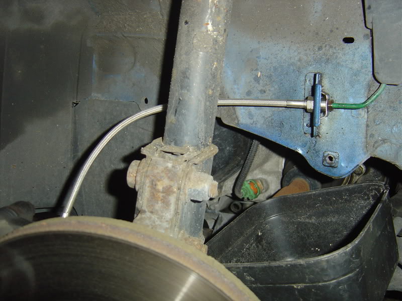

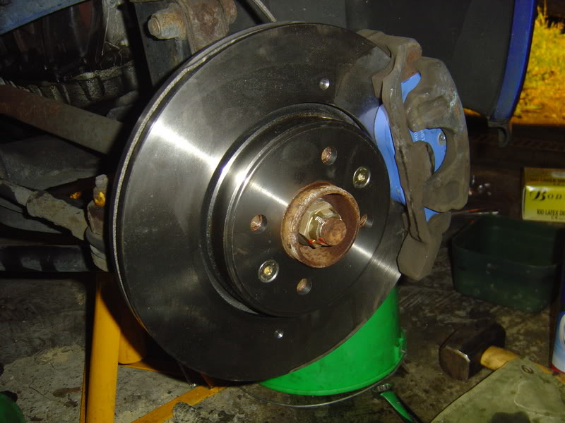

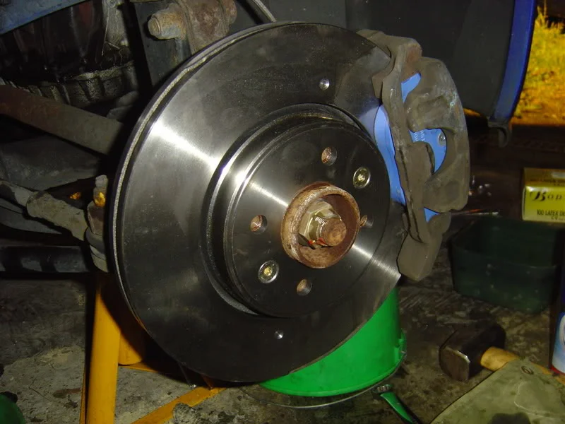

Update: Brembo HC Discs, Pagid Blue Pads & Moquip Hoses

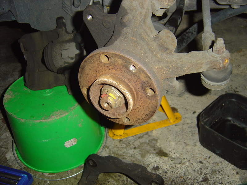

On the Friday 29th i finally got my breaks fitted!! with the help of Mr Frost again me started around 9pm!!

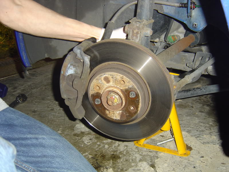

old brakes... coming off
the braided lines where changed on the fronts first!! didn't really take too long but needed doin!!
with the caliper upbolted and the disc removed we are all ready for the new brakes to be fitted :)
the Brembo High Carbon Discs looked so so much better and should provide better braking performance...
...especially when coupled with the awesome Pagid Blue Racing Pads!! after seeing some the the x2c clio sport crew already running these pads on track and not a hint of brakes fade i know they are what i need!!!

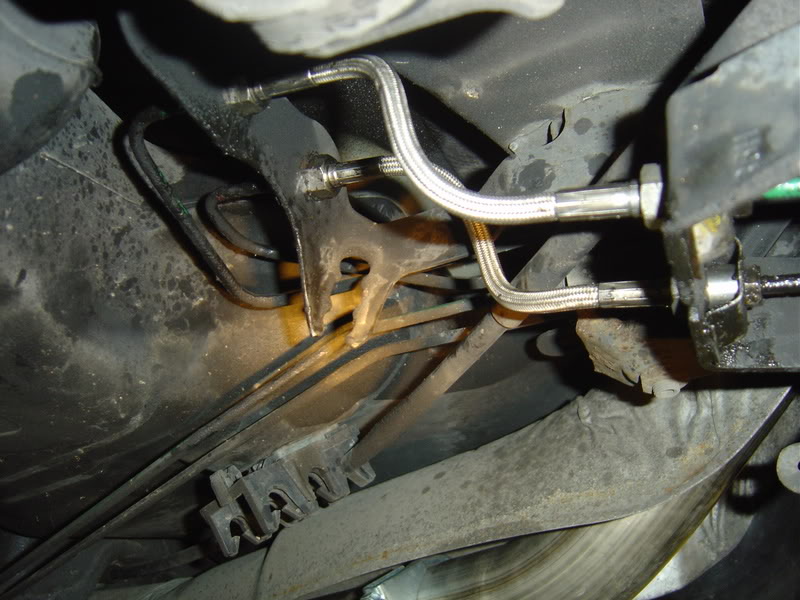

with the fronts all done all that needed doin now was to fit the rear braided hoses!!!
after fittin the discs, pads and hoses all we needed to do was bleed the old brake fliud and replace with some secret racing fluid ( pics not provided as the fluid is TOP SECRET FORMULA ) ;)
with the job all done and around 1.30am its time now to road test the brakes!!
at 1.30am in the mroning with the roads empty i drive up the A23 towards the Caterham Bypass ( A22 ) which is a 60pmh road!!! but b4 i even get there i get caught doin 46mph down the Purley way by a Laser Gun and some well hidden coppers!!! needless to say after a £60 fine and 3 points later i am not most impressed but the job still needs doin :twisted:
when we finally got to the bypass i could bed the discs in a little!! doin several stops from 60mpg down to 30mph the brakes feel terrible!! like braking on Ice!!! another set of stops and not much different!!! another set and a slight improvement!!! by the 6th or 7th set of tests they are gettin a lot better!! then all of a sudden on a brake test they jus bite!! and bite alot harder than b4!!! the discs are slightly bedded in!!!
all they need now is several days of normal driving and braking and they should b properly bedded in!!! when that is done its time to bed the pads in........... and that will take a little more bottle and a lot more speed :)

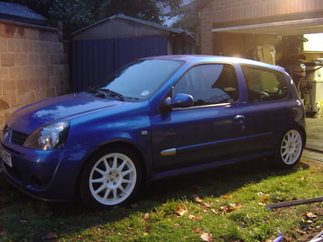

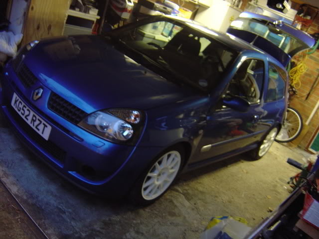

Update: 9th Oct
well they hav been on a week now and i should hav updated this section last week!! i wanted to get decent pix but hav not had time tbh!! i will do it next time the weather is better and i can clean the car!!!
anyways b4 i went on holiday i dropped of a set of 16" Speedline Turini's down to Dave @ Hybrid in Harlow, Essex!! i wanted the wheels refurbed and painted b4 Modded Uk but it wasn't to be!! anyways i got the wheels back last Tue and i gotta say i am over the moon with the finish!! as well as the refurb i wanted them painted in white!! and they really make the car look 100 times better!!
the wheels are wrapped in Goodyear Eagle F1's so the grip is really good!! am well pleased and now that the suspension i set up i can really give it some :)
here is a few night pix!! i will post day pix when i can :)

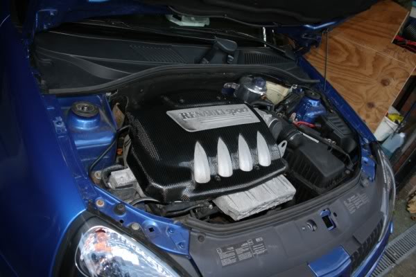

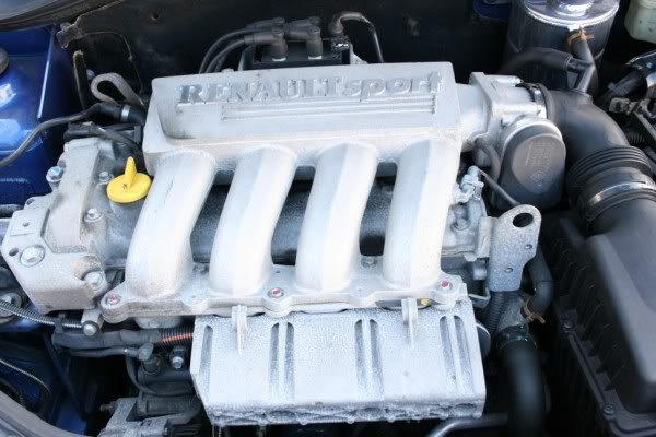

a few weeks back i purchased a small engine tidy up mod!! i hav been after one for a while and when one came up 2nd hand at a reasonable price i snatched it up!! its nothin much but a small start!! i intend not only for this car to be a great track and b road car but also to look good at shows also!! i suppose its a bit of the Show Car Driver coming outta me :)
here is a few pix and i am sure they will spk for itself!! a defo improvement :)

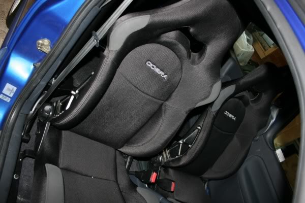

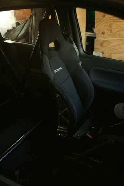

...jus after my birthday i ordered up a new set of seat's from 2 Modified!! as my budget wasn't huge Jon agreed that he would do me a deal including one of his ex display seats and a new seats direct from Cobra!! the deal he gave me saved me a few hundred ;) and although there is a few small problems they can be sorted at a later date and tbh its only if i wanna b anal about things ( the Carbon Weave is different between the seats, due to one being new and the other old ). anyways people here is a few pix!! Cobra Misano's :)

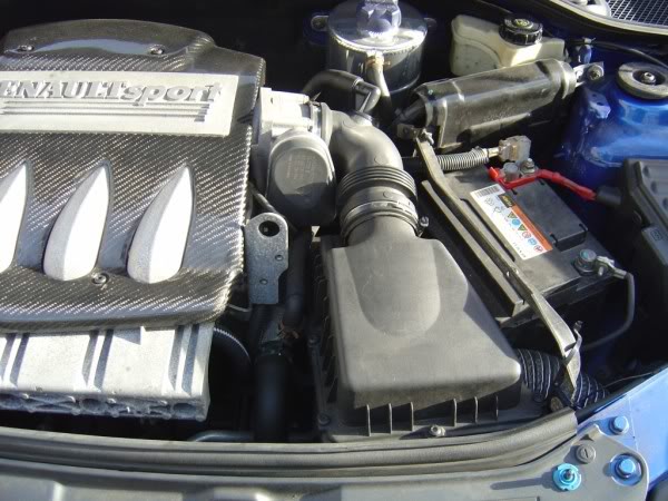

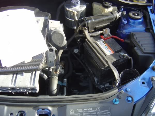

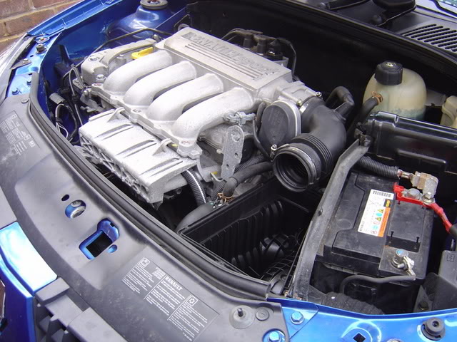

its been a while since i hav updated my WIP on the cup but i hav now added a new mod to the car!!

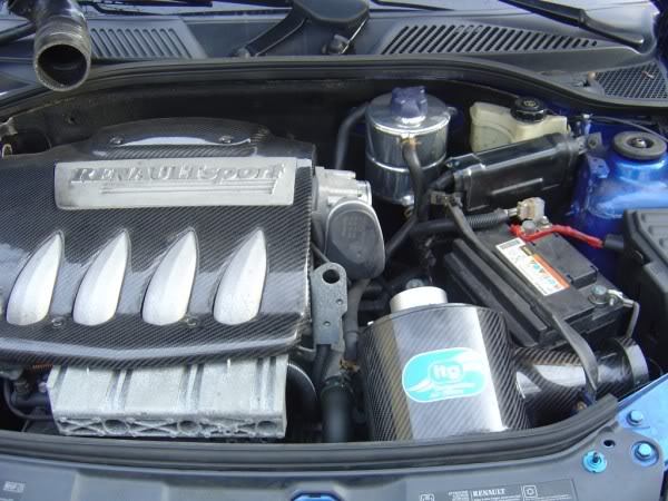

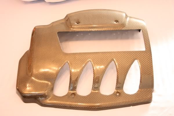

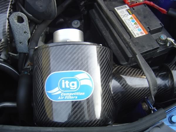

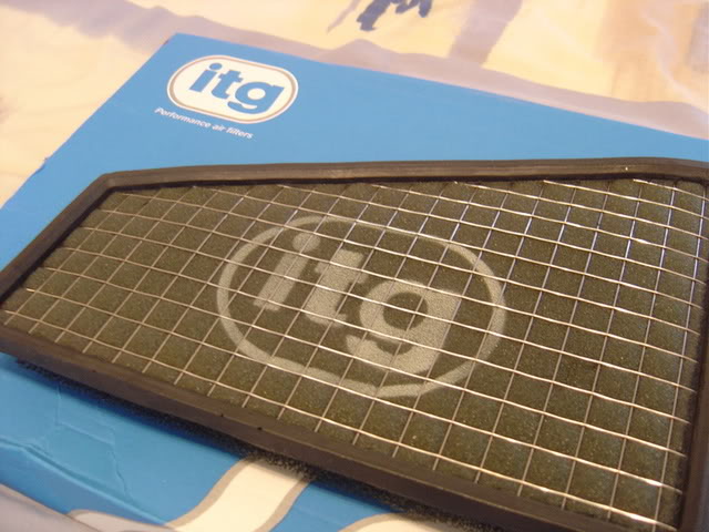

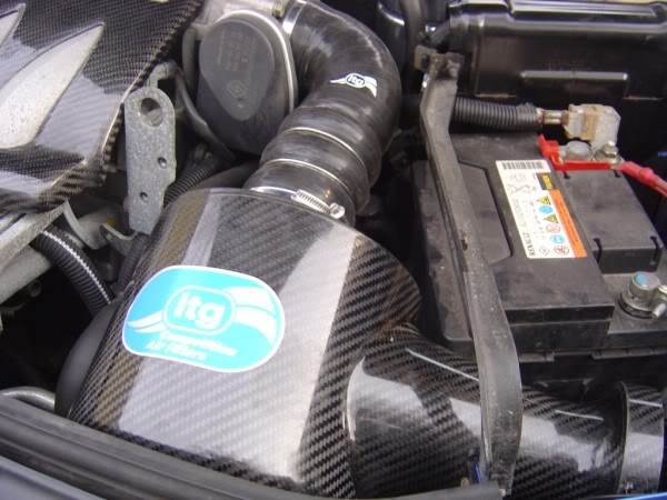

as most of u know i was running an ITG Panel Filter in the standard air box and what a bit of kit that was for the money ( £40 )!! really did increase throttle response!! but with more mods on the way the panel filter has had to make way for its bigger brother!! the ITG Maxogen IK :)
on many a Clio forum there is a lot questions asked about this peice of kit!! is it value for money? etc well at £360 rrp is aint cheap and tbh i wouldn't pay that sort of money on an IK but when one came up cheap ish 2nd hand i had to hav it!! acording to the tuning company doing the next step on the cup, the Maxogen is the best IK out there regardless of it being the most expensive!! i fully understand that to get the best out of it thcar need to be remapped but that wont b long!!

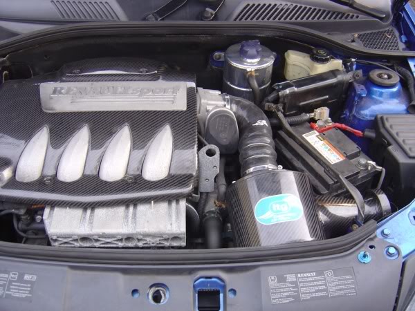

anyhow i finally got round to fitting the IK on sat with help from Terry!! what a b*****d!! the IK is so big and tight to fit it took ages!! not an easy job :twisted:
standard airbox
removed
the maxogen Carbon Heatshield in
fully in with the ITG Silicone 90 degree elbow
well after fitting i started the car up and straight away the IK sounded so much louder than my panel filter i had b4!! so we took the car for a test drive!! disaster.....
the Maxogen had been rubbing on my silicone hose for my coolant and split it in half!! the car was pissing coolant everywhere!! not good
anyways i managed to limp the car home and Frosty managed to get me a new hose for this morning!! nw with the new hose on and a plastic collar round the hose all is good!!
it was recommended that i disconnect the battery for half hour to re set my ecu after fitting the maxogen which i done and the car feels to pull slightly harder than b4!! nothin much but defo harder to 7k!! the noise is silly!!! it is so so loud!! the car sounds totally different!! it really roars when u plant ur foot down!! all in all i am happy with the maxogen :)
roll on the next mods :)
  clio 200 F4Rt
with the Bailey header tank, how do you tell the fluid level? is there a gauge on the side?
otherwise good stuff!!
