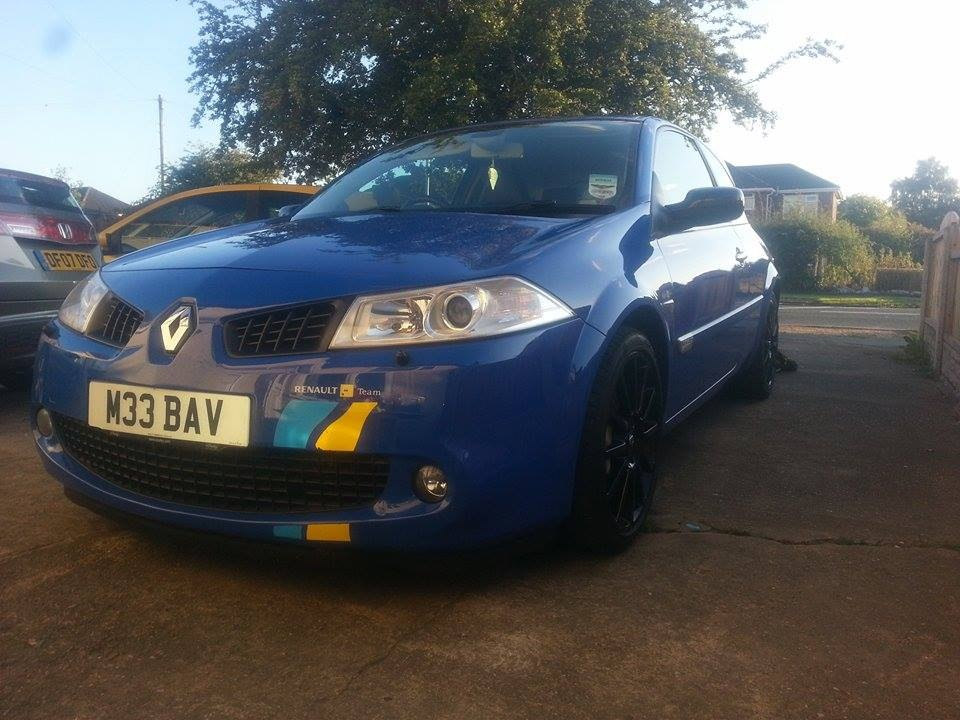

I was asked through Facebook to enhance a recently acquired Megane 225 in ultra blue. When Shaun came by to give me a look at the car It was clear it was well looked after, very tidy bar swirled paint.

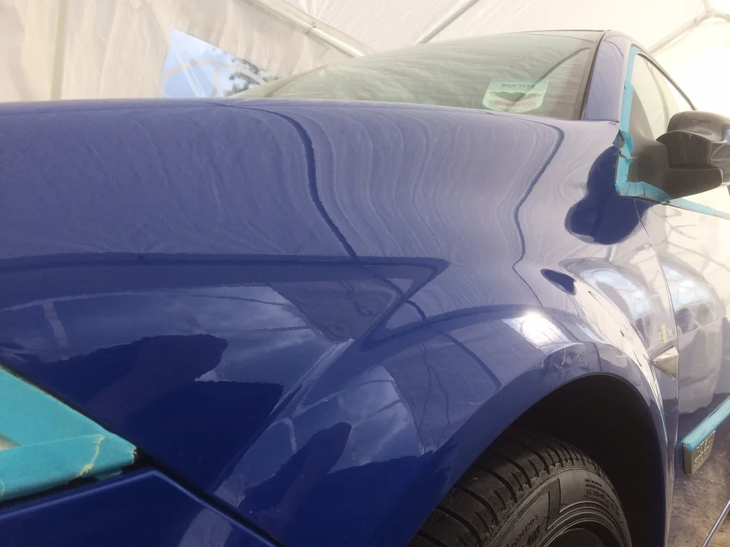

The lacquer on the wing had quite a dull finish

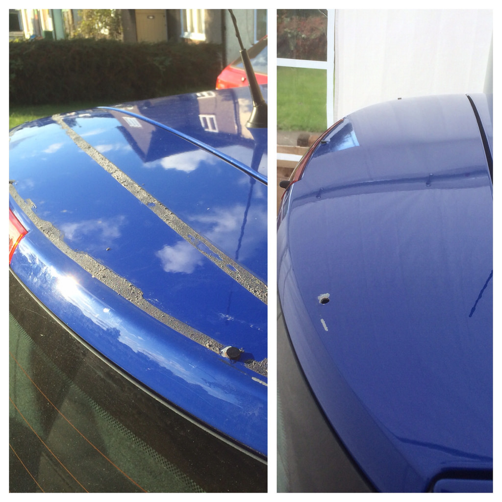

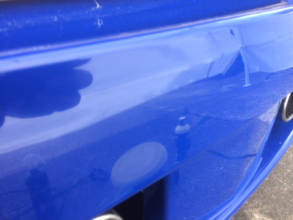

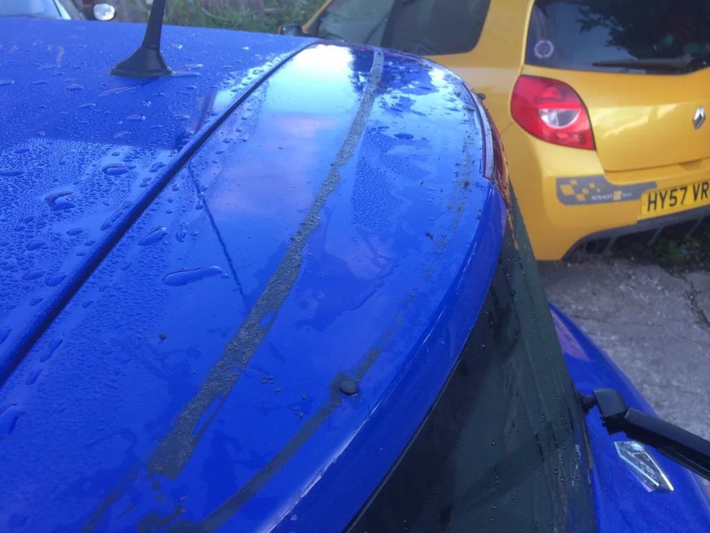

I then moved my attention to this mess :(
After a while it persisted at this stage.

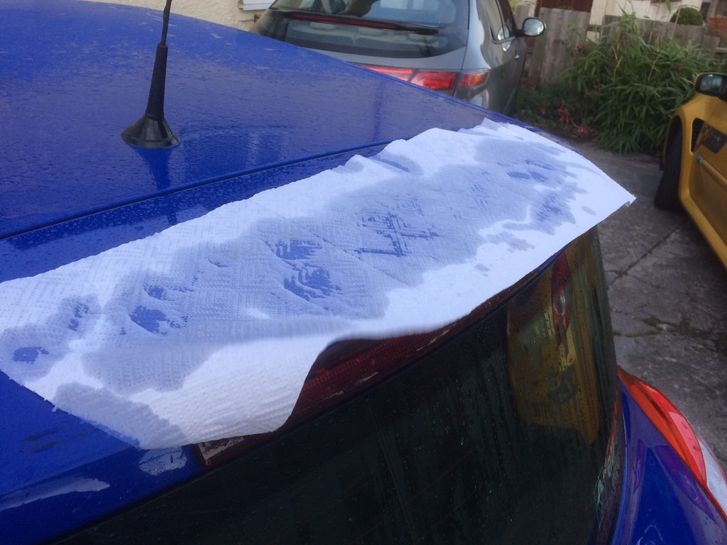

So out came the kitchen roll! Doused in tardis and left to dwell.
This softened it off enough to get the majority of it off with just a little residue left for the following day. It got too dark so I called it a night.

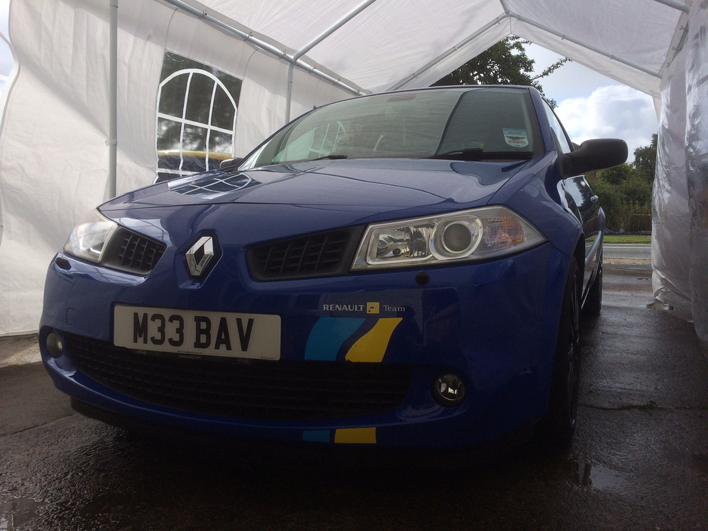

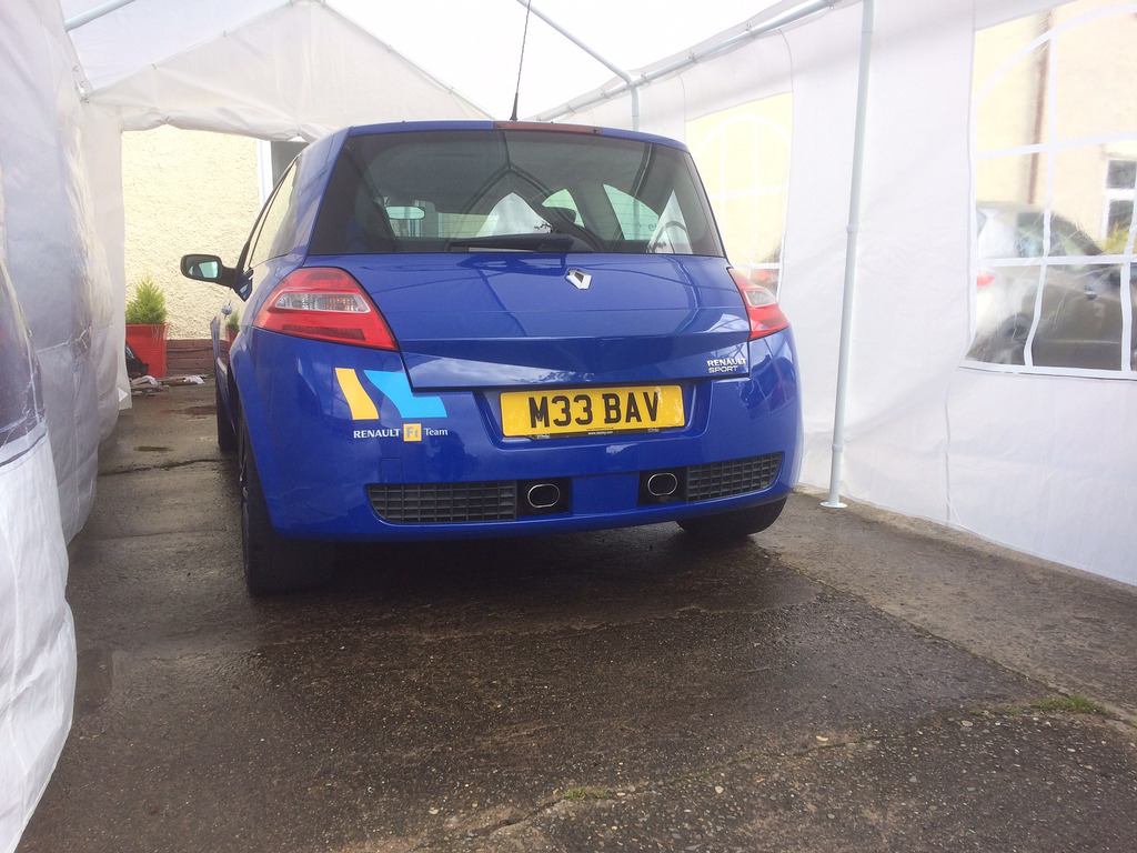

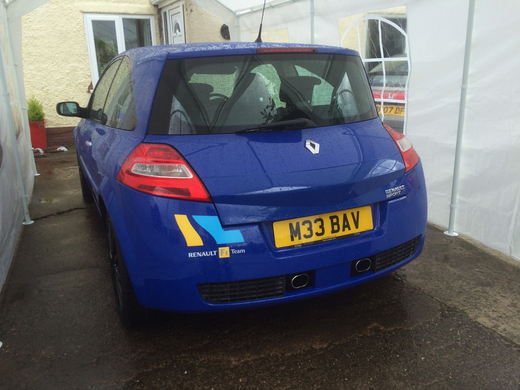

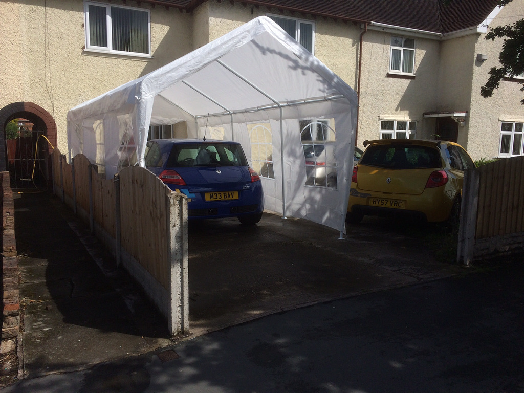

Day 2 opened with a bit of drizzle. So up went the gazebo and we (the girlfriend was over the moon with helping assemble a gazebo in the rain :eek:) finished just as it started to rain properly.
It was looking much better just after a wash and decontamination
Quick rinse, wash and then I finished the bootlid

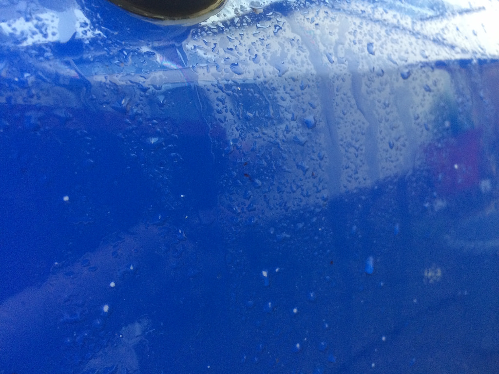

Sprayed with iron x
There was less than I expected but the colour made it difficult to catch the bleeding
So glad for the gazebo, the heavens opened.

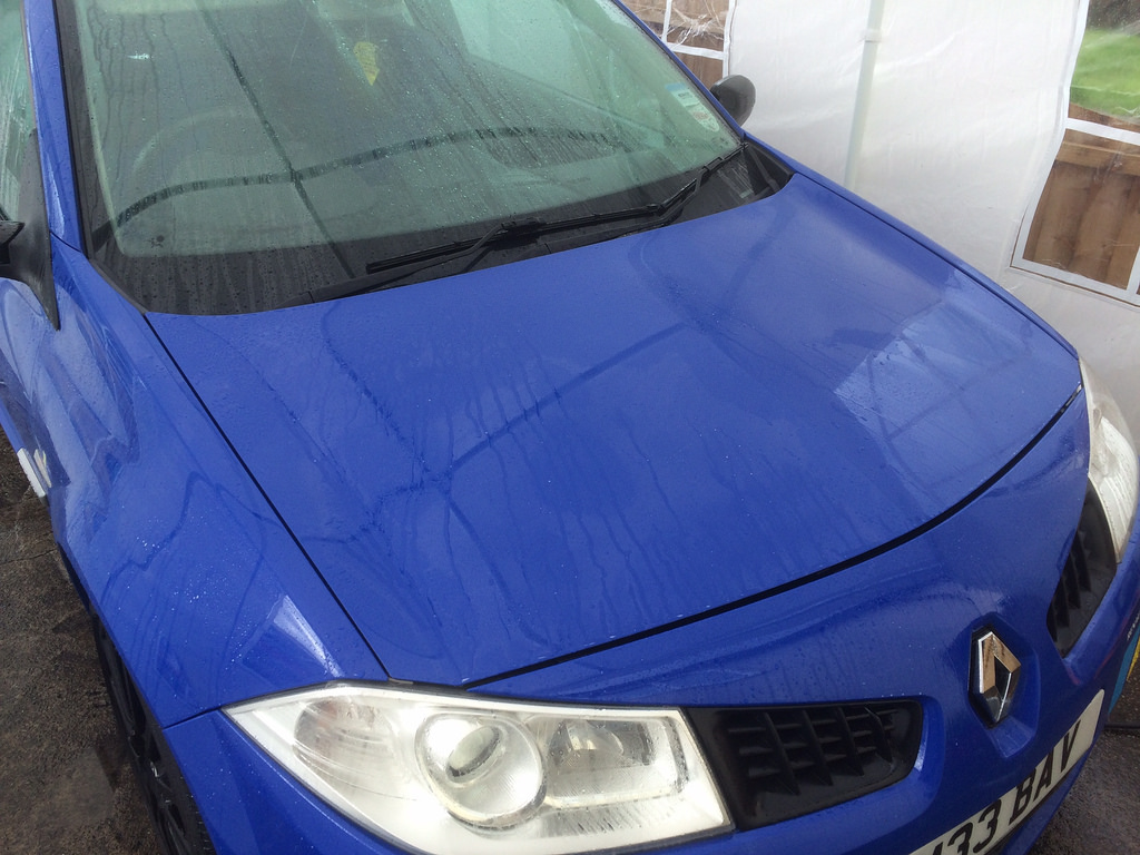

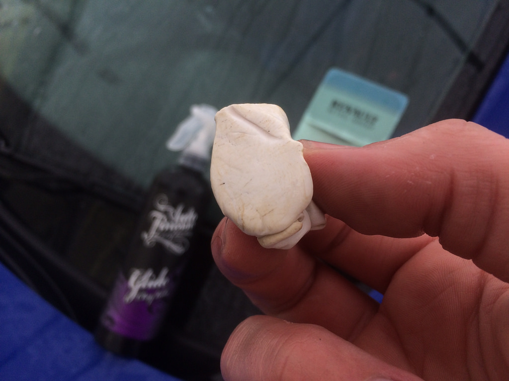

Sprayed off and washed again ready for clay.

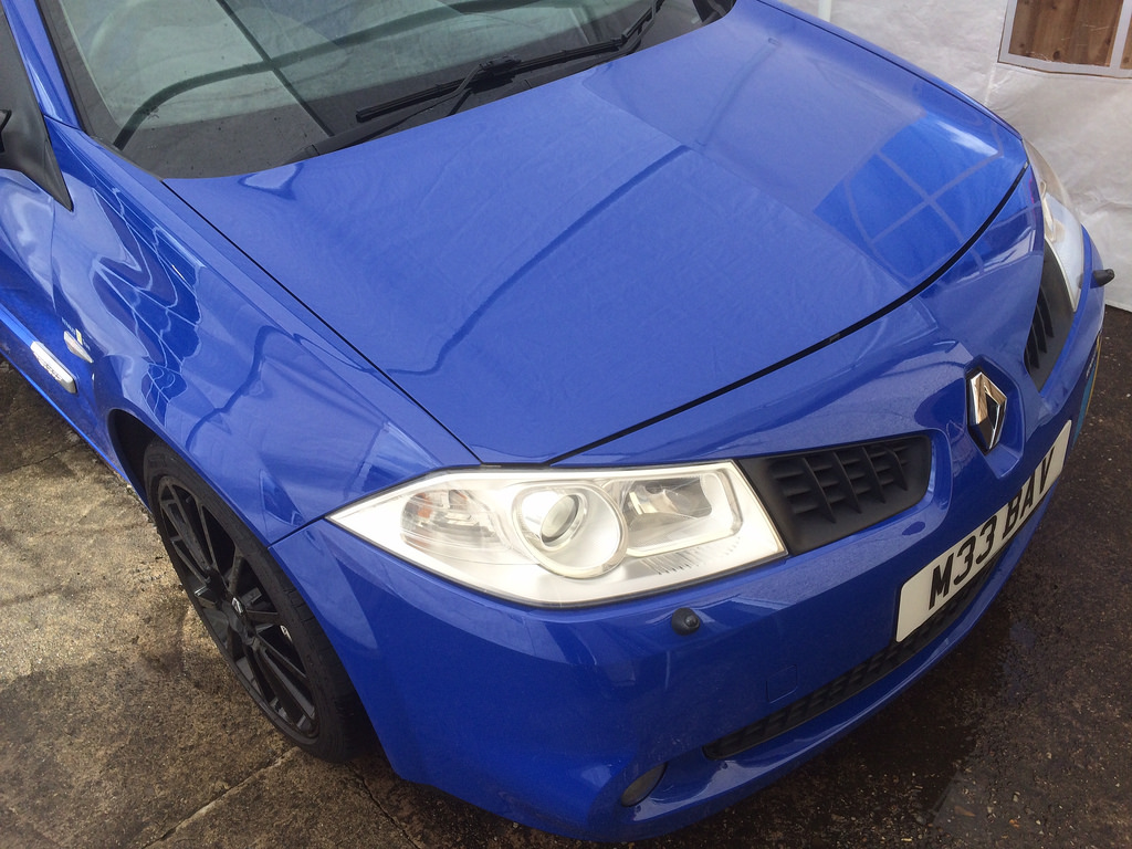

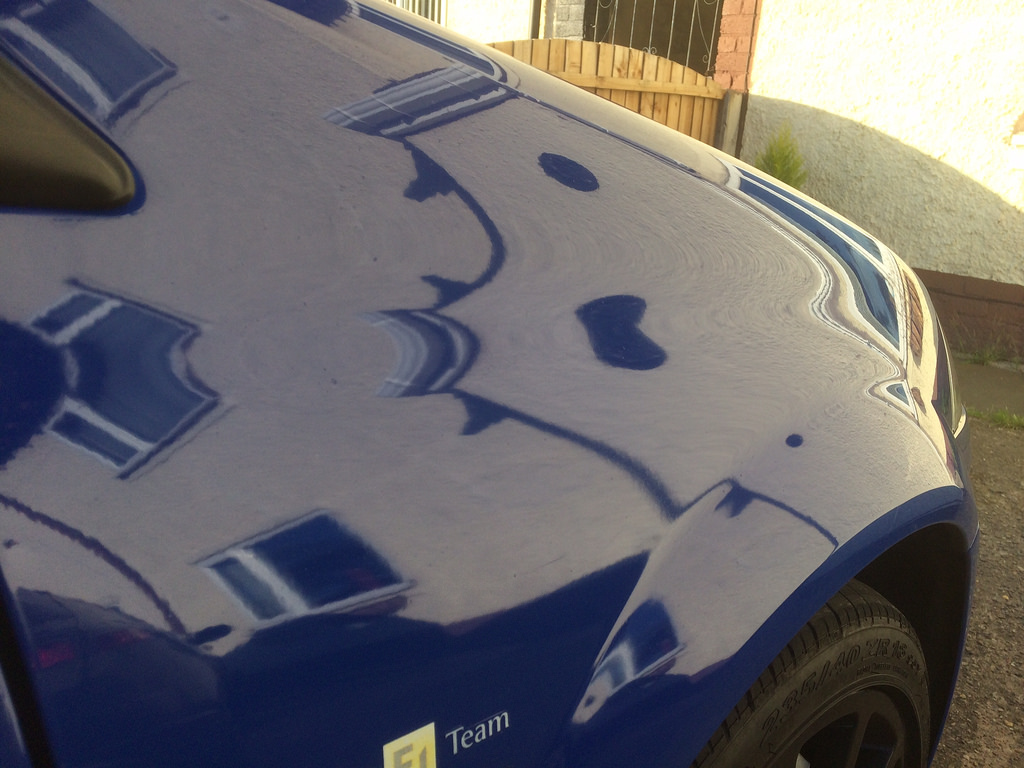

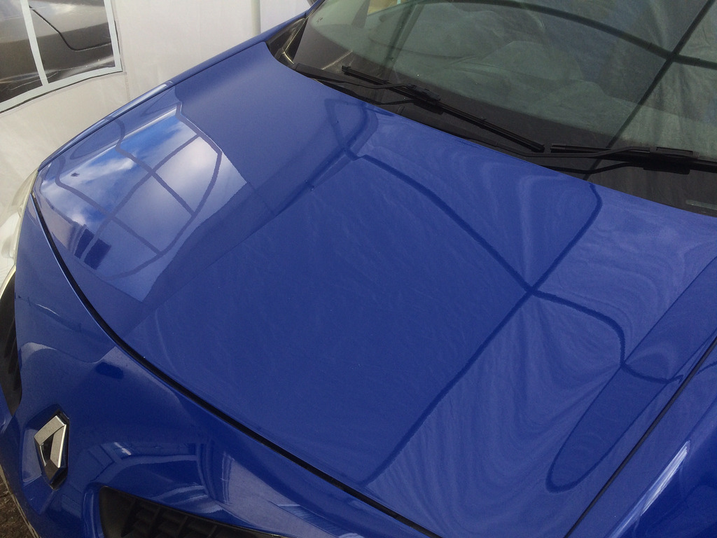

Got a shock at the bonnet! It could've done with another hit of tardis.
The wing was better, the rest of the car came off a bit like this tbh.

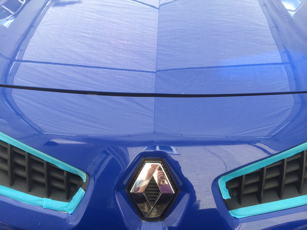

Rinsed and dried ready to be taped

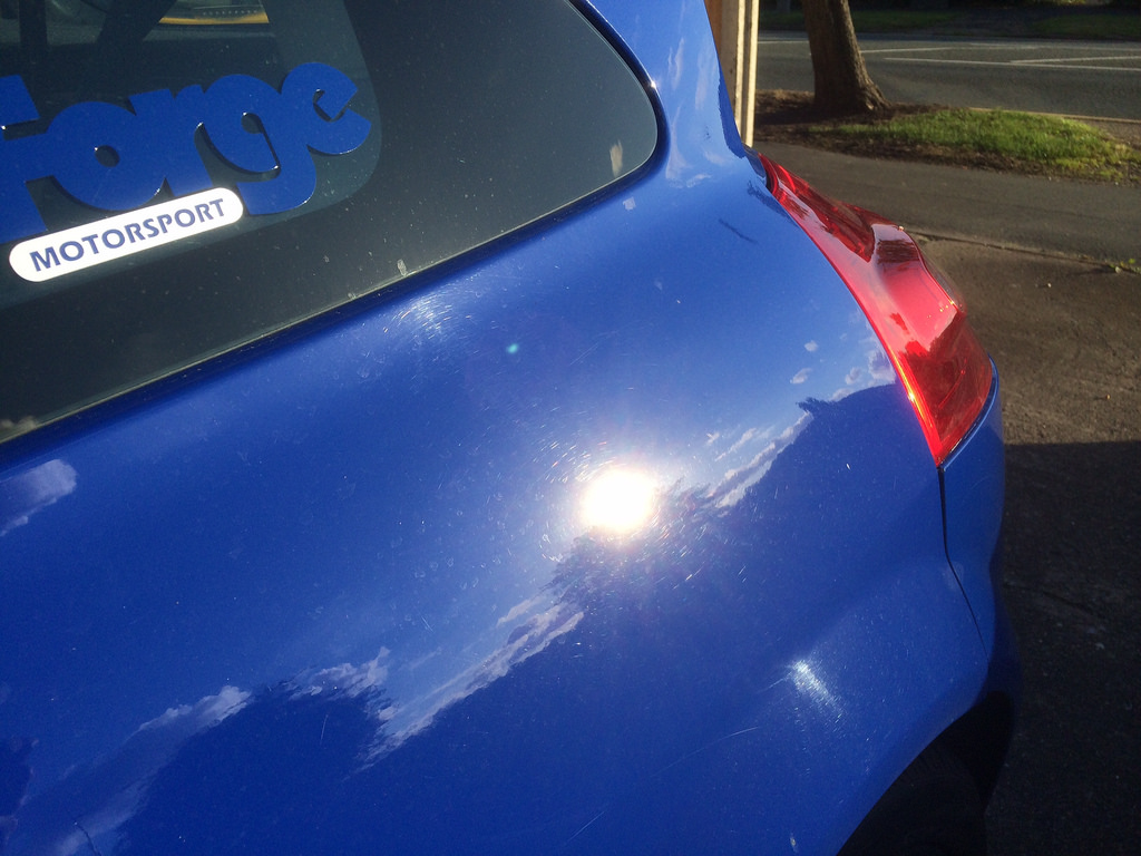

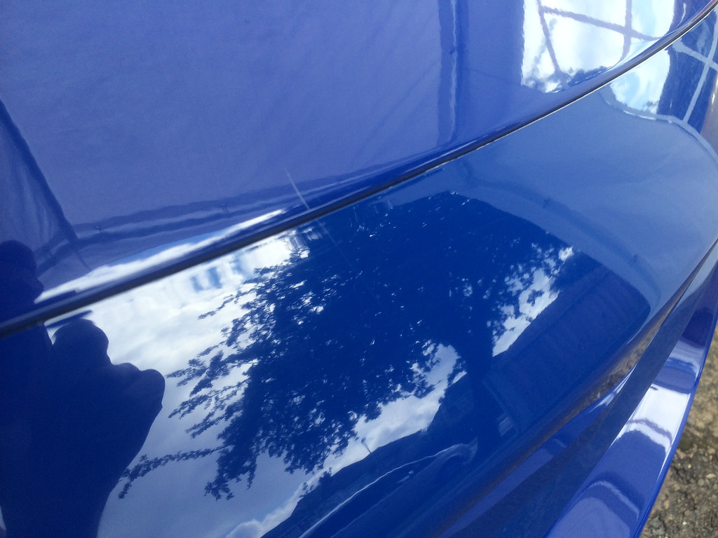

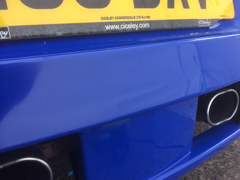

Some more random scratches
Odd marring in places too

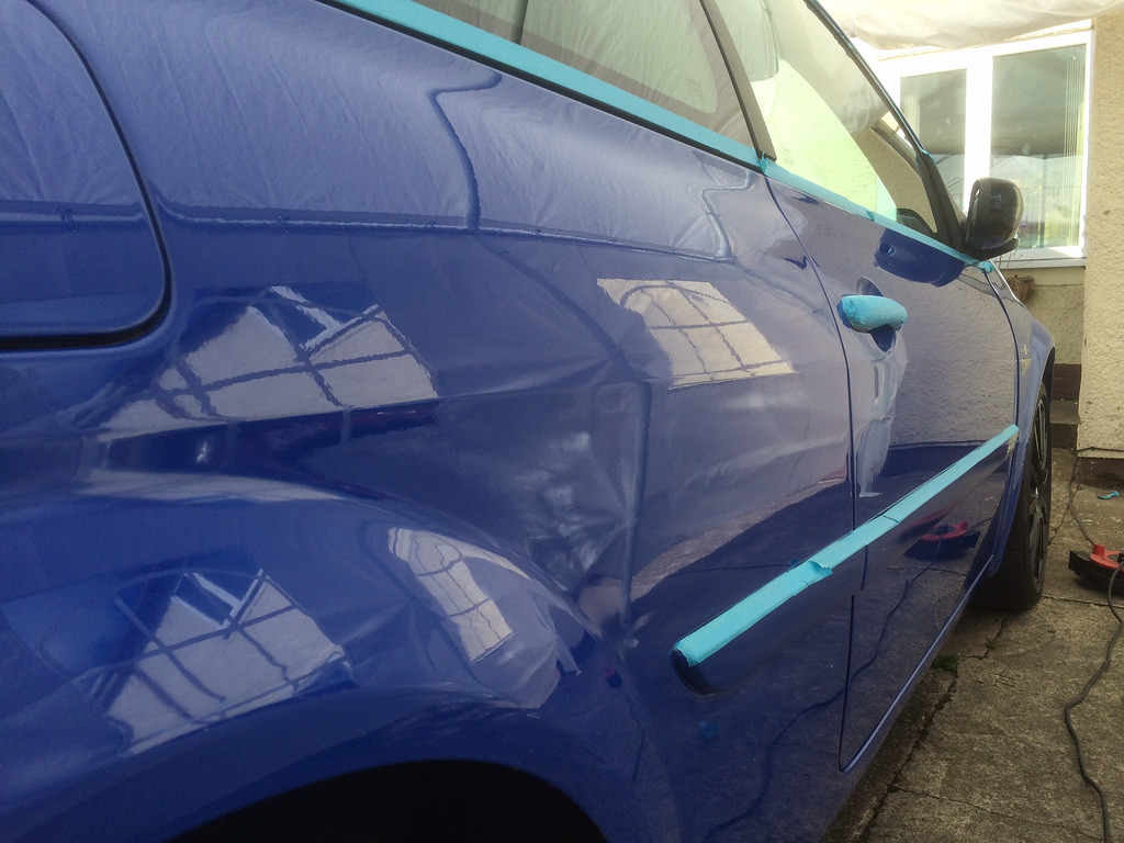

The sun came out just in time for polishing

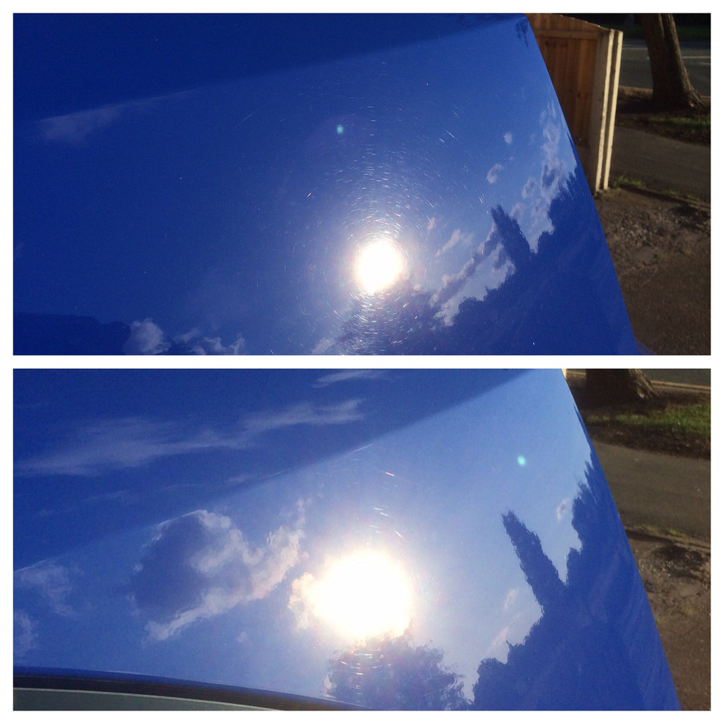

I mainly used auto finesse revitalise #2 as I was aiming to get it all done today, I figured this would add some depth to the finish as well as removing most of the swirls.

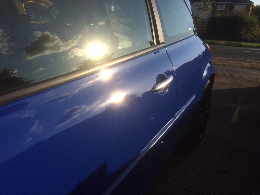

This was difficult to capture. You can just make out the 50/50 here after a pass with AF #2. It didn't remove it to my liking so I moved to AF #1 then back to #2 to finish
Then I went on to tackle the rest of the car.

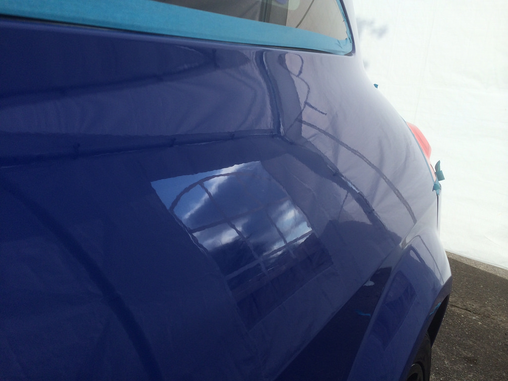

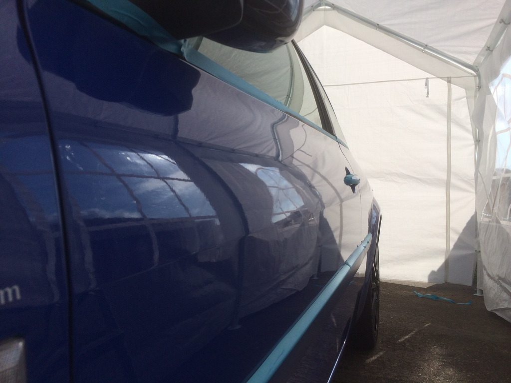

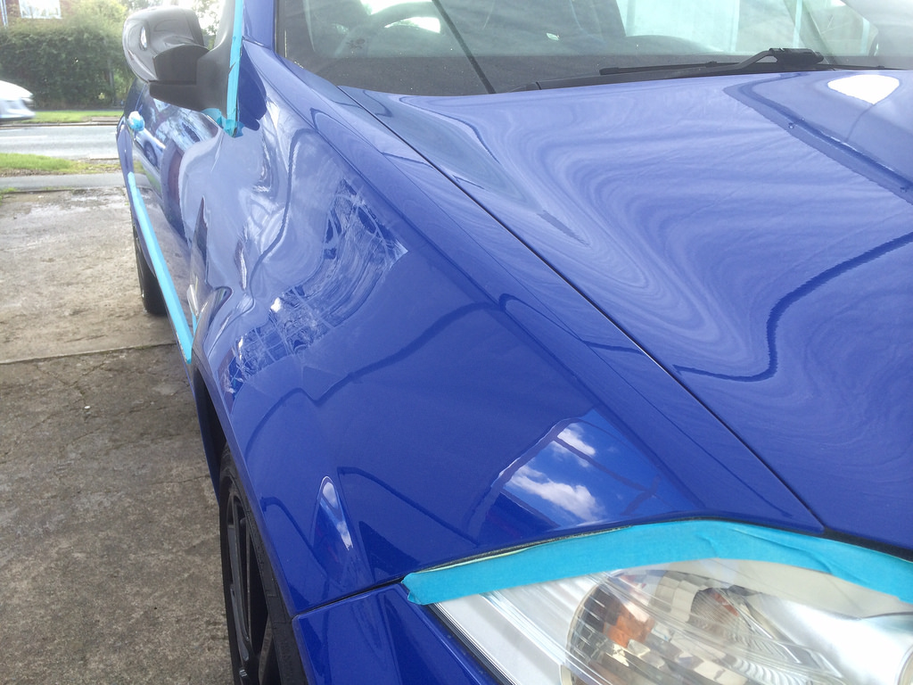

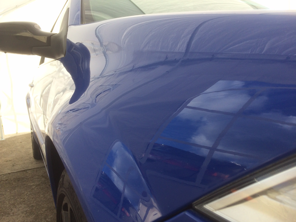

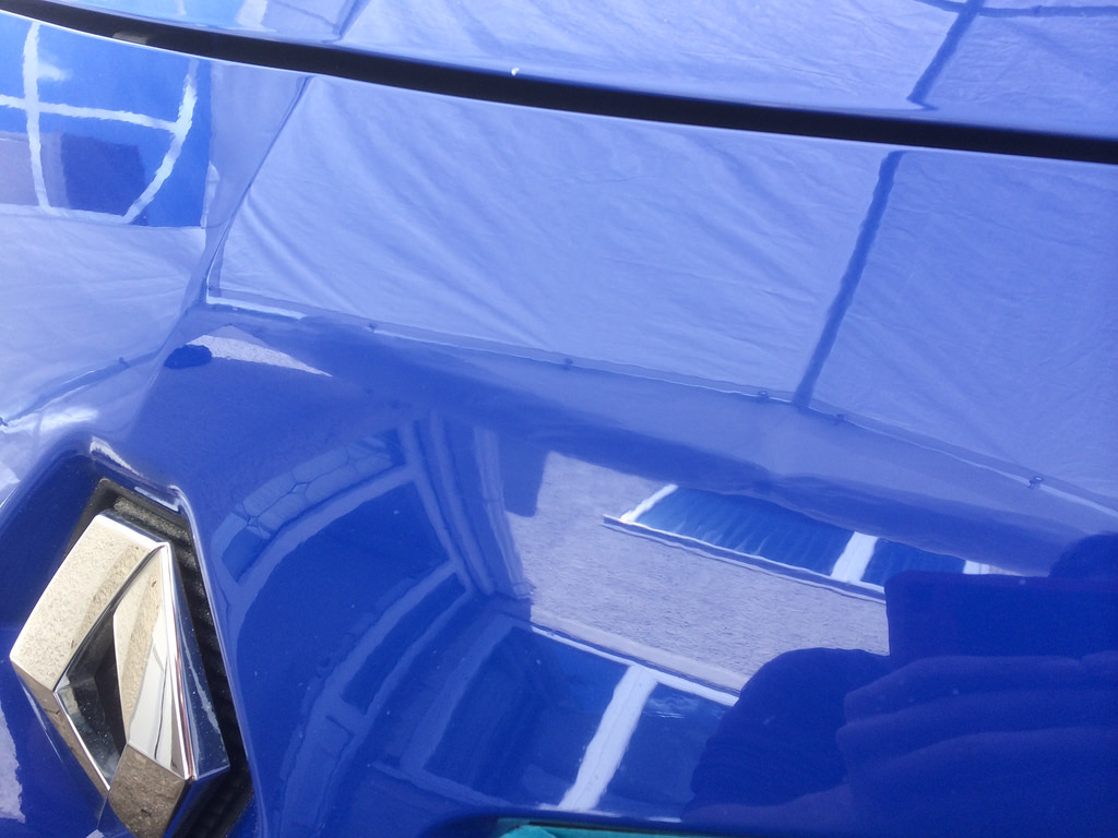

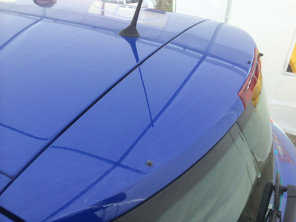

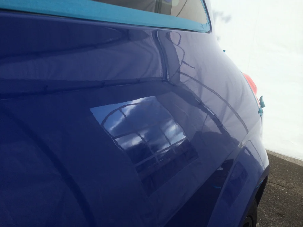

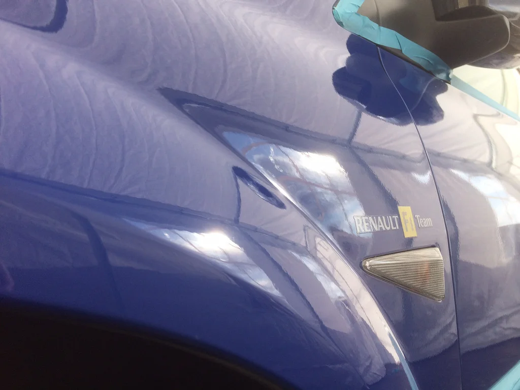

The wing came up brilliantly IMO, almost no orange peel.
This had some marring which I struggled to capture, it just looks like the reflection is unfocused.
The bootlid came up brilliantly

The wind then picked up so the gazebo came down

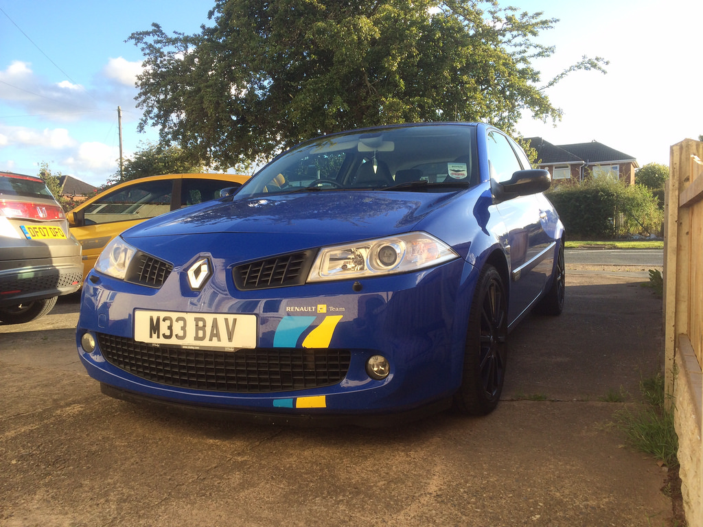

The deeper scratches and RDS' remained but I was happy with the finish given the time I had.

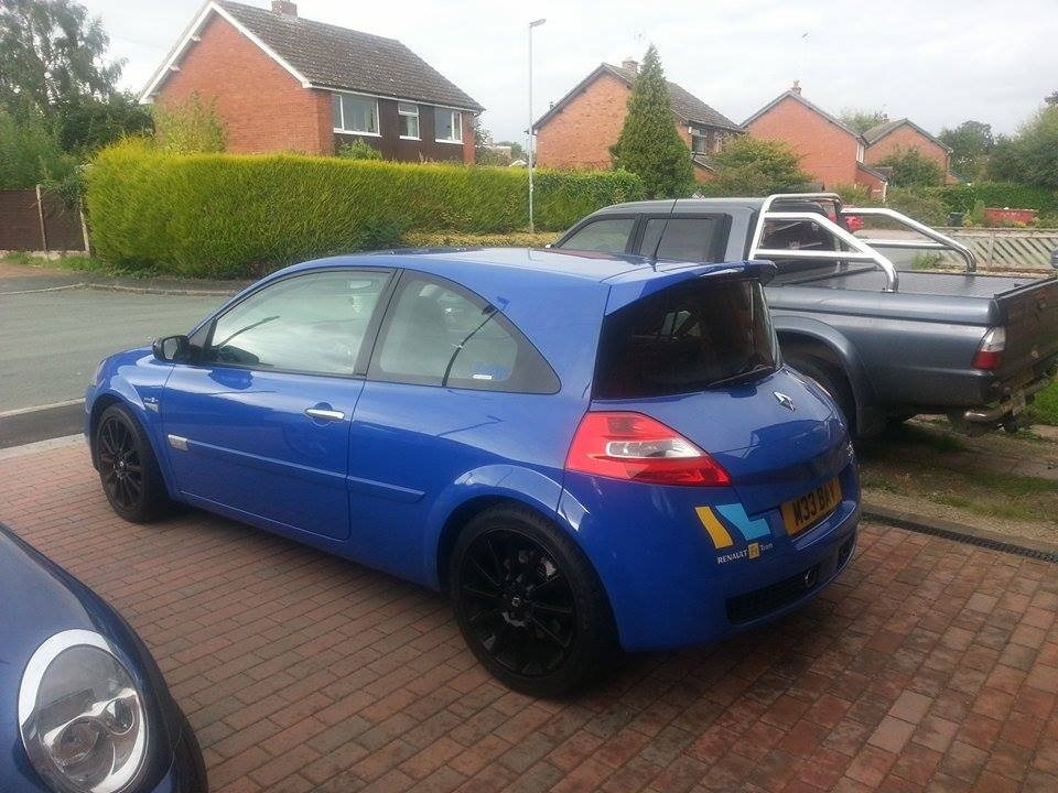

And with the .r spoiler from spray shack fitted
I'm waiting on some more finished photos as I forgot to get any before the car was collected :eek:

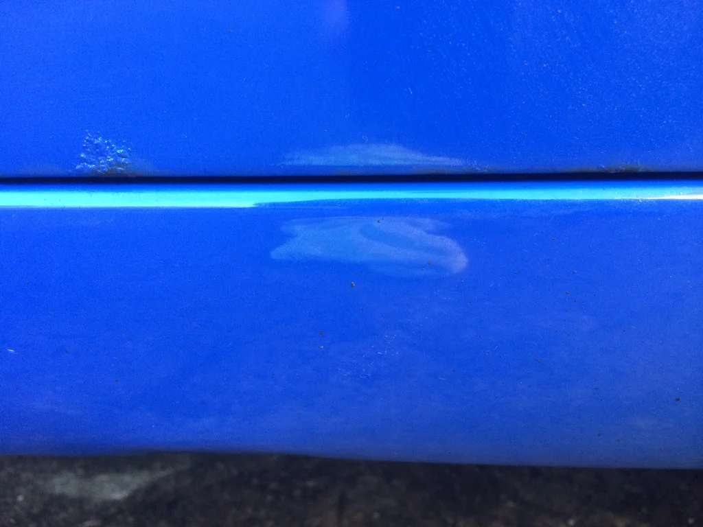

That little rust bubble doesn't look good, what year is it?

@Jay.S 56 I think, it's due to the drains in the door getting blocked, apparently it's common on Meg's. The owner has a new door coming to replace it with. Ah you should've stopped by to say hi.
