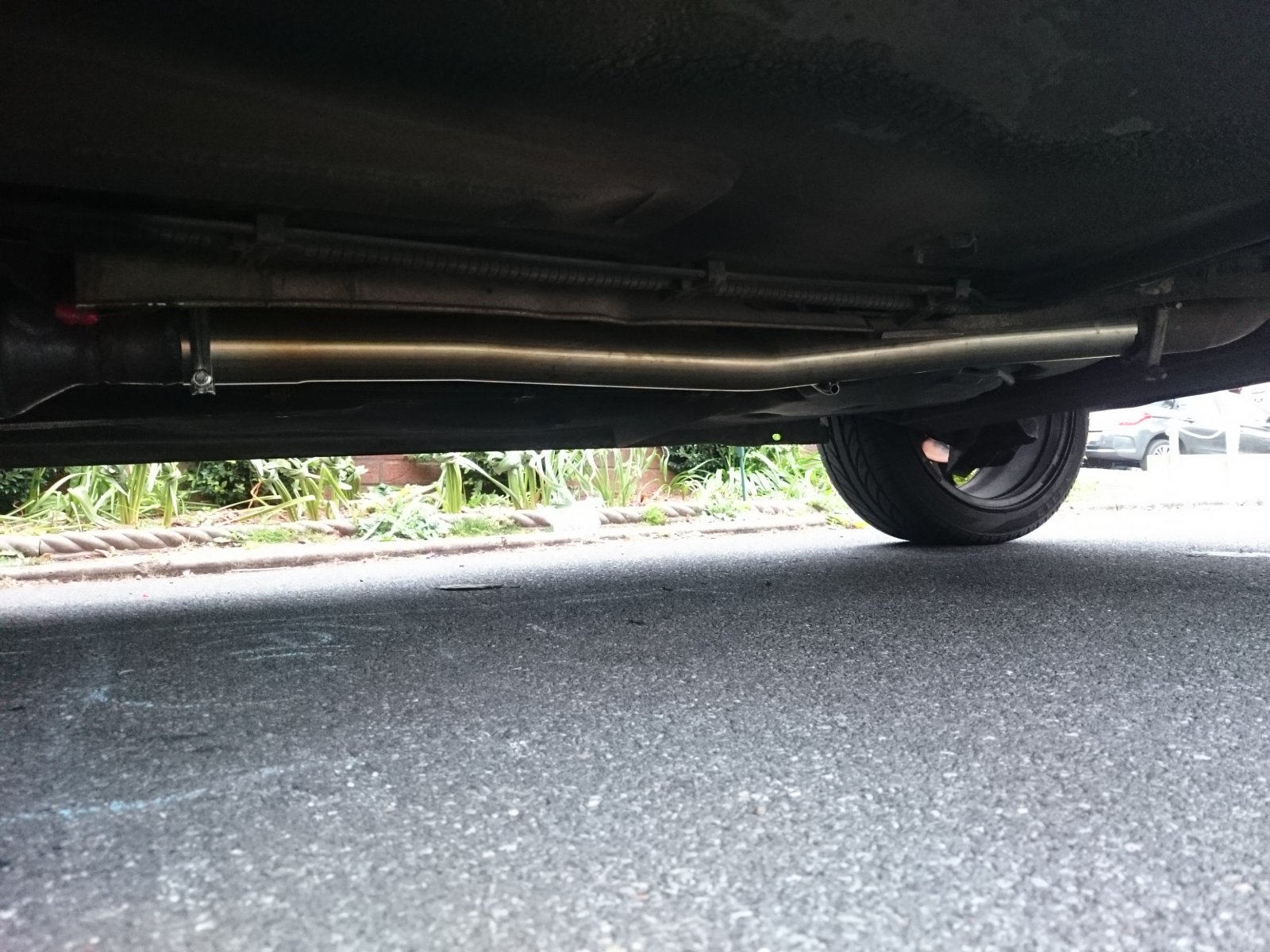

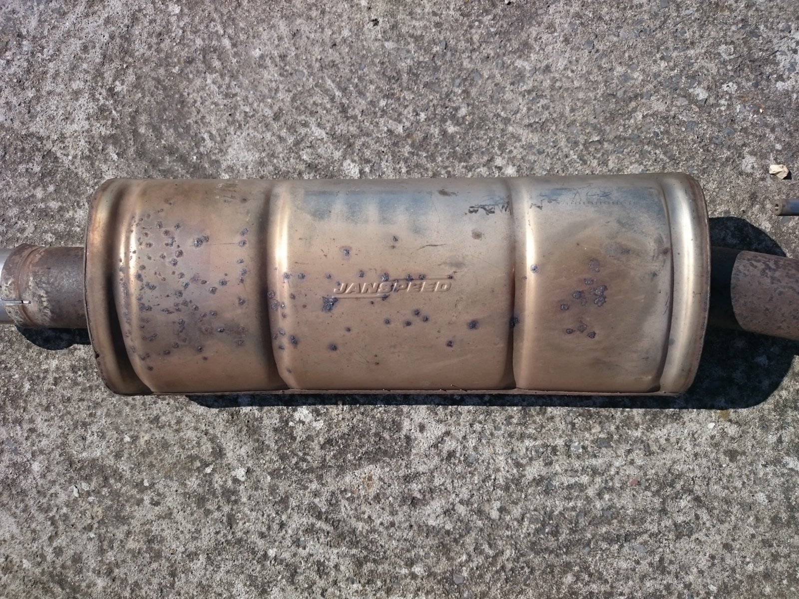

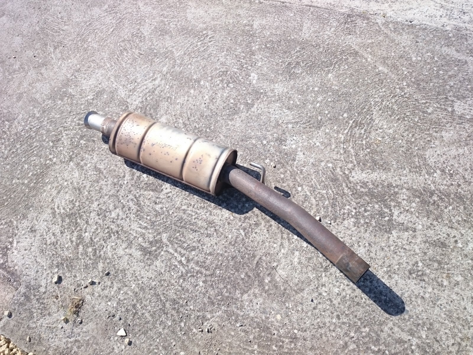

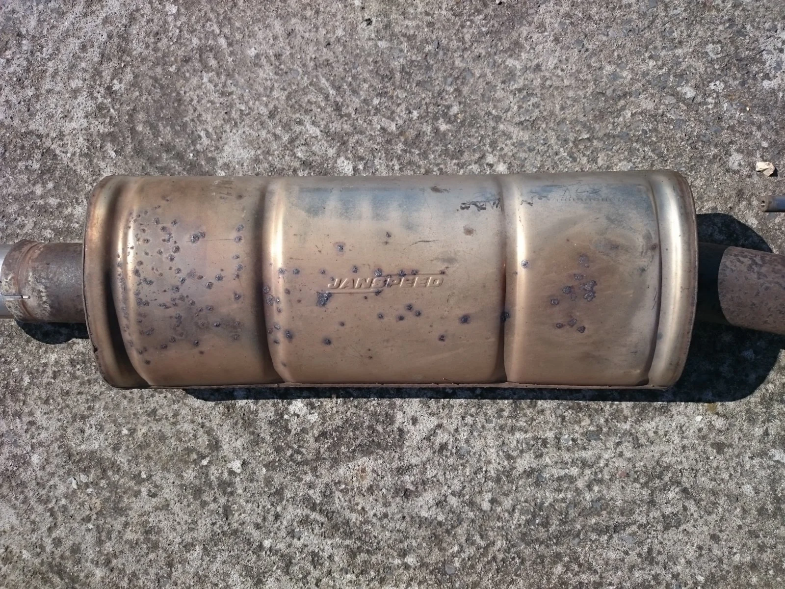

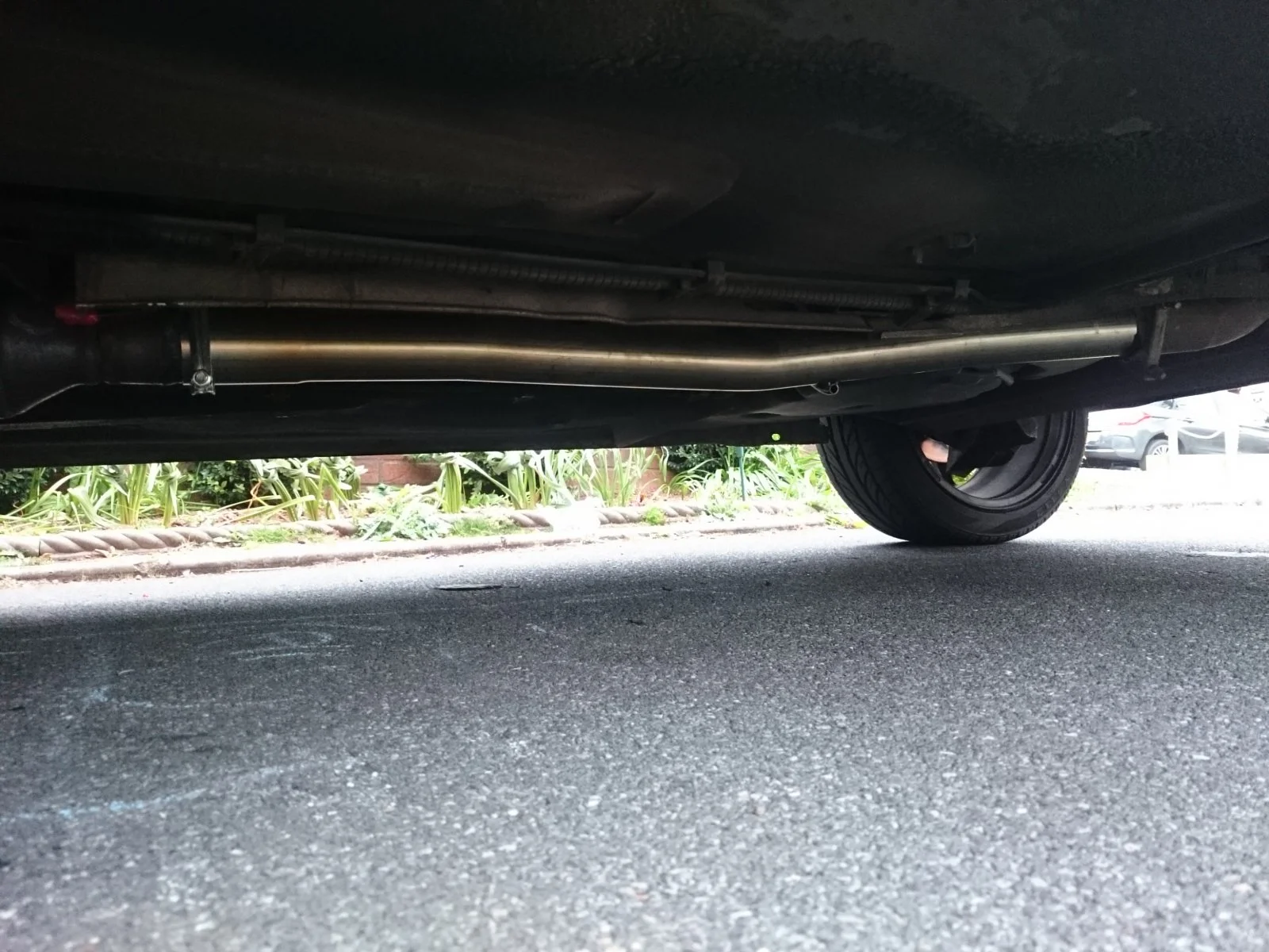

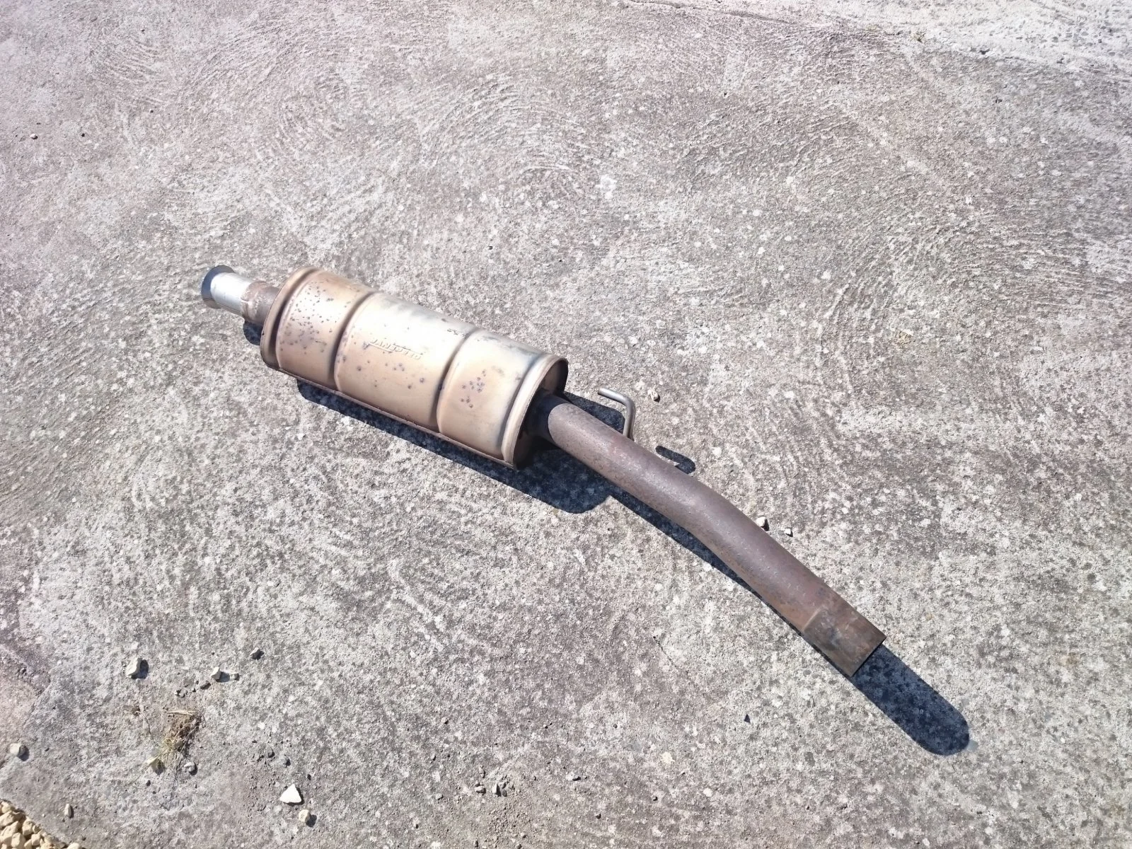

So after solid exhaust mounts, new centre mount, new donut gasket between cat and manifold, new cat and weld mod to match exhaust diameter, engine mounts, Evol dogbone mount and all hestshield clips the rattle continued until.....replacement Janspeed centre section.
Went for the unsilenced section over silenced which I've had on the car since 2009, and the noise difference is marginal without a decat. So, so pleased this has finally cured the pain of wondering and the expense!
