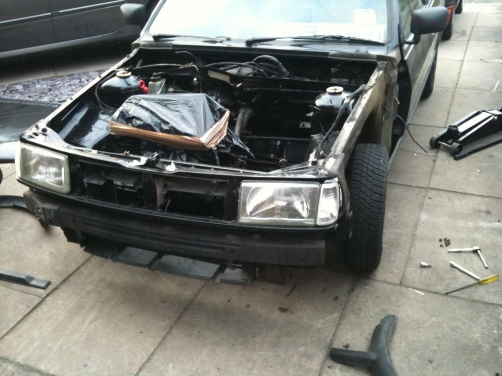

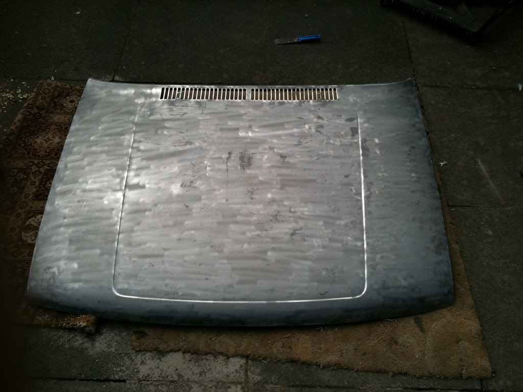

Bonnet stripped

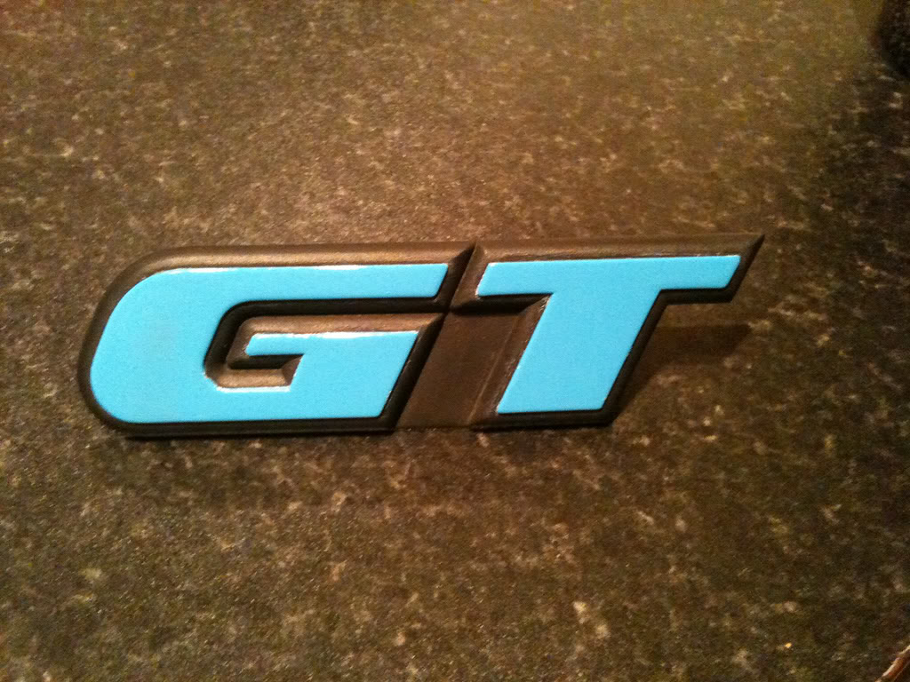

Painting badges

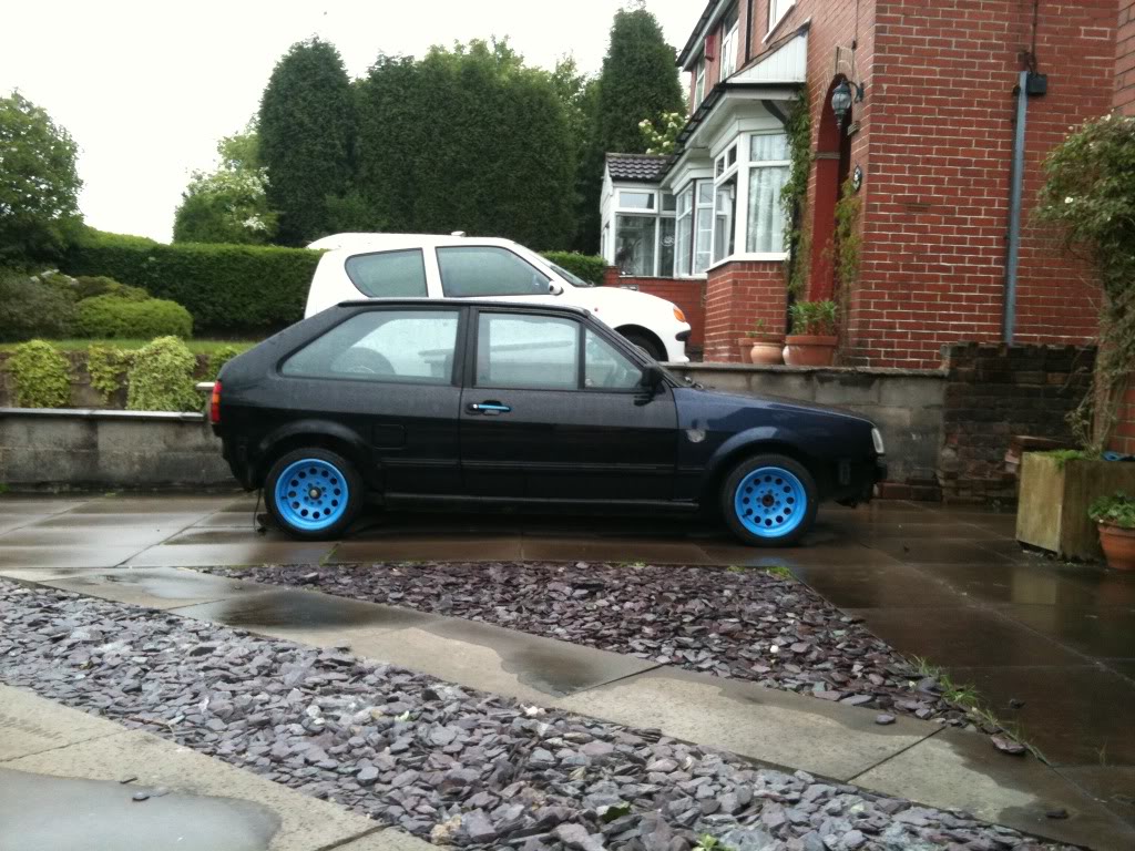

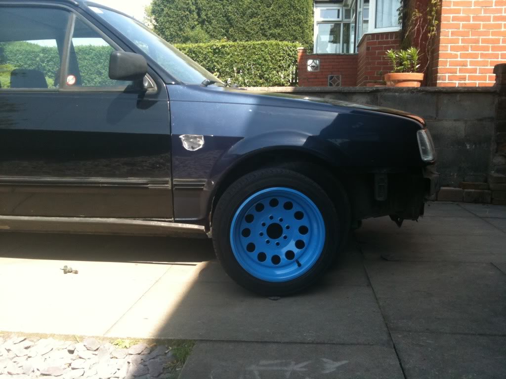

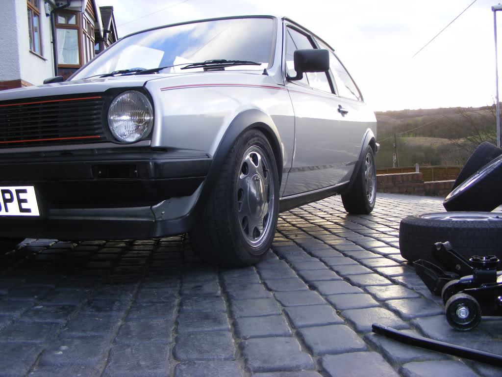

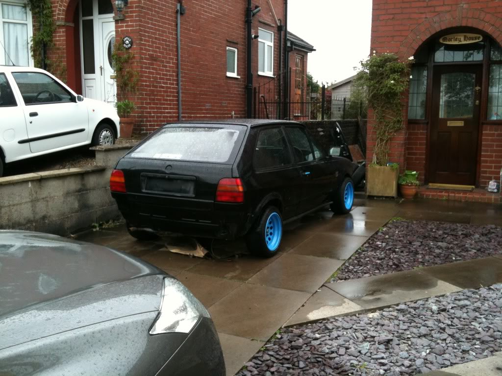

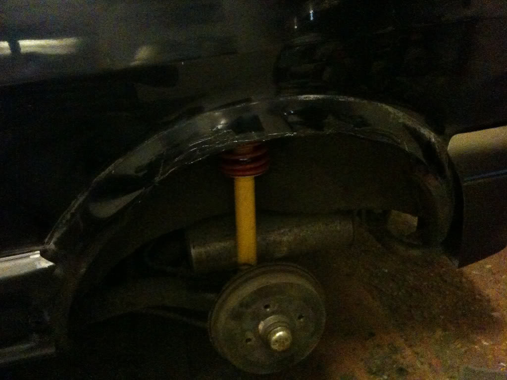

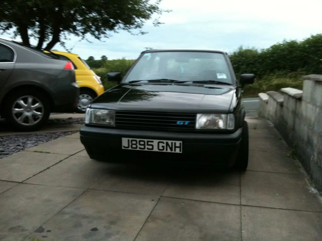

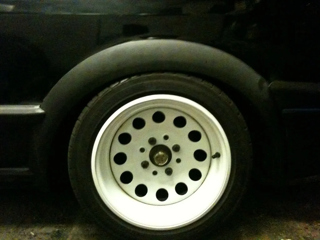

Lowering, but had a few problems with the wheels fitting

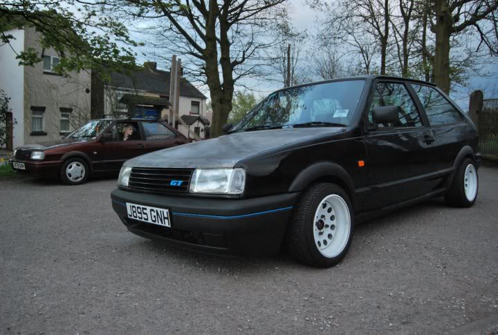

Fitting and sitting nicely now,

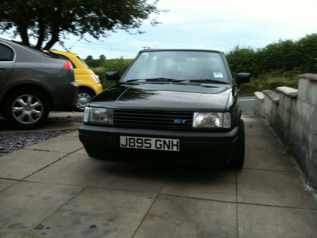

Few pics of her up and running

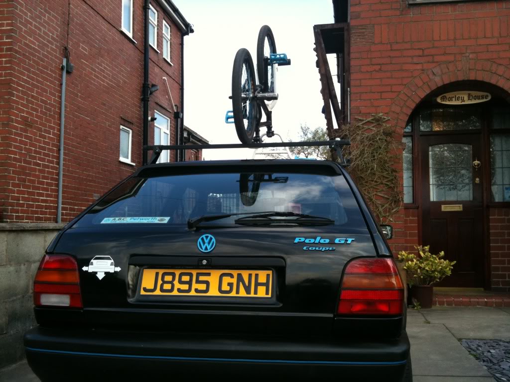

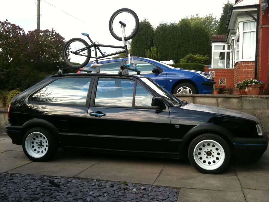

Painted the rest of the badges and roof rack on

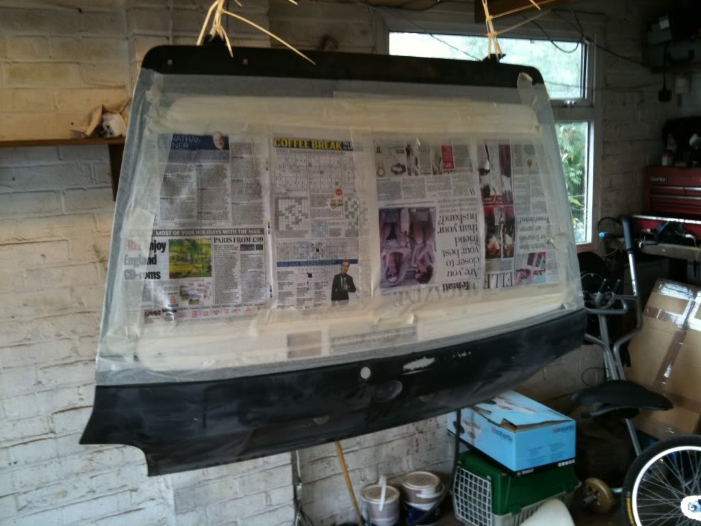

Dent free boot prepped and masked

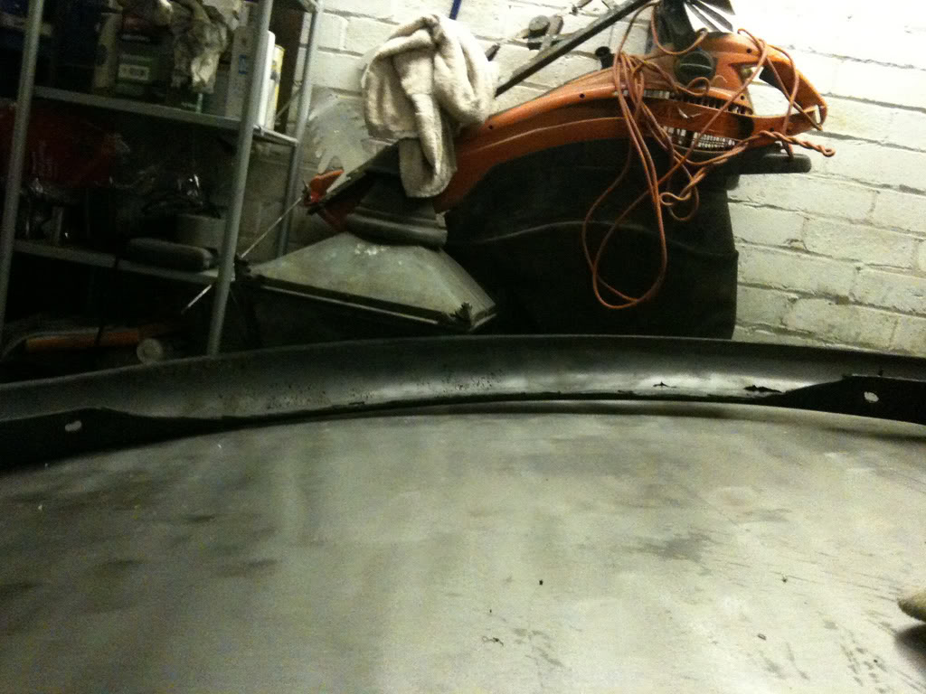

Painted the bonnet

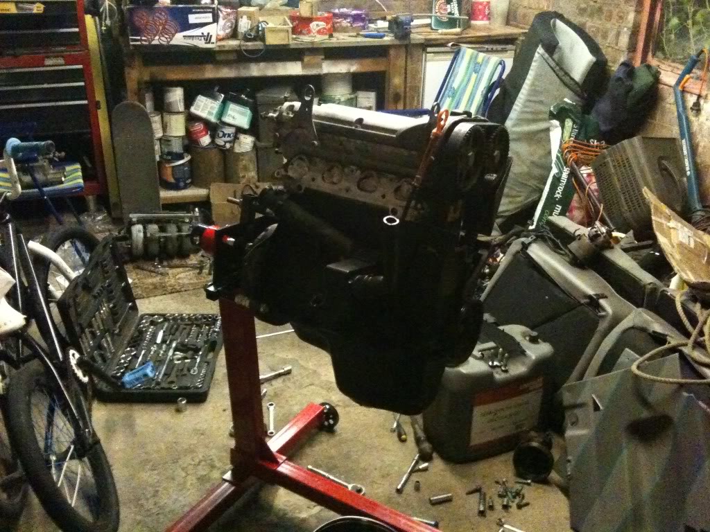

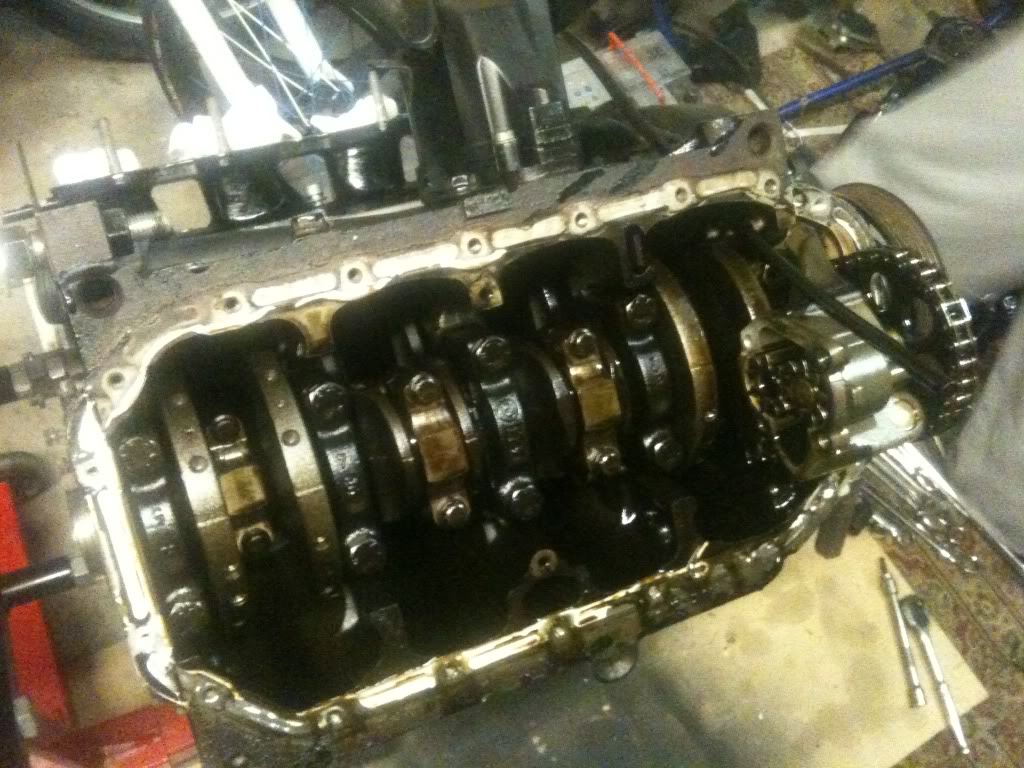

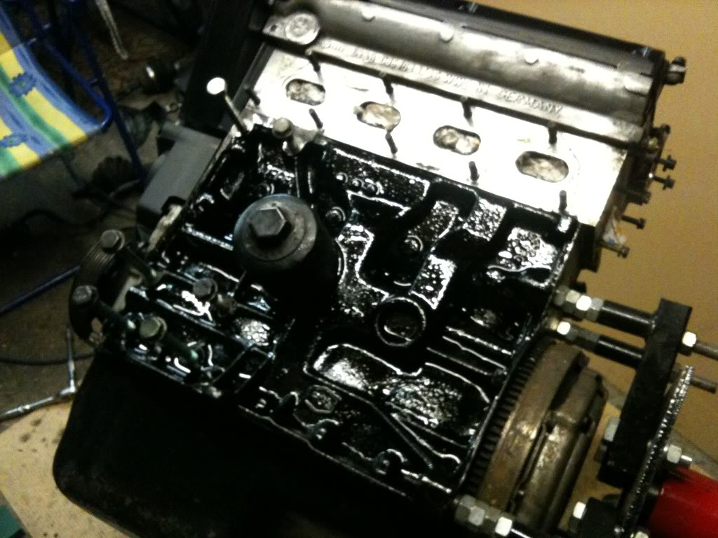

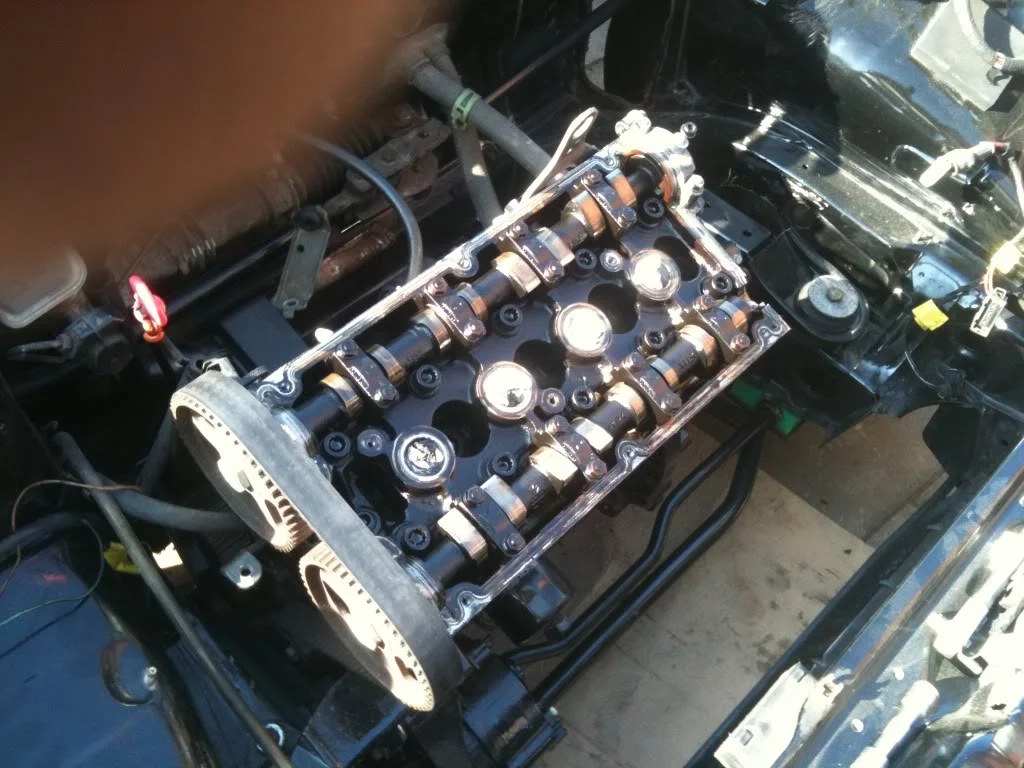

Picked the new engine up and set to work cleaning the 10 years of sh*t off it

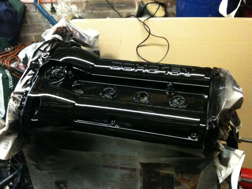

Painted the rocker cover with some black enamel paint.

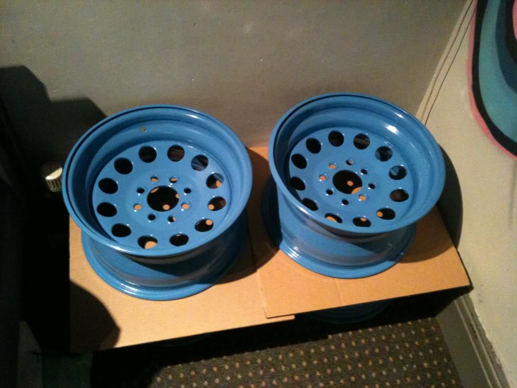

Got the wellers powder coated

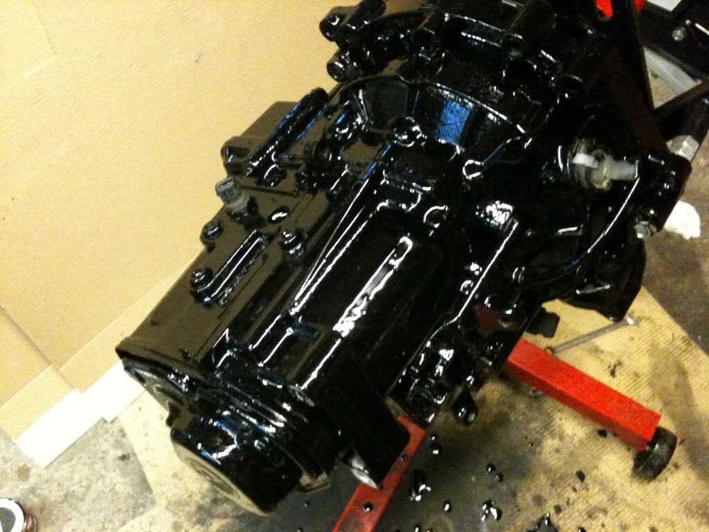

Painted the block (sorry about phone pics)

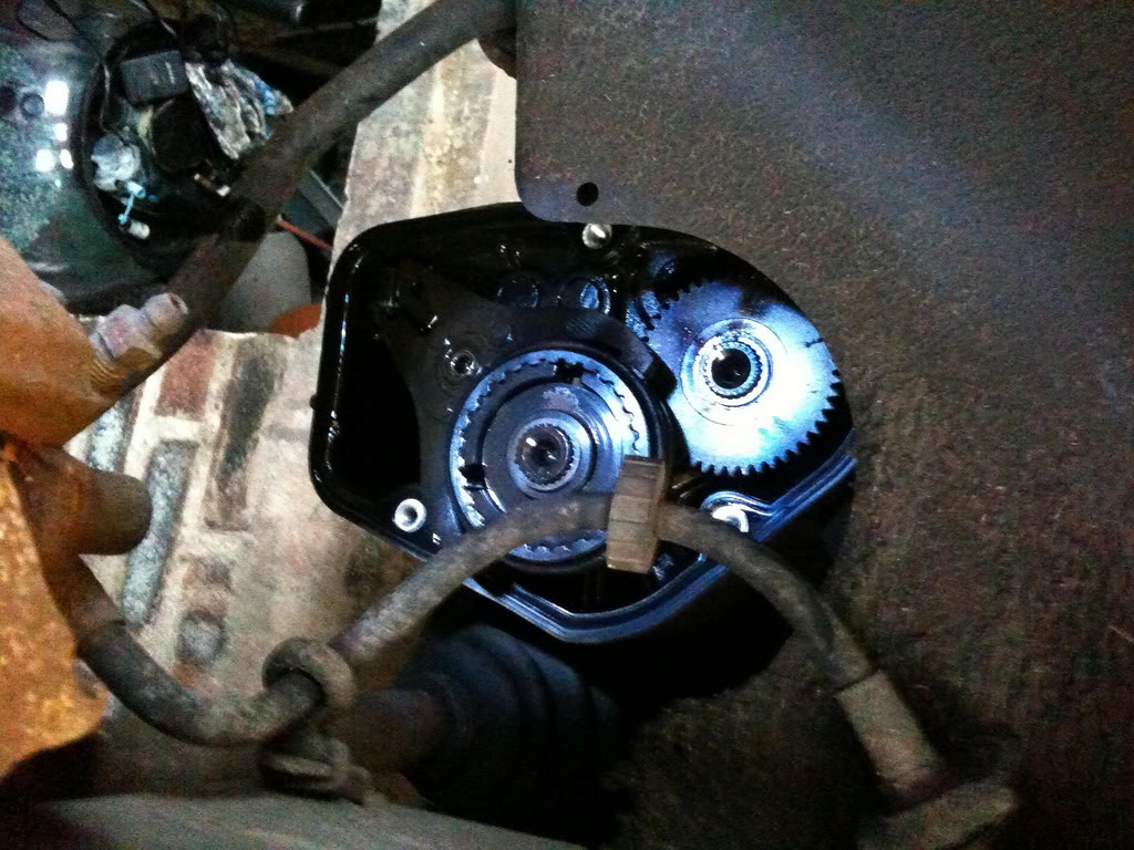

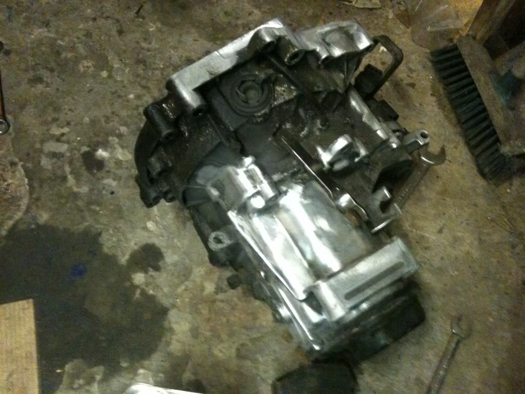

and cleaned up the gearbox
Little meet with the coupe, bready and next doors coupe.
Finished cleaning the gearbox and painted it

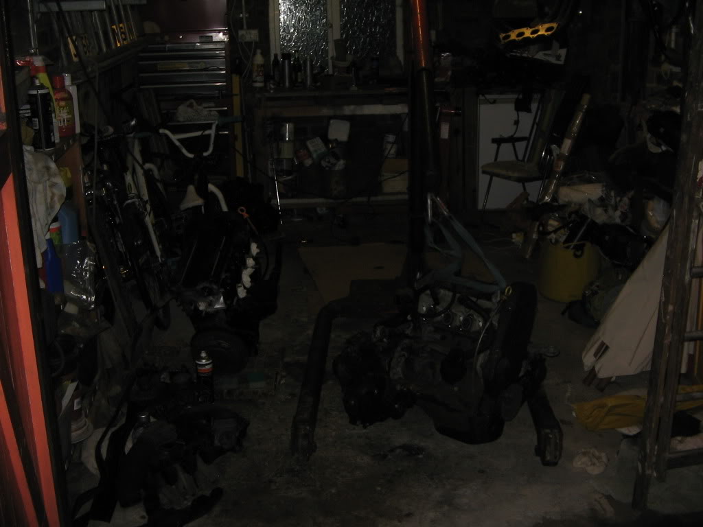

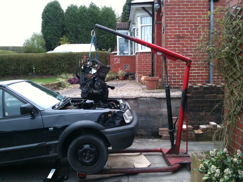

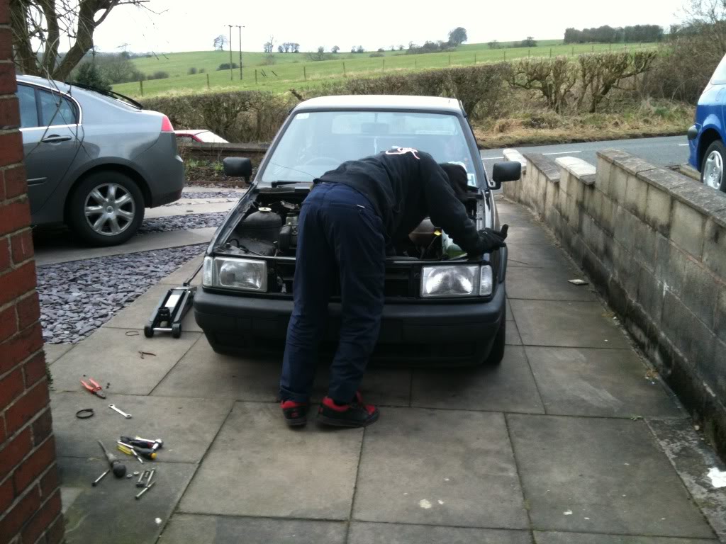

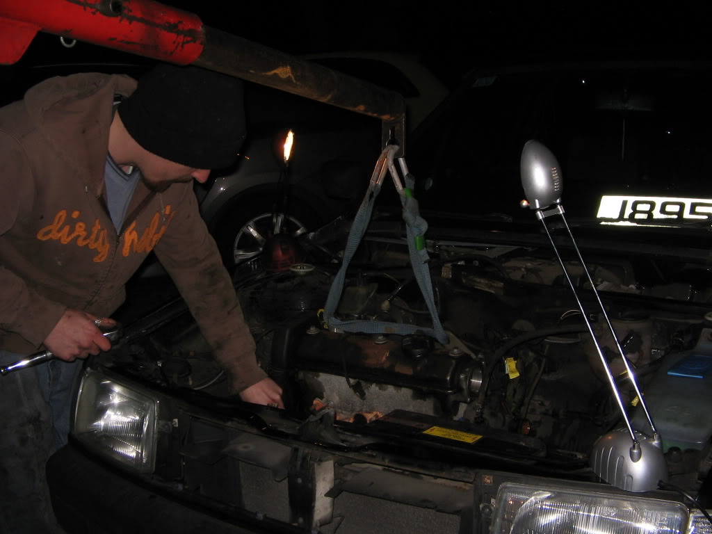

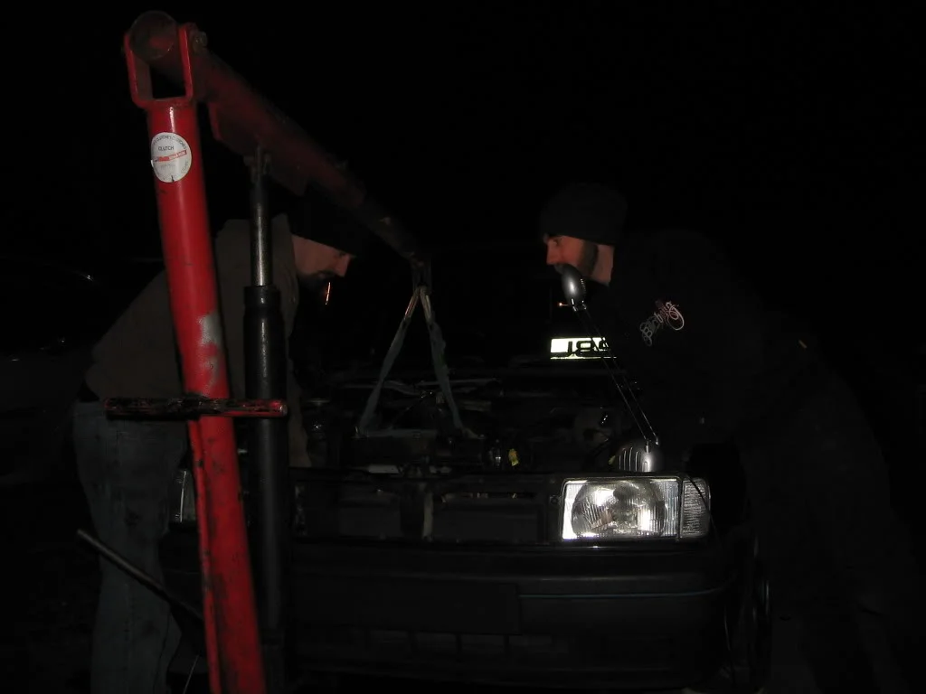

Borrowed an engine crane to get the old one out,

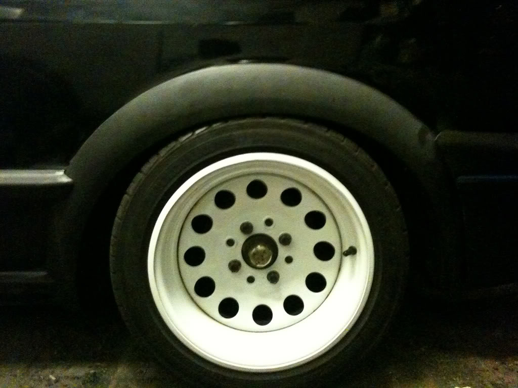

Fitted ben's new wheels, they rub tho so will need to roll the arches.
Anyway getting back to getting the bay ready for new engine.

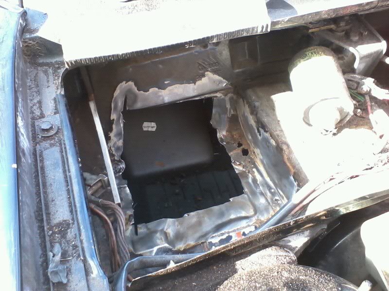

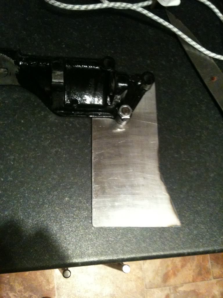

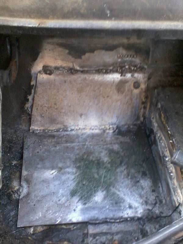

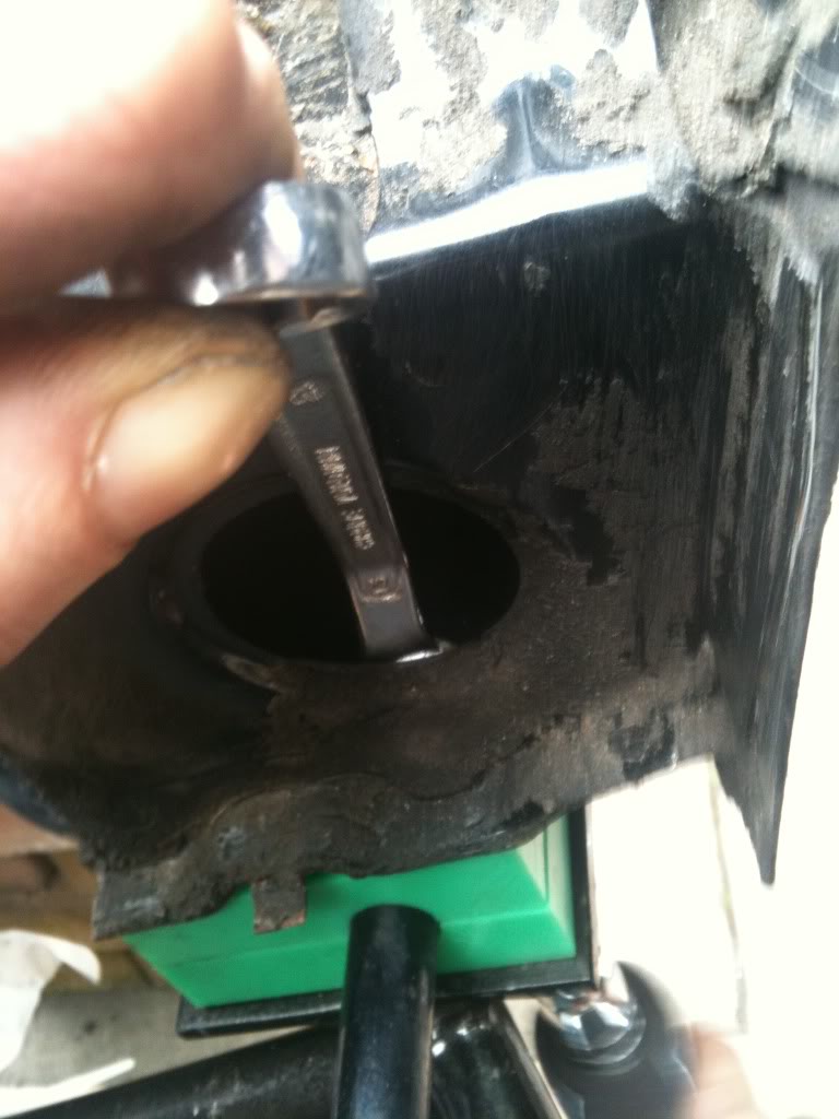

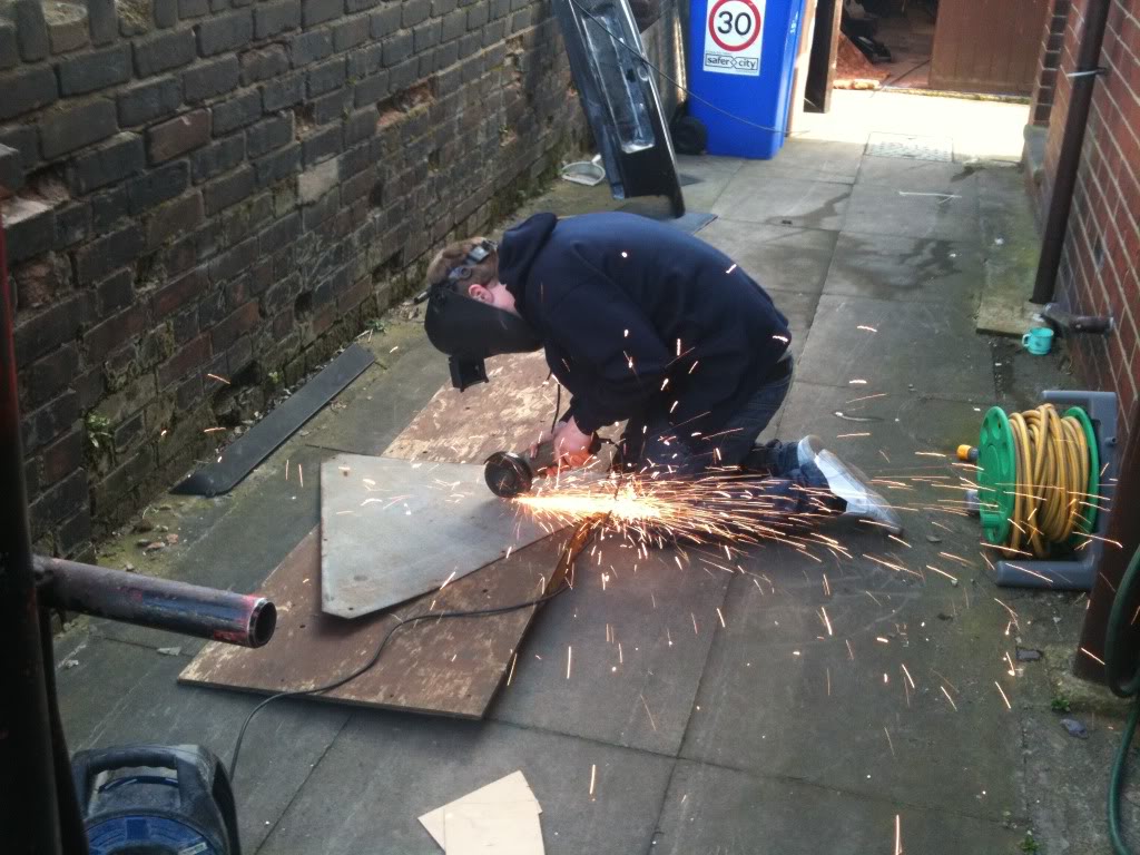

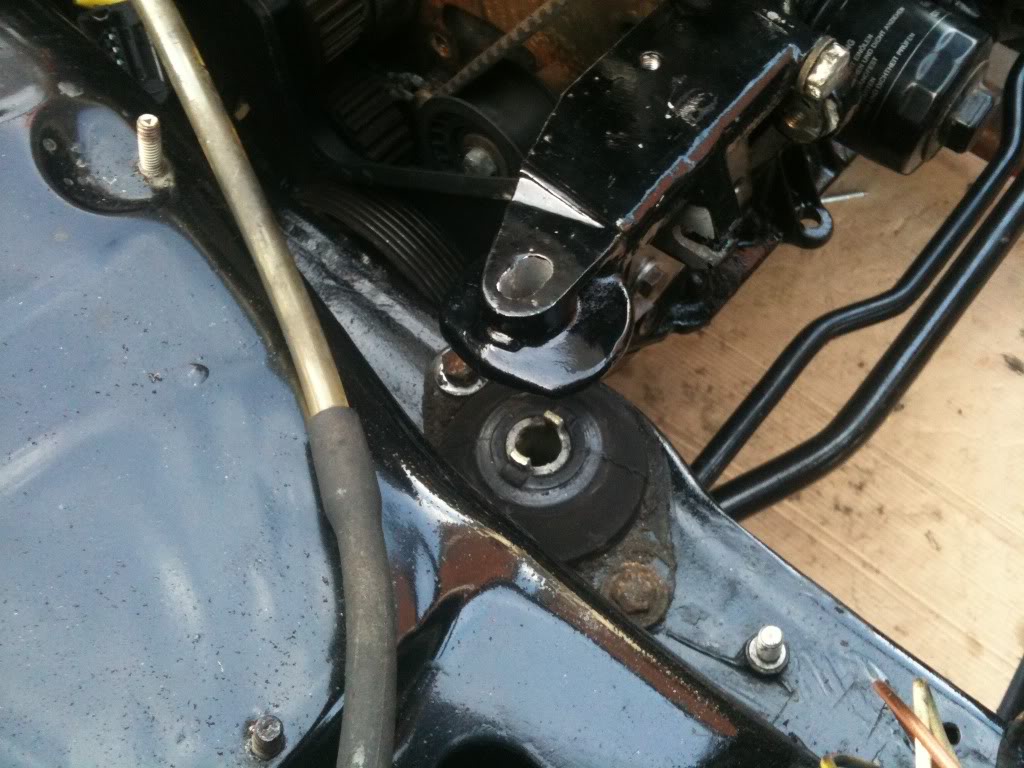

Using a road sign to plug the massive hole in the battery bay
Before
After

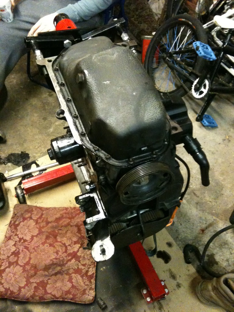

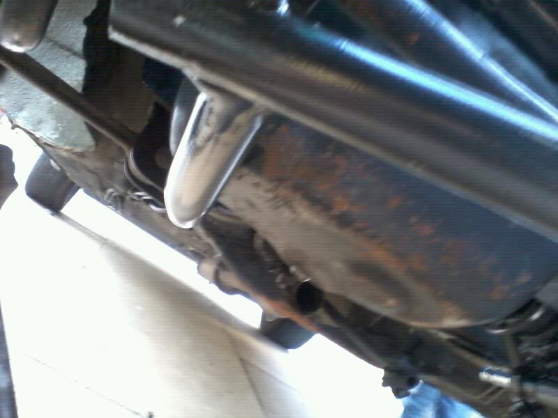

Tried to fit the engine, but need to get a new sump as it won't quite fit in.

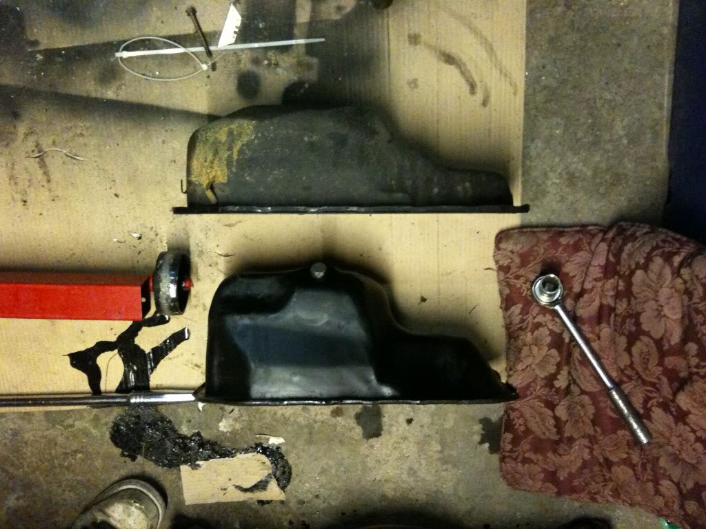

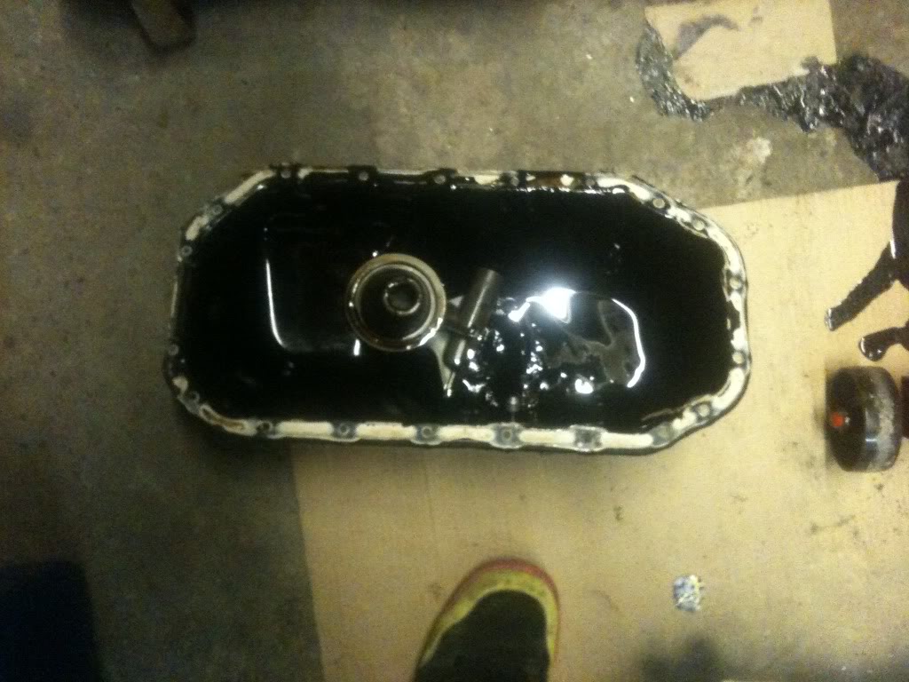

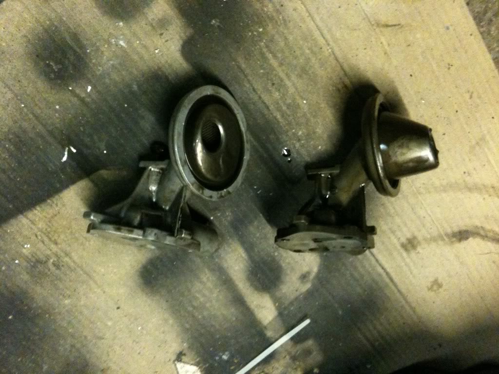

Took off the sump and oil pickup
The new sump came, DPD guy looked at me a little strange due to the little prank
The difference
All back together

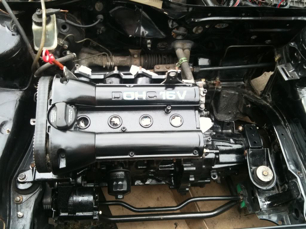

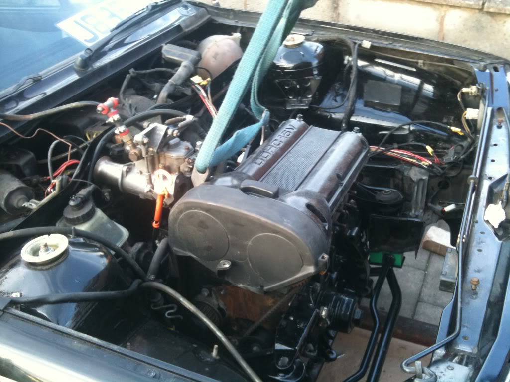

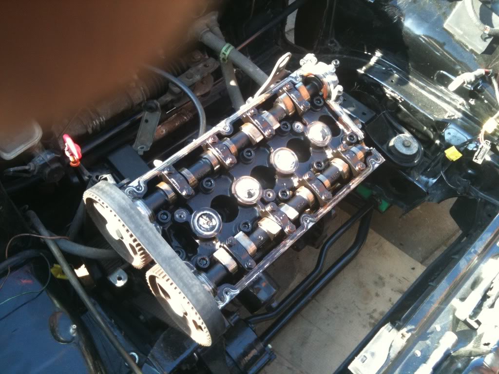

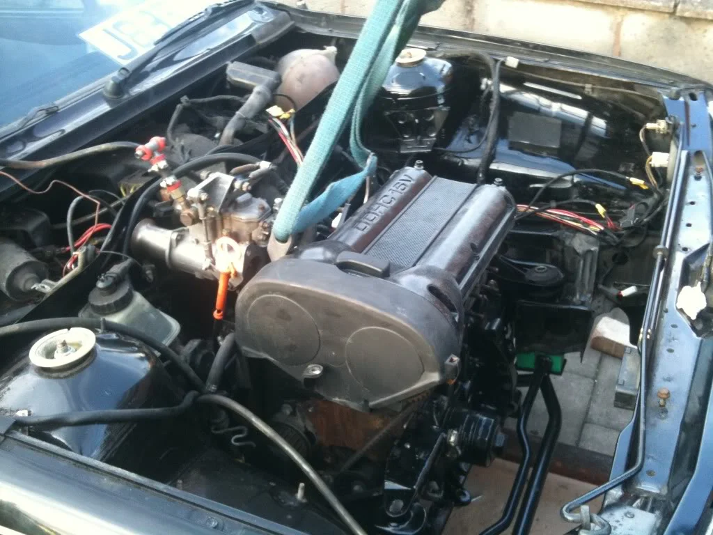

Engine back in!!

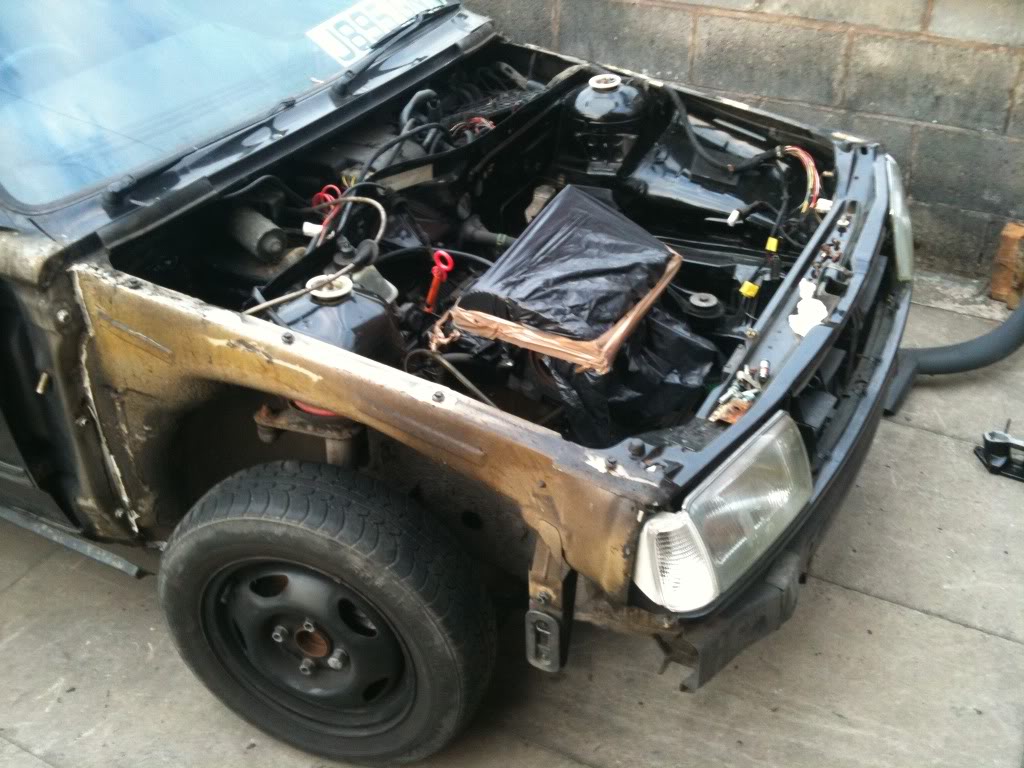

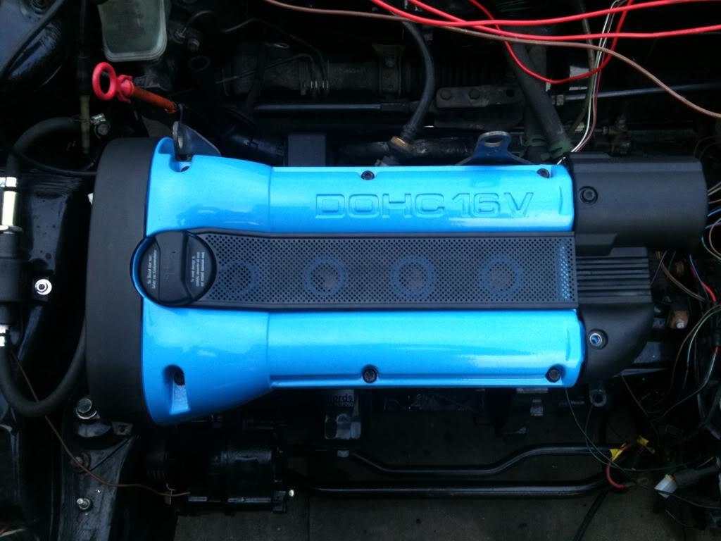

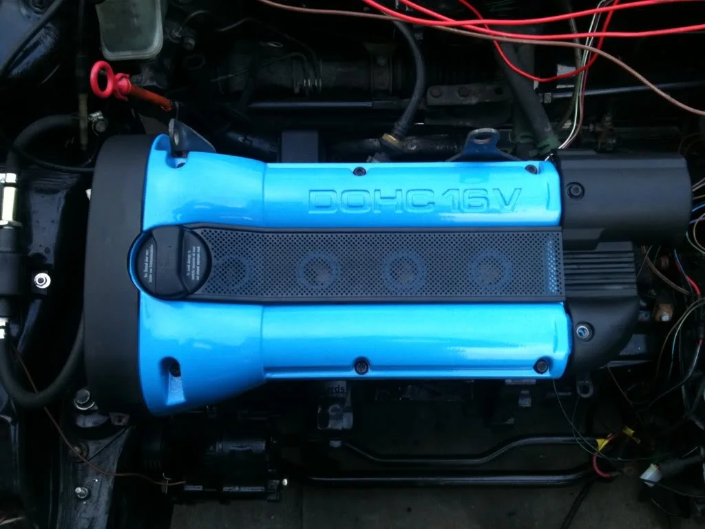

Popped the rocker cover off to get it powder coated blue and took the arches off as having new ones without dents.
Got the new wings on with the side repeaters welded up. Will be getting a full body respray soon.

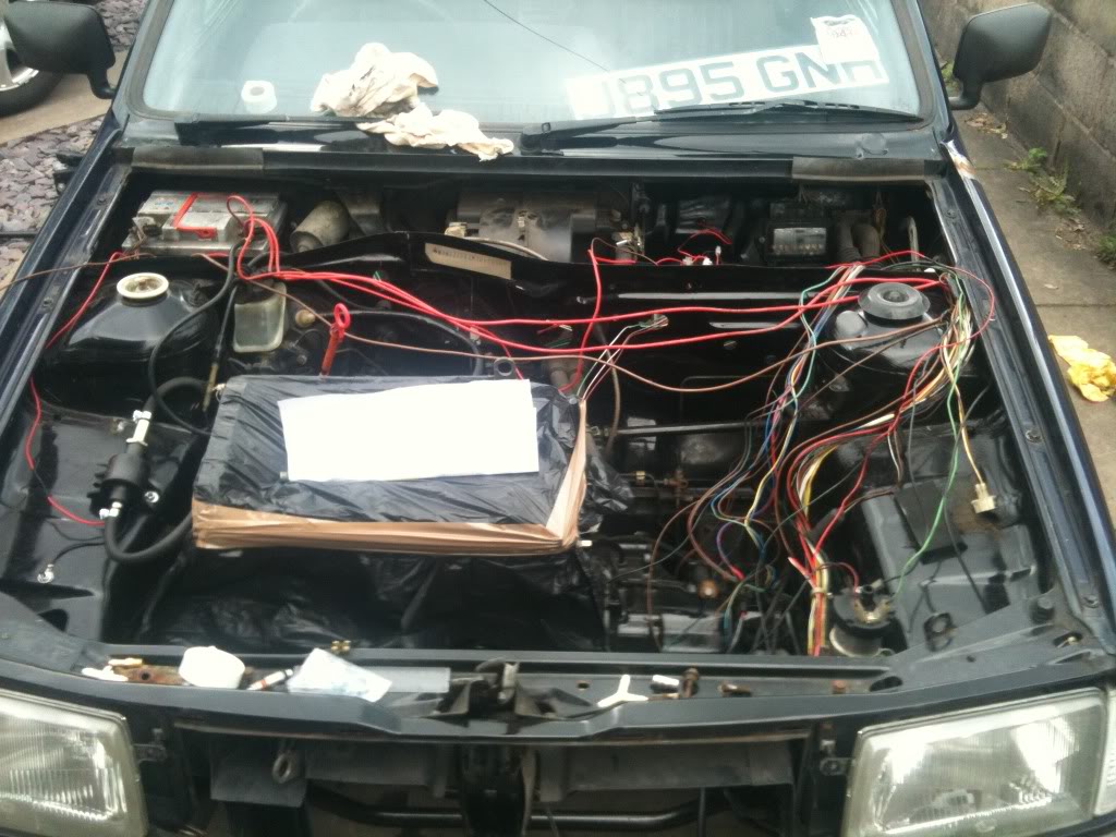

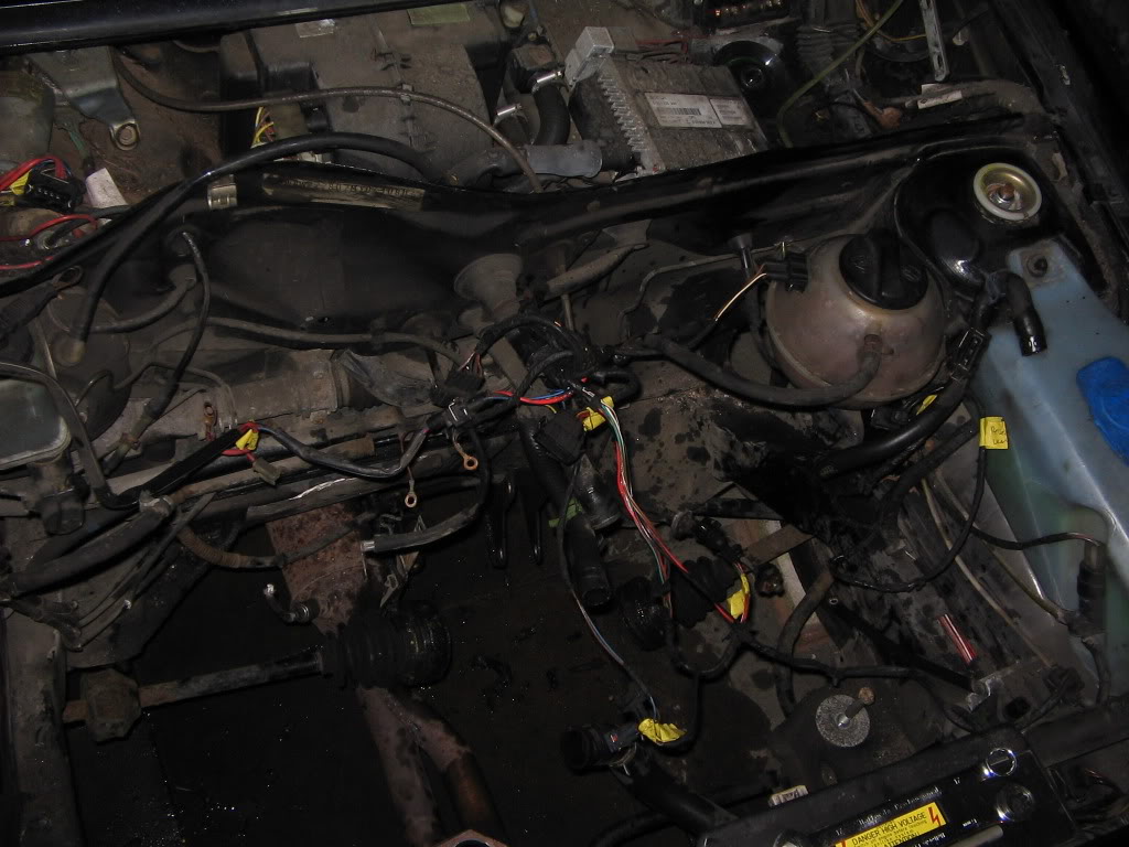

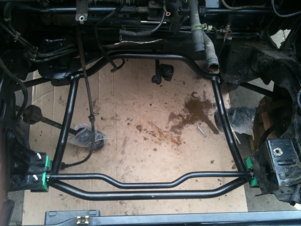

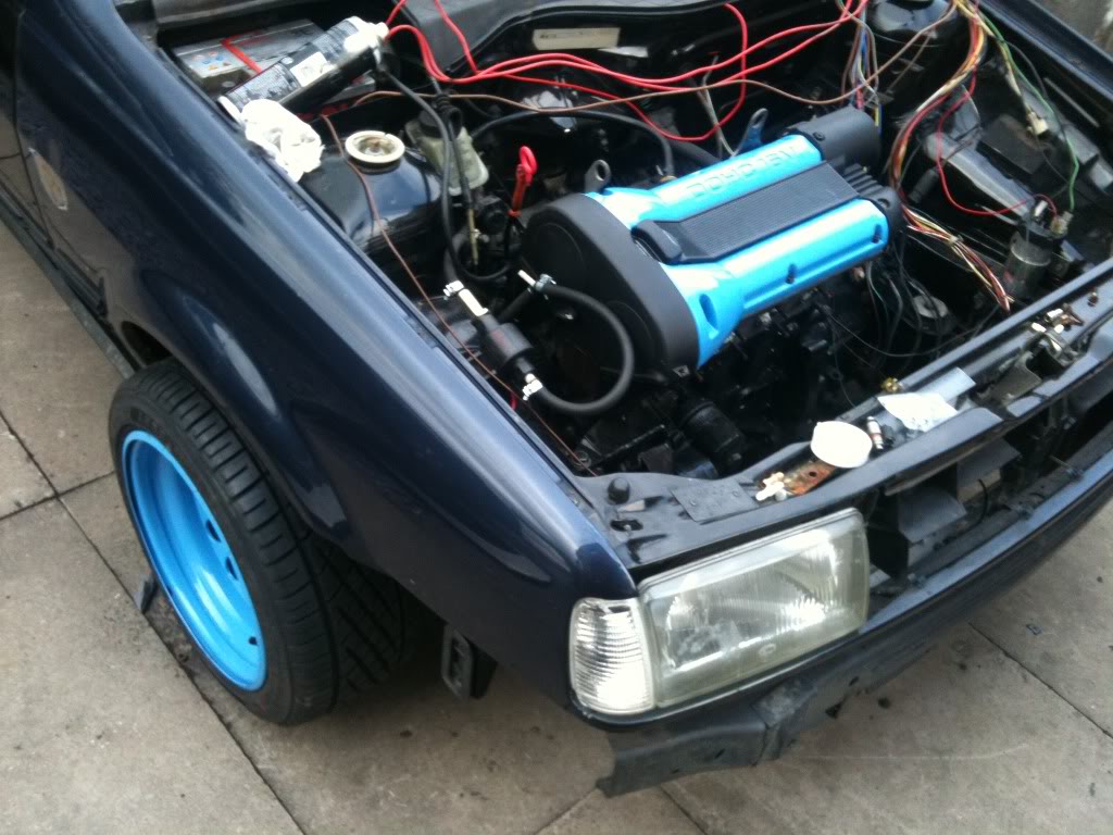

Managed to get all the wiring pretty much done

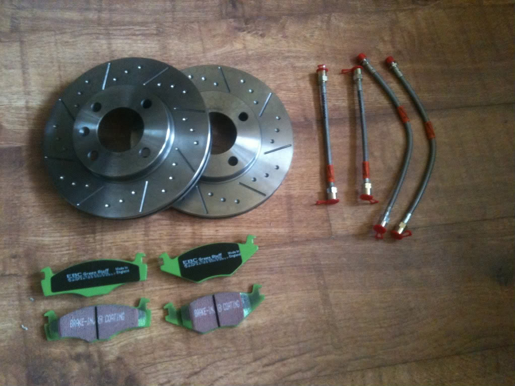

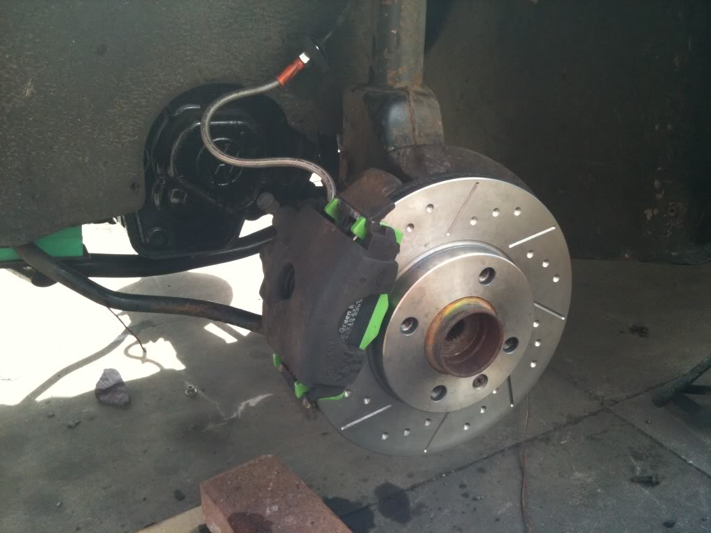

Getting the new brakes on

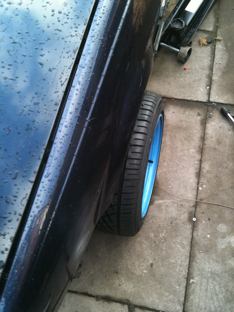

Wheels didn't fit back on so had to get some spacers for the front which has given some awesome poke
Rocker cover has come back

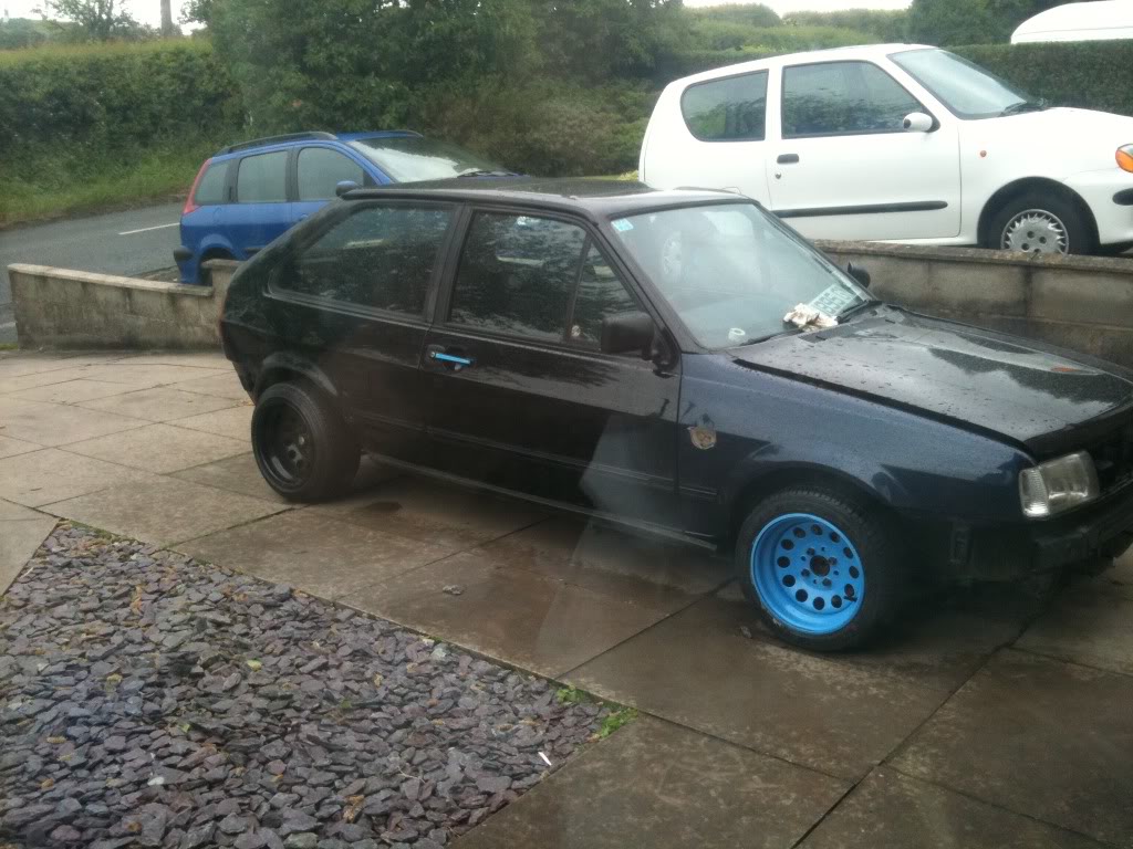

To get the wheels in line front and back, swapped the rear wellers (7) for a mates (8) so now sits nice

just remember...your "poke" will get you 3 points a wheel if your pulled over..so 12 points...no license...no point in having car...hmmm is it worth it...

Rolling the arches and the bumpers aren't on yet so wont be as noticeable.

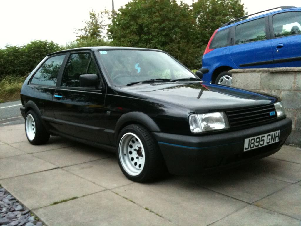

That looks great, think im gona change my 6n 16v for a gt this summer, sooo much cheaper to insure!
  1.2 expression
This isn't tommy, it's Alex, the owner of this car, though id better say what engine it is as somehow, even though i work with him and he's seen this progress, jack somehow didnt know what engine was in it :rofl:
At the moment, its a 1.4 16v out of a 6n, but the plans are to build a hybrid 1.6 16v out of 3 different engines in the future, cam it and stick it on mappable ignition, its been done before and the guy is running 180bhp, cheaply, nd more importantly reliably! Failing that, its going to be a g40 turbo build, but thats lots of money and i should be saving for a house!
i just want to get this thing running now, so the 1.4 16v will do, 130bhp in a car that weighs 600kg will do for this summer i guess..
I know about the poke issue, and the points for it, the rears, with the stretch sit inside perfectly in the arches, so they are ok, and the fronts will just about be when my arch roller finally arrives :)
Anyhow, thanks for the feedback guys :D

I am not saying it won't - I am interested to know if it will. I would have thought the wheels sticking out that far would be a fail for a start? Things like using a sign to cover a hole and just welded into place cannot be safe? Same with the wiring that looks all over the place! It just all looks half arsed and like a death trap to me!
  Clio 1.2 mk2
The wiring isn't finished yet. It's just there like that so we can see where it all is before it all goes back properly. The arches wont be so much of a problem once the trim is back on. The sign i've no idea haha, but i think it's better than the whole that was there that it passed it's last mot with. But yehh it will be a lot tidier before it goes on the road.
Not to come across as a t**t, but if my car failed an MOT on the basis of having "a sharp edge" from a crack in the wing, I'm amazed a self welded piece of metal from a sign is let through.

The sign was because i had no metal to hand, and the sign was galvanised and wouldnt rust as that area is horrendous for rot, but has been sealed around the edge, and all painted, and since its been smoothed, its hard to tell its not original! Its the battery tray anyhow, so without undoing the clamp and taking it out, you wouldnt see it!
The arches are getting rolled tonight/tomorrow so the wheels wont poke out at all.
The wiring has been stripped back as ive ditched the ecu as im running bike carbs and an old mk2 vac advance ignition system, im removing the wires i dont need (about 3kg so far!) and cant do that whilst its all in the loom tape, in fact this morning, 20m of tape arrived to tidy it all back up again :D
Trust me, this is no rush job, and no expense has been spared, i hate to think how much ive spent on this bloody thing :/
Oh, and by the time its finished, there is nothing it should fail on, everything has been replaced! though emissions may be a slight issue :S
