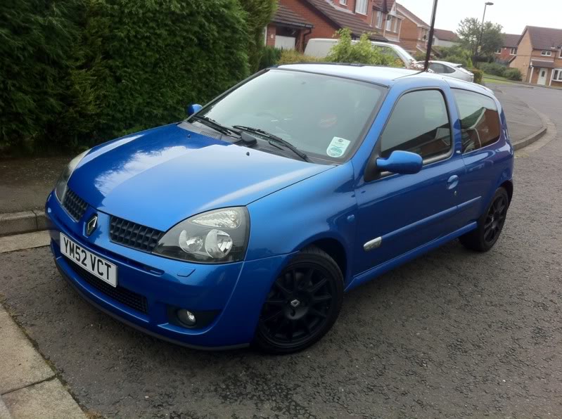

Thought I'd throw a few pictures up of my new to me Clio 172 Cup. I've been a life long Vauxhall fan, owning everything from a 1ltr Nova 1st car, onto Mk 4 Astra GSi and SRi turbos, aswell as my long term 2ltr, twin carb'd, Quaife Diff'd Nova.
After buying our first house 4 years ago money started getting a bit tighter, so the turbos were sold leaving just the Nova, and after a trip to the Nurburgring for my stag weekend and a track day at Croft in it, I decided I'd spent enough on the car, had my fun with it and was time to break it :(
So after a couple of years of sensible motoring, I was getting the itch for something entertaining to drive again, and hopefully if money allows (now have a 3 month old son and an expensive mortgage) be able to do a few track days, and a return to the Nurburgring ASAP!!
I narrowed my search down to either a Civic Type R or a RenaultSport Clio. After weighing up insurance costs, and the price to buy a decent condition car it was decided to buy a Clio, and use the money saved to pay for some mods and pay off the insurance on both the Clio and the family Laguna.
After road testing a few cars, I found the ideal car I was looking for, a low milage, Mondial Blue 172 Cup. I loved it straight from the 1st drive, reminded me a lot of my old Nova with it's big engine, light weight body, but crucially it also handled fantastically, especially in the wet when in a converted Vauxhall you'd be cautions pressing the throttle mid bend!!
Anyway, enough talking, here's some pictures of the car and some of the mods that have already been carried out in my 1st week of ownership!

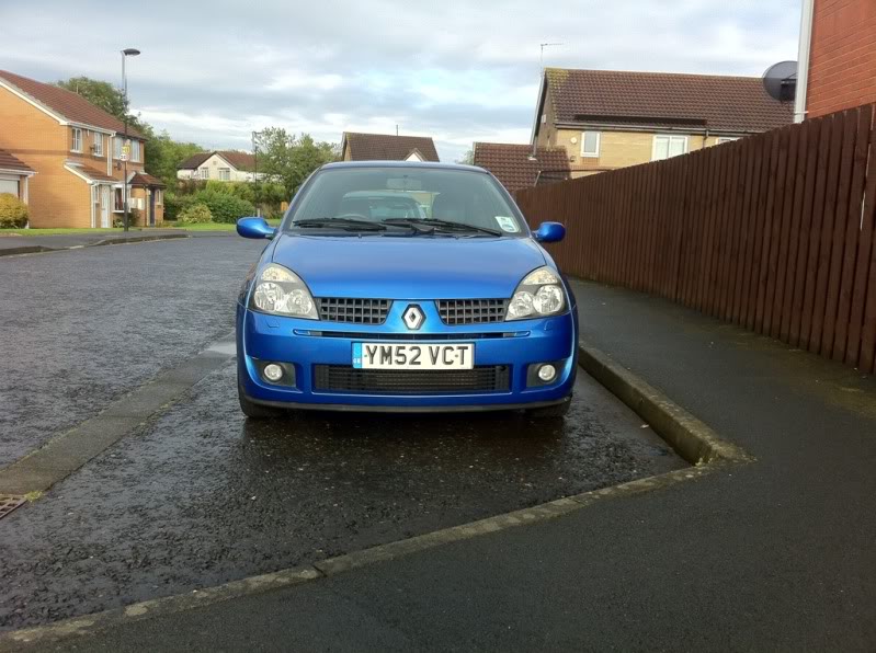

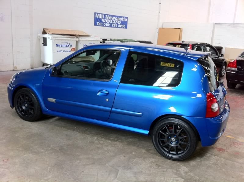

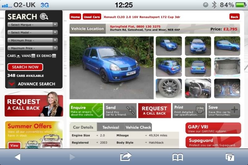

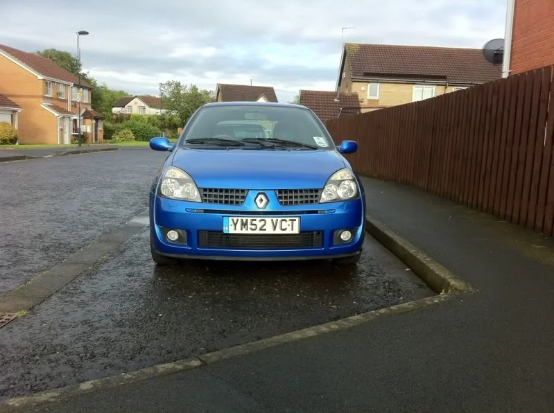

How I first spotted the car - a trade in at a local Fiat Dealership.

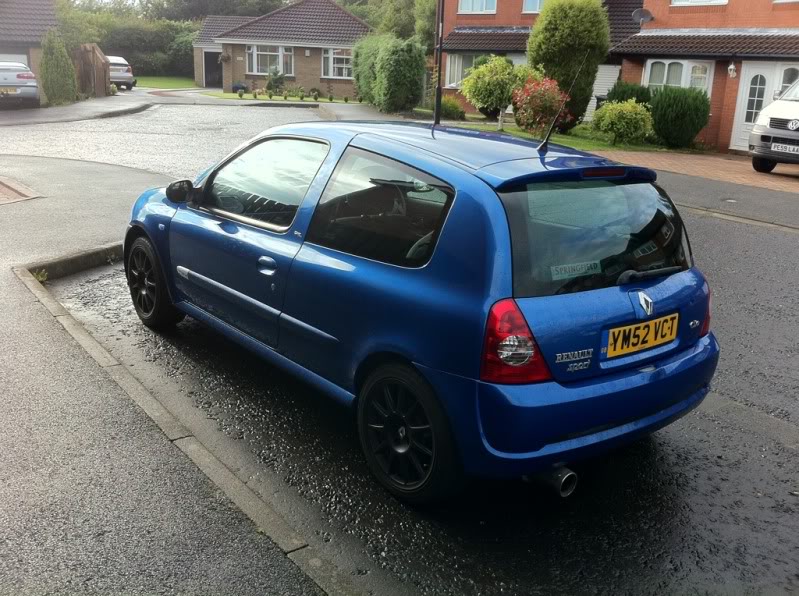

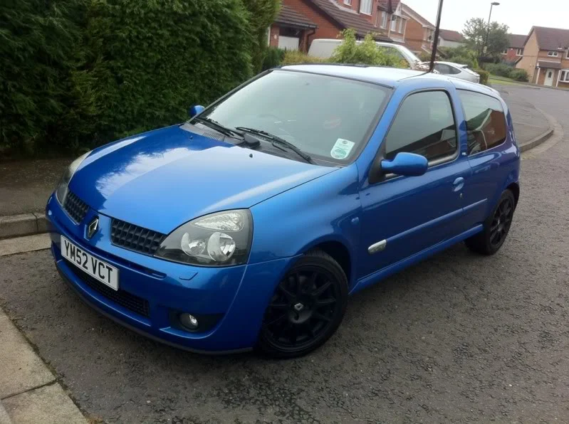

Got the car home after a quick wash, needs a few jobs sorting.

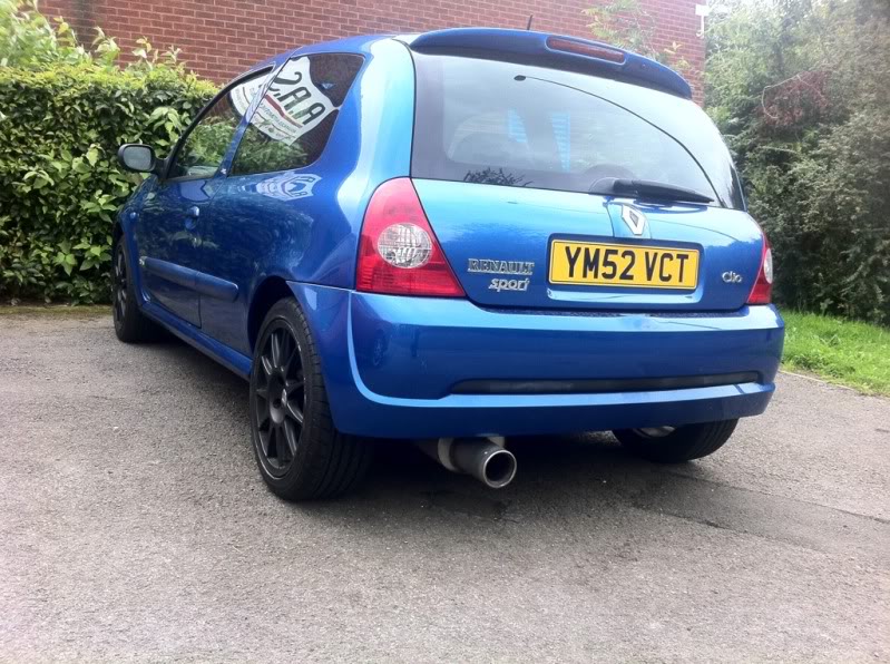

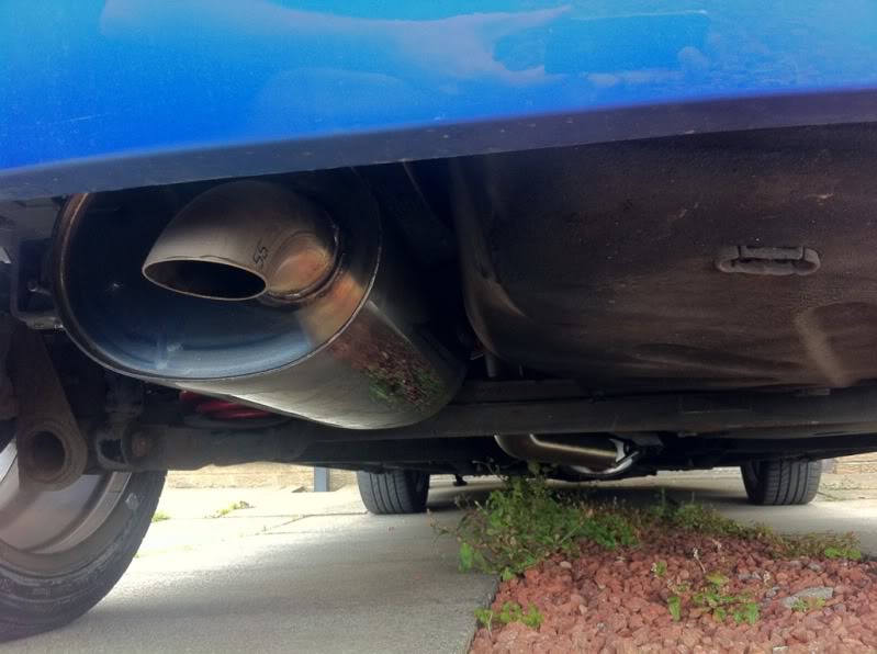

First job was to remove the Scorpion exhaust for a custom made stealth exhaust by local legends AAS!
Also fitted some Eibach Sportline springs, slightly disappointed with the lack of drop, but at least it's levelled out the suspension and still looks fairly standard which I like.

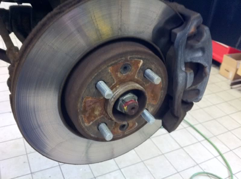

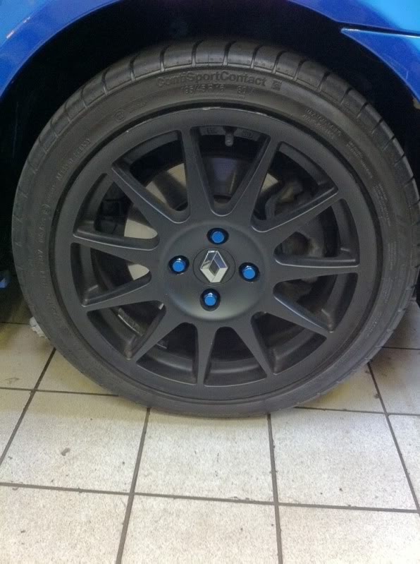

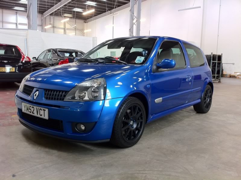

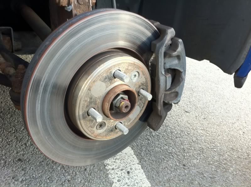

Next up a quiet day at work (I'm a mechanic at a Volvo main dealers) meant I could give the car a proper clean and also fit the wheel stud conversion kit from my Nova, complete with Blue anodised nuts!
That's where I'm up to at the minute, next jibs are to remove the Blue side repeaters, a proper refurb of the wheels and upgrade the pads and discs, then fingers crossed a track day before the end of the year!

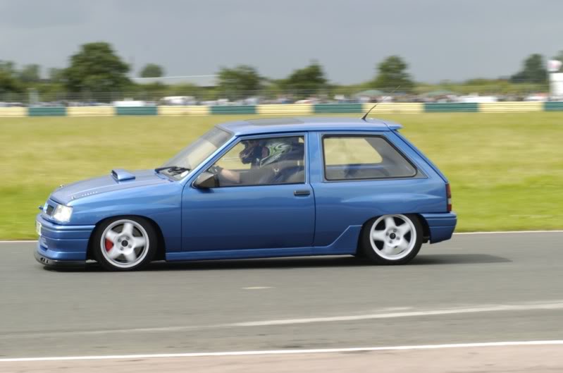

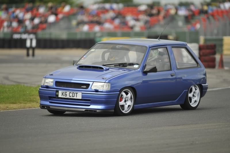

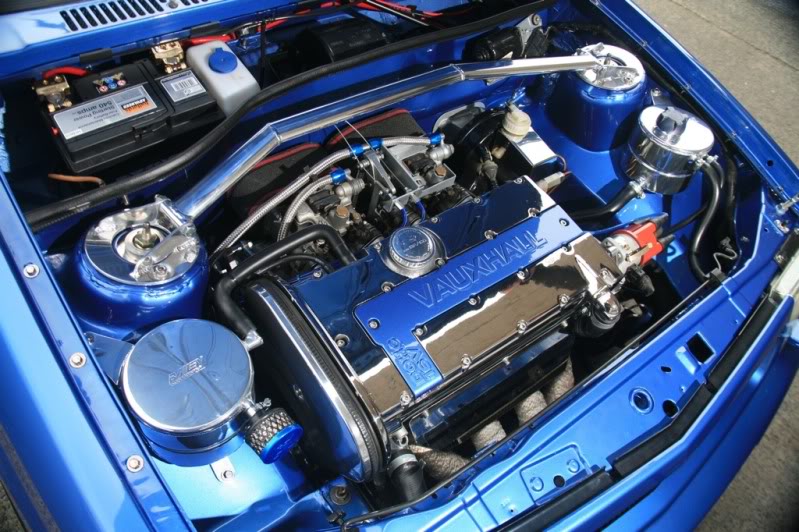

Here's some pics of my old Nova too - love them or hate them it was a fantastic car to me!
And the reason for the bonnet scoop - function over form! Hungry carbs!!!

novas filth!! love it mate! cup looks abit like mine too, part from mines lowered ;)

Looking good mate. Were the sportlines new? it does look a little high from the picture. Maybe they just need to settle a little.
Cheers for the comments guys!
Sportline springs were bought brand new, and do seem to have settled slightly lower now.
Turini's will be getting refurbed at some point, can't make my mind up what colour yet. I do like the standard silver, but also like the satin black when their clean, or Anthracite:S
Stud's came from eBay - M12x1.5mm - 40mm long.
  Golf GTD Mk7
The wheel colour looks bang on to me. Nice clean satins work well. Unfortunately they're a b**ch to clean.

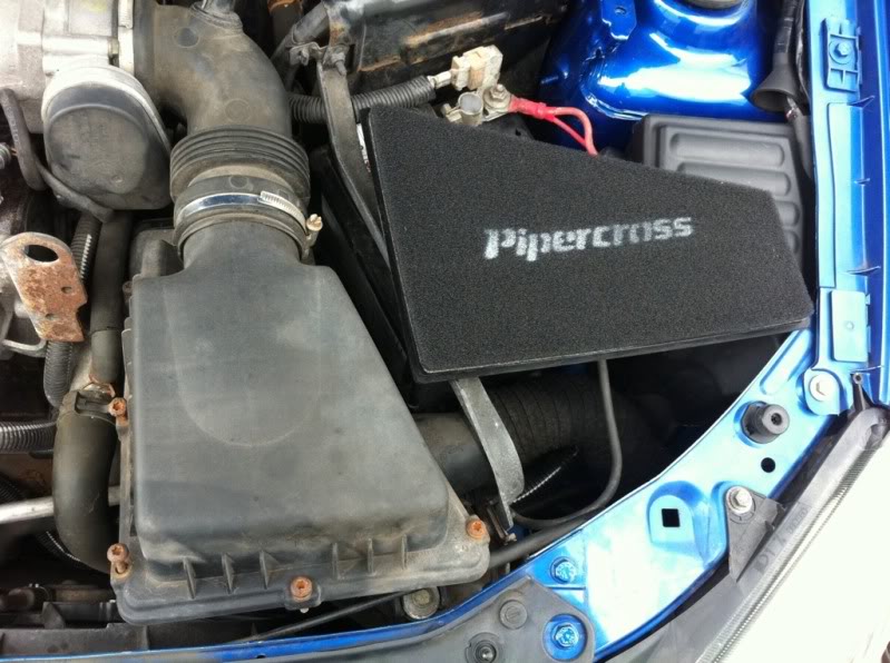

Small update, fitted a Pipercross panel filter - I've read all the arguments for and against so please don't bother trying to tell me not to bother with it!

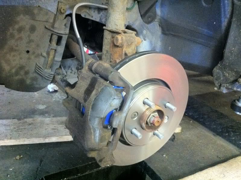

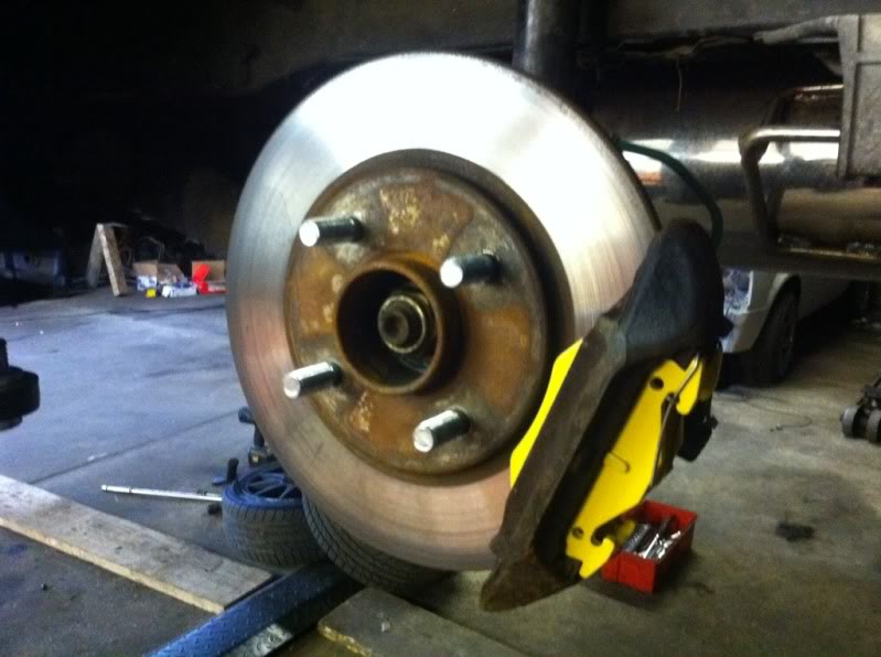

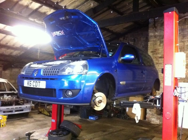

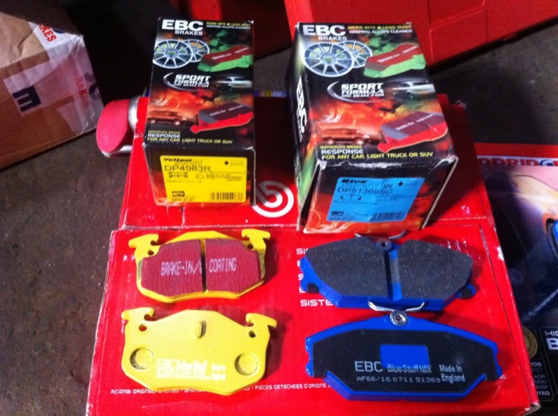

Been a long while coming with an update, but I've been gathering parts, and today got round to fitting them with the help of my mate and his ramp!

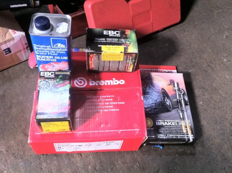

Here's the parts:

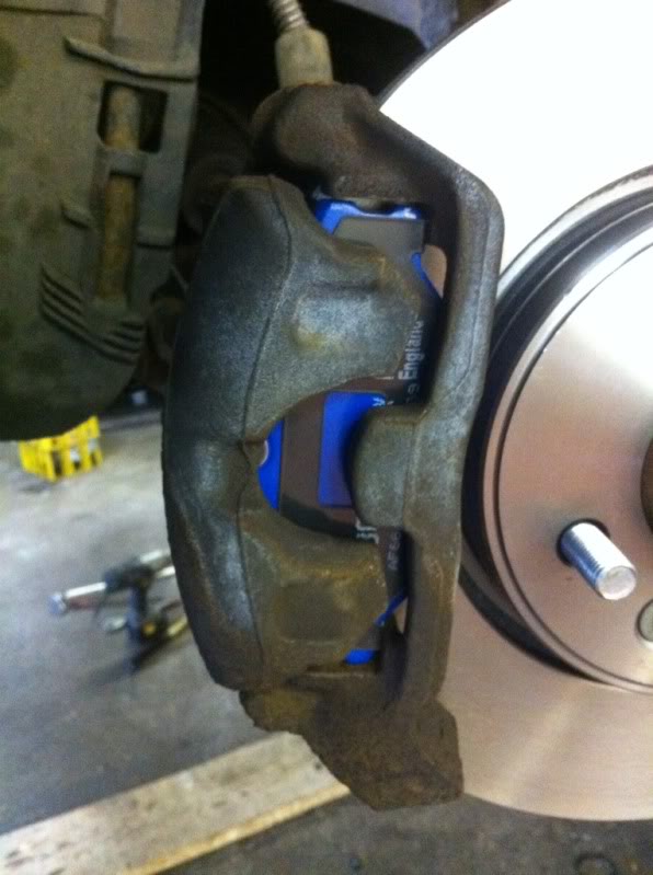

EBC Bluestuff front pads, Yellowstuff rear pads, Brembo High Carbon discs, Goodridge braided hoses, and ATE Super Blue Racing fluid.

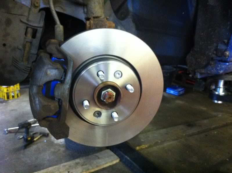

Nice easy job fitting the pads, perfect fit, no need to file or grind the edges at all :)
Onto the front - same again, perfect fit :)

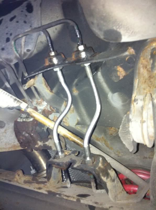

Then fitted the hoses, again, no problems here, great fit, and brake pipes came out of the old flexi's without too much of a fight!
All done and ready to rock:
Initial feedback after only a short drive in the car - the brakes are awesome!! Even at this early stage straight out of the box, the initial bite of the brakes is very strong, not grabby, but fantastically powerful, and confidence inspiring. I can't wait to put a few more miles on them and see how they cope, but they certainly shed speed very quickly!

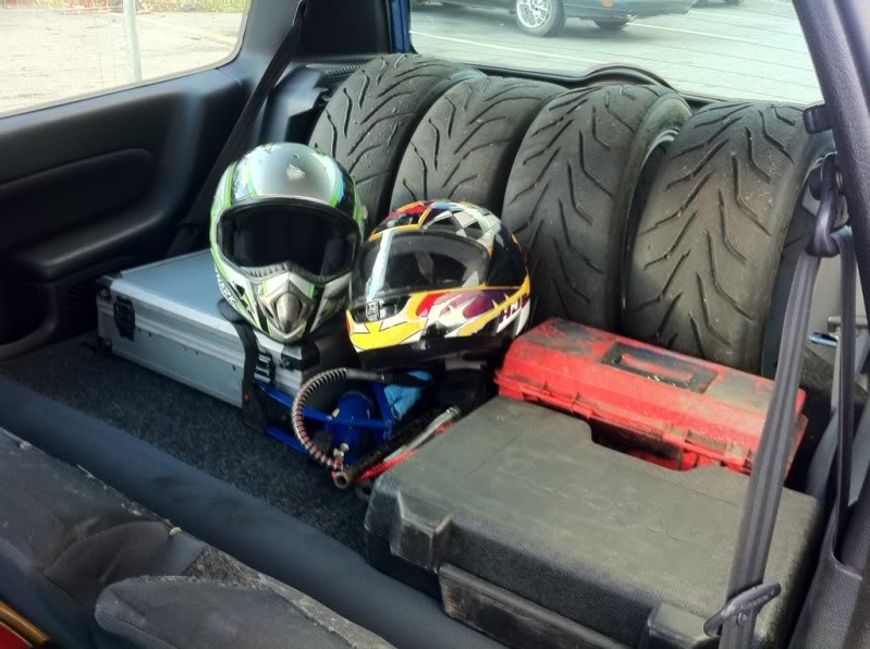

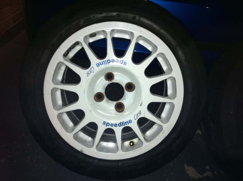

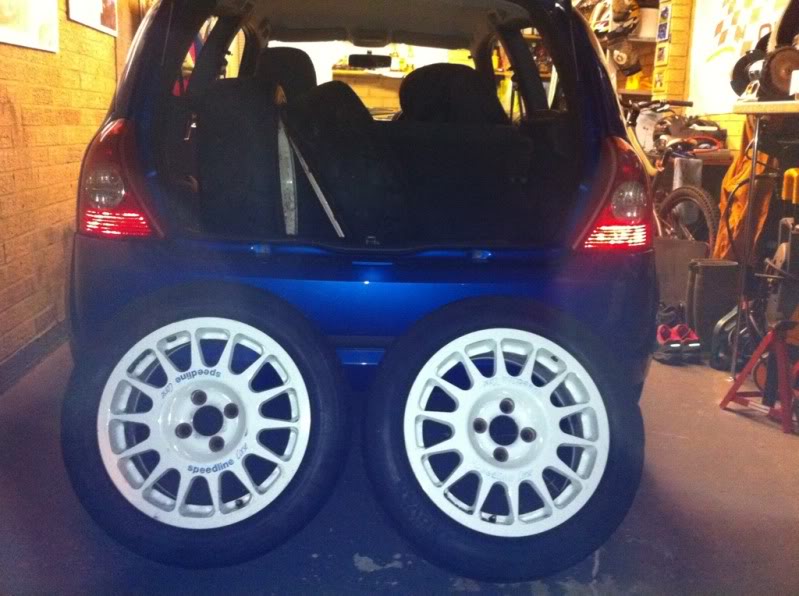

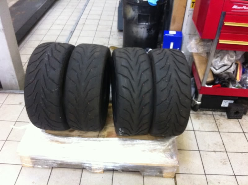

Also sitting waiting to go on is my new track wheels:

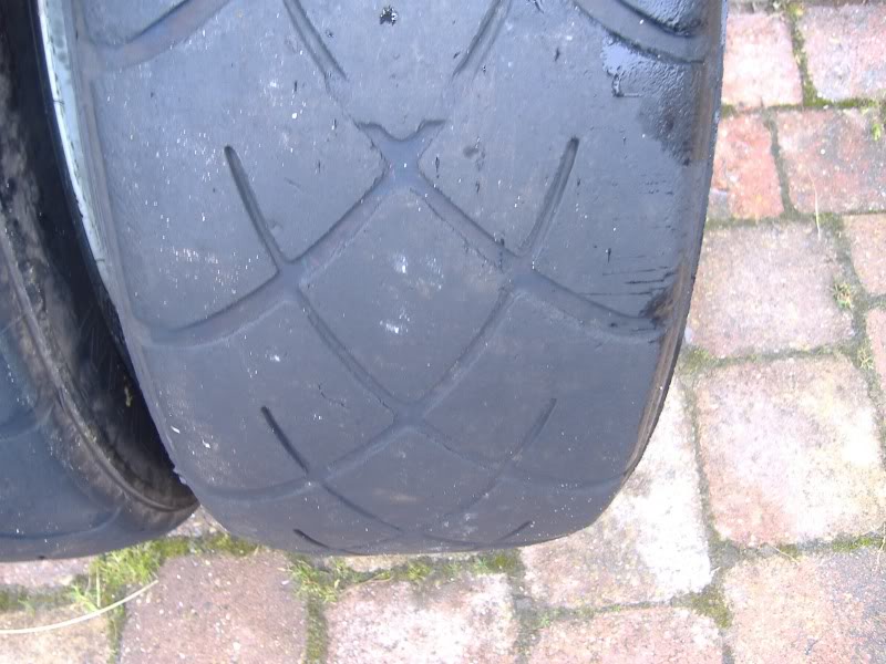

The Yokohama A048 track tyres that are fitted them have seen better days:
so these were found:

Nice update. Out of interest where did you get the pads from and how much? I've got the hc discs just looking for options on pads.
Dan.
imprezaworks
  Mk5 Golf GTI :)
Nice one mate cheers. So overall a good compromise to say the ds 2500? Their cheaper for a start
I can't honestly compare, as I've never used the DS2500. I cam say tho I'm so far very pleased with what I've got! It's just under 3 weeks til the track day so I'll have a better idea of them then, but they already feel very good!

Another small update - fitted the 888's to the 15's and decided it would be a good idea to check there were no issues with them before using them on a track day, so am gonna run them on the road for a day or two.
Obviously can't really go testing their performance benefits properly, but turn in seems much more responsive, possibly down to the stiffer sidewalls? Road noise is massively increased, not that that's an issue for the use they're gonna be getting, but sounds like the wheel bearings are a bit noisy, which I know they're not!

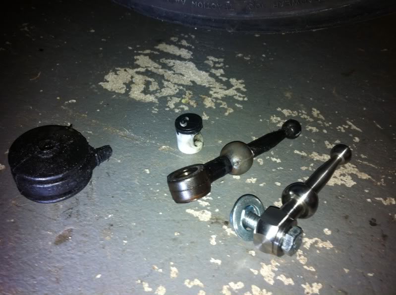

Next jobs before the trackday on the 7th October will be a geo set up, and oil and filter change, gearbox oil change and fitting a Yanoo short shift and stiff shift kit, fingers crossed it all goes smoothly!!
Another small update with a terrible picture - fitted the 'Yanoo' 10% quickshift pin. Still have the 'stiff shift' part to fit, but after a full day working on customers cars, then a fiddle job after work and then fitting the quick shift I really have had enough of cars for one day, so will have to wait for another day.

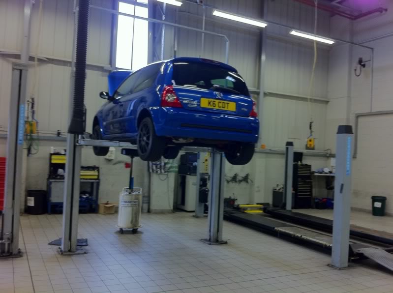

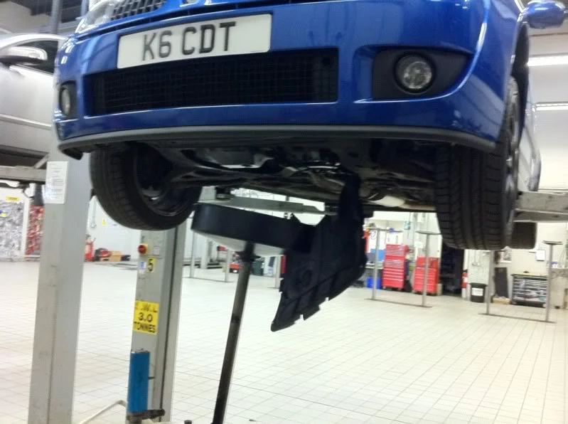

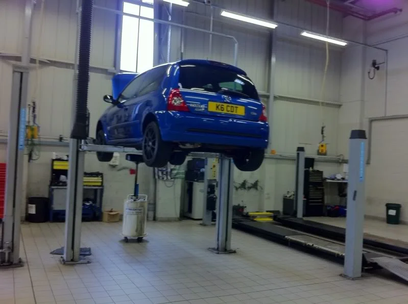

Right, track day coming up on Friday, so today was pretty much my last chance to get the car on the ramp at work (not allowed to use the ramps, so do it on a saturdy while the gaffa's off!!)
Started with an oil change:
The oil that came out was still really clean, testament to the low milage and full history :)

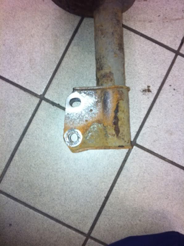

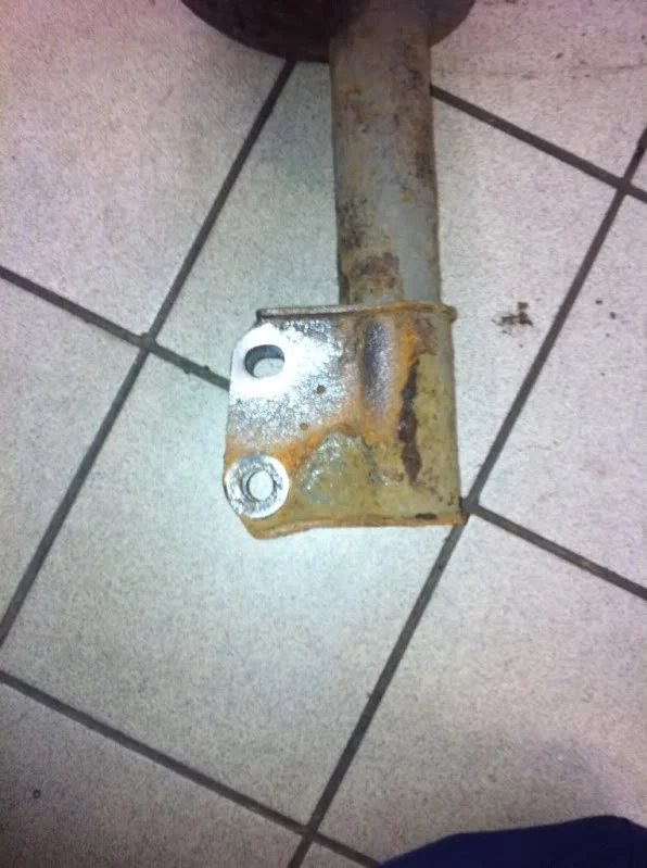

Next came something which I've been debating about for a while, adjusting my front camber. Now the car drove nice and straight beforehand, and tyre wear was perfect, so I was a bit reluctant to mess with it, but also knowing the extra loading on the tyres during a track day I thought I'd give it a go. I ordered some camber bolts, but they haven't arrived yet, and with today being the last chance to do the wheel alignment at work before my track day I thought I'd set about it the getto way:
Now I know people have said it 'can' move when done like this, but the way I see it I won't have these shockers for too much longer (hopefully) and they're tightened to death I'm hoping they'll be ok. This is the same way Volvo adjust their camber, and we have no problems with them.

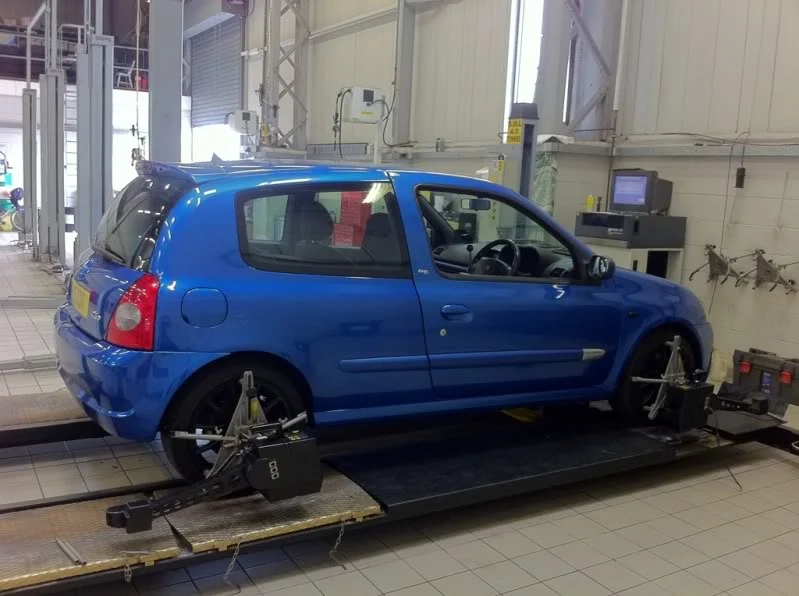

So with both shockers done it was onto the 4 wheel alignment ramp, to set the camber and tracking to my specs. 1.5° front camber, and slight toe out (got the figures in the car, can't remember fully of the top off me head.)
If anyone's interested in this method, I elongated the holes by an extra 3mm, and this gave me a maximum camber of 3.5° so if you were aiming for 1.5° I reckon 1mm should be enough.
A road test later made me pleased I made the changes, it's so stable in a straight line, it's brilliant, and even just driving it on the road you can feel the extra stability! So far nothings moved either, and it's been driven pretty hard and over some bumps etc. Will keep you updated on how it works out. If it does slip I'll simply fit some washers to the bolts, set the camber where I want it and weld the washer to the strut.

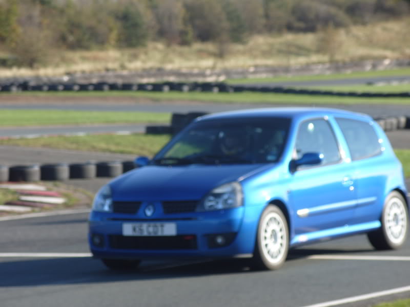

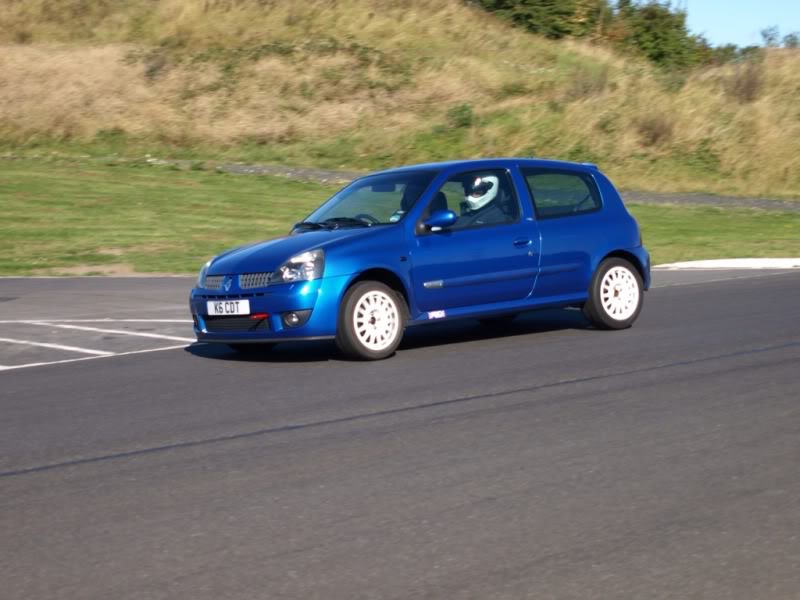

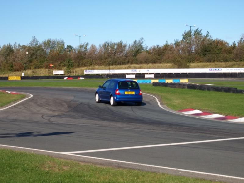

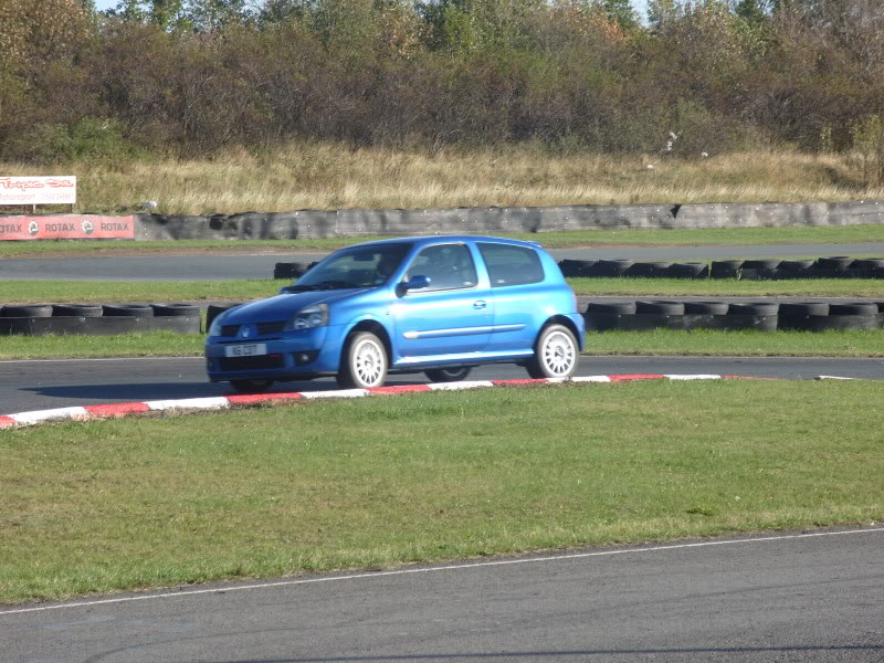

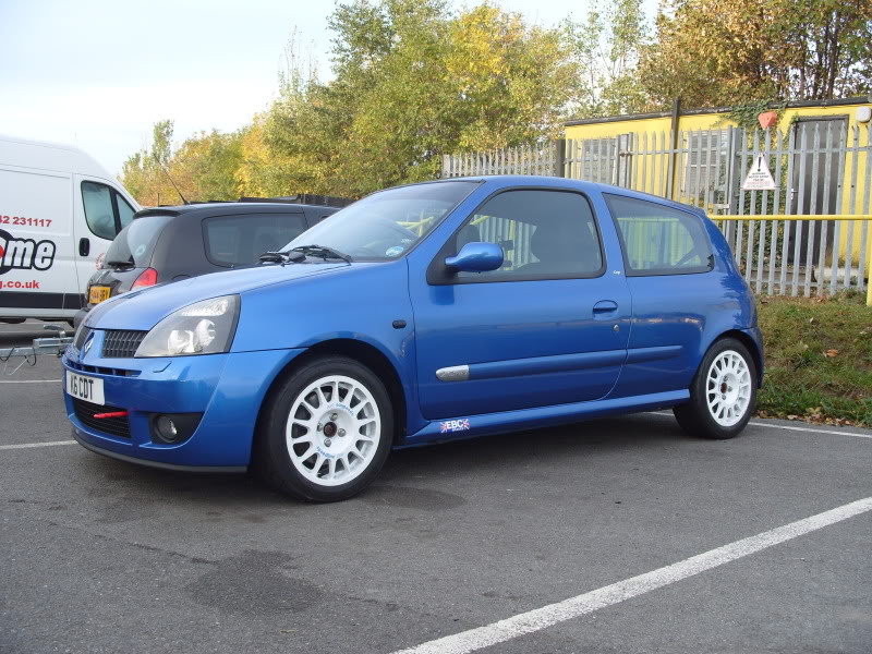

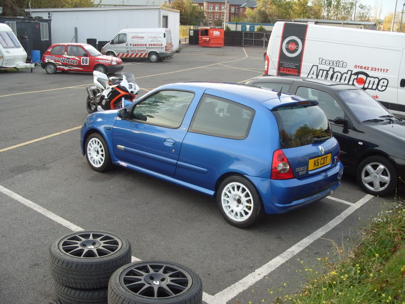

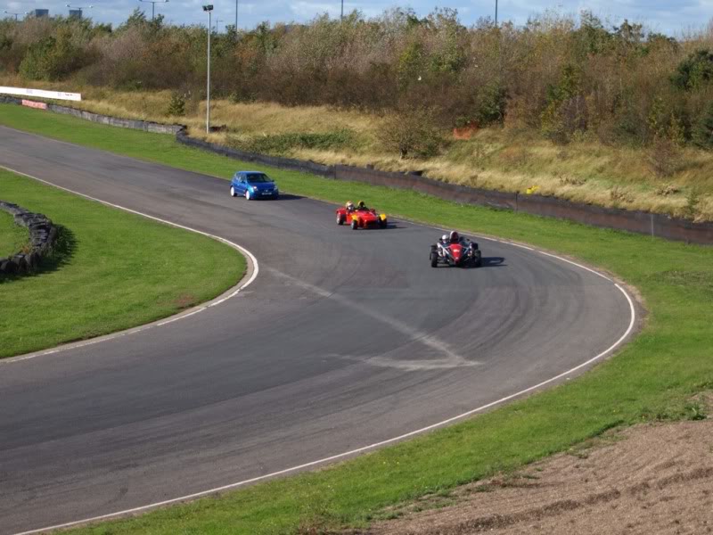

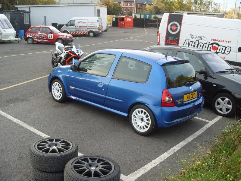

Well, track day done and the car was awesome!! Weather was cold but dry and clear, and there was a very wide variety of cars, from Aerial Atoms to a bog standard, M reg Rover 214, with a tow bar!!! We got to the circuit nice and early and got the road wheels off and my track wheels on.
Then, a very relaxed drivers briefing and off out onto the circuit for some sighting laps behind the instructor and then straight onto our own. I gave a mate my camera and asked him to get some snaps - unfortunately it turns out he's a terrible photographer, and out of four sets of batteries I charged for the camera, only 1 was any good, and they died after about 10 shots :( here's some of his better ones!
The day was run in 30 minute sessions, and was a joint bike and car day, so 30 mins cars and 30 mins bikes! The bikers were mental, and had some serious kit!
In all there were 6 car sessions and the Clio was out in all of them for the full sessions, the only time I had to pull into the pits was to change the battery in my camcorder!! I'd knocked up a home made camera mount for the headrest posts, and it worked excellently! Here's a video of the second session uploaded to YouTube. In this session a Gulf coloured kit car span right in front of me after trying to out brake me, and an Evo blows up his rear diff, spilling oil all over the track :( this was the second session and I was still getting used to the car, and driving on track for the 1st time in 2 years, so in the earlier sessions I was guilty of carrying too much speed into corners and understeering, by the end of the day I was entering slower and more controlled and exiting faster, I was loving it!!
[video=youtube_share;qK6M9h__Pn4]http://youtu.be/qK6M9h__Pn4?hd=1[/video]
I'll be uploading more videos to my YouTube channel so check it out if your interested.
The car behaved fantastically all day, coolant temp never got above half, tyre wear on the 888's was pretty good, handling was great, but above everything else the brakes were incredible! As I've already said from driving with the blue stuff pads on the road, initial bite, even from stone cold is very very good, and out on track stop after stop after stop the feel stayed exactly the same and even after repeated 100mph braking never once changed. I was consistently out braking a lot of the Atoms, track prepped Exige and VX220, and I think that was down to the confidence in the braking performance! I've never been so confident stomping on the brake pedal!!

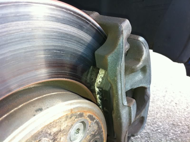

Here's a couple of pics of the hammered Brembo HC discs and blue stuff pads after about 3 hours out on track. The discs have had a seriously hard time, but there's no judder at all and there still as sharp as ever! Brake dust didn't seem to bad either, but I'll know better once I clean the wheels.
I never felt the need for any extra brake cooling, although I'm sure it wouldn't hurt!
Best of all for me tho, after a great days fun the at was loaded up again, road wheels fitted and driven hone without a single bit of bother - I love it!!

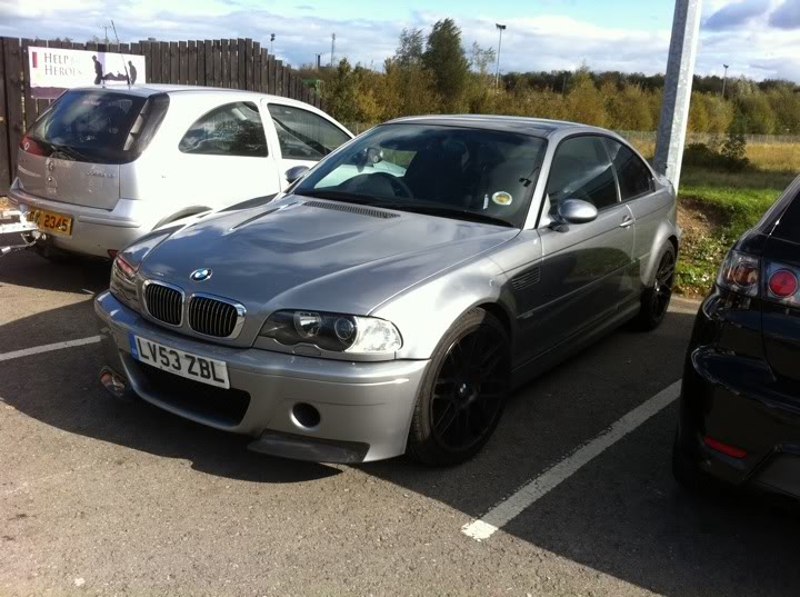

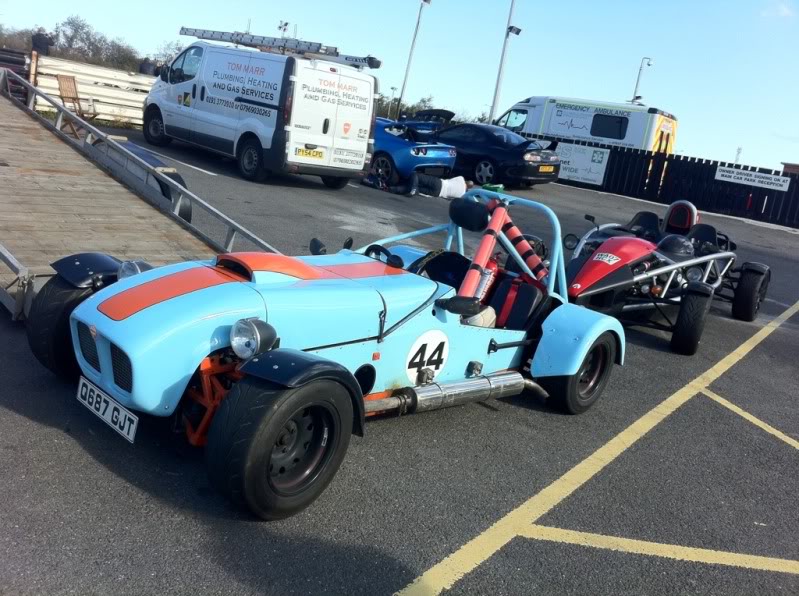

Here's some pictures of the other cars on the day:

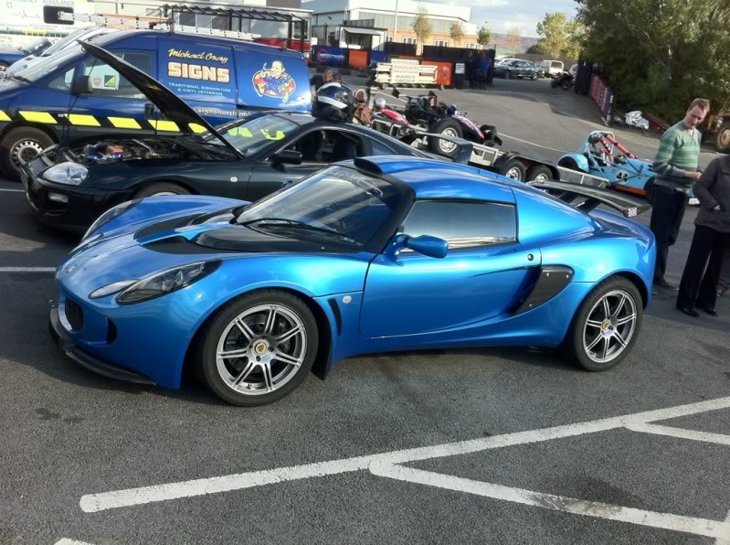

Civic Type R engined Exige - sounded absolutely incredible!!

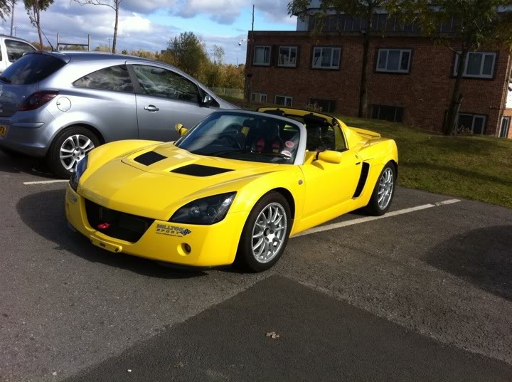

Very well prepped and quick VX220 turbo:
Spinny kit car

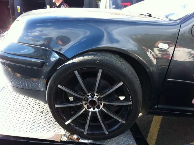

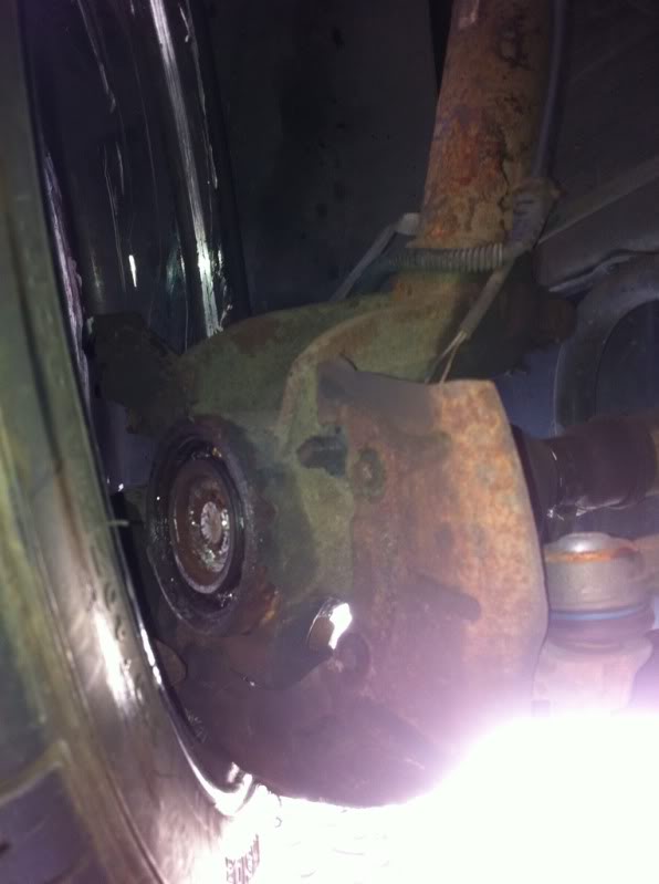

And some poor bloke who was thrashing his pride and joy Golf GTTDi had a scary moment in the 5th session when his front hub gave way!! Hi quote of "the ABS light just came on" may have been a bit of an under statement!!

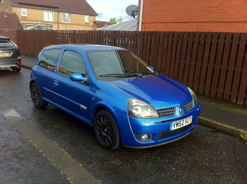

Not much has been happening with my Clio lately, its just been taking the commute to work in its stride every day, and putting a smile on my face on the rare occasion there's an open streatch of road on a weekend drive!
This happened a week or so ago...

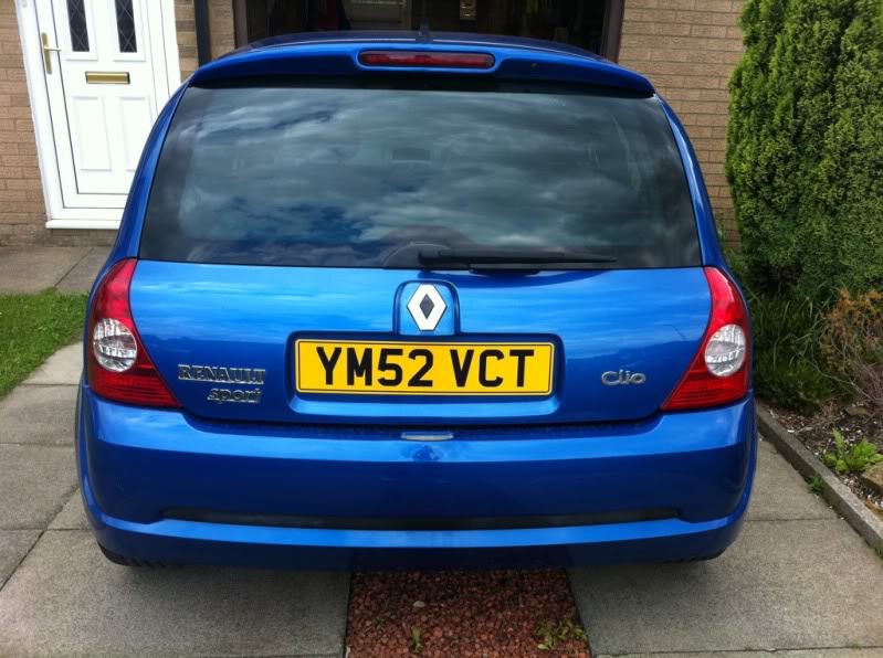

I did manage to get a slim front plate fitted (was on before the track day!) by local Company Allidrew, and today I have changed the oil again (actually less than 1000miles old!) due to the hard use on the track day, and being unsure of actual oil temprature and if it would have damaged the oil at all. As its easy done and will do no harm I changed it again.

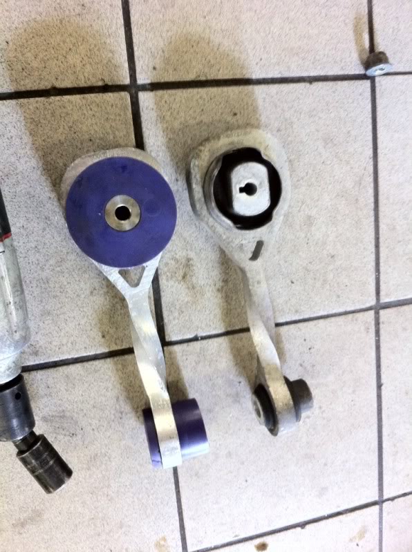

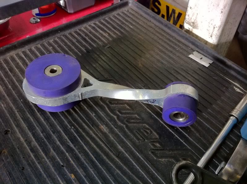

and today I've also fitted a Powerflex bush'd dogbone mount....
I'm now on the look out for the other Vibratechnic engine mounts, and also some 15" tyres to allow me to run the 15" wheels for the winter, so I can refurb the Turinis.
